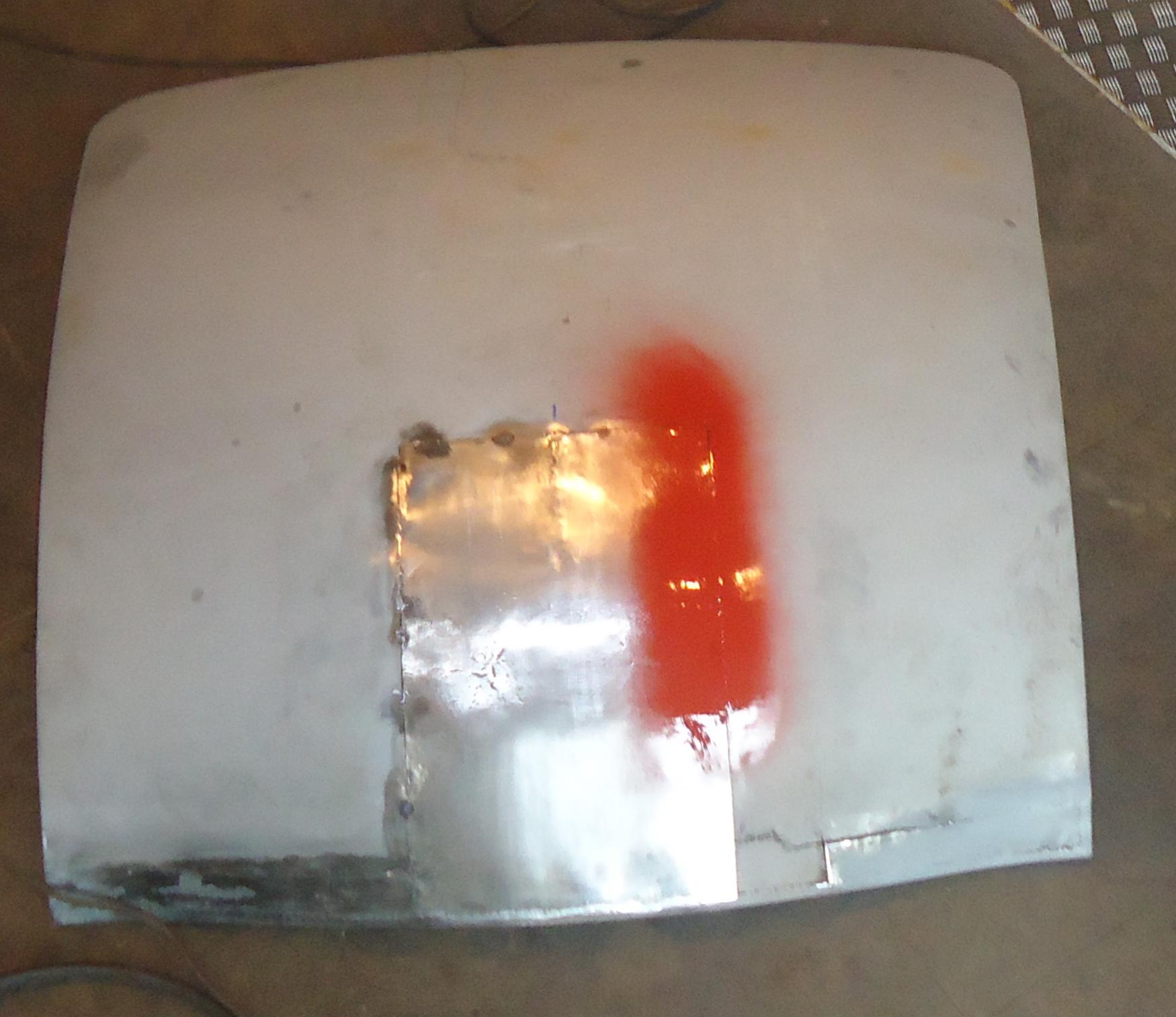

    Thank you for the praise Allen. I'm probably going to spend most of tomorrow with a hammer and dolly on the new piece as I now have very good access.

    Thank you K13! You are correct and read my mind. I figured that if I was unable to fabricate the correct curvature, I would build an English wheel. I may still build one in the future though.;) For the time being, it's hammer and dolly time tomorrow to get the panel smooth.

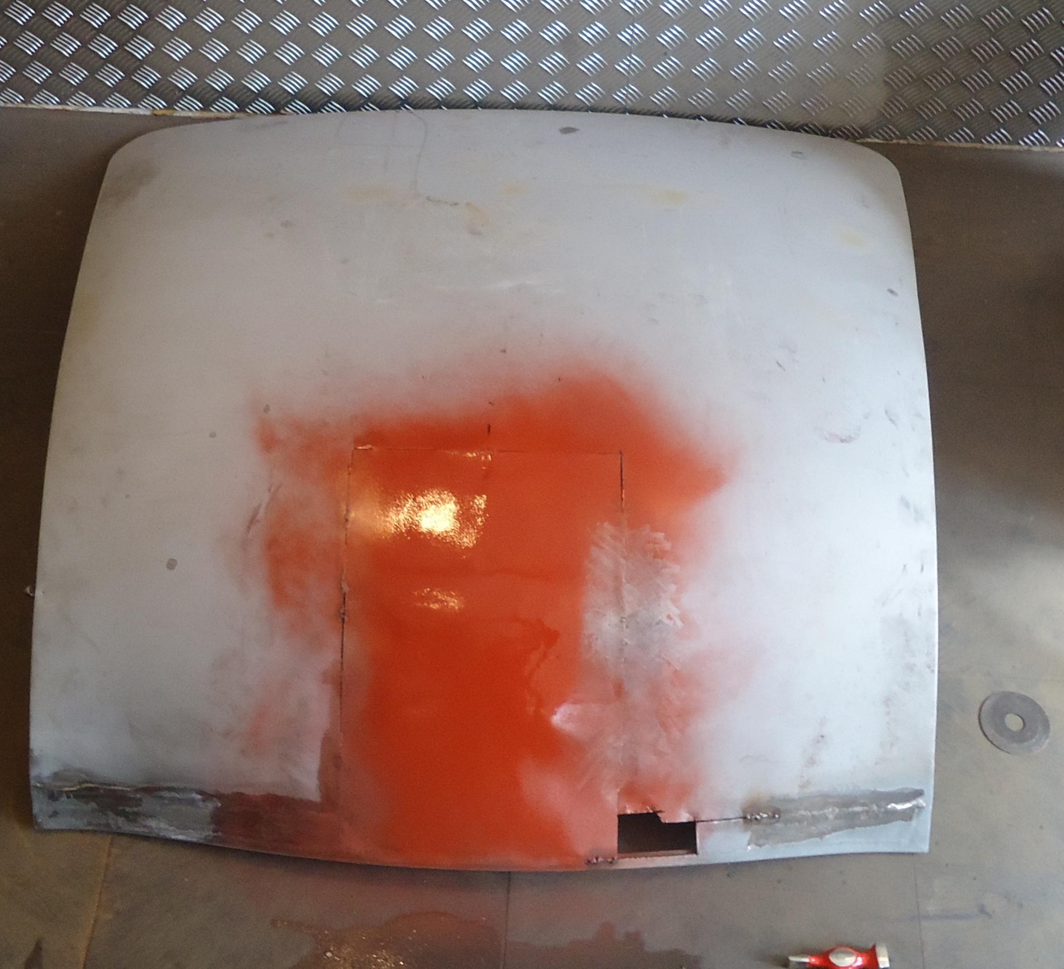

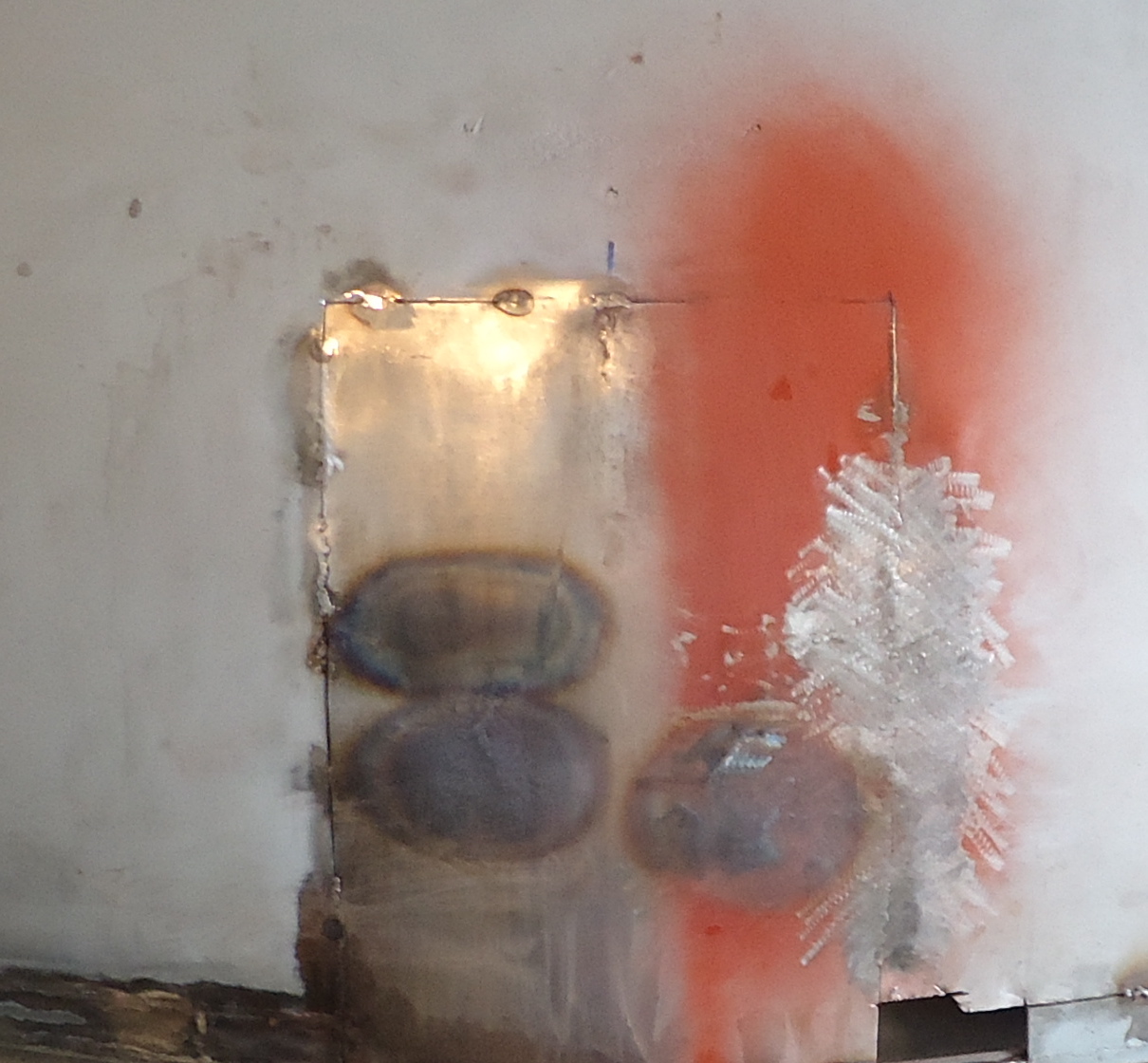

    Most of the day was spent with my hammers and dollys....and the odd bit of welding. I managed to get the right hand side welded up, while combatting warpage all the time. It work out good. Also used some heat to shrink 3 of the high spots. This also worked surprisingly well. In btween hammering and welding, I use this special red paint. Once dry, I use sandpaper to find the high spots, and this indicates the areas requiring attention. I'll be continuing with the deck lid next week, as it's off to work and cruise the European skies.:D:D:D
