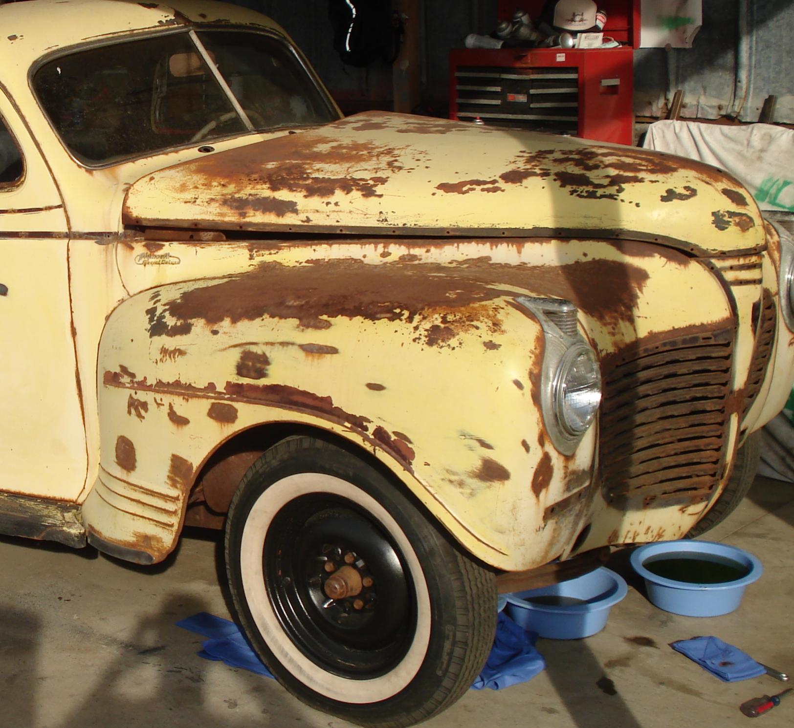

    There is a picture of a yellow 41 plymouth..I believe it came from a motel in between Avala and Pismo Beach California..There was one just like it that sat there for 30+ years and I am thinking its that one.

    Hey Brian, good to hear from you again! It would be great to find out some more history of the car. (***uming it's the same one.) Any more info would be appreciated! Here are some other pics of the car. (btw, I think originally it was a dark red exterior color before it was painted yellow.)

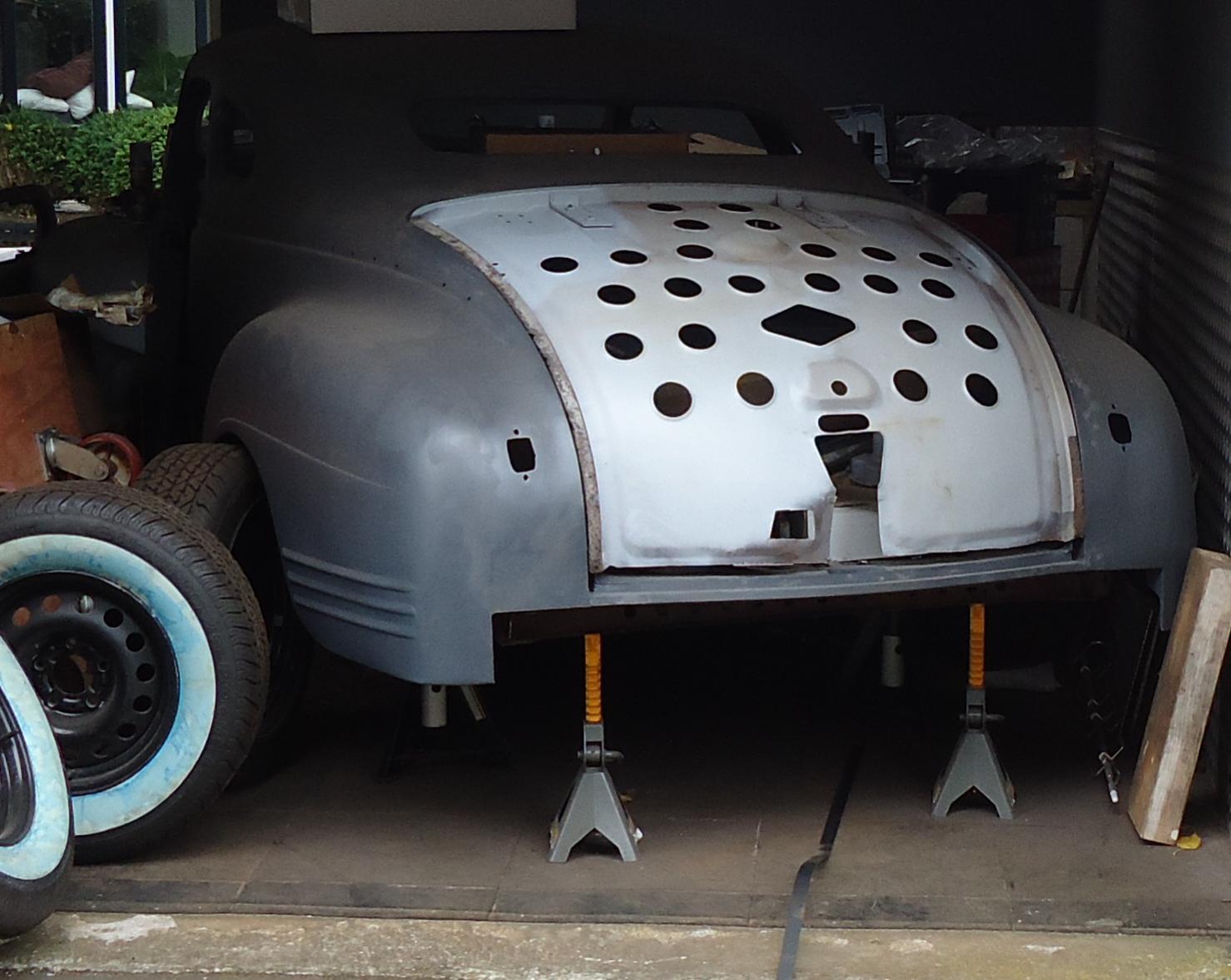

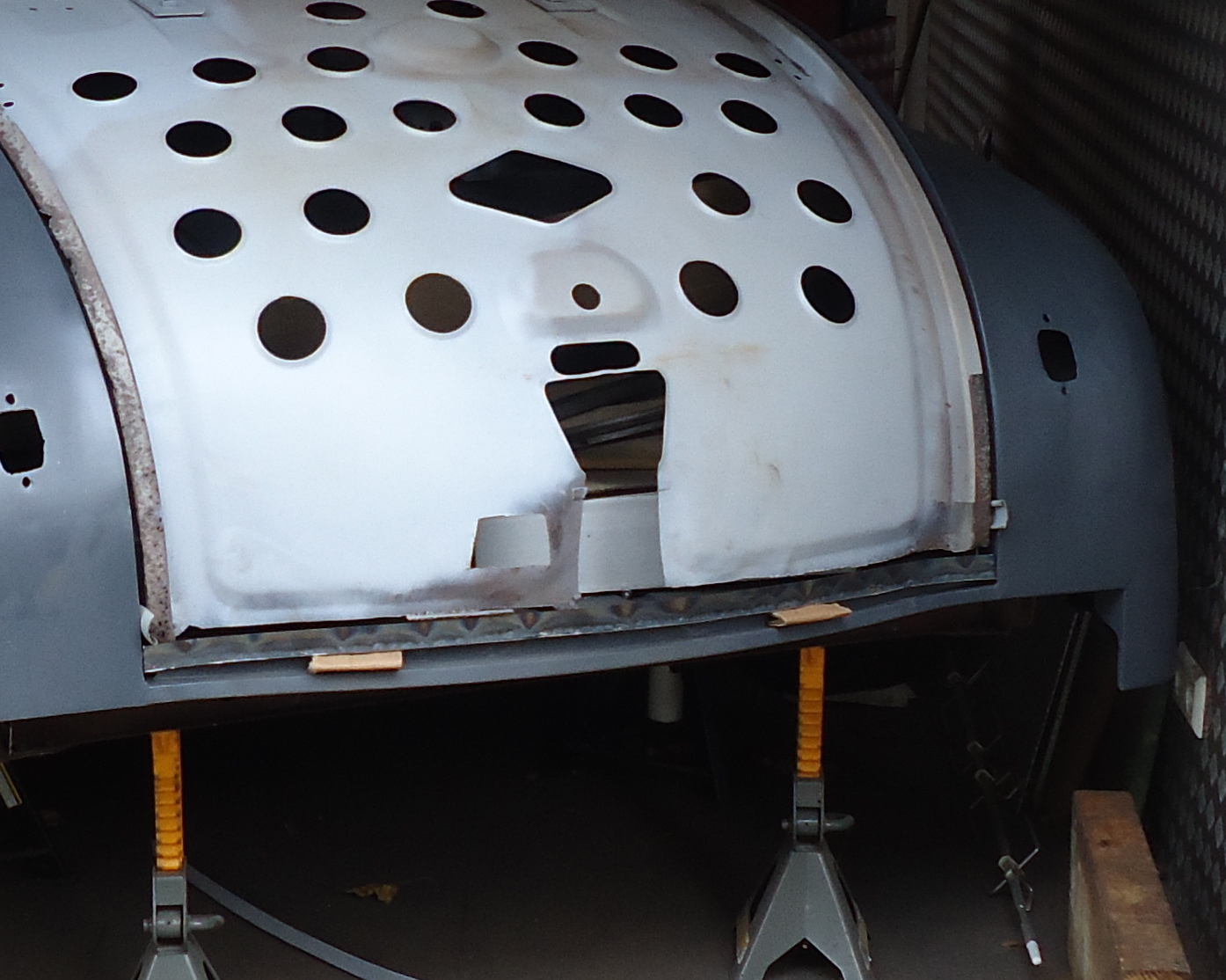

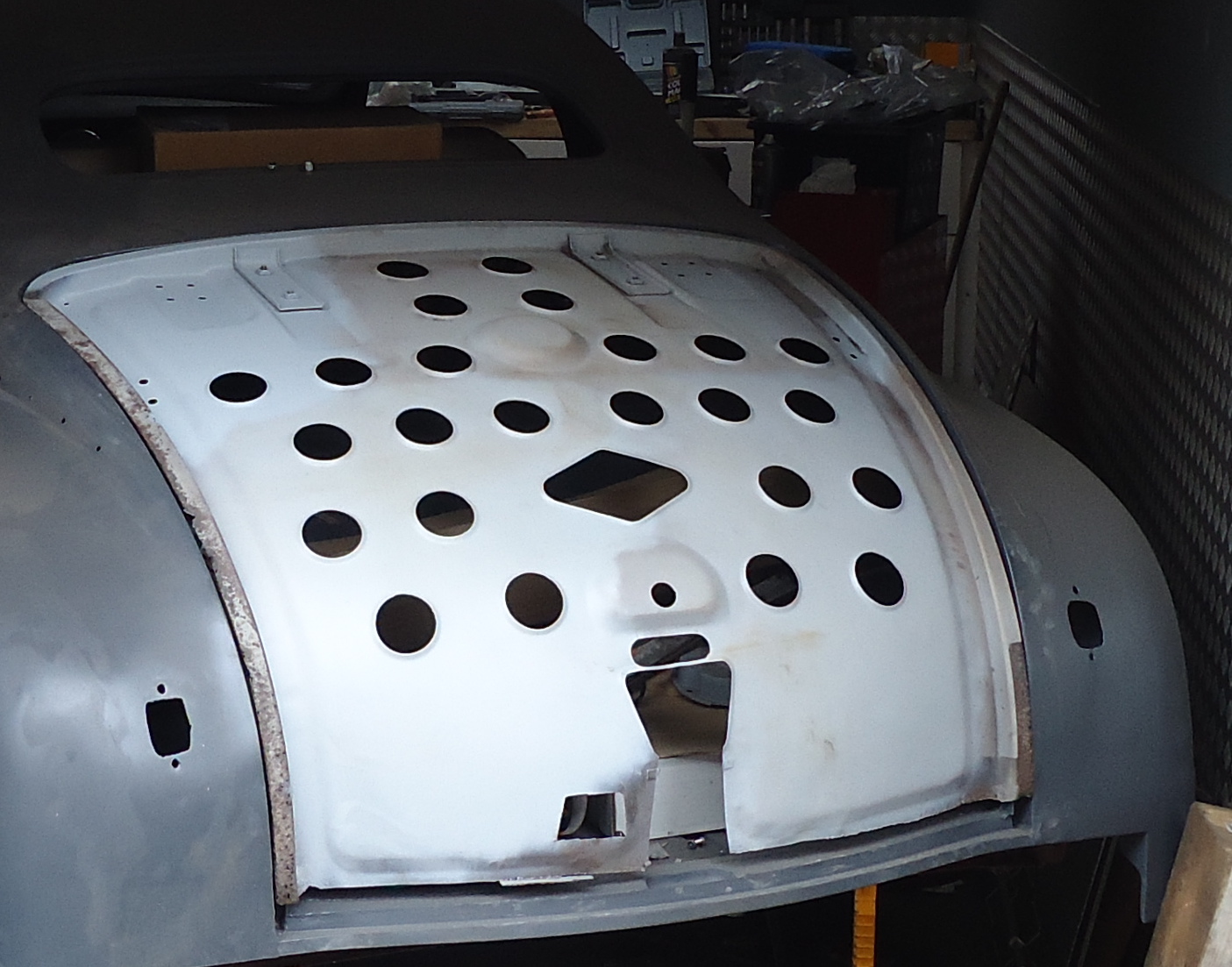

    Mounted the inner deck lid today to see how the fitment is. I want to get the shape correct first by repairing/extending the bottom first before I weld in the piece I fabricated last week. As you can see in the pics, the bottom needs to be rounded more, that way the space in the gutter will be equal all the way. (at the moment, the sides at the bottom are hitting the body.)
    I'm going to make a few drawings tonight in order to get my thoughts on paper .......the fabrication will start this week.:D

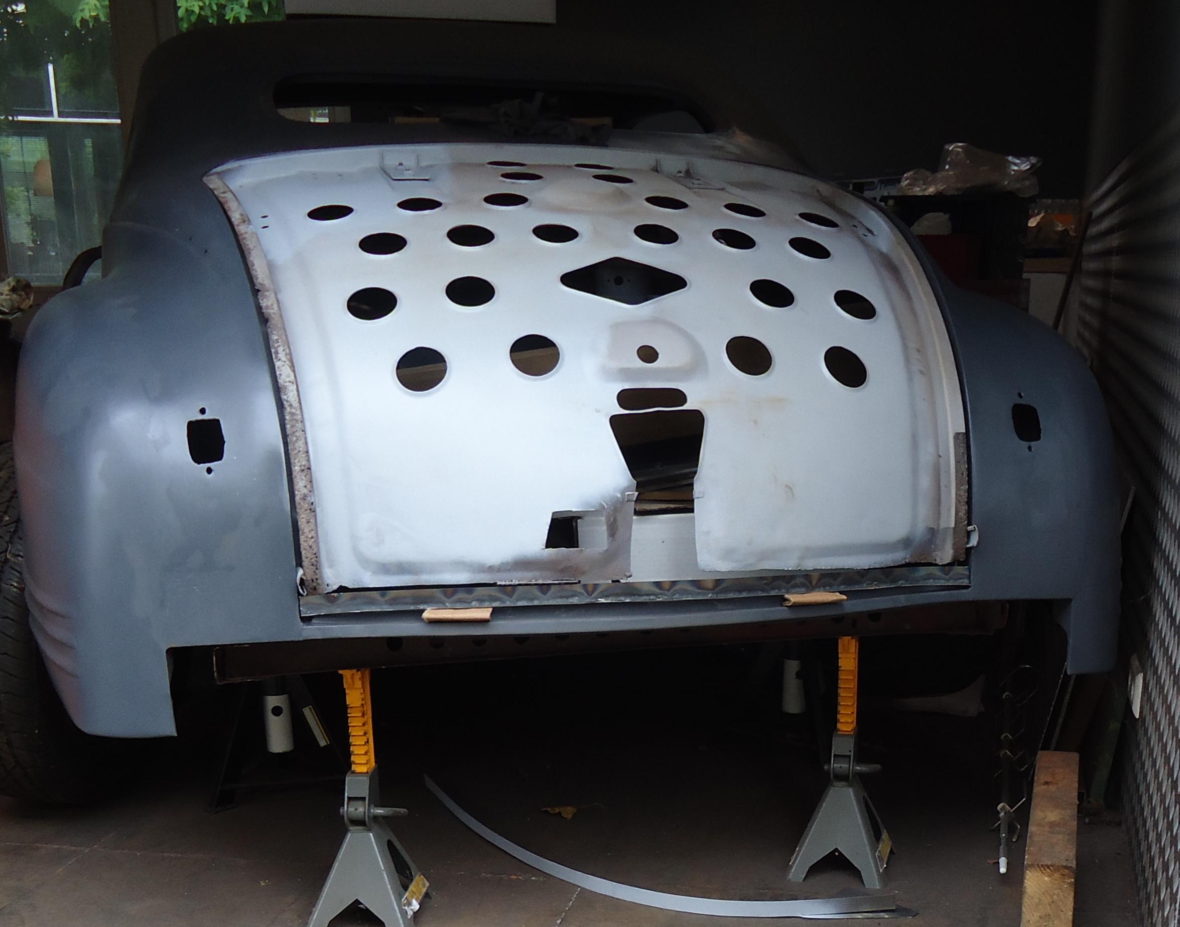

    Fabricated the first part of the bottom of the inner deck lid. I still need to tweek it slightly to get the right form. (it's just resting on pieces of cardboard at the moment so you get the idea.). The difficult part is going to be : how to join it to the inner deck lid in order for the outer shell to fit properly. What fun.:D:D:D

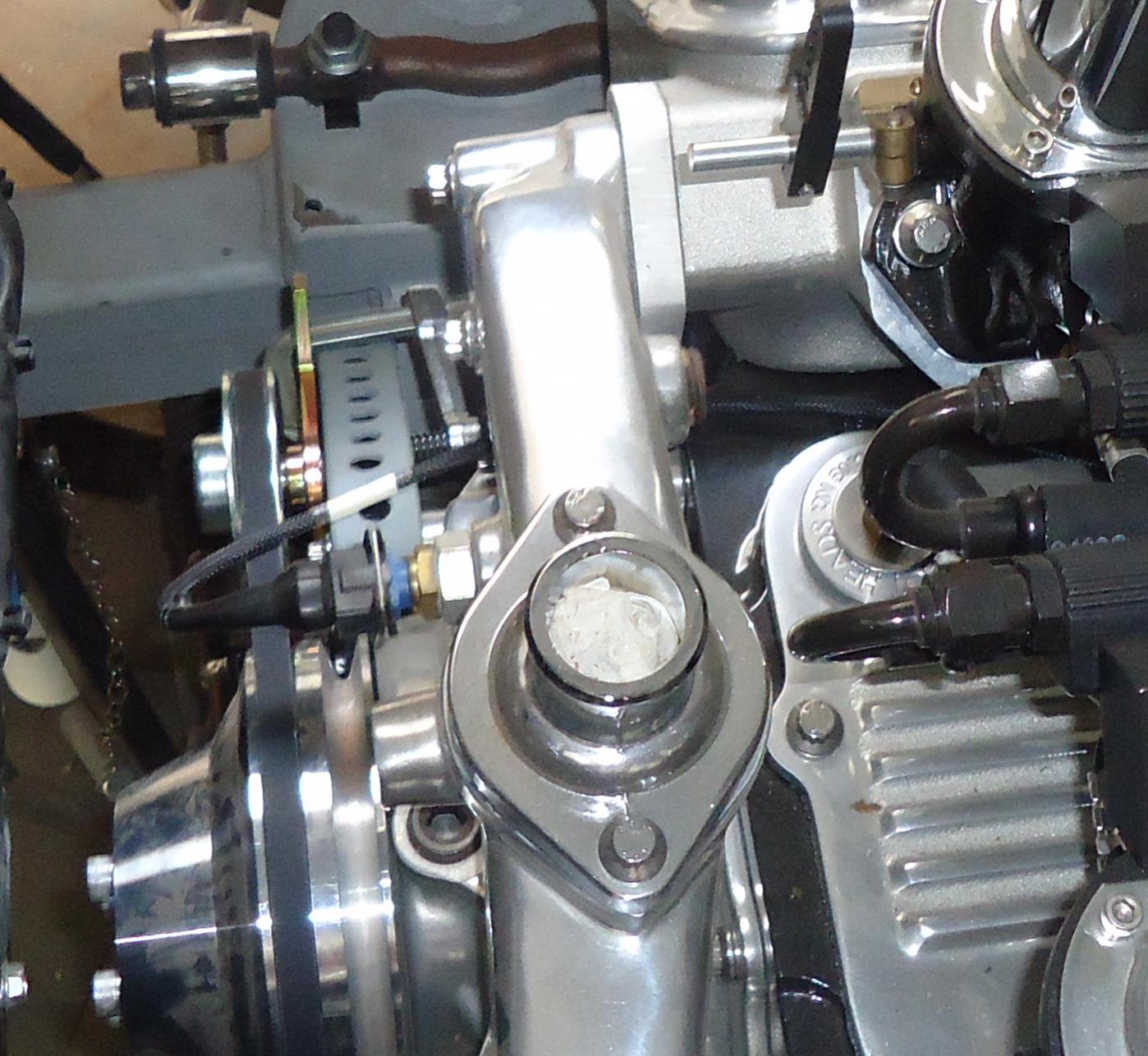

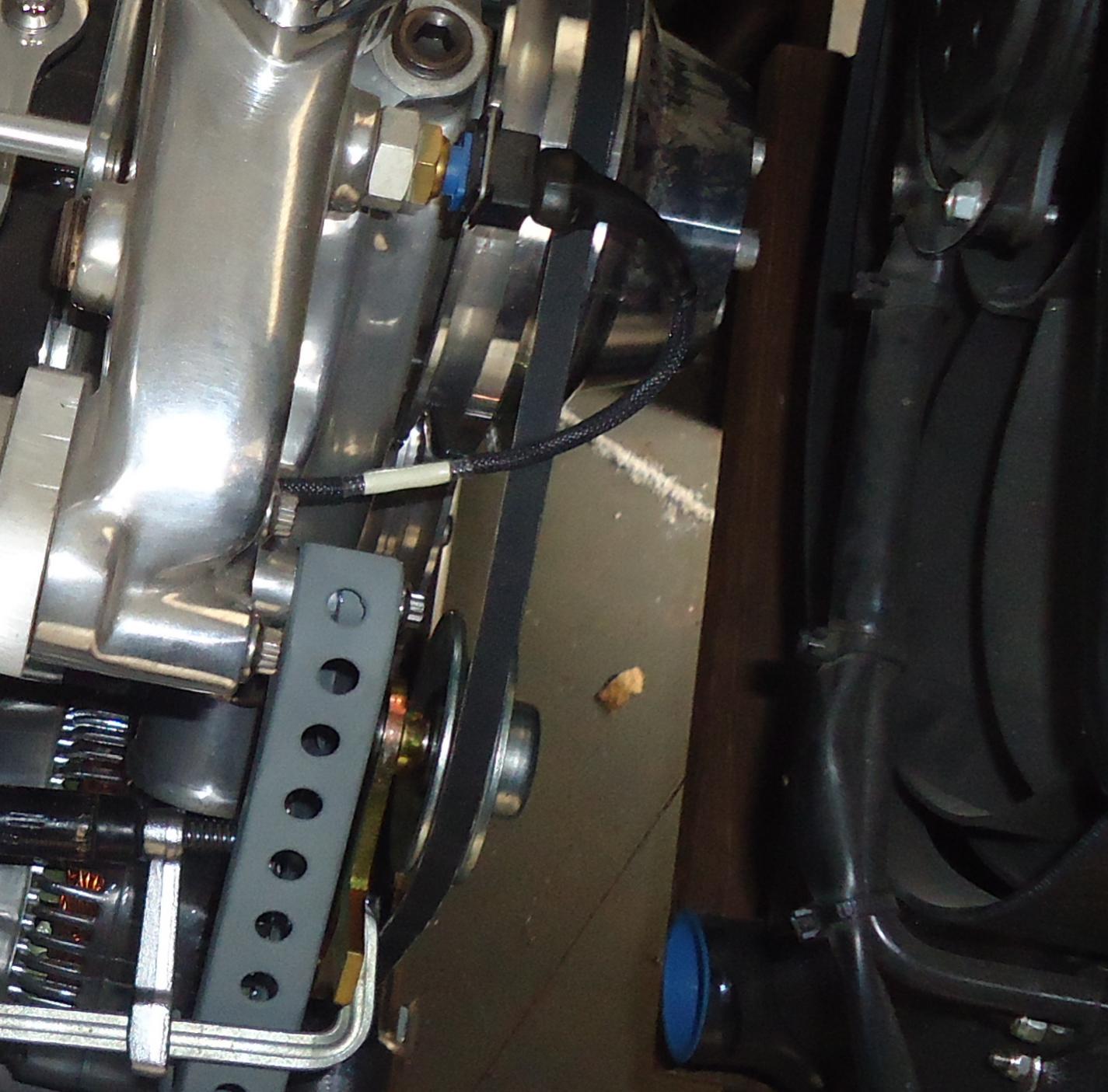

    Yes, finally found a belt tensioner that will (probably) work on my engine. It originally belongs on Citroen models (years ago) and it's NOS! Picking it up tomorrow!

    I can recall that you had limited space between the electric fan and the waterpump, this may just be the solution. love your work.

    Thank you speed v8. According to my measurements it should fit......I'll know for sure tomorrow when I pick up the tensioner.:D

    I picked up the tensioner today and it will work just fine! I just clamped it in place for the time being, as I can't drill and mount until the radiator is out of the way. I'll need to fine tune the set up once I have the engine back on the stand. Also managed to buy a correct length v-belt. :D

    Thats a neat unit Eric, do you know what model it came from ??? Might need one also

    Thanks Steve. It's from a Citroen BX. There is a left and right model. OEM 96034825 and OEM 95590353. If you can't find it using these numbers, I can order one for you, no probs.
