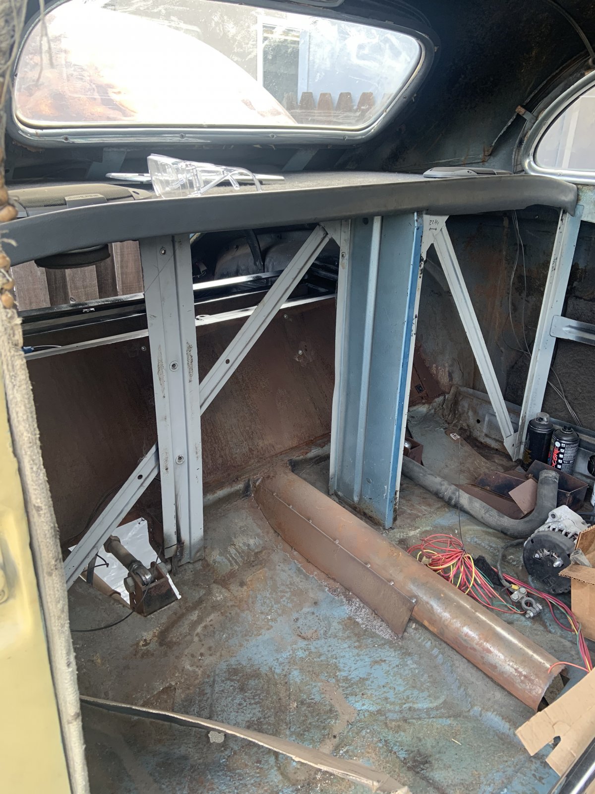

    Working on a 41 Plymouth coupe special deluxe. I’m curious, if by looking at the attached picture, anyone can tell me if this was an opera coupe or business coupe. If there is a difference ( I am new to this model of car). Also is the bracing pictured structural or could be removed without messing up the cars integrity. Has anyone encountered this before and what did you do?

    As far as I know, the opera coupe designation only referred to the rear seating arrangement; opera coupes had 2 center-facing jumpseats but the car was the same. I can’t tell what your car may have been originally. As for the bracing, I would leave it (or replace it with something you like better), but I believe that there needs to be some kind of stiffening/diagonal bracing for the rear of the car.

  3. Can’t help you with your question of coupe or opts coupe.
    but that bracing does not look factory , I would get a service manual and confirm what is supposed to be back there and how .

    The business coupe had a very large trunk compartment. The opera coupe had fold down jump seats that faced one another and a smaller trunk area. You should be able to tell which it is by measuring from the trunk braces to the front seat rear mount bolt holes. Business coupe only had a small package shelf behind the front seat and no quarter widow, if memory serves.

    That be a business coupe! I've never heard of it being called an opera coupe. Maybe on a more "high end" car but not a Plymouth. Opera sounds so fancy.
    All of that bracing looks factory to me, the spare tire would have been behind the p***enger seat.
    If you had to remove any of it I'd say take the two uprights out but leave the two diagonal braces alone with the package tray. It looks like the one upright is getting too friendly with one of your 4 link bars .

    The centre brace doesn’t look right to me as Vandenplas mentioned. I believe the business coupe did not have centre bracing as there was a throughway from the trunk to the interior which would allow larger samples to be hauled around on the salesman’s travels.

    Thats the way it was made . Ive got a Chrysler windsor 3 window, 1941 . Id remove it all and replace with some tubing, going from one side up to the package shelf and over to the other side and down to the frame . If not leave it you need support for the twisting the body and gl*** go through.

    Note how far forward the rear package tray comes on the car that Samurai Mike posted, the OP's tray doesn't extend as far forward from what I can see, I think the OP has a club coupe (or opera coupe, that's more semantics), business coupe has no back seat. There was no 3W coupe Plymouth in 1941 and no long door/short door coupe either, the outer body was all the same, the only difference was the length of the package tray and inclusion or exclusion of any kind of back seating, as far as I can tell.

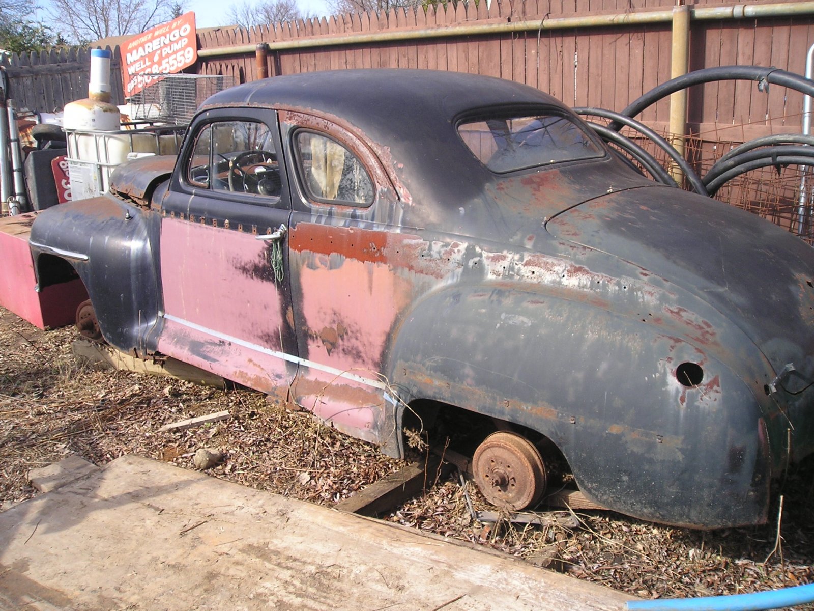

    The Standard book of Chrysler 1924-1990 only shows a business coupe or a club coupe. I suspect the Opera Coupe was probably a club coupe with the sideways mounted seats.
    The roof line at the top of the rear window on a business coupe was 2"-3" lower then the top of the rear window on a club coupe, so the roof lines on a business coupe were more sleek then the club coupe. The rear gl*** on a club coupe is more vertical then the rear gl*** on a business coupe.
    By looking at the pictures of your bracing compared to the bracing in the picture Samurai Mike posted, the package shelf on your car only comes forward to about 1/2 of the side window, but the package shelf on Mike's car comes to the front of the side window, and it appears the rear gl*** on your car is more vertical. The OP has a club coupe, Mike has a business coupe.
    With the 46-48 Plymouth coupes, the business rear gl*** is a flat gl***, but the club coupe gl*** is a curved gl***. There is also a distinct body line between the roof and the trunk that does not exist on a business coupe. This body line is the easiest way to distinguish between the business coupe and a club coupe.
    This 1st picture of my 48 Plymouth business coupe clearly shows the missing body line.
    The 2nd picture shows most of the panel (the plywood was about cut in half on the right side of the picture to get it out of the car before my time) that sat at at the front edge of the package shelf on my coupe. On the right side (of the picture, but the driver side of the car) the spare tire was bolted to a cut off bracket, the shelving was on the p***enger side of the car. Gene

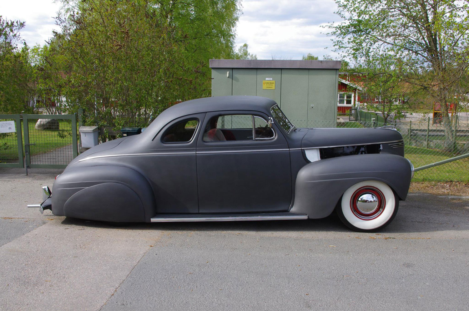

    My previous -40 business coupe modified with a rear seat from a Volvo Amazon. Unfortunately I have no interior photos.

    Yeah that’s what I was thinking. I may redesign it and move it back some to create more room behind the front seat. Thanks!
