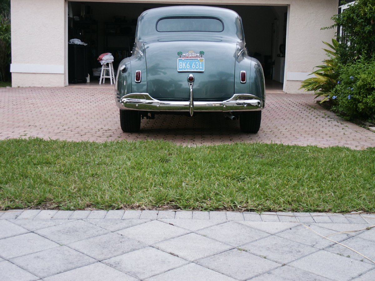

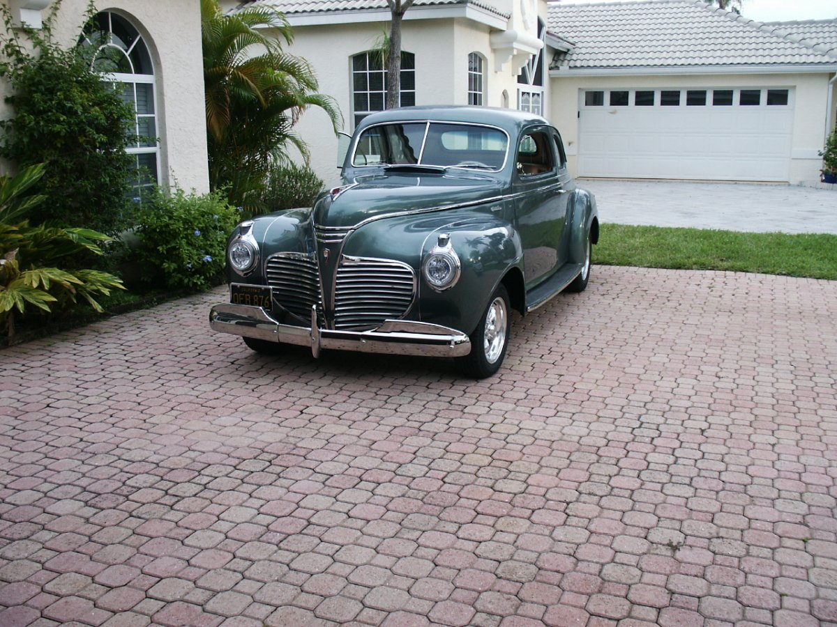

    PICT0001.JPG PICT0001.JPG PICT0001.JPG 4.JPG 6.JPG 8.JPG 21.JPG PICT0001.JPG 4.JPG 6.JPG 8.JPG 21.JPG PICT0001.JPG 4.JPG 6.JPG 8.JPG 21.JPG PICT0001.JPG 4.JPG 6.JPG 8.JPG 21.JPG

    I used American Racing Torque Thrust Wheels; rear 16 x 7, 5 x 4.5 Ford bolt pattern, 4" backspace, with Goodyear 215 x 65R tires (could probably go to 225/65R); front 15 x 6, 5 x 4.5 Ford bolt pattern, 3.25" backspace. I t gives the car a much cleaner stance and look. Also gets rid of the bicycle tire look of the original 16" x 4" tires
    The locating stud can almost remain intact or trimmed down slightly as there is room for it to fit in the spoke pocket (you'll likely want to keep it to accommodate the stock spare tire). The wheel hole is larger than stock so I used concentric locating spacers from US Wheel adapters, Inc. out of Lubbock, TX. They have plastic and aluminum and can be made to custom sizes. I used custom aluminum spacers sized to 83.06 x 71.44 mm and they were a perfect fit. Because the wheels use lug nuts instead of lug bolts I could not find left hand lug nuts for the wheels. I could not find anyone able or willing to drill and refit the drums to wheel studs either so I simply purchased two more right hand brake drums; problem solved. You can likely sell the replaced left had drums for more than the right hand drums cost.
    Andy Bernbaum's out of Needham, MA is still a good source for most all needed Plymouth parts.
