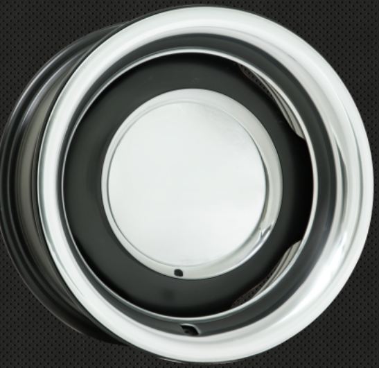

    I've thought about both of these - not sure what color though (maybe dark silver...??)
    I think I like the color it is now....it'll stay that way for awhile.

    Like those with the bigger trim ring and darker color. Red is sharp...but its very common now it seems. Your car will look good no matter what you choose, but that top one with a dark silver / charcoal would set it apart.

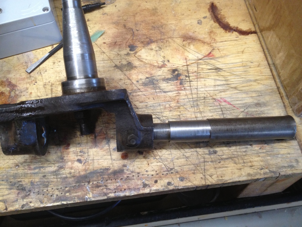

    After not being able to find a machine shop to do my spindles, I headed down to the old man's shop (radconjon on here). After fooling around for a half hour trying - with no luck - to get the old bushings out, we decided to make a tool.
    As you can see, we turned down a piece of bar stock machining two shoulders - smallest diameter matched bushing inner diameter, middle step matched bushing OD. Worked for removing as well as pressing in new bushings - remember to line up your grease holes!!
    Now to find a reamer....
