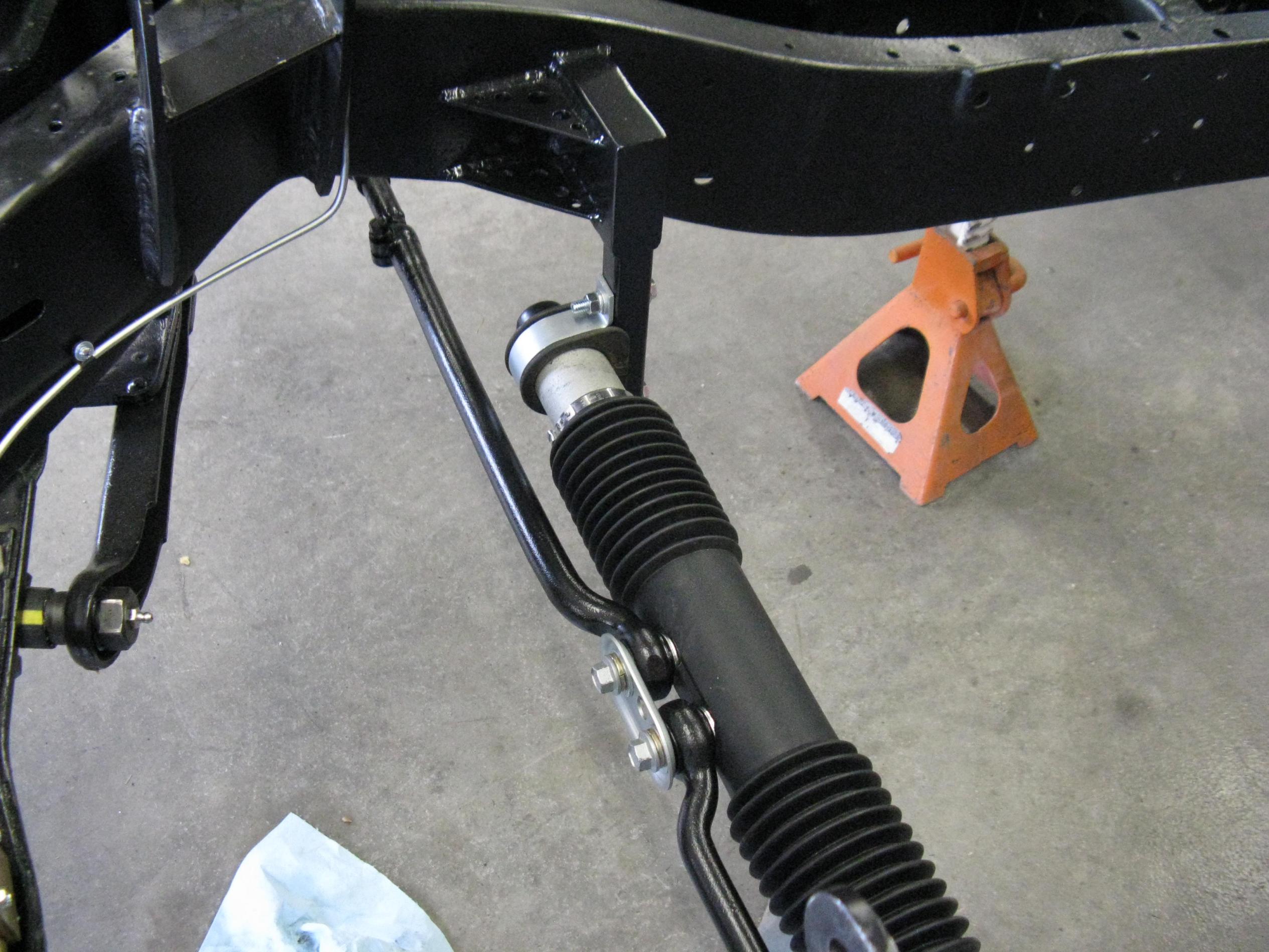

    Do you have any pic's of the front sway bar installed?

    I'll post some pics of the sway bar installed in a few weeks. I mocked it up and then took it off. No pics.

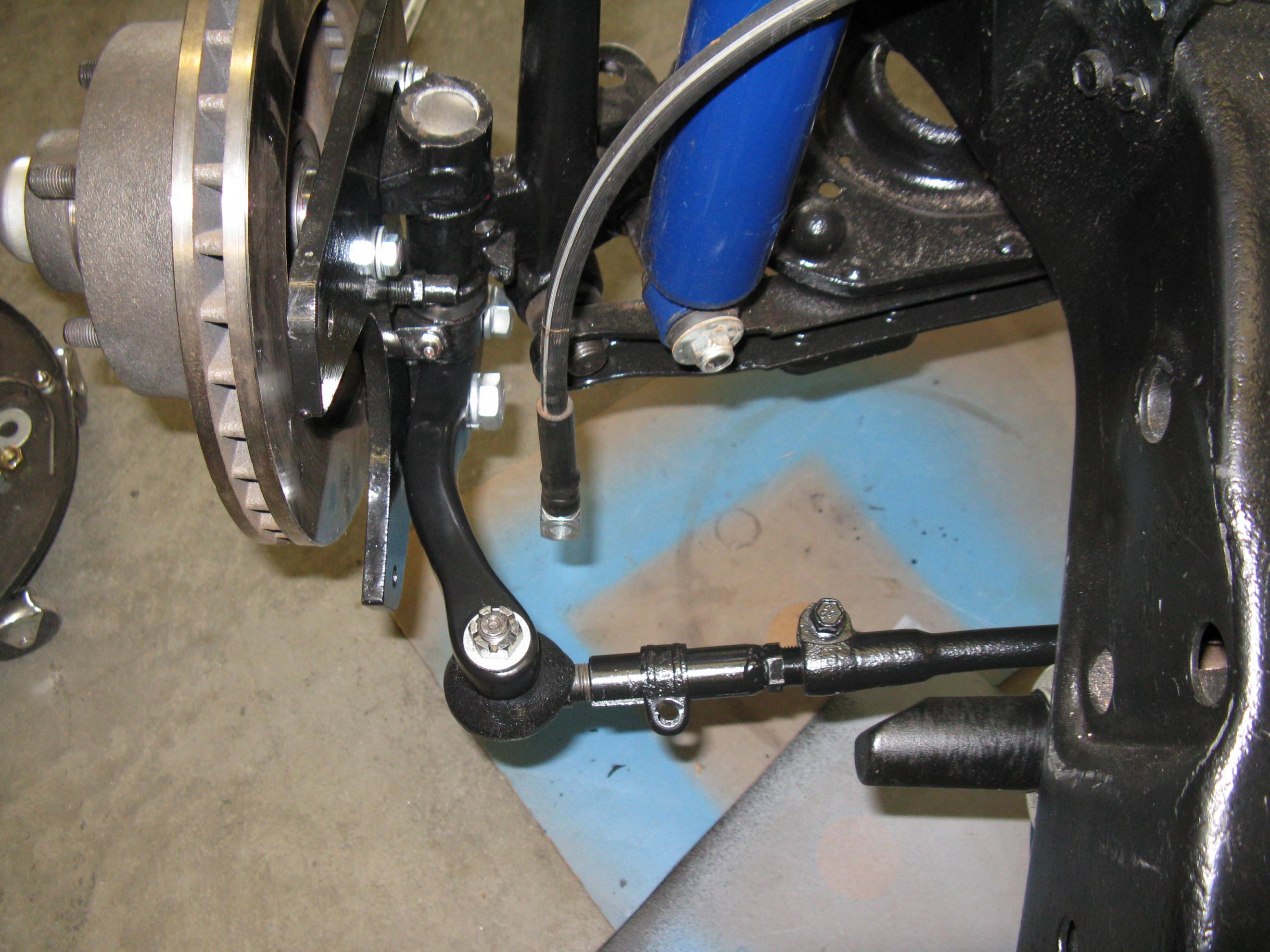

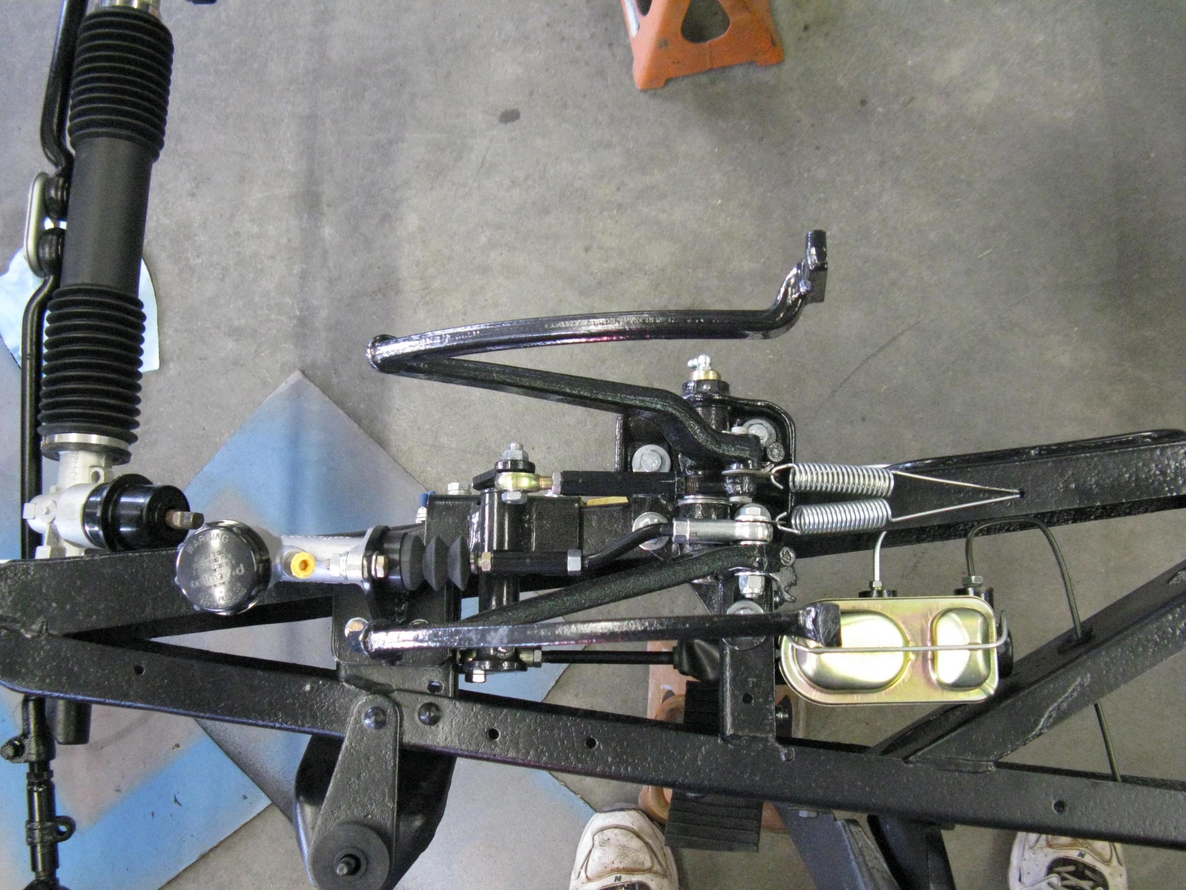

    Ok. I worked hard yesterday and today. Yesterday, I re-assembled all the painted pieces onto my chassis. Today, I put the body back on - by myself - in about 2 hours. Most of that time was dismantling the roller hoops that allow me to turn the body over. Here are some pictures.
    I only had one issue. My rearmost muffler mounts will not work and I had to cut them off. I'll have to figure out another mount after I get the exhaust on. That will come later.

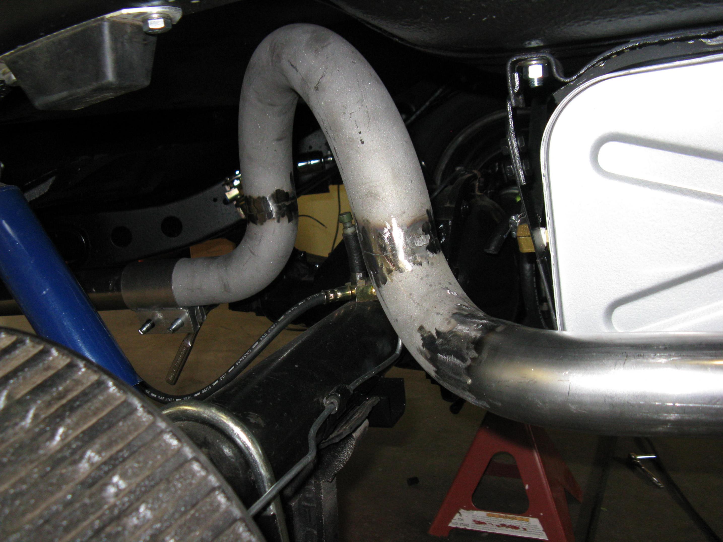

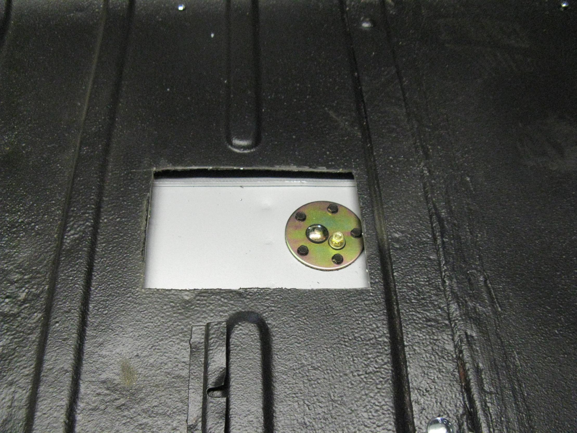

    I have been really concerned about how I was going to route my exhaust. A buddy, Randall Yow, came over this afternoon. I had the gas tank installed in the original location and was commenting on the problem I was going to have routing my exhaust. He said, "Why don't you just move the tank over about 3"?" I said, "Because the sending unit comes out over this hole." He said, "Well, move the hole over 3"." DUH!!
    Long story short, I did some checking and sure enough I can make this work. After at test fit, I got out the die grinder with the cutoff disc and opened up the hole into a rectangle. I'll have to make a new cover but it's an easy piece to make. I now have about 4" of space down the left side of the tank that will allow me to have my exhausts symmetrical and run out the rear. Just what I wanted.
    I also mounted my fuel pump and routed the plumbing to it. I put the fuel pump on the PS and am running the plumbing down that side. This is opposite from the OE side but away from the brakes, clutch, etc. This also happens to be the side the carb connection is on.

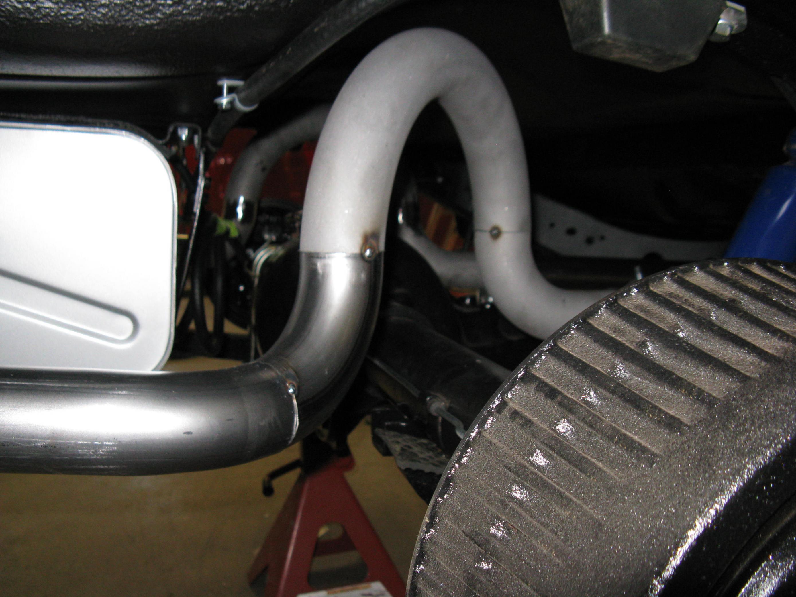

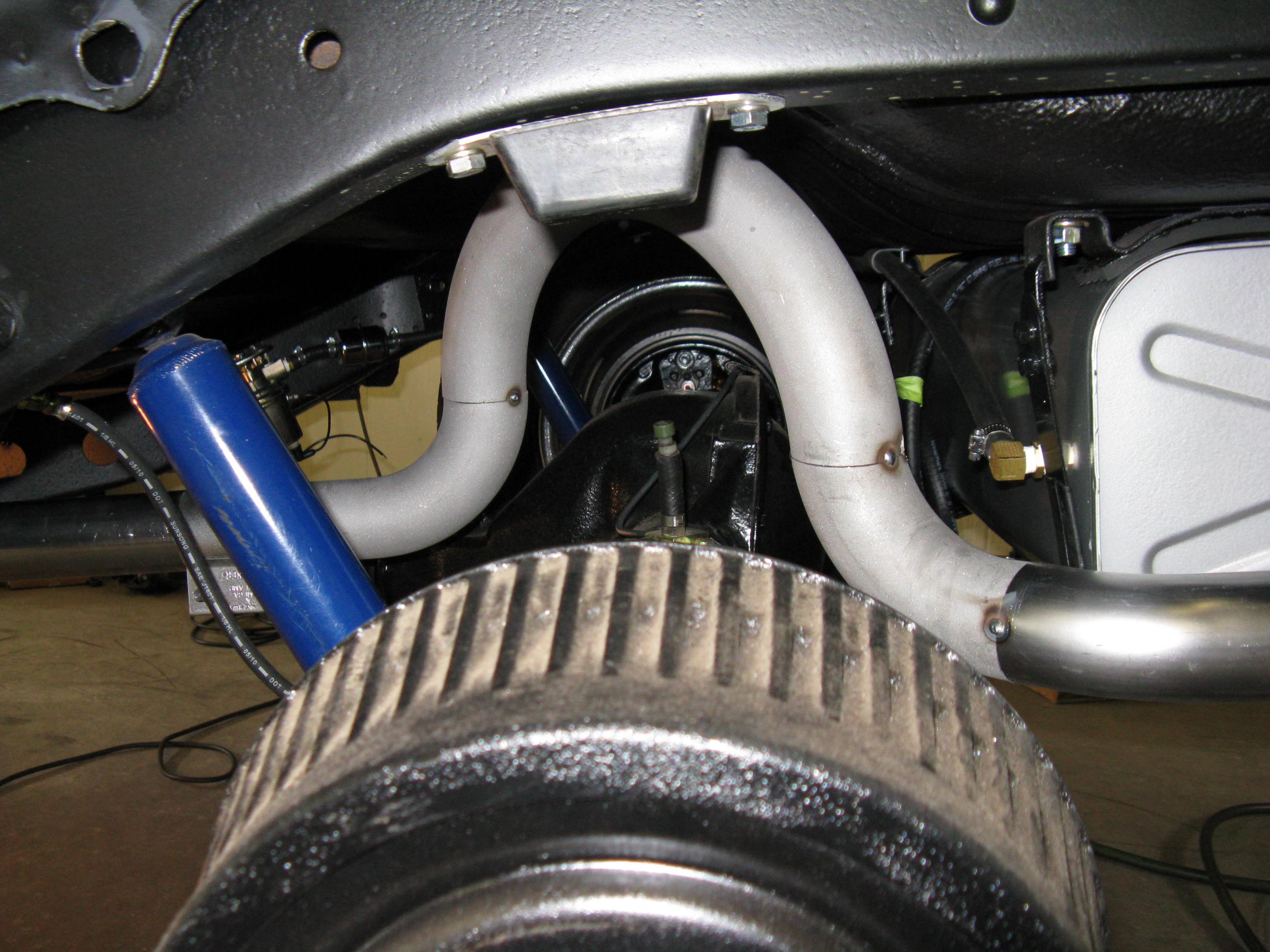

    And..........I got the rest of my exhaust fitted up. It really wasn't that hard..........or I'm getting better at this. The exhaust exits symmetrically on each side. The DS has to be trimmed a couple inches after I remove it. I have about an inch clearance all the way around it in the tight areas.
    Here are pictures that show the DS. I'll post PS pictures, too.

    The PS is tacked up. All I have to do is remove it, weld it and grind the welds. All in all, I'm really happy with the way this turned out. I'll probably put some SS or Chrome tips on them to finish it off.
    The Walker band clamps work well for this because they allow you to twist the exhaust a little when you need to. You also can cheat the length a little, too. I'm pretty glad I decided to use these.
    Also, I used the Red Snapper type mounts for my exhausts. I've still got to add another one between the rear axle and the rear of the muffler but that's a piece of cake.
