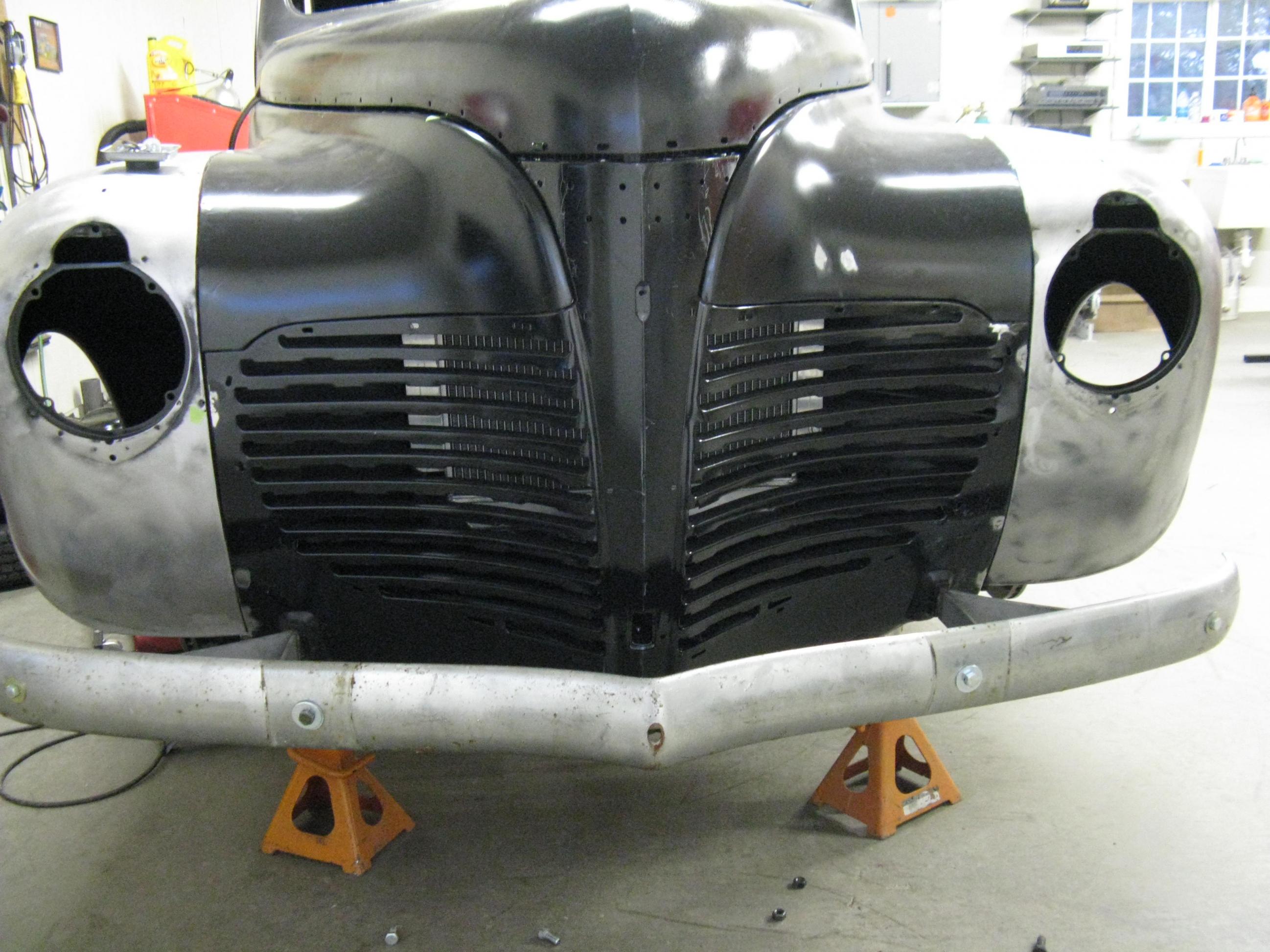

    Woo Hoo! It's looking like a car again! I got the running boards put on am modifying the underneath braces to make sure they support the boards properly.
    Also, I have installed the front bumper. It is a 41 Dodge bumper and the mounts had it sitting about 12" away from the body. The Dodge had a tray that went on top of the mounts between the bumper and the body. i shortened up the mounts and made it sit about 4" away from the body. I like the "pointed" bumper. I think it works well with the car. What do y'all think?
    (I'm excited now but I know I'll be disassembling stuff again soon. First, you have to make sure it all fits before you paint. Otherwise, you've got a mess on your hands. This all fits pretty well.)
    I forgot to give props to Dan Babb (aka Danbabb) for coming by and helping me get the hood installed. Thanks, Dan!

    looks good rockable. my 40 front bumper is like that one. I like it moved closer like that, looks alot better than stock.

    Thanks, Plow! My buddy wants me to make a tray and put it on top. What do you guys think?

    I think it would look awkward in my opinion. I think it looks better closer(like you have it) and without the pan. Look how 40 fords are, the grille flows down like your plymouth, it would disrupt the look of the grille if a pan was put in.

    I agree. I may trim the curved tips off, however.
