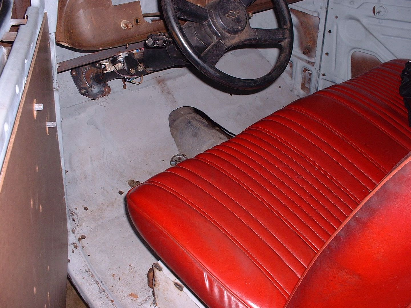

    Here are a couple of pictures with a better angle view of the steering column.
    My next challenge will be to free up some space that is occupied by the cowl vent linkage for my A/C. Anyone got any ideas?

    Darn. I worked two days this weekend and don't feel that I accomplished much. I did a lot of head scratching and planning, however. I guess that counts for something.
    I cut out some plywood and Experimented with different cushions I had around and tried to decide if I could make the original seat work. I don't feel good about it. So, I'm ruling that out. I see the potential for an expensive mistake. Also, I have a nice set of bucket seats out of a late model car but they don't look right.
    I don't want minivan seats in my car. That's just me. So, I'm going to look at Tea's and others and try to come up with a bench seat that is both comfortable and looks right with the restorod look I'm shooting for.
    While I was playing carpenter, I cut out the plywood for my rear bulkhead. I also screwed around with my trunk lid hinges and planning my AC install. I also came up with a simple and obscure way to unlock my doors, should the electric lock fail me. More on that after I get it installed.

    1979 Buick Lesabre front seat, fits perfectly.
    Here is the pick of what I have in mine:

    ****! I forgot that I posted that the other day. I don't have any pictures of my seat, and my car is in a million pieces over at ElPolako's shop getteing retweeked after some accident damage. But it doesn't look "mini vanny" in any way shape or form. Plain yes, but not mini van roundy shaped. I will eventually will trim it in a simple pleat design with some sort of body cloth inserts and vinyl outers. No vinyl in Phoenix - on a 118 degree day you don't just stick to it with sweat, you bond to it like a frying pan!
