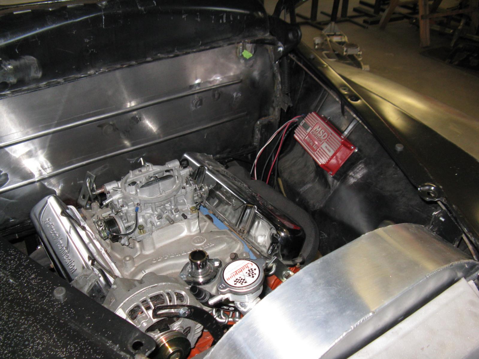

    Here you go. As you can see, this is about in line with the deepest bulge in the OEM firewall. Distributor clears.

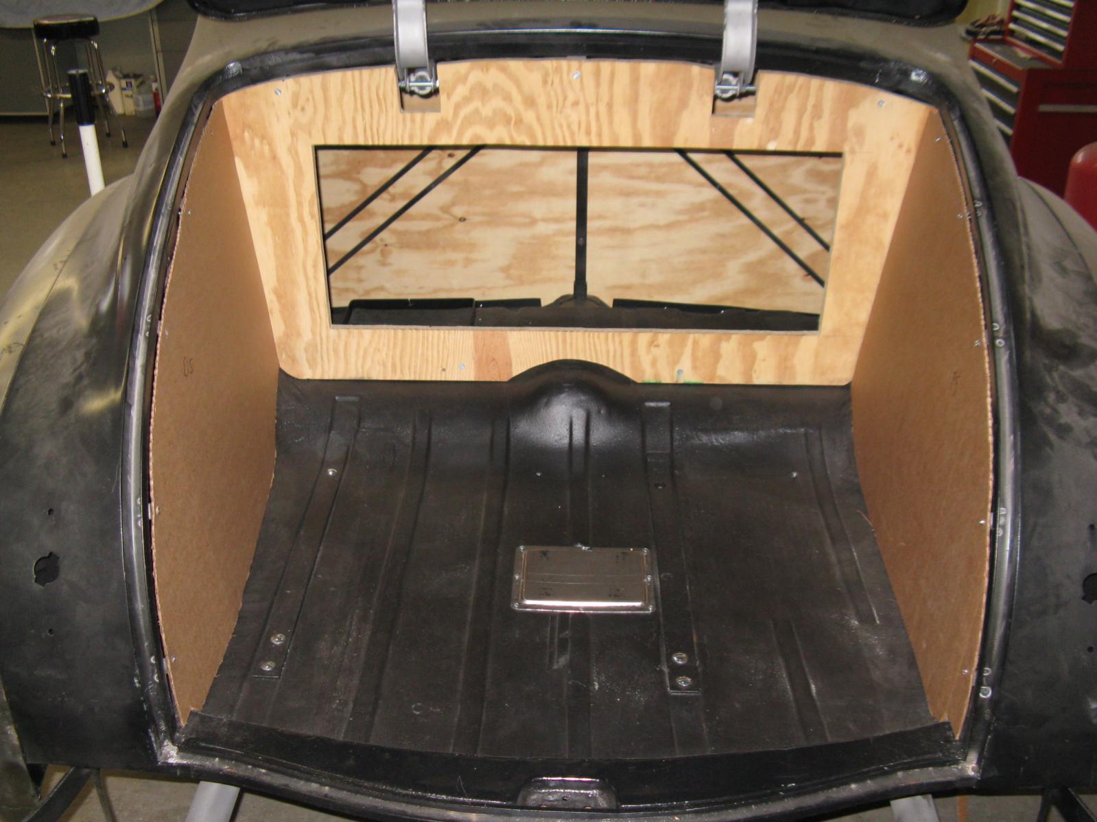

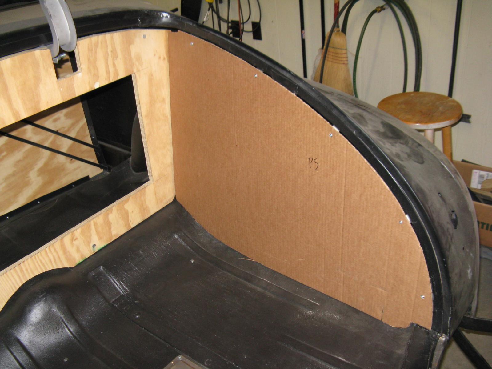

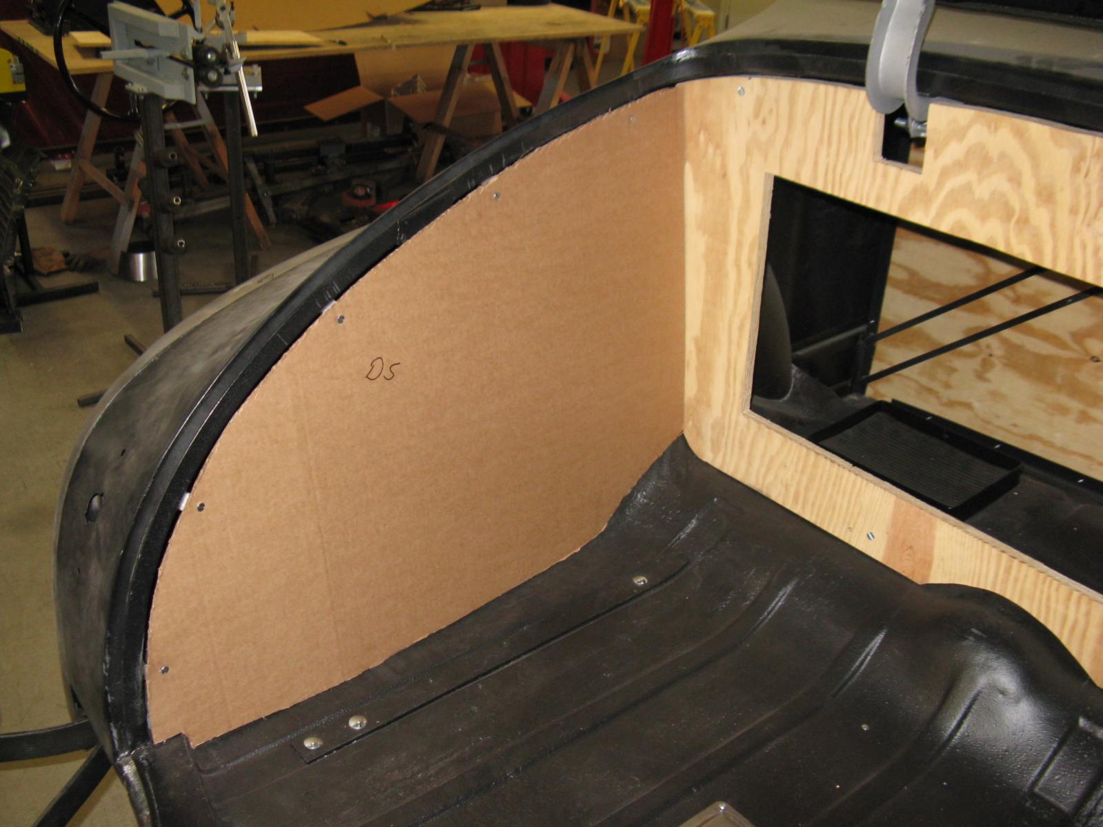

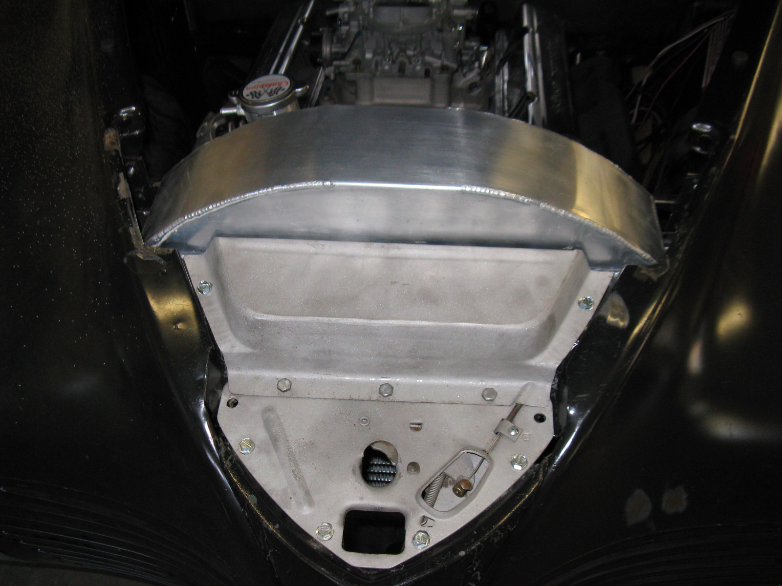

    One day a metalsmith, the next day a carpenter. I decided to build the bulkhead for my trunk, weld in the tabs for the side panels and make the patterns. This will save the upholster a bunch of time and, hopefully, save me a bunch of money.
    I still have lots of room between the ****pit bulkhead and the trunk bulkhead for the spare tire, tool bag, folding chairs, battery, moonshine, etc. I'll fit the door with slip hinges, so that it can be easily removed. It's probably going to be a female dog to get the battery and tire in and out, however. Oh well, it all comes off with 5 screws, after you remove the side panel. Let's see, that's more like 15 screws.......

    This style of dzus fastener and a piano hinge at the bottam......maybe:)

    Nice work Rock! Are you planning on using some sound deadening material behind the side panels?

    Oh yeah.

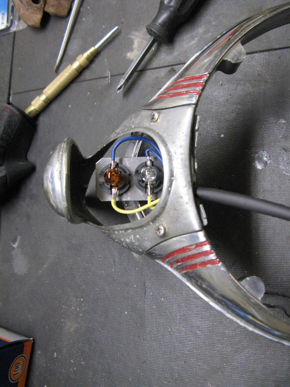

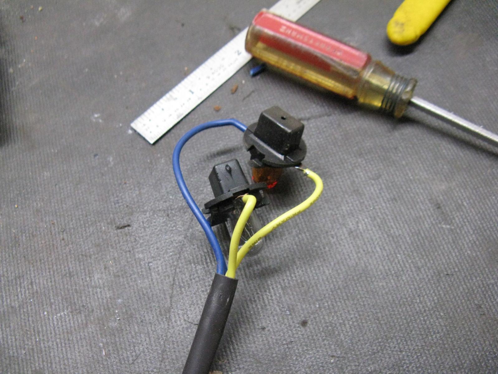

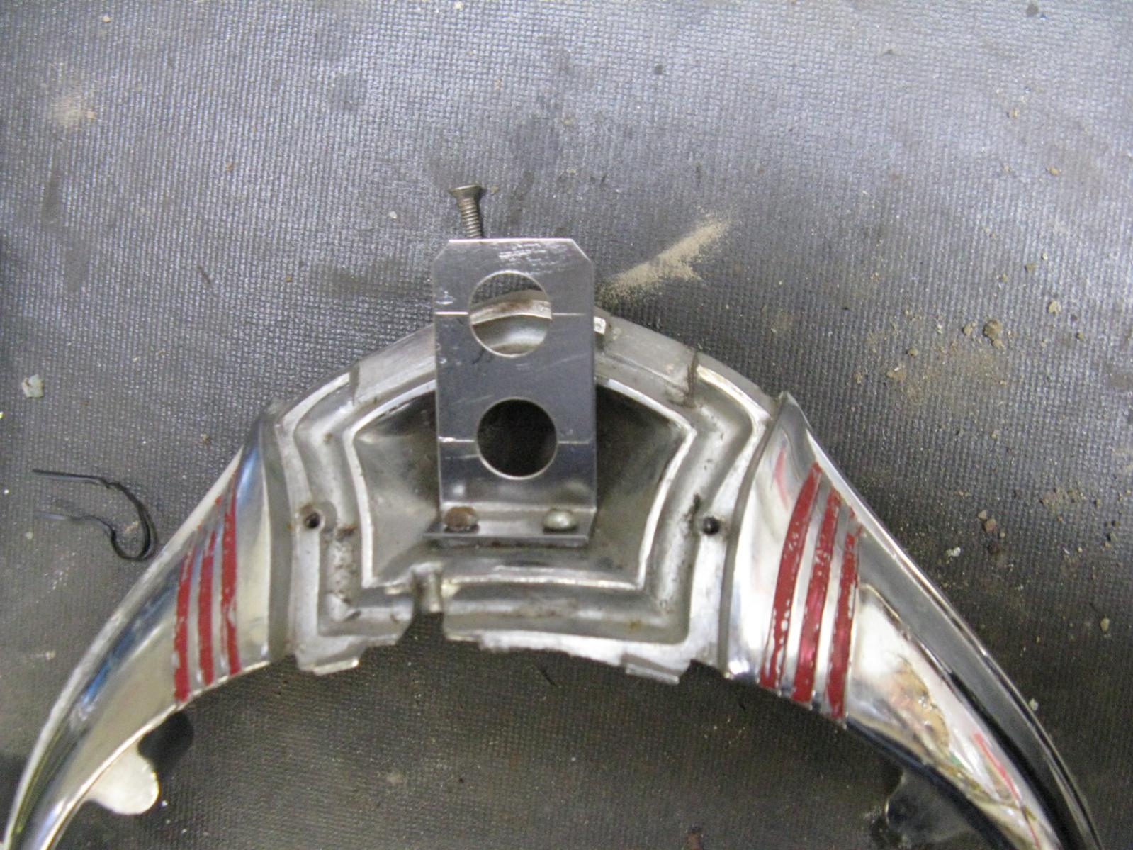

    Well, since I'm relegated to light duty work at this time because of "the boot", I decided to solve a problem that has been bothering me. If you keep up with Farmer12's thread, you know that we've been discussing alternatives for parking lights and front turn signals. Today, I came upwith what I think is a slick solution.
    With a little help from my buddy at O'Reilly's, I came up with some sockets that are designed to twist into a circuit board and that hold a 194 bulb. I chose this one because 194's come in orange and clear. I chose this socket because it is shallow and that is important when trying to squeeze these into the housing that was designed for the parking light only.
    I fabricated a simple bracket from some 18 ga. s****. The plastic housing of the socket will press into a 9/16" hole and will stay there without adhesive. Since the sockets are designed to screw into a circuit board, the terminals are on the front, which is perfect for this installation. I simply soldered leads to the terminals and bunched them together with some shrink tube. This did not take long to make, once I had the pieces.
    Sorry for the fuzzy pictures but you'll get the idea.
    I'm thinking I'll have to add a relay to each parking light to turn it off when the turn signal is switched on.
    For all you traditionalists, these don't twist in but they aren't LED! :)

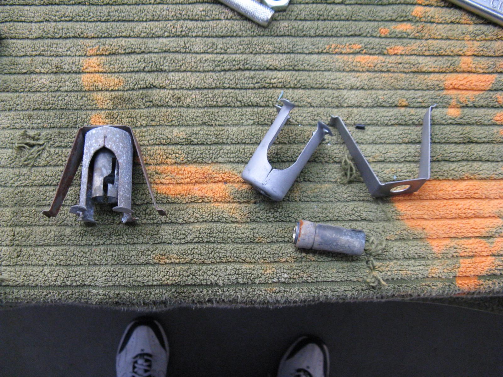

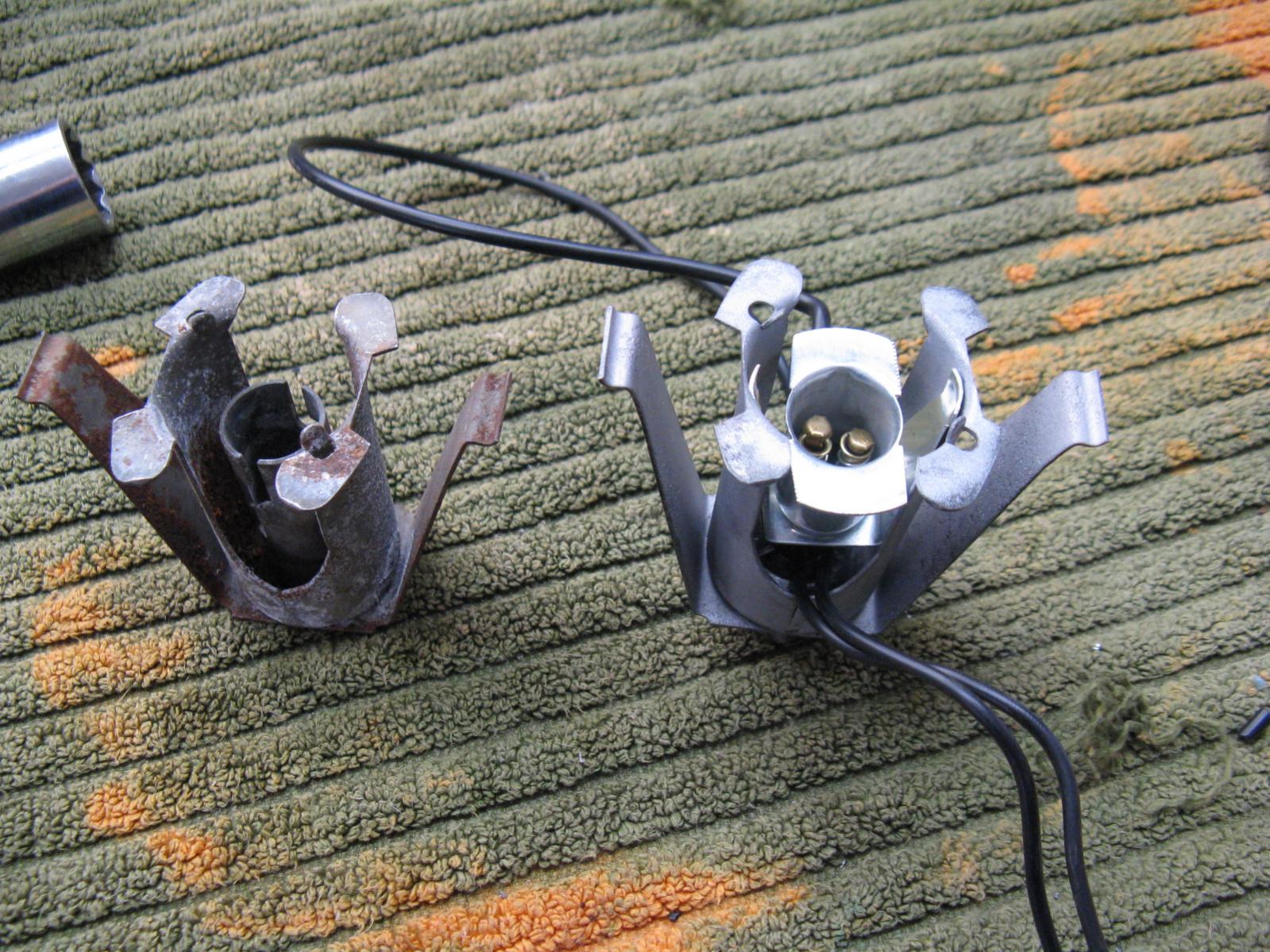

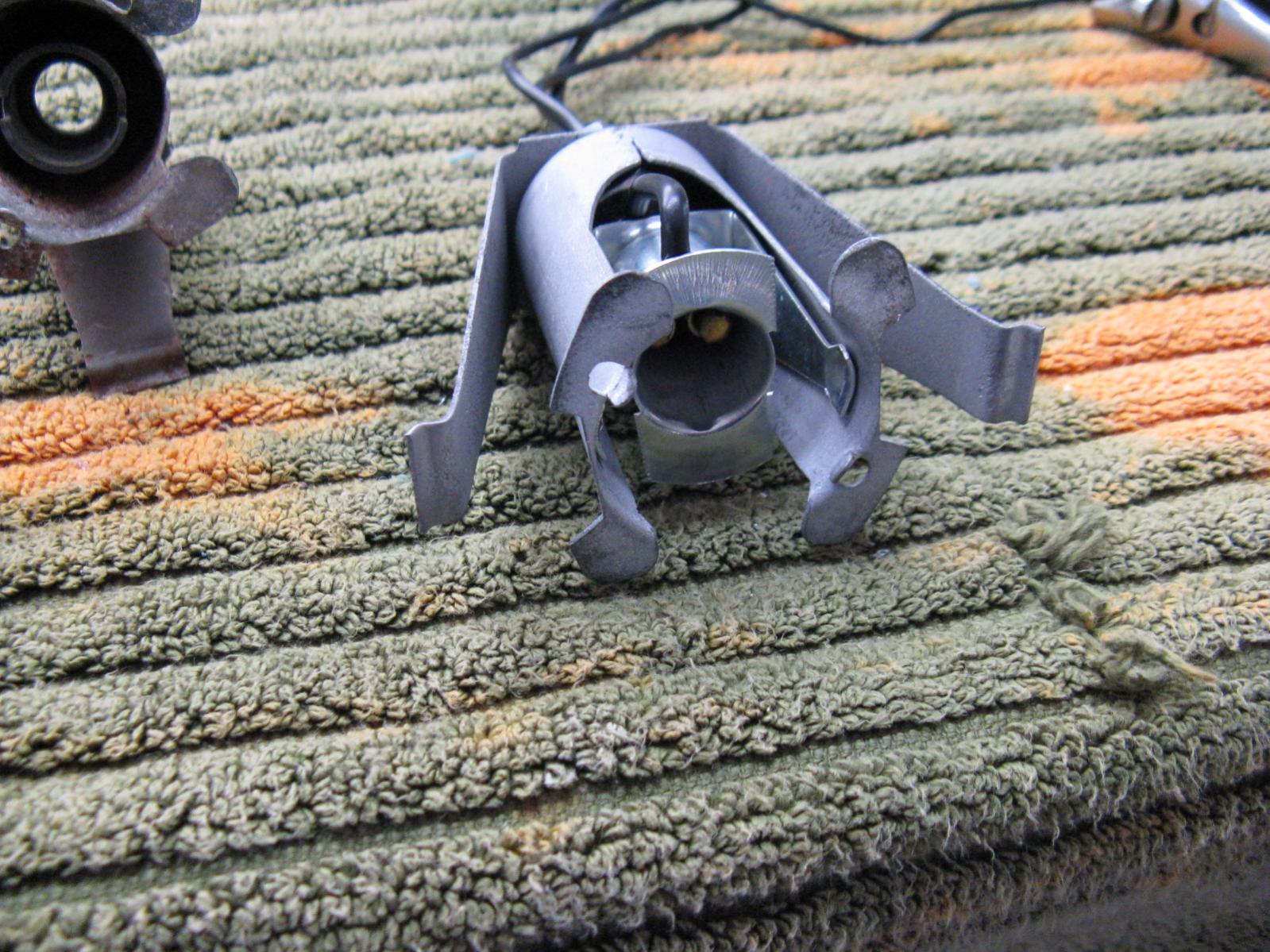

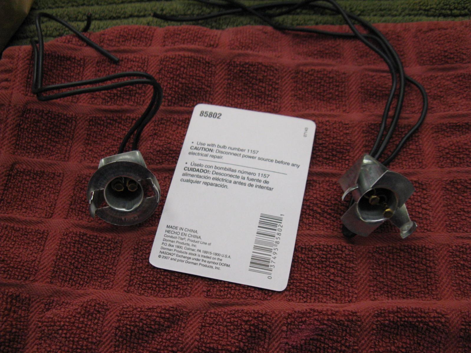

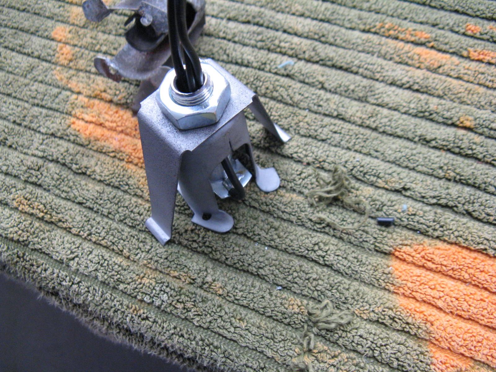

    Worked out the rear brake light/turn signal sockets today. I drilled out the old socket and separated the housings. Then, I took a 9/16" bolt, cut it off and drilled it through with a 3/8" drill for the wires to p*** through.
    I painted the pieces and re***embled them. I modified an 1157 socket as shown and soldered it to the housing. Also, I added a ground wire so I don't have any trouble with flickering lights, etc. It will be grounded to a tab I welded to the trunk lip.
    No rocket science here but it did come out clean. You need a big iron to solder the socket to the housing. I used a 5/16 tip and it was marginal.
    This will clip right into the original hole and use the original lens.
    Also, I fired up the the bulbs for the front lights and the orange looks like it should as a turn signal and the clear bulb is perfect for parking lights.
    PS. Don't try to drill a 9/16" hole through the retaining spring with your favorite step drill if you intend on ever using it again. That steel is HARD! A round file works better. :)
