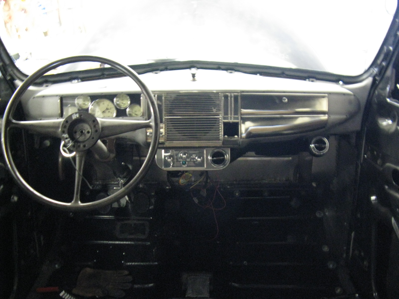

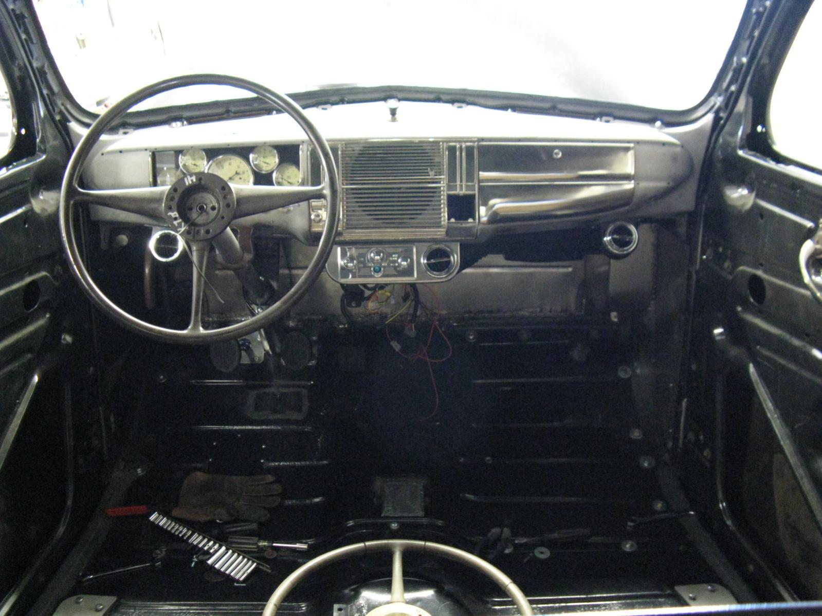

    I finished up the dash and under fitments. Got the wipers, cowl vent operator, AC, all switches, etc. mounted and filled all unnecessary holes. Also, I fabricated a cover to hide the extra u-joint and shaft on my steering column.
    I am going to wood grain the dash and garnish moldings, so I think I will do the glove compartment cover, as well. It looks better in my mind.
    I'm now working on the means to route the wiring into the door for the electric locks and speakers.

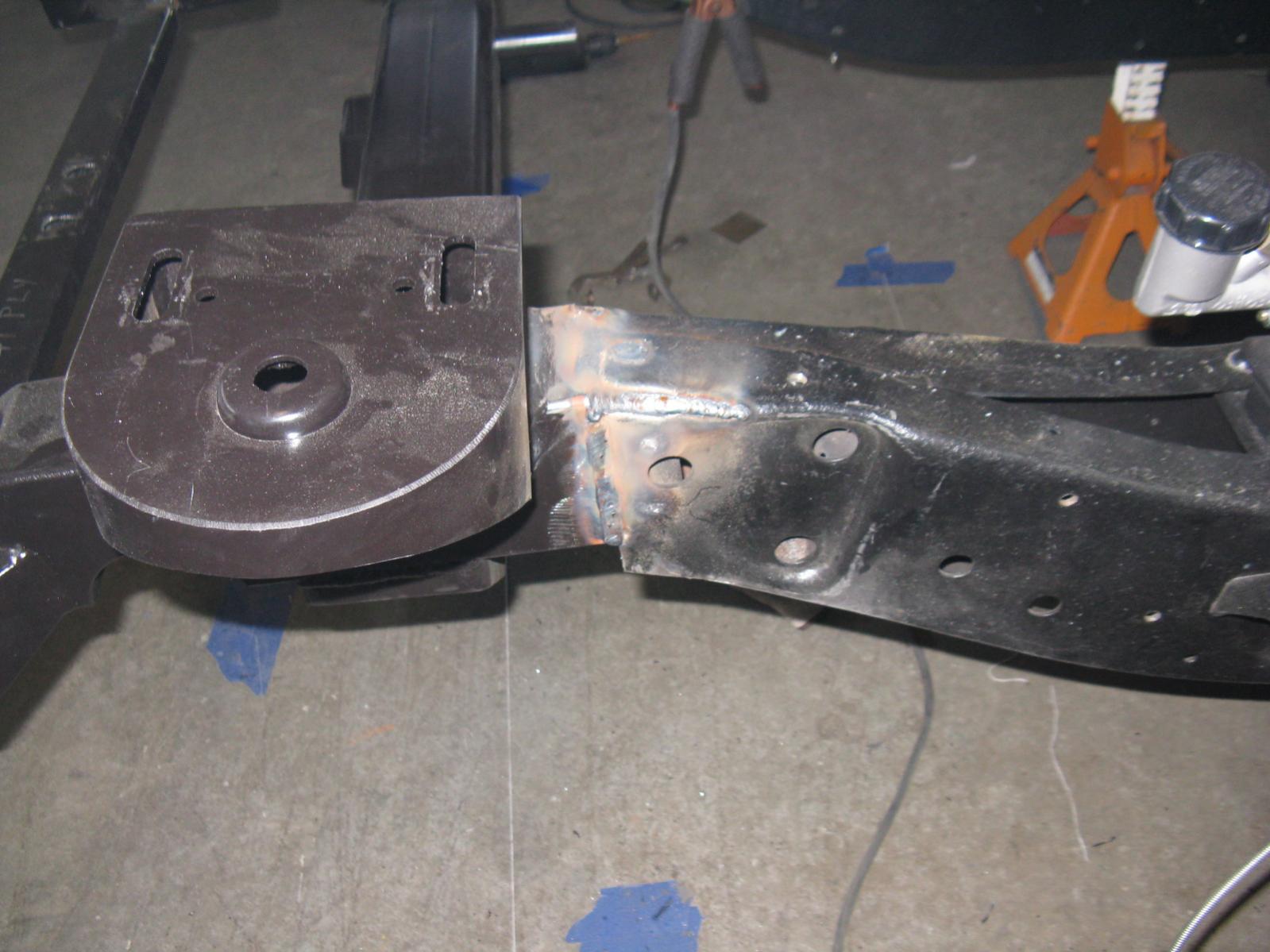

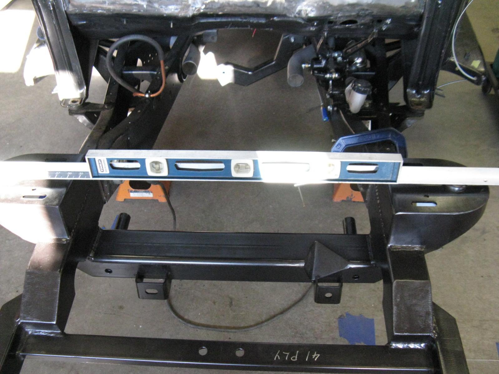

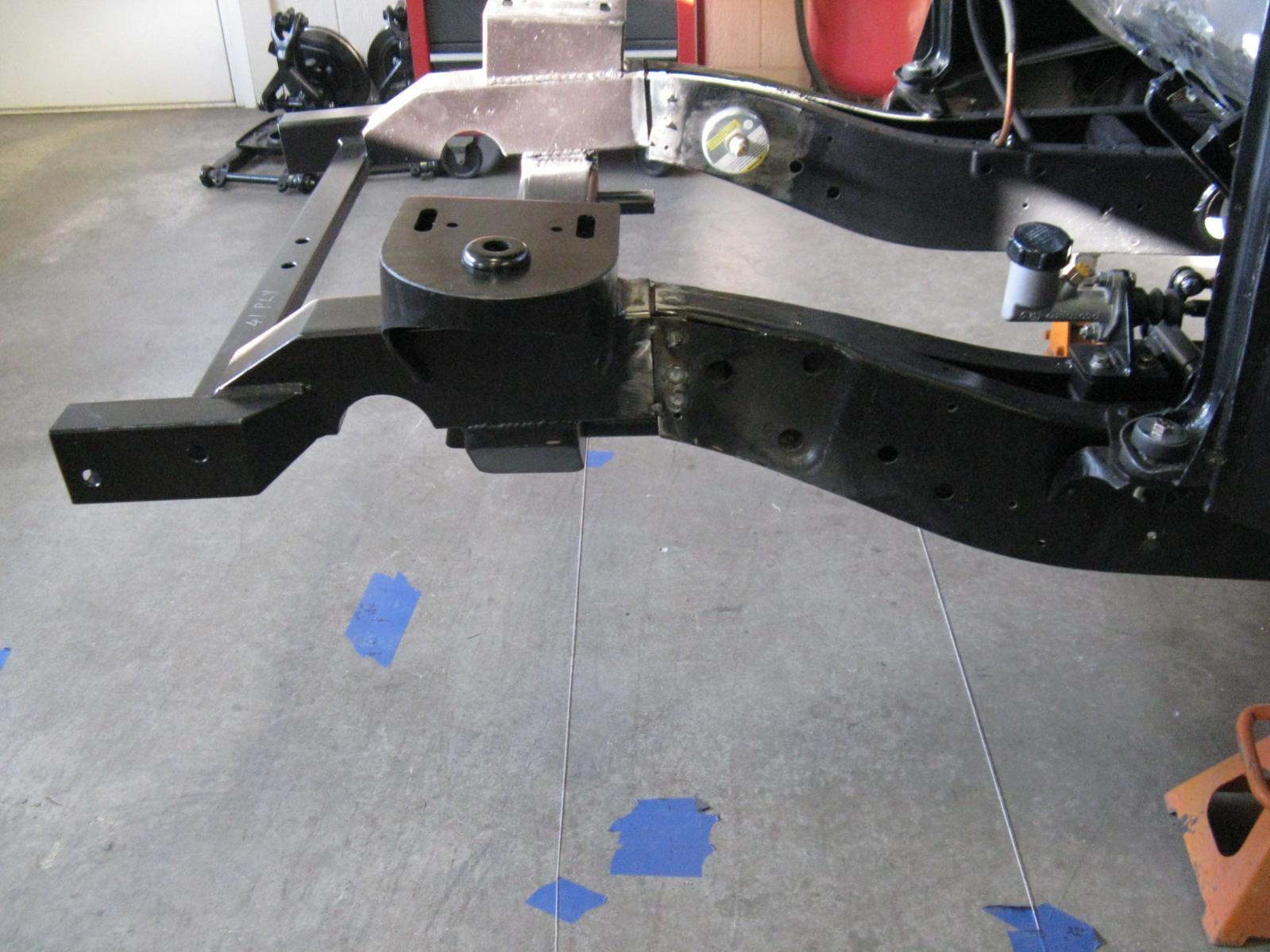

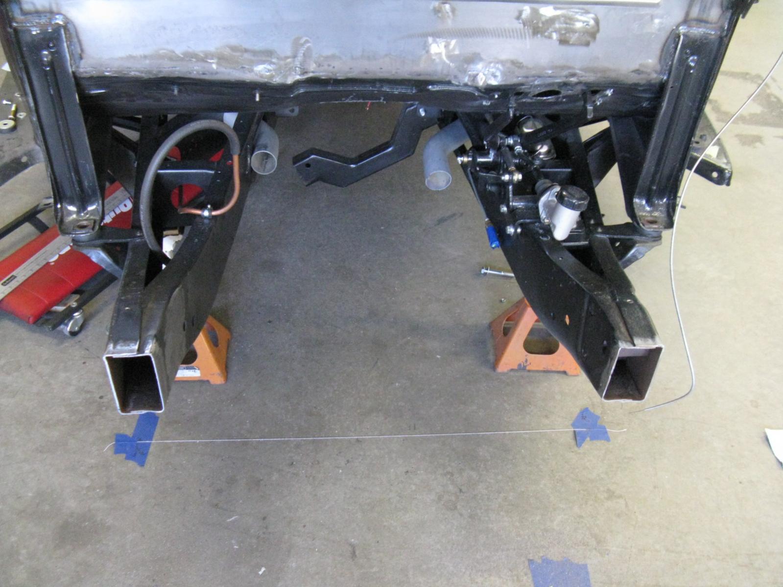

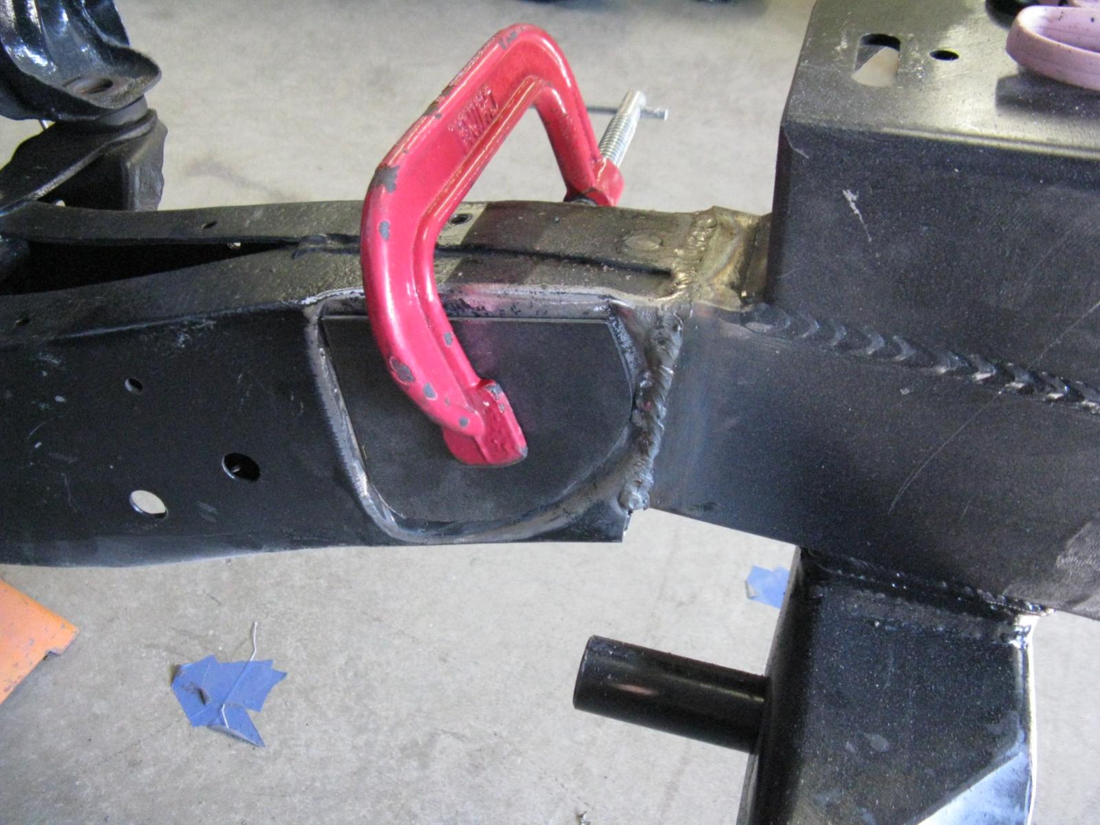

    Got my stub from Fatman on Friday and had already prepped the car. I set everything up level. Dropped all my plumb bob marks and got all the measurements written down on the tape.
    I marked my cut marks, rechecked my measurements ad nauseum and took the Sawzall and whacked off the OE front stub. Then, I plug welded some tabs in just like the instructions said. and tacked everything up.
    You really cannot get distracted when you are doing this. You have to keep checking and rechecking to make sure things are right......or at least I did. It's always easier the second time. :)

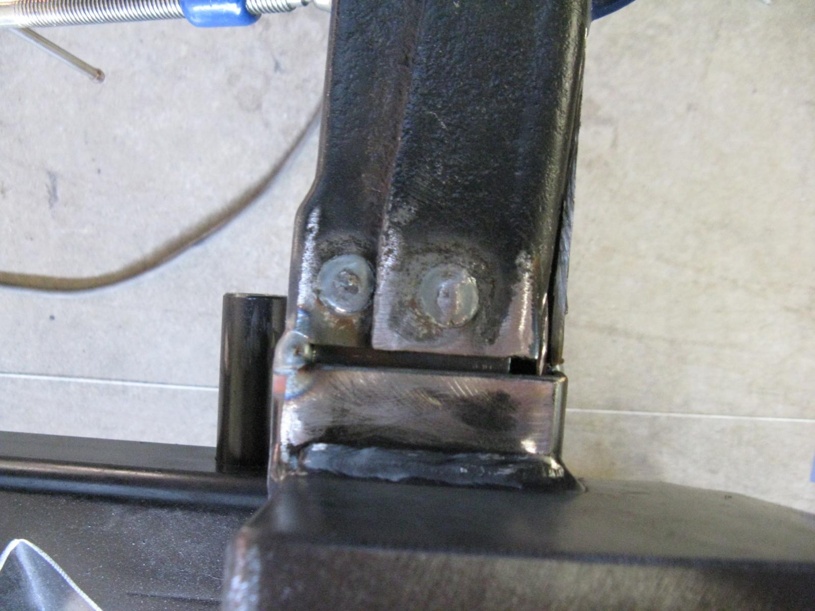

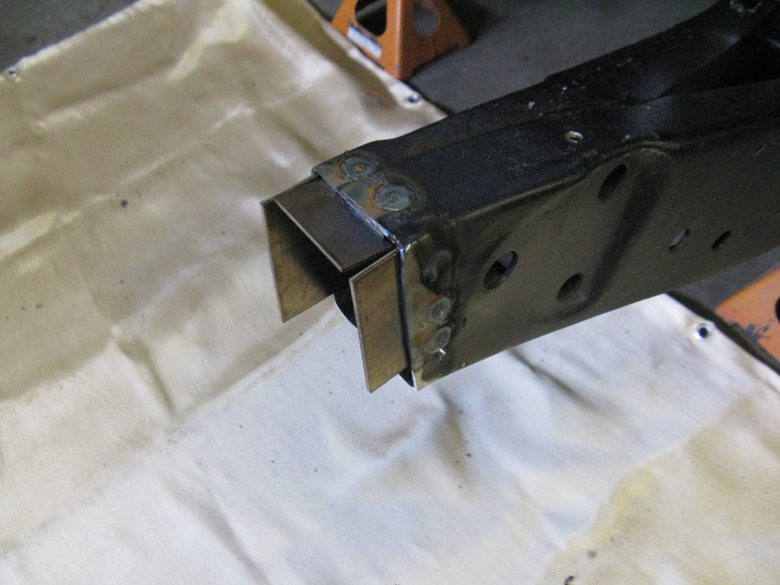

    More pictures of initial tack up.

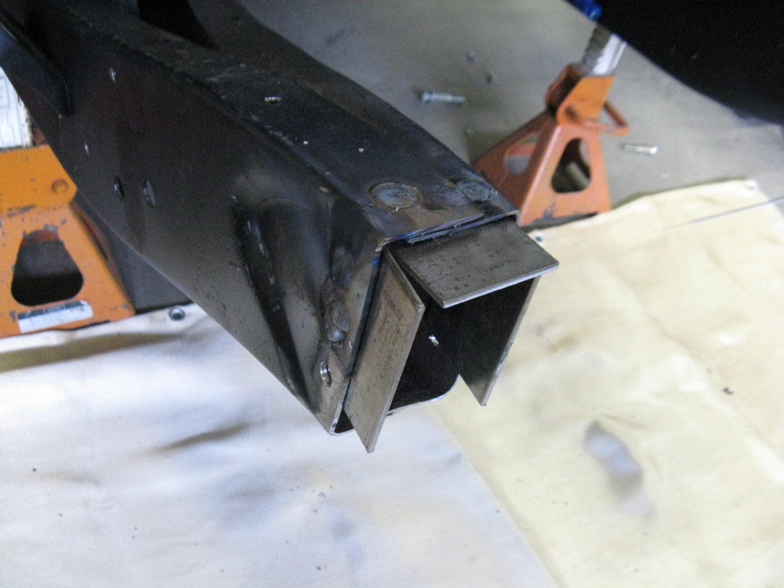

    Because the frame cross section is larger than the stub, I had to make a couple of little "wedges to blend in the bottom of the stub. Those are not installed yet but are pictured.

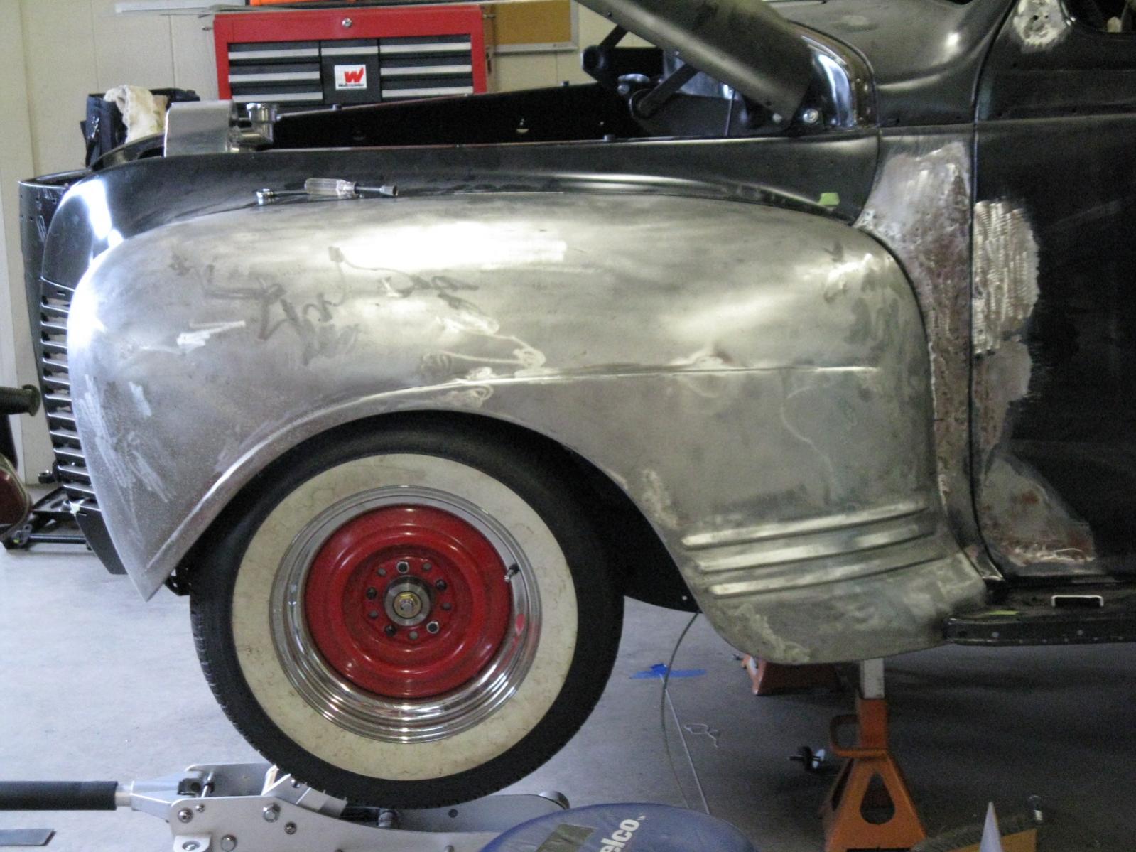

    The radiator support was not in the right position, so I cut it out with the sawzall and moved it back 3/4". That turned out to be unnecessary as we will see but may have been my fault with giving them the measurements.

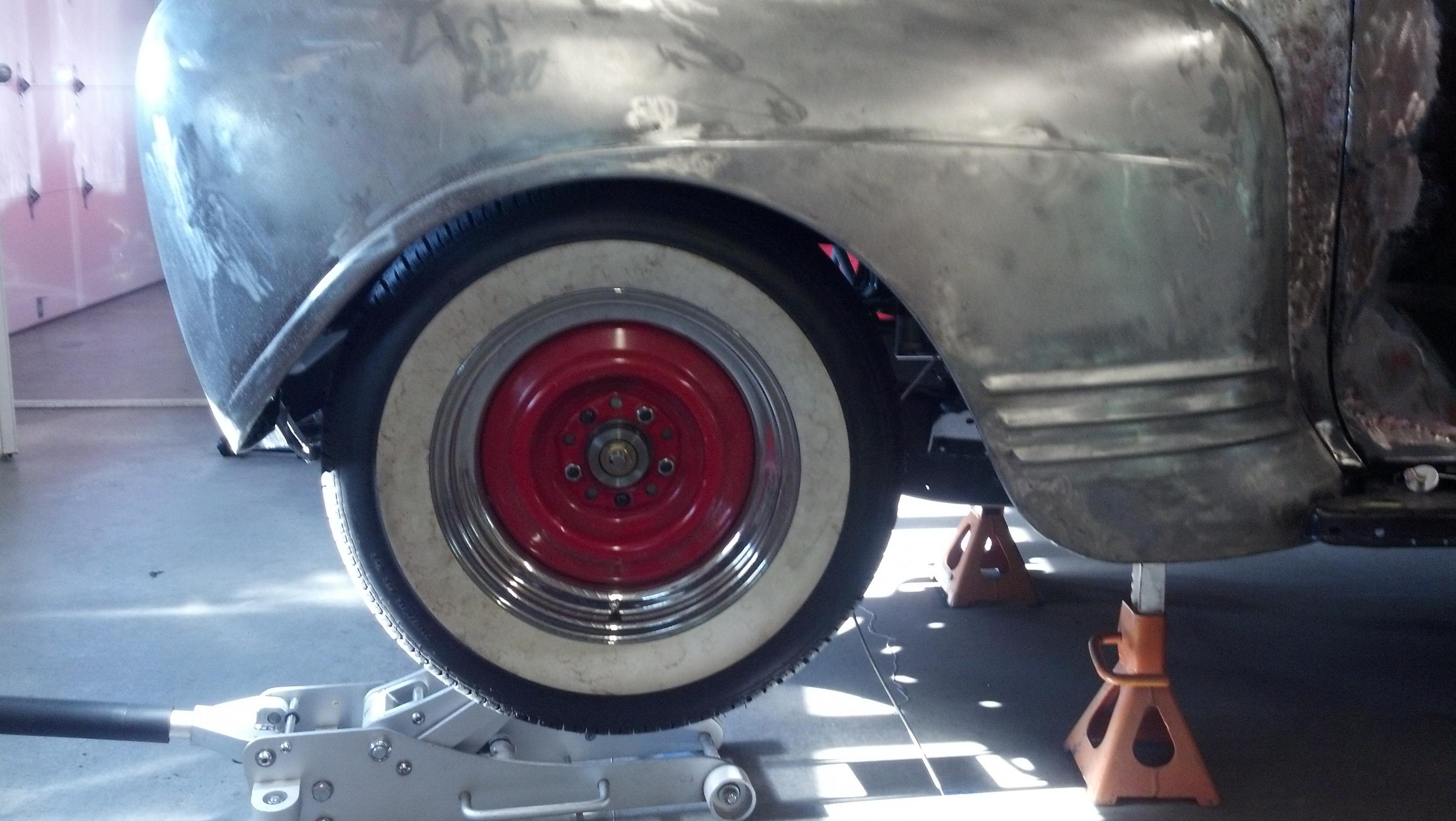

    After getting everything tacked up, I put the front clip on. I did not like the way the wheels were positioned forward in the fender well. After a lot of studying and procrastinating, I decided to take it all apart and move the axle center line back about 7/8" (That's why moving the radiator support turned out to be wrong. Luckily, I only tacked it in.)
    I removed everything, cut about 7/8" off of the frame and have re installed the stub. I have not put the sheet metal back on. That will happen next weekend........after I move the radiator support back out where it needs to be? :)
    This was a lot of work but I think I will be glad that I moved the axle centerline back. It was only about 1/4" ahead of where the OE axle centerline was, so I guess that's how these cars looked. It wasn't how I wanted mine to look, so I took creative license. Hopefully, I didn't create any unforeseen engineering problems by doing so.
    The last 3 pictures are of the last install. I went ahead and zipped it up since everything seemed to be on the money. You can see that there are some indentations where the OE steering box was installed. I'll cover those up and reinforce them and the butt weld next weekend.

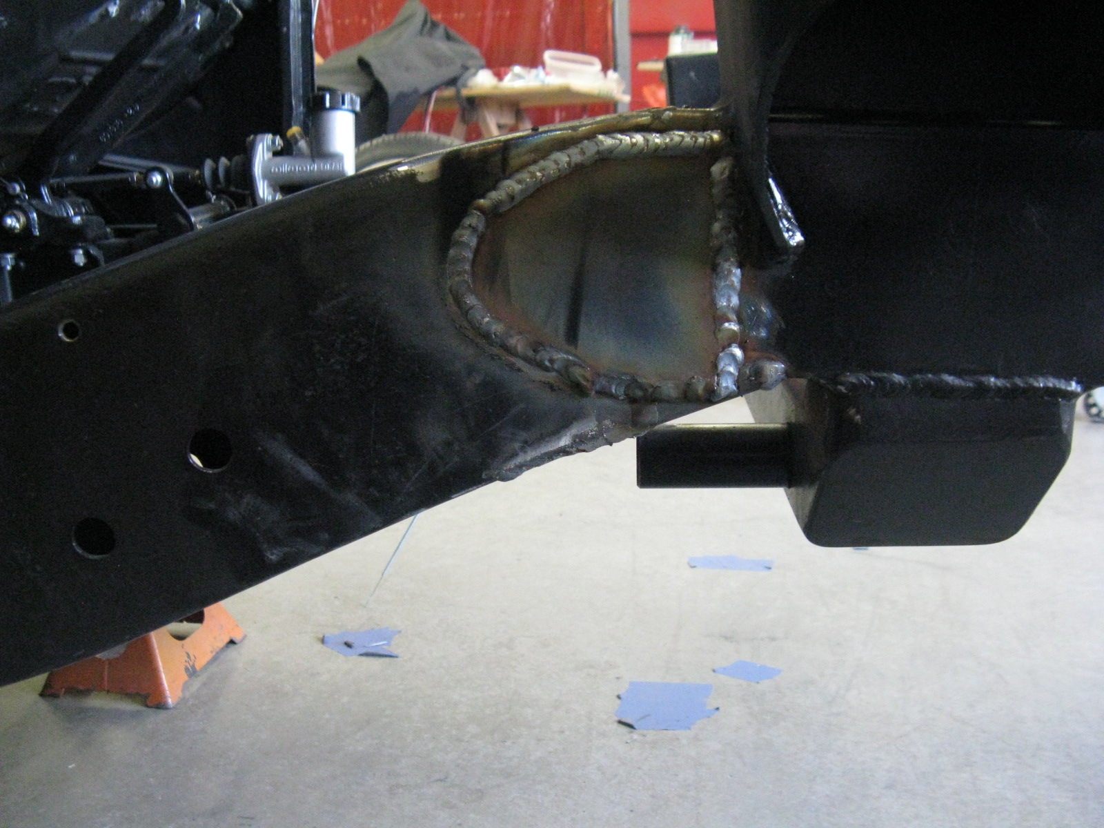

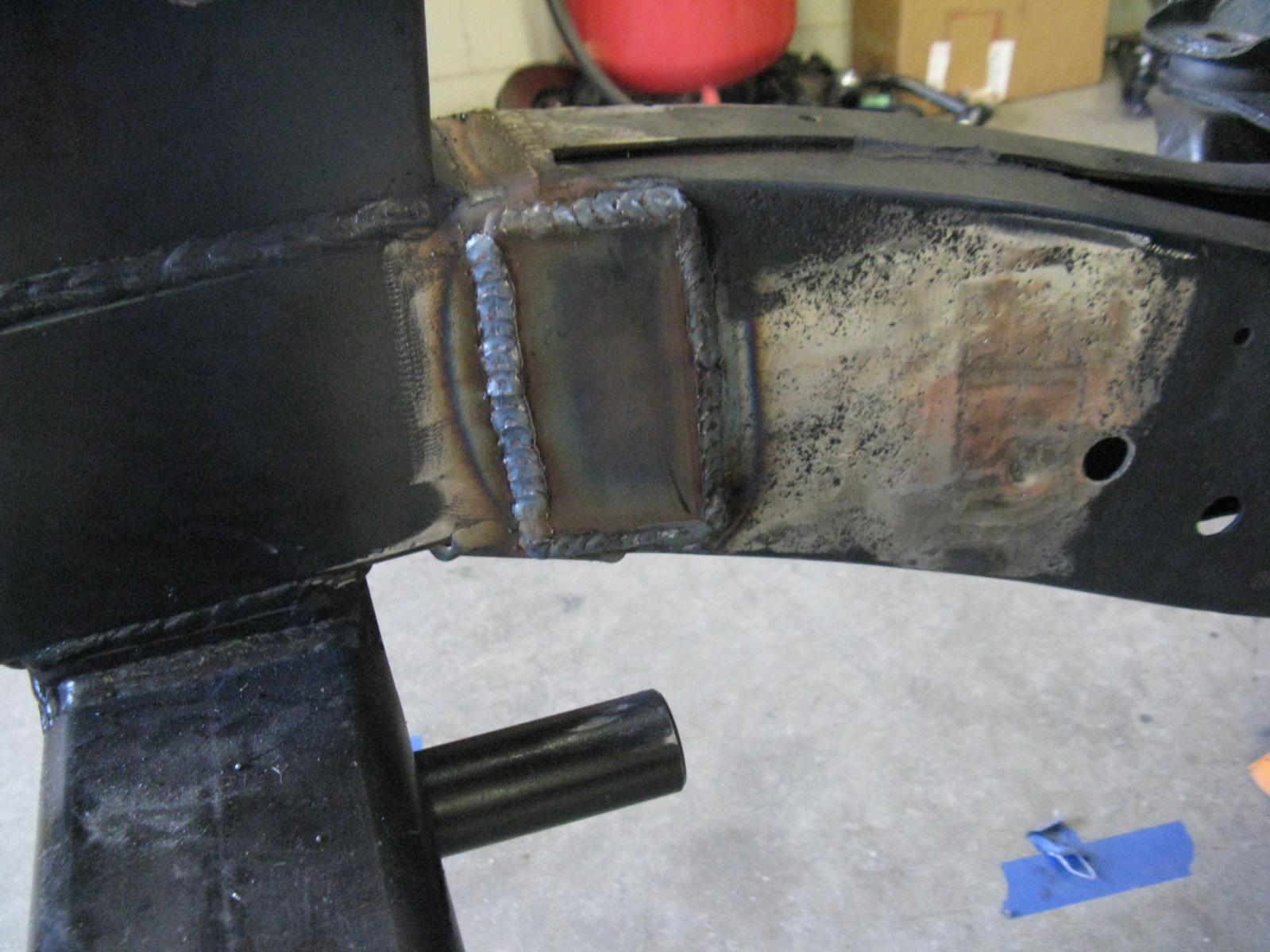

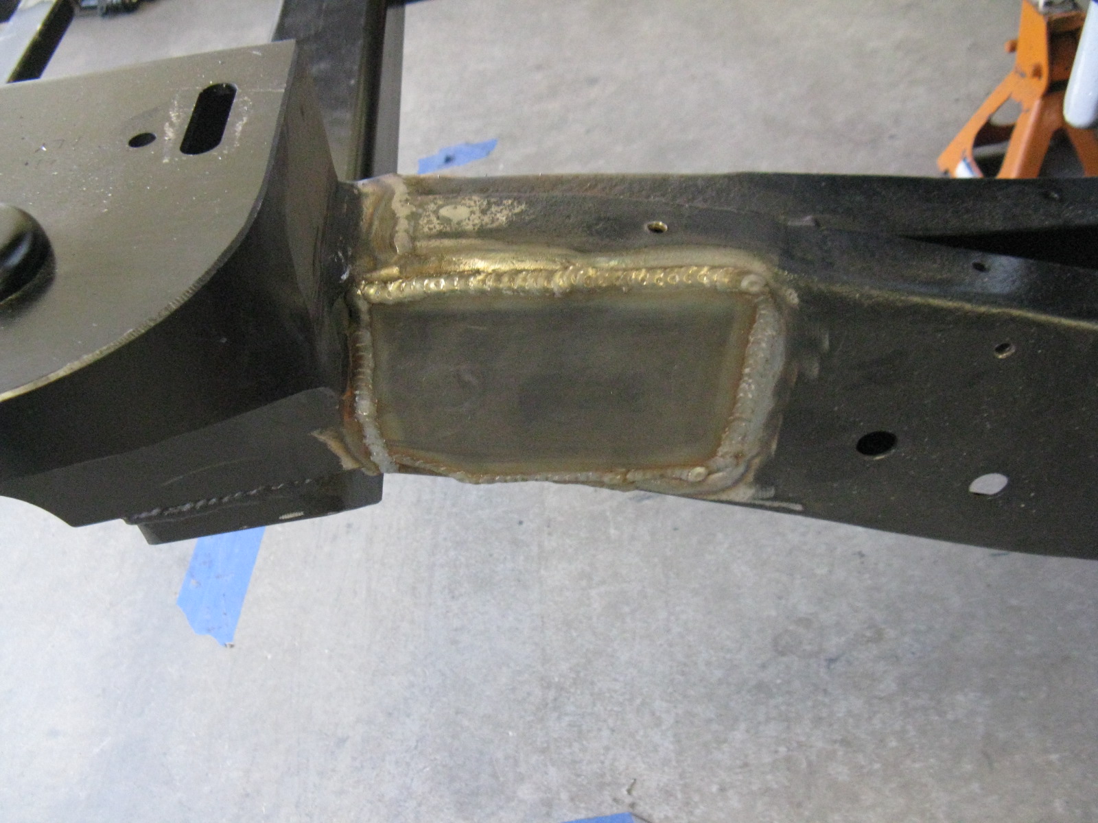

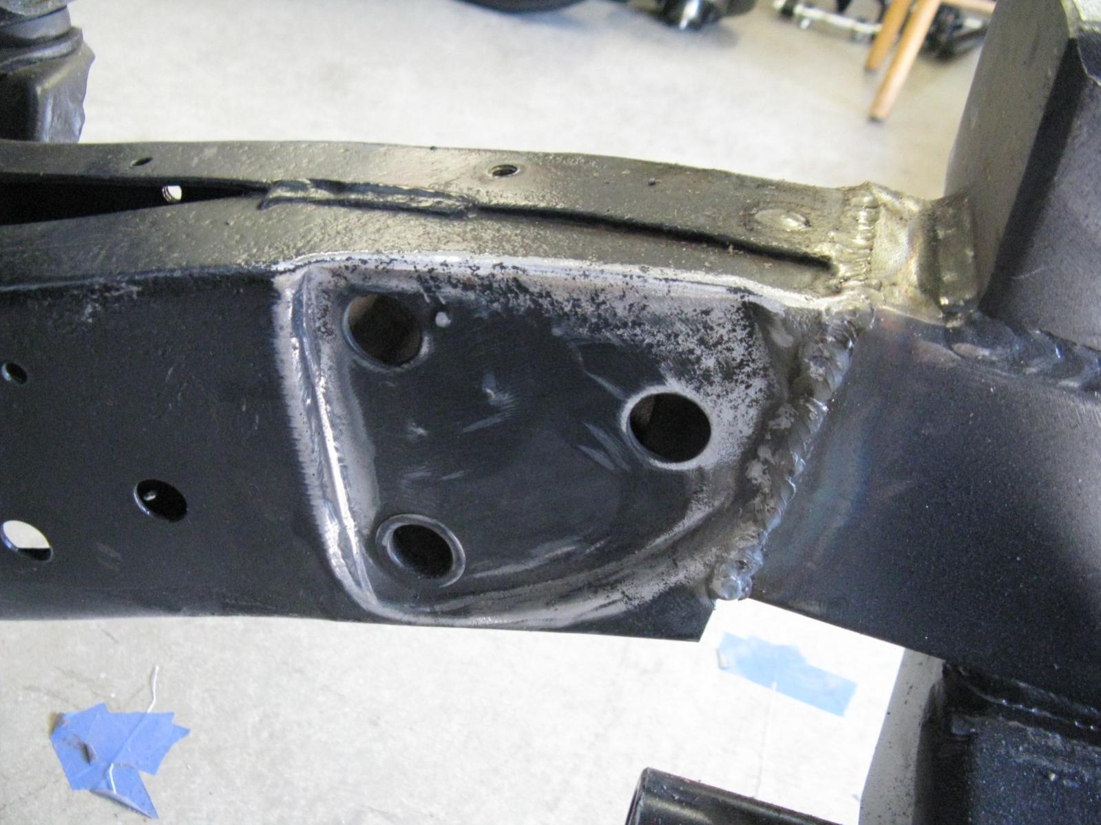

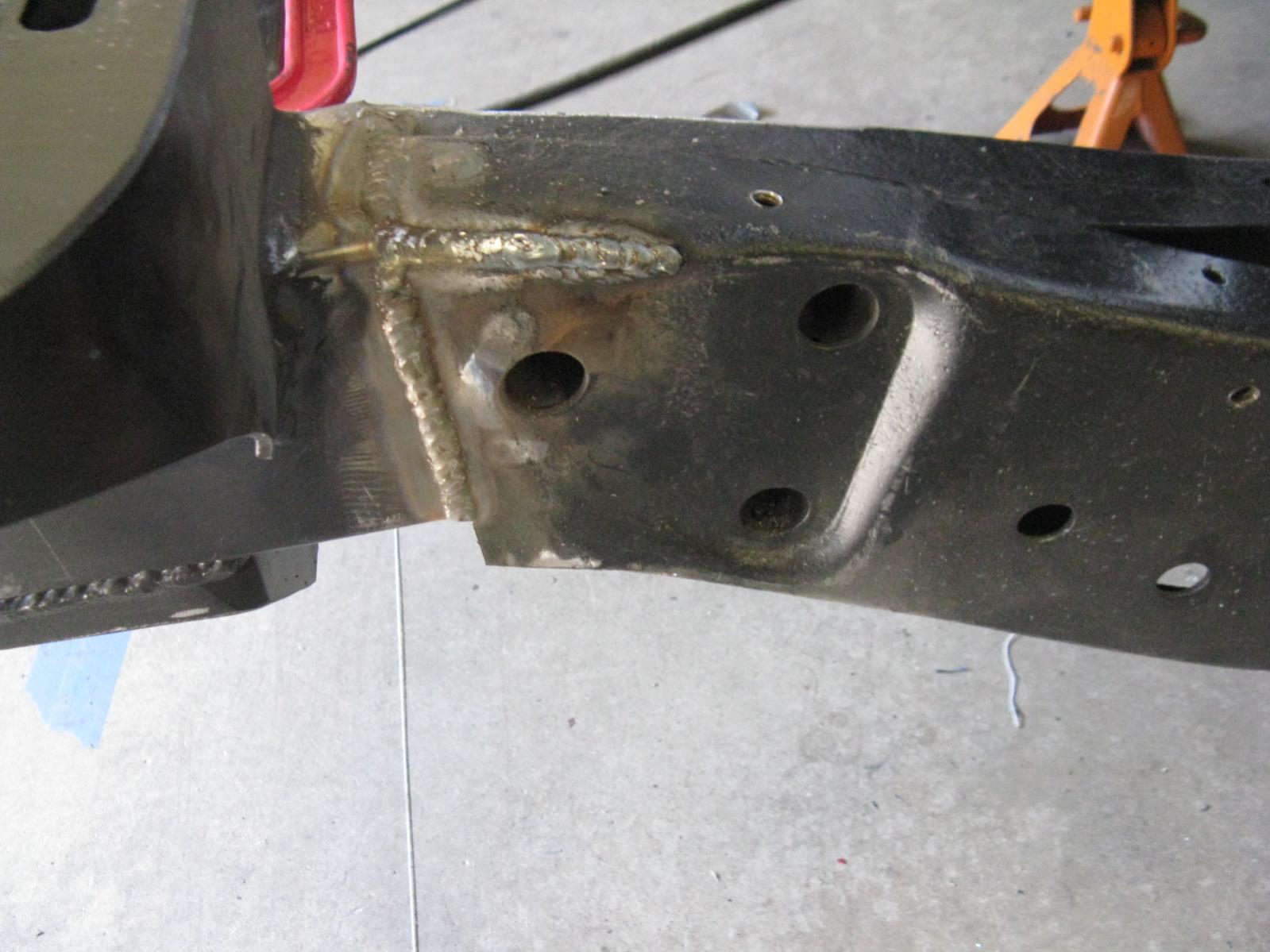

    Ok. Here is the "before" and "after pictures. I shortened the frame 1" to accomplish this. The remainder of the pics are of the welding and reinforcing of the frame.

    Here is the lesson learned. Always decide if you like your axle centerline BEFORE you disassemble the front end. If not, decide how much further back from the original axle centerline you would like to move it. Then, mark BOTH on the floor. You will still have to tack up the front end with the "prescribed cut" but then you will know exactly how far back to move it, if you don't like it.

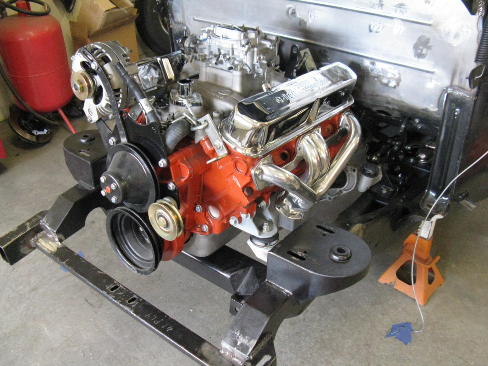

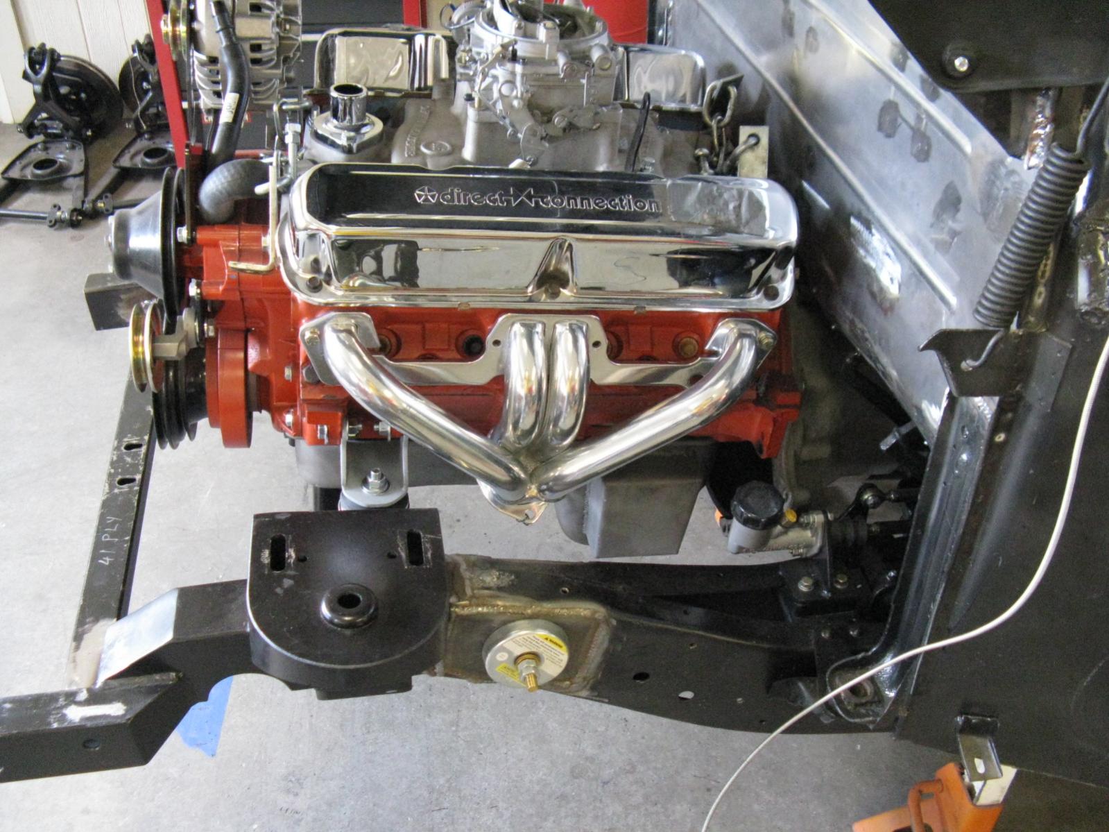

    Got the engine mounts in. Engine is still 3/4" offset to the PS to make room for the starter.
    Next up will be figuring out the steering and re-doing the steering column.
    Thanks to hotroddon for the tip on the Patriot headers. They look a lot nicer than the 340 exhaust manifolds and dump right where they need to.

    Nice looking welds, do you do it for a living? I am the design engineer at a steel tank fabricating company and you make the welders here look like a bunch of amateurs.

    Nope, just a hobbyist. Thanks!
