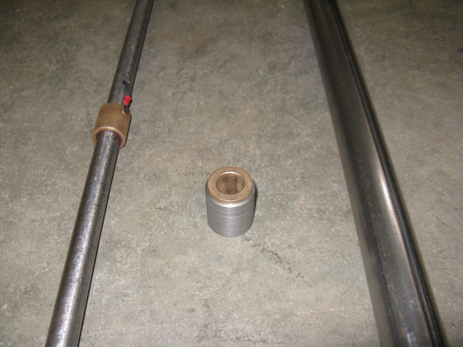

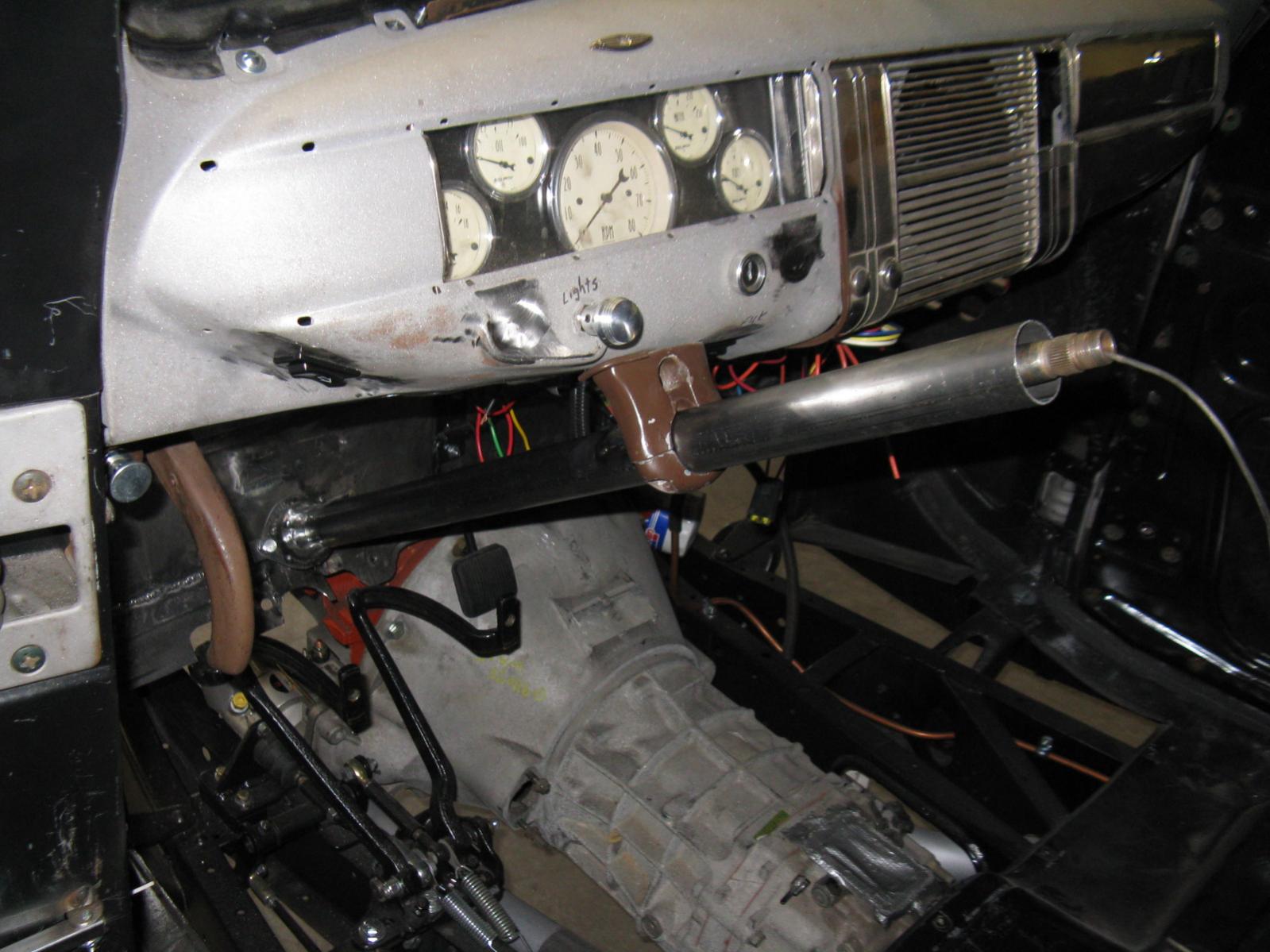

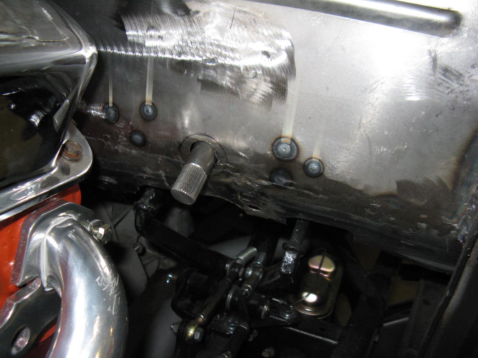

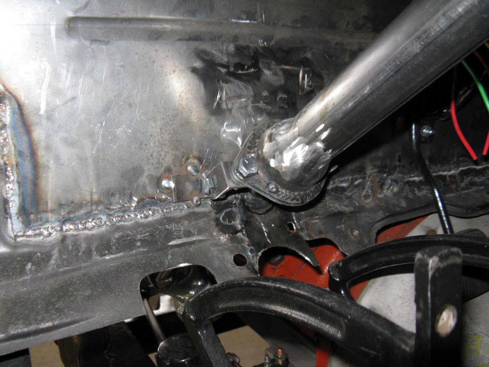

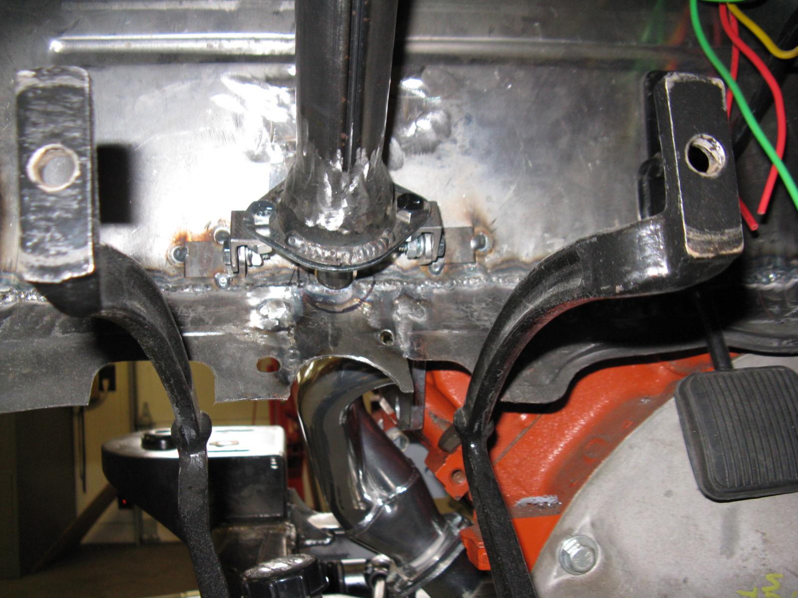

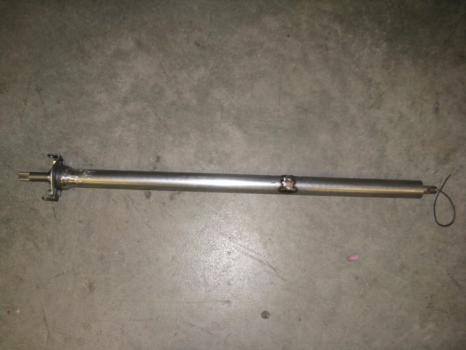

    Remade my steering column for the 3rd time. Don't ask. Anyway, here is the final iteration. 1 1/2" exhaust tubing from NAPA, spliced old shaft/new shaft, Limeworks horn adapter, custom made bronze bushing support for the steering wheel end and ball bearing from Tractor Supply for the other end.
    Insert custom bushing support and plug weld it from underneath. The rest is self explanatory or you can look back in the thread and see more details on the bearing end.
    Everything is tacked in place and I've ordered the shafts, etc. from Borgeson to finish it up next weekend. I'm planning to use a flexible grommet around the shaft through the firewall. I still have to enlarge that hole.

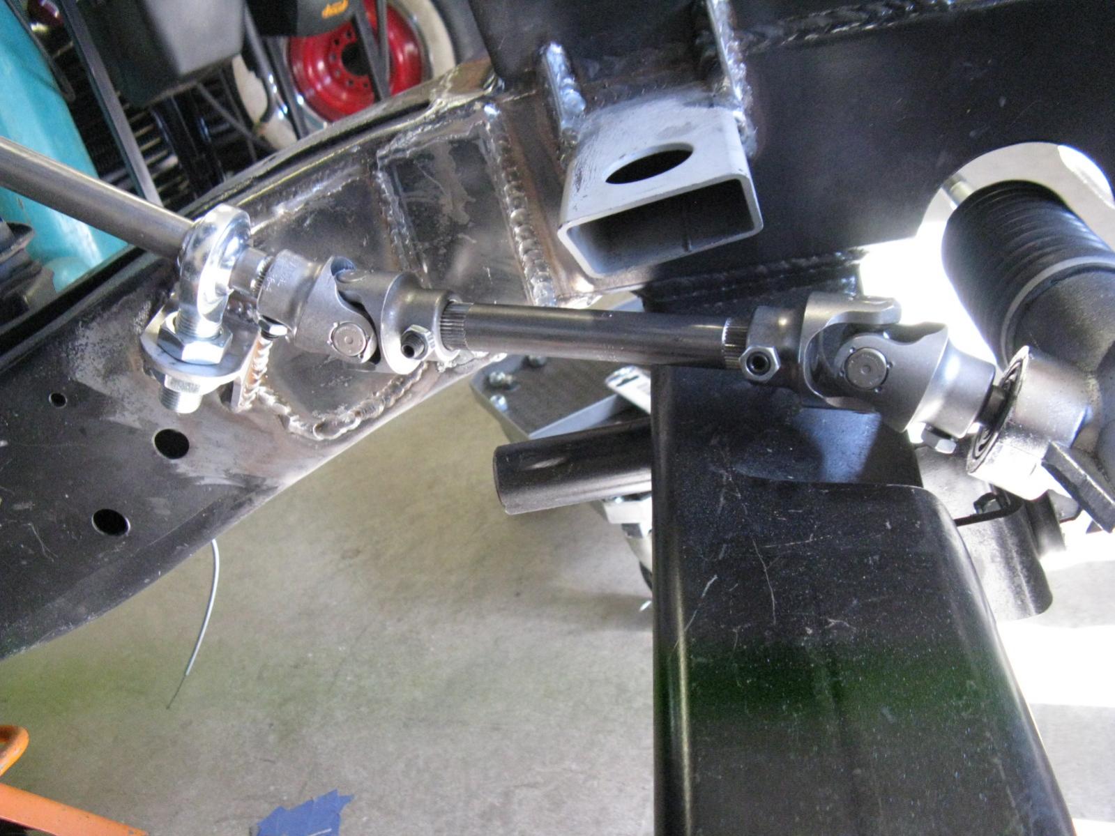

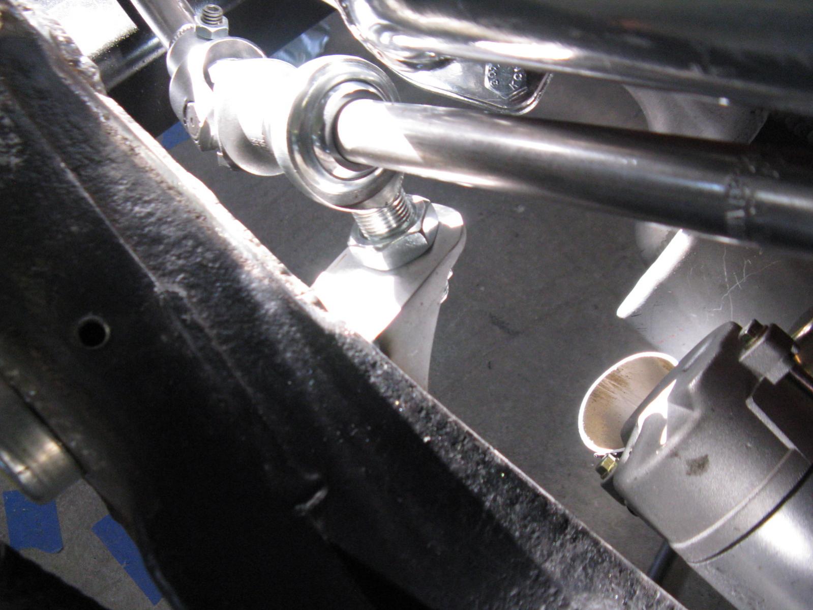

    Finished up the steering linkage. Is it just me or does this take an inordinate amount of time to get right? Anyway, it's right. No binding and smooth as can be.

    Looks good rock! Those angles can be a mess for the steering linkage. It looks like you got it figured out.

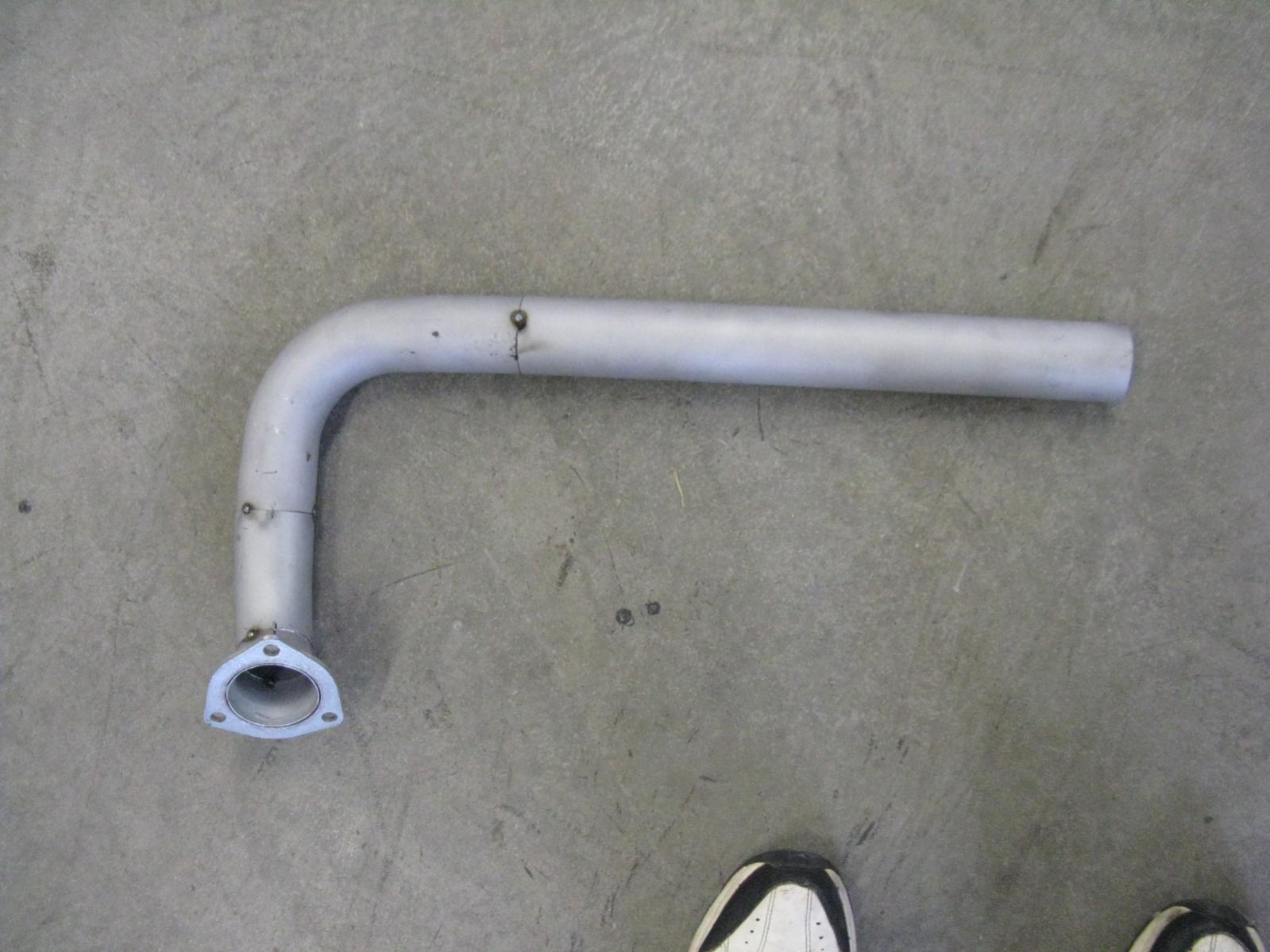

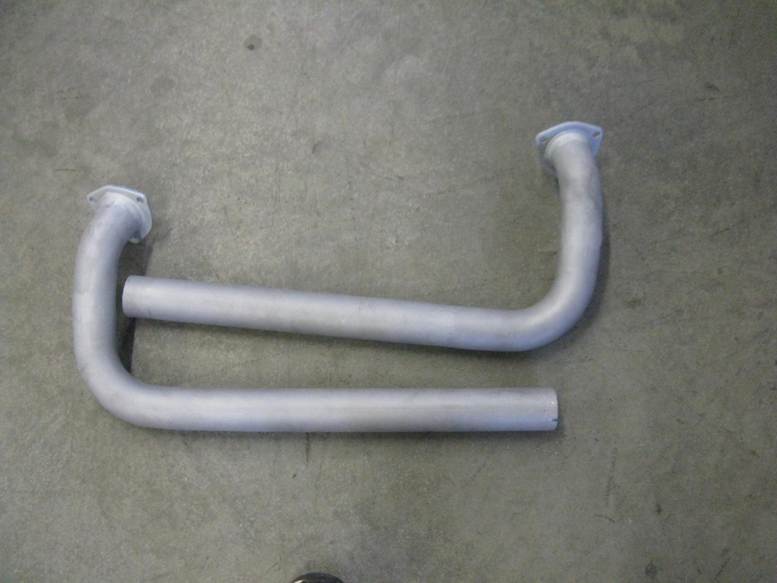

    Somewhere around page 16 is the start of the fabrication of the exhaust system. I'm just reconnecting to all of that. I ran the pipes through the frame, moved the gas tank, and made the system symmetrical.
  12. rockable
    Joined: Dec 21, 2009
    Posts: 5,119
    rockable

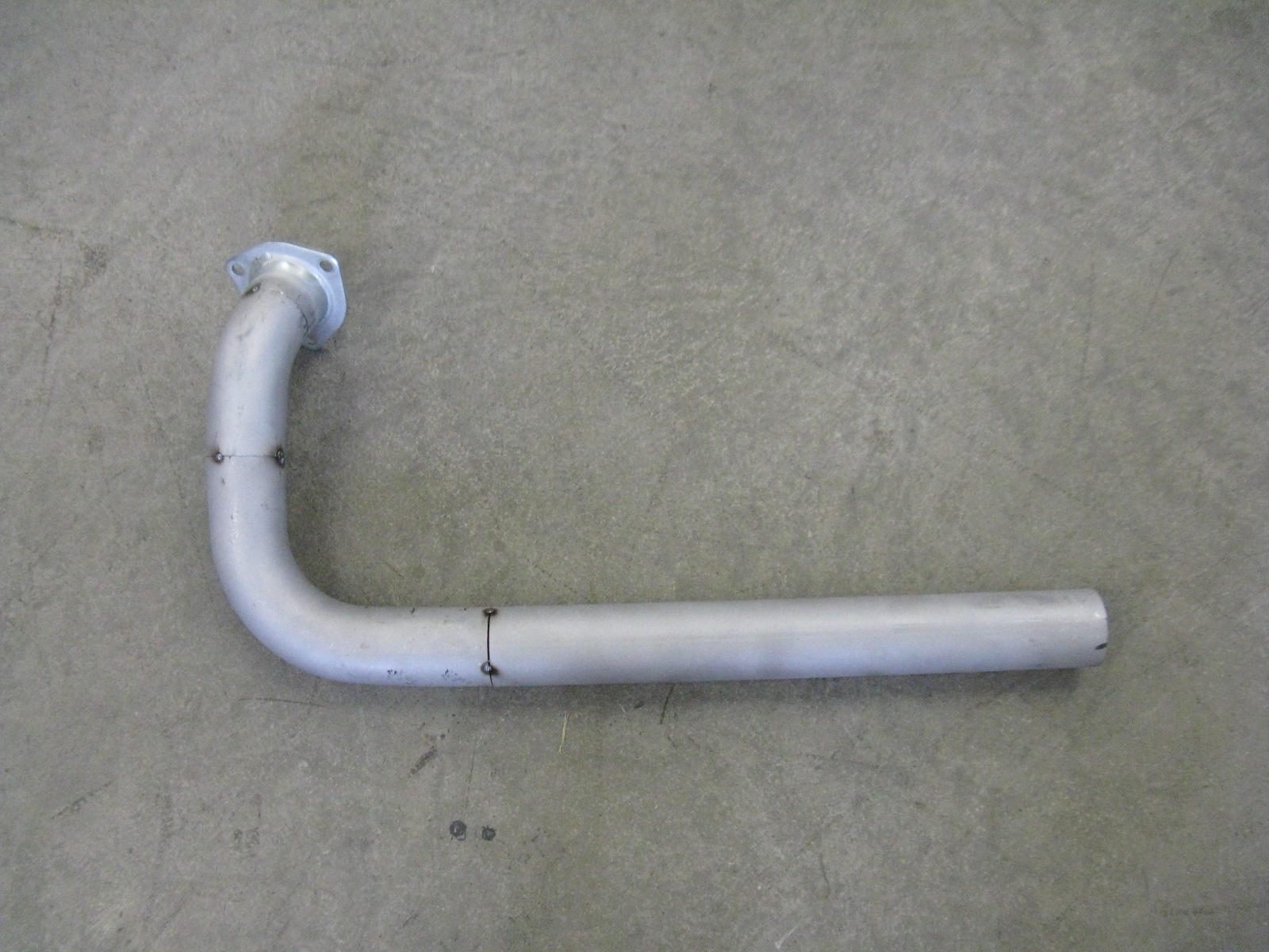

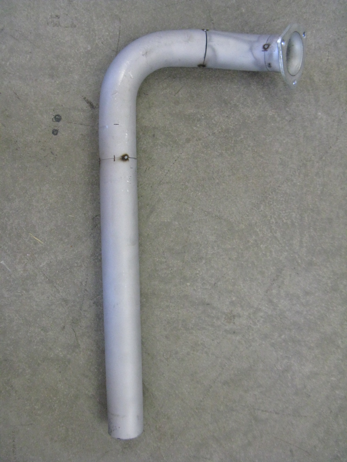

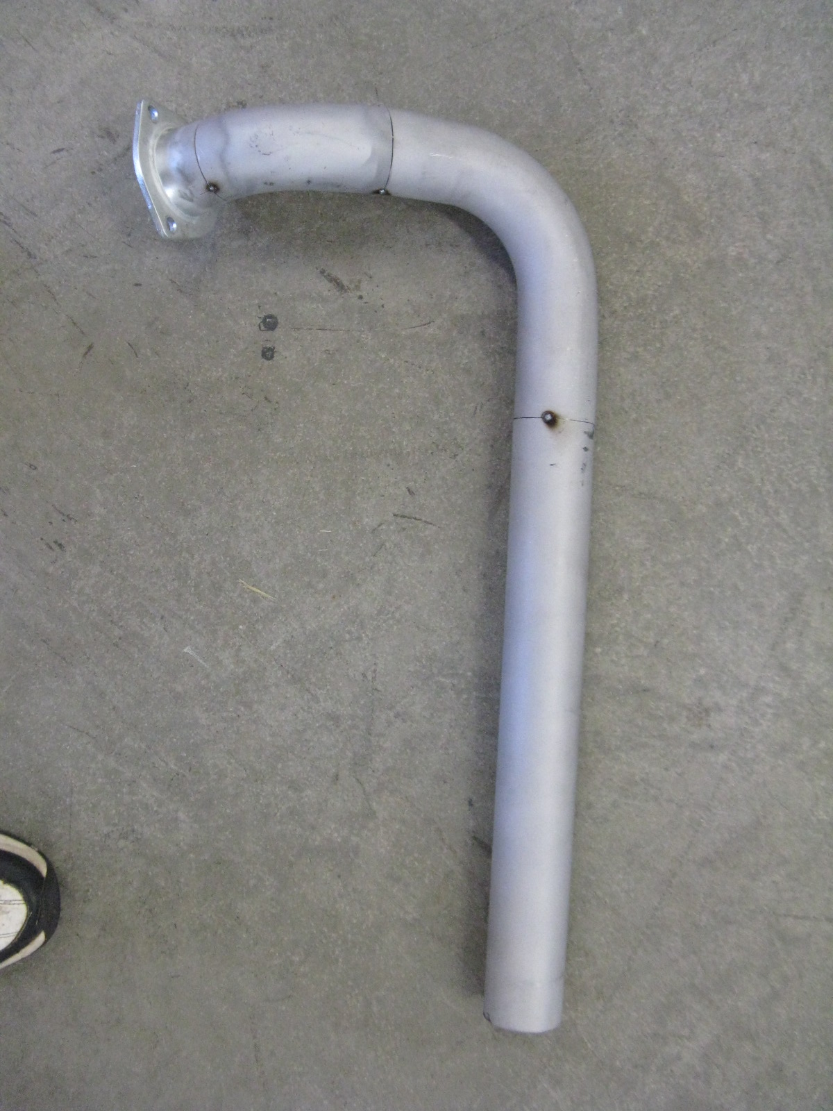

    Refabricated the exhaust today. This is not for the impatient person. It really takes time and patience to get it conceptualized, measured, tacked, welded, etc., especially when you are routing it through the frame.
    I'm pretty pleased with how this turned out. It damn sure won't be dragging the ground.

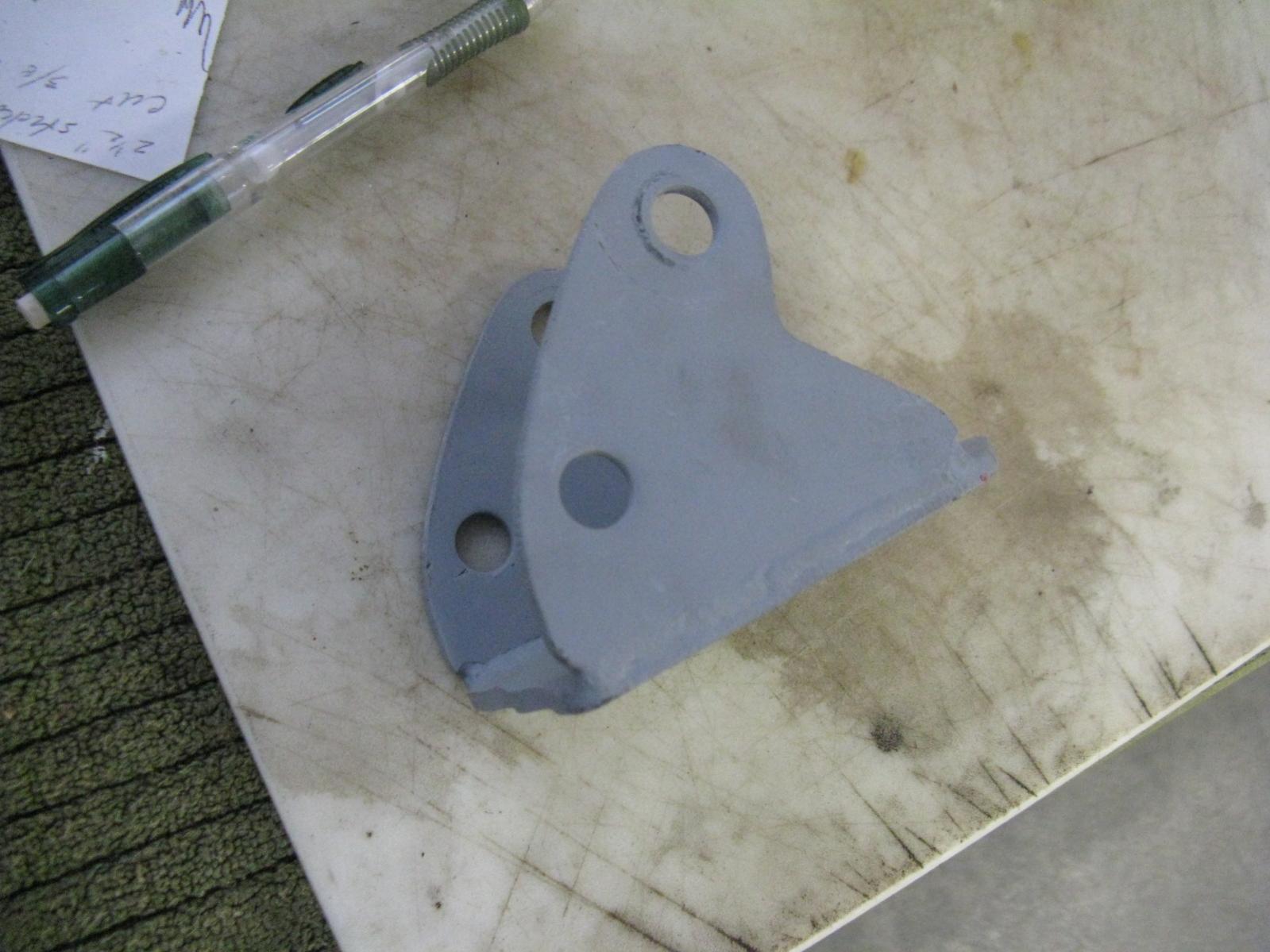

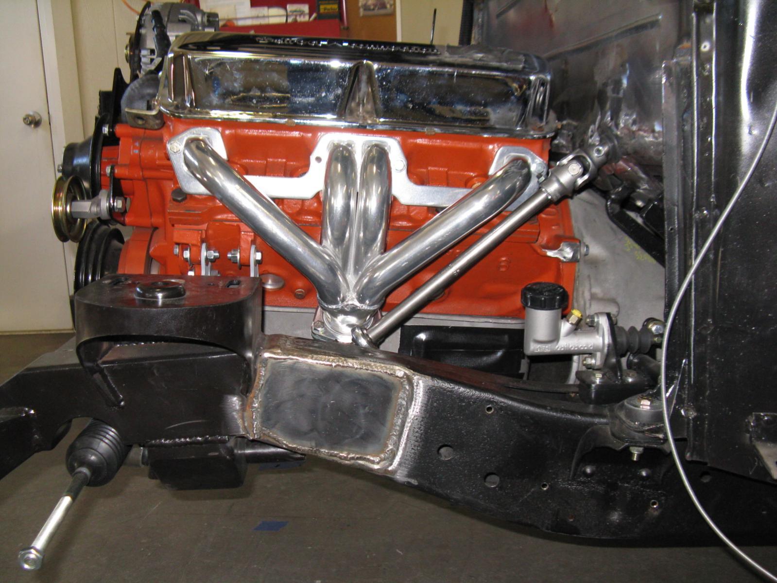

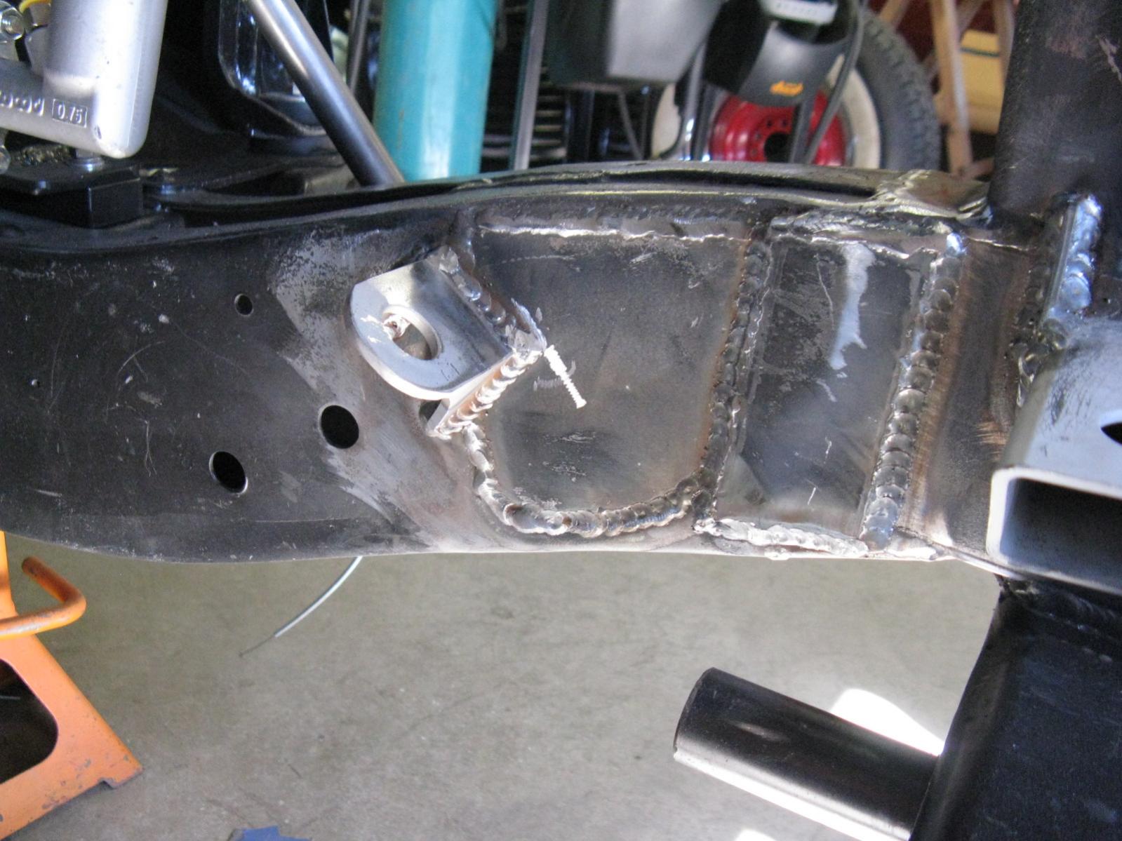

    I had some issues with the height of the engine and I need to lower it 1/2". I really didn't want to cut the mounts that I had welded to the frame, so I figured out how to lower the engine mounts to get that 1/2". I'm going to also have to take a 1/2" out of the crossmember when I get the engine out again. No big deal but a pain in the ***.
    Here is a before and after picture of the mounts.

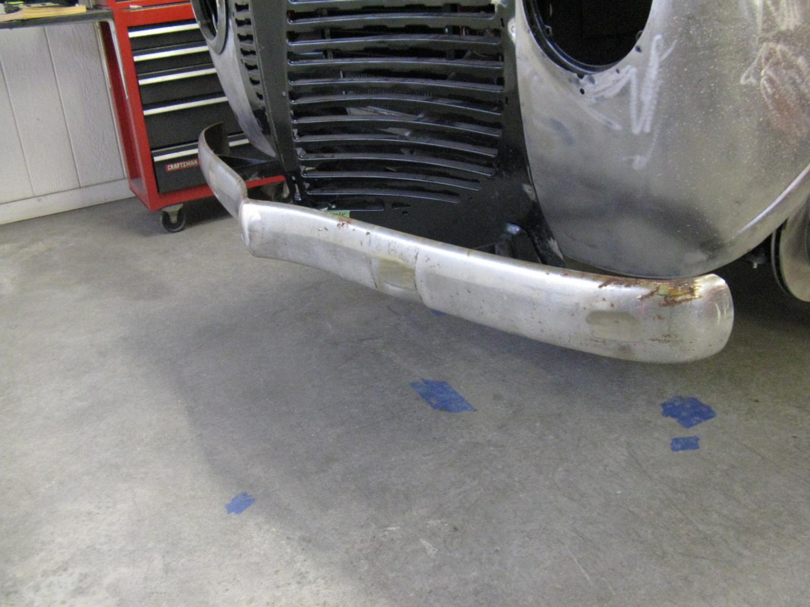

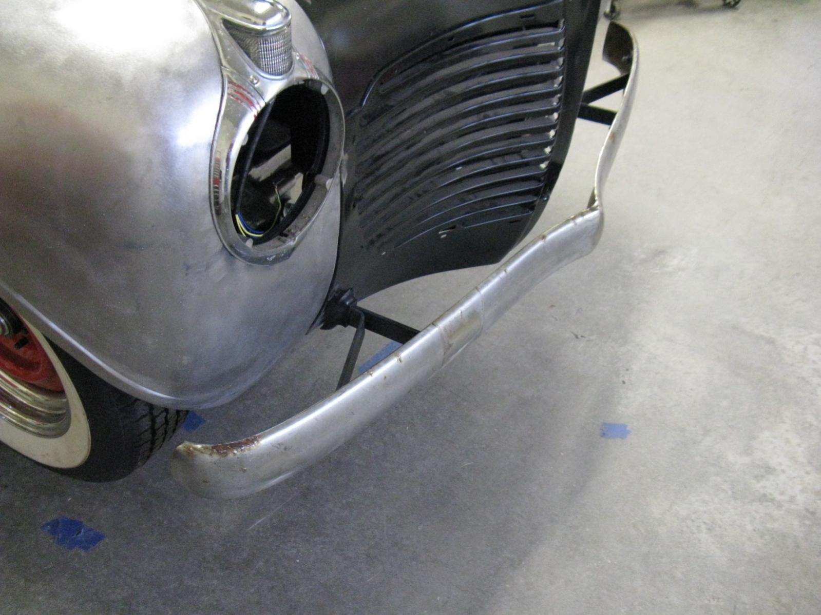

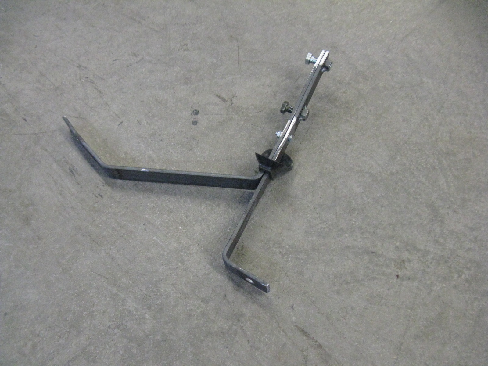

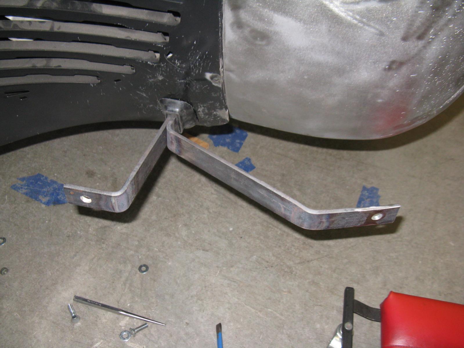

    This weekend, I worked on the front bumper. You wouldn't think it would take most of two days to get it all right but it did. The bumper is the one that was on it when I got it but I think it's from a Dodge or maybe Desoto. I like the way it looks with the pointy front end.
    The original mounts had it sticking about 7" out from the point. Now its about 3". I also welded all the bolts into the bumper to smooth it out.

    Yes they do. What do you think of the bumper?

    I have the same front bumper,but not nearly as goood of condition as yours,,and plan to do the same thing, its a 1940 chrysler/desoto bumper looks good

    Bumper looks great

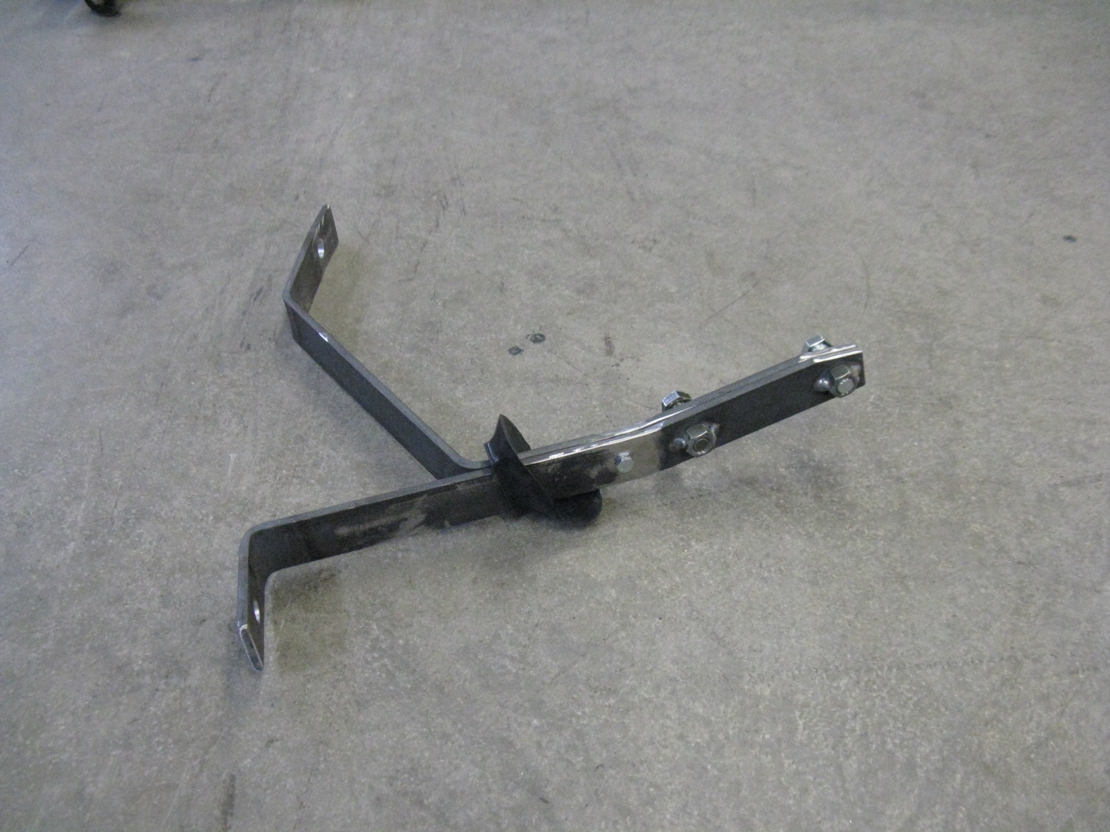

    I finished welding the studs into the rear bumper this morning and installed the mounting points for my 3 point seat belts. Plus I made a spare tire tie down. I am tired.
