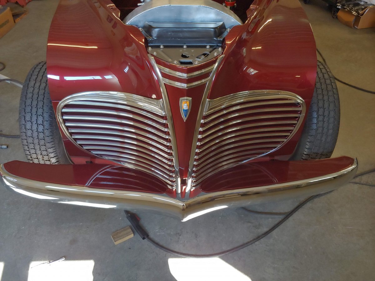

    I'm getting close to finished. Here are some shots I recently took.
    The clips that hold all those grill pieces on are no a. Had to use Auveco clips and drill 92 holes! I already have 2 days of work in that grill and am waiting for more clips.

    No one could appreciate how much time and aggravation went into this grill. The front end is assembled and I hope I never have to do that again.
    I used a 40 Desoto bumper with some filler panels I made to give the front end a better look. I don't think the 41 Plymouth bumper works well with this car. What do you think?

  17. Hnstray
    Joined: Aug 23, 2009
    Posts: 12,355
    Hnstray
    from Quincy, IL
    Looks GREAT.....like it was intended for the Plymouth! ;)
    Ray
    rockable likes this.
  18. earlymopar
    Joined: Feb 26, 2007
    Posts: 1,749
    earlymopar
    The bumper is sure a nice addition to your build. Great looking Mopar!

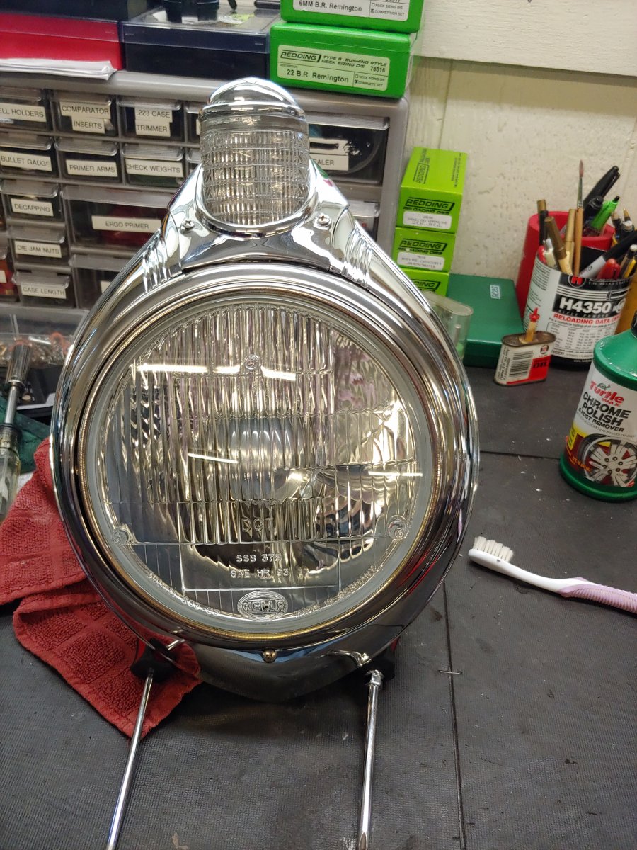

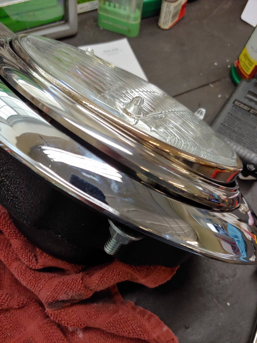

    Fitting chrome is simetimes a real pain...but it sure is pretty. These bezels have too much plating in the I.d. and the trim rings won't fit inside them like they should. Probably going back because I'm afraid I will screw them up. Sigh.
