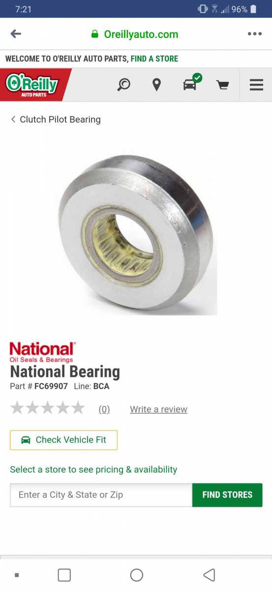

    Screenshot_2018-11-20-07-21-51.png Actually, it wasn't a defective part. It was the wrong part. I selected a pilot bushing and the shaft did not engage it adequately. I replaced it with a pilot bearing that moved it up on the shaft adequately and supported it. Hot rodders learn a lot of lessons the hard way. At least I caught this quickly. The correct part should look like this.

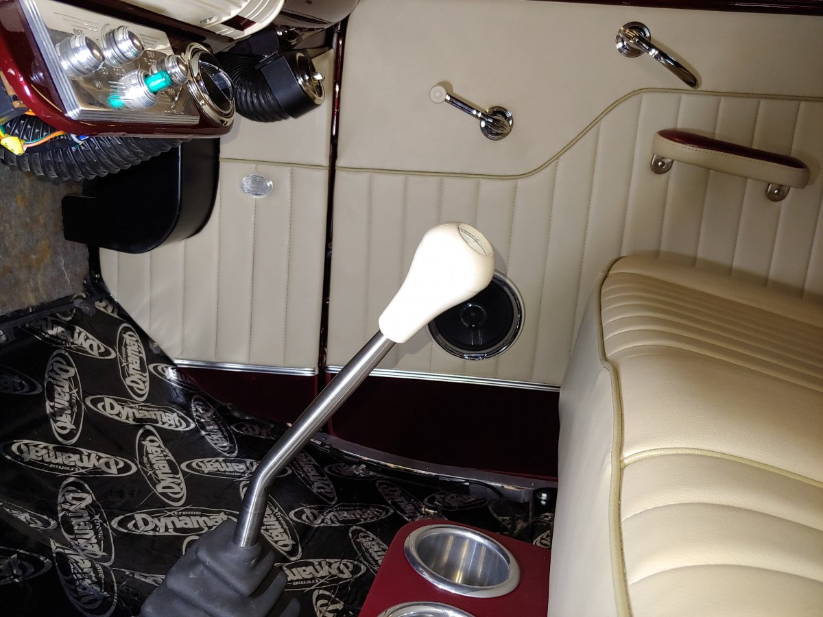

    A few more interior pics. Next up is headliner and carpet. 1219181622_HDR.jpg 1219181621.jpg 1219181622_HDR.jpg 1219181621.jpg 1219181609.jpg

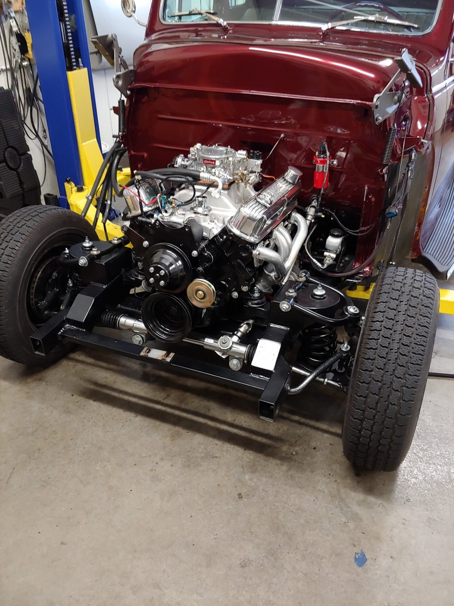

    Reading your post I see you have changed from the oem steering to a rack and now a snub with mustang type front suspension. I'm gathering parts for a 39 Plymouth coupe that I only drove one time with the six still in it. Liked the way it drove so just wanted to know why you kept making the changes to the front maybe I missed something.
  30. rockable
    Joined: Dec 21, 2009
    Posts: 5,121
    rockable
    Well, the original steering has unequal tie rod lengths. The short side will exhibit more roll and bump steer, plus the camber and caster adjustments wouldn't work for me with the suspension lowered and with radial tires. So, I ditched that, as well. The stub gave me lots more room for mounting everything, works better for my purpose (interstate trips through the mountains) and is just a cleaner install. That is why I did it. YMMV.
