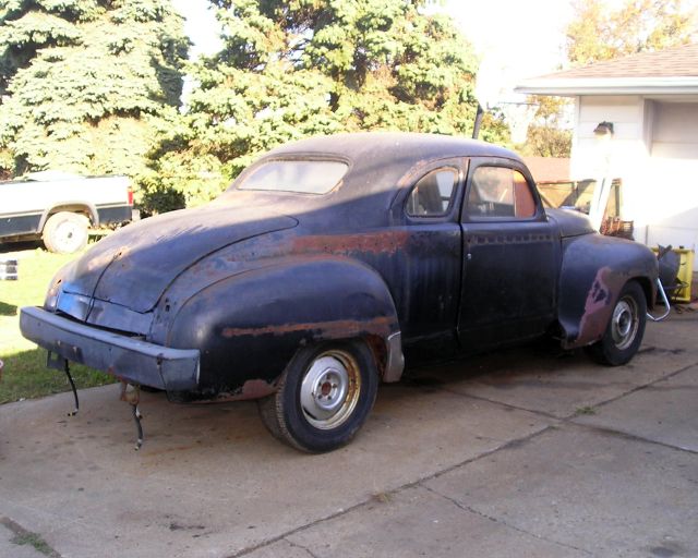

    I'm getting lazy. I didn't take any pictures this weekend. After deciding that I was going to have to replace my gas tank, I decided that I might as well fix my rusty trunk floor. No need to be welding and grinding around a gas tank at some time in the future.
    So, I've made two of the necessary 5 panels and it's going well. I'll post some pics later.

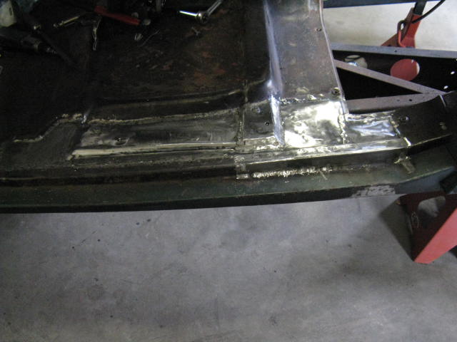

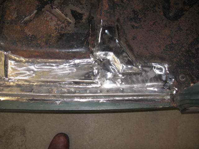

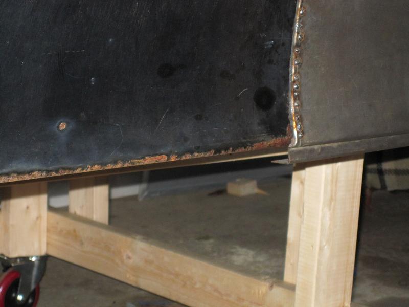

    I'm on a roll, again. I got the passenger side floor pan and inner rocker repaired this week. It's hard to take pictures of this stuff, but here goes. All panels were hand fabbed and MIG'd in. It's pretty self explanatory. The Driver's side is going to be worse.

    Also, when I tried to remove the running boards, the internal nuts were shot. I ended up using a die grinder to grind the heads off all the bolts so that I could get the running boards off.
    Then, I had to figure out how to repair these unusable nuts. After considerable head scratching, I decided on the following plan.
    First, I cut several pieces of 1" X 3/16" flat bar about 1 3/4" long. I drilled and tapped a 5/16" NC hole in the center of each piece.
    Then, I cut a three sided window in the bottom of the rocker panel, folded the flap down and removed the old nut and hold down hardware.
    Next, I screwed a bolt through the flap into the new "nuts" and tightened them down in place. I then took a 5/16" drill and drilled a hole through the rocker flap and a small way into the flat bar. Two button hole welds secured the flat bar.
    Lastly, I moved the flap back up into place, welded it up and ground it down. The pictures here are the finished product. I didn't stop to take pictures of the flat bar and the flap but you should be able to figure that out. :)

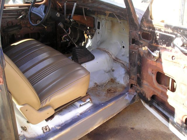

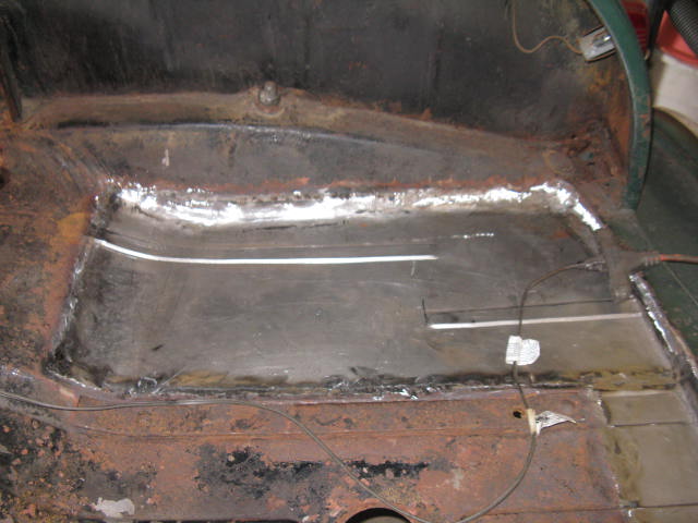

    Today, I finished up the driver's side floor. Here are some pics. I still have a couple places in the floor to do but it will be easier with the body off the chassis. The pics aren't great. The work looks better than the pics but I don't know how to shoot them any better. :)

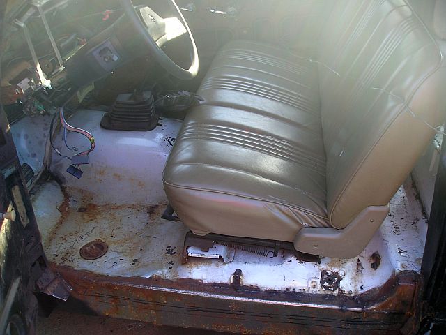

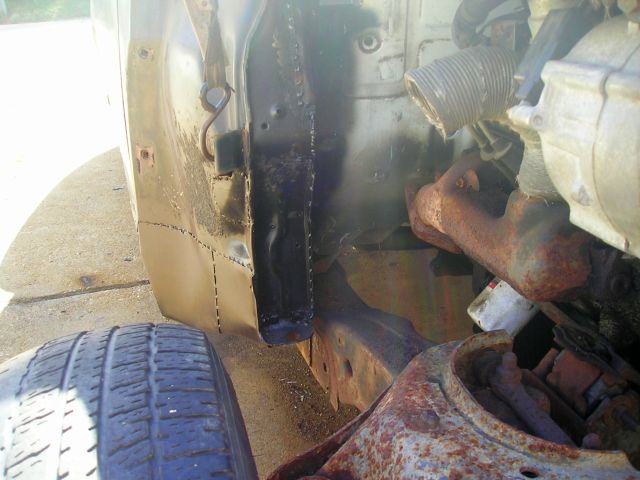

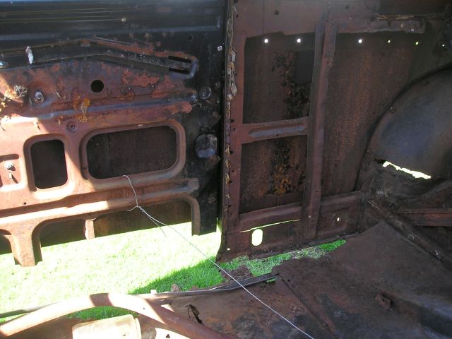

    Thought maybe I'd give you a few pictures of what my car looked like when I started. I do rust repair to car body, frame, and suspension mounting points for a living. I bought this car specifically to put on the Dakota frame with the intention of building a street version of a dirt track race car. I bought the body (whole car with a rotted frame and froze up suspension) for $200. It will get a full roll cage because it will fit into my plan, and because I'm a little concerned about the body structure. By adding a cage, I can tie the body to the cage. It won't ever be pretty, but it will be safe and my wife and I will enjoy riding around in it. Don't be too concerned, I've done this before, the 1st one we drove it for 7 years and put over 70,000 miles before I sold it to the next guy. This one is in slightly better then that one was in before I started.
    Hopefully I can give you inspertation for your car. Now, those "before" pictures. Gene

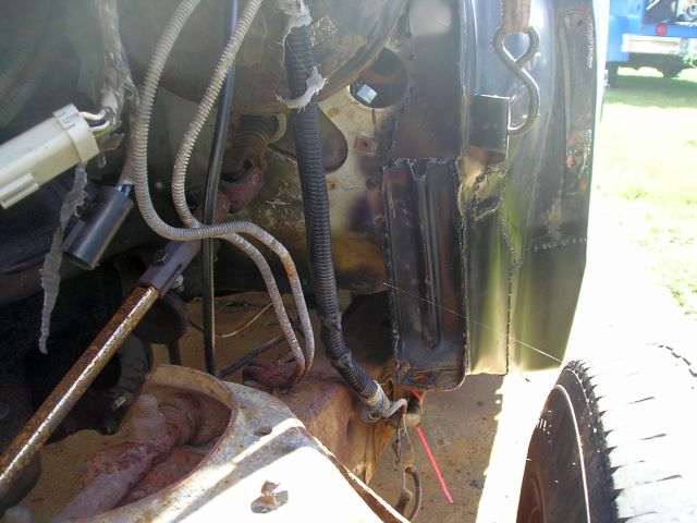

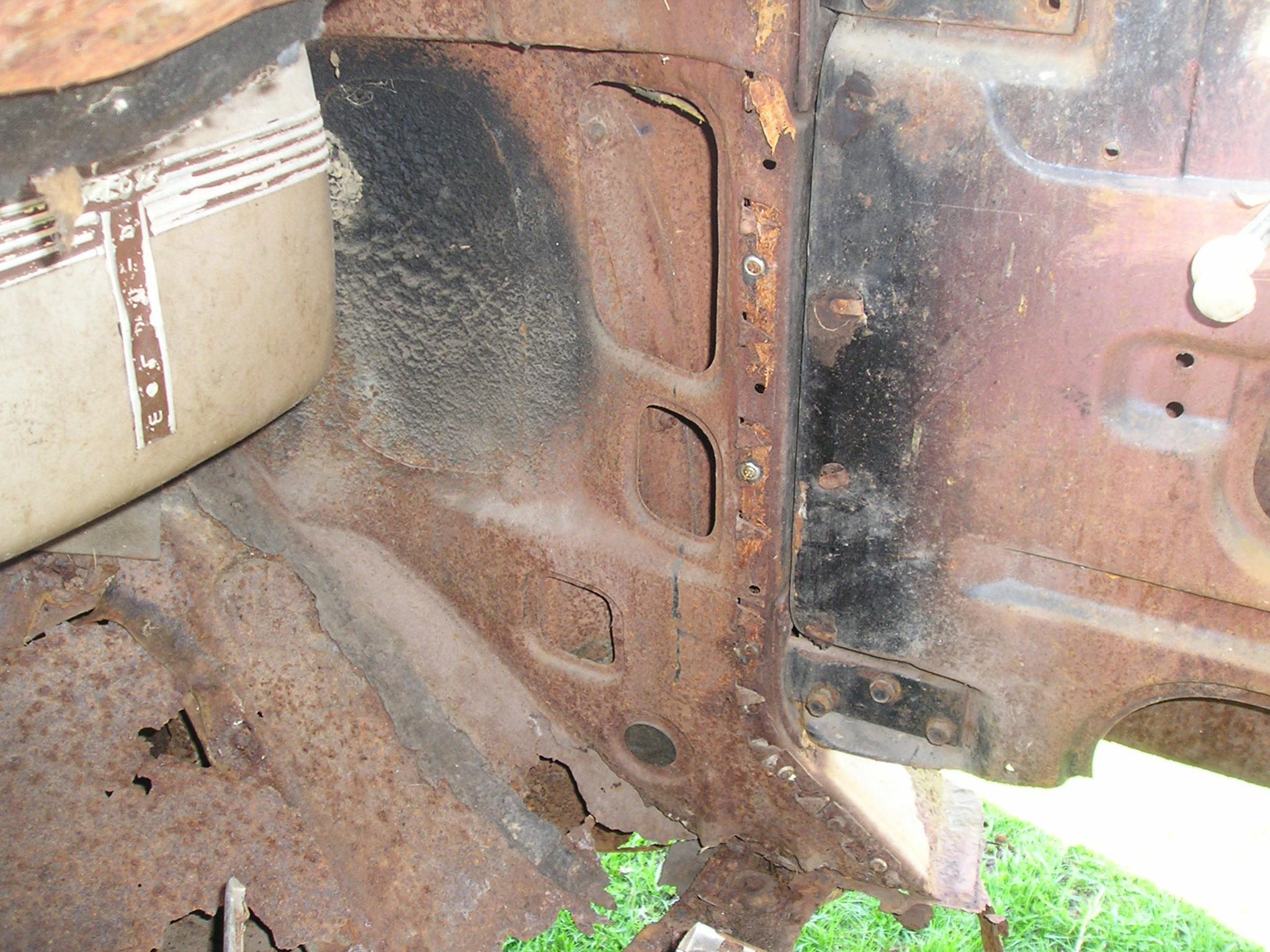

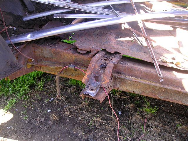

    And a few during pictures. This is the body with the Dakota floor pan attached to the body and bolted to the frame. I used the Dakota's cab floor and the firewall and they are moved back on the frame about 7". The cab floor ends at the rear edge of the door posts. The main hoop for the roll bar sits on top of the rear cab body mounts.
    The frame was shortened 8" just in front of the fuel tank. The truck was a standard cab, 8' box truck. The truck's box floor was also in great condition. The box floor was cut in 1/2 front to rear (wouldn't fit under the body shell without being cut.) The front of the box floor was shortened. The front edge of the box floor is attached to the truck cab floor with a step up of about 5". The box floor is bolted to the frame at the original two box center bolt mounting points. There is a fabricated rear box and body mount that I don't have pictures of.
    Since I quit taking pictured and before the weather turned to crap, I did get both rockers built, but right now the whole works is under about 18" of snow. Gene

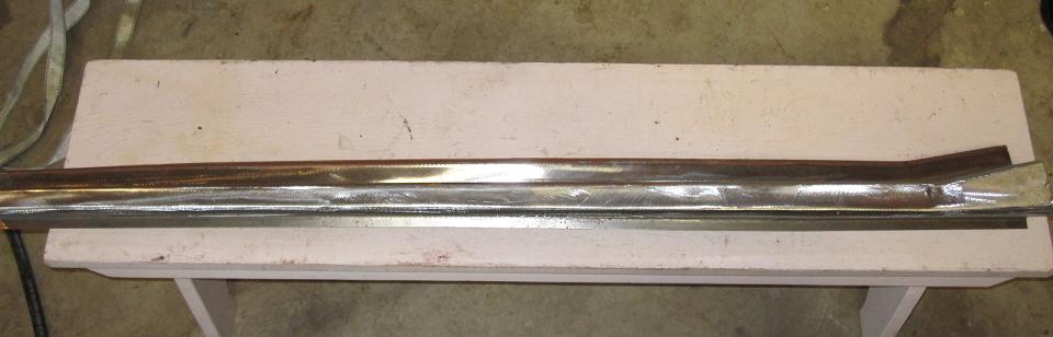

    The biggest problem with the rockers on these cars is the fact that the rockers have compound curves going in all directions. You really don't notice the front to rear curve until you set a piece of something straight in place. Tubing works if you can give it a bit of a bend, front to rear, but if you require an original appearance, you will probably end up spending the big bucks for the repops, if even they are curved. I've not seen them in person, so I have no idea how correct they are. If you look down at the top of the rocker, at the front edge of the door frame, the rocker is closer to the car's centerline then the rear edge of the door frame rocker is and at about the center of the door, the rocker bows outward about an inch more. Then there is a step down and back out of about a 1/2" from the front door post to the rear door post where the bottom edge of the door would fit. After the step, the entire rocker curves down about 2" and then back to the inner rocker. The "bow" with the "step" between the door posts is the problem area. Most replaced rockers I've seen are straight between the door posts and leave a gap at the bottom of the doors, and they are cut narrow and eliminate the "step" and the door bottom sits outside the rocker.
    On my car, the original apperance is of little concern to me. My 48 had the kick out on the bottom of the body which was cut off my car on one side at some time during its history and the remaining side was swiss cheese. I ended up cutting off the remaining side and eliminated the kick out on both sides of the car. When I'm done, the lower body will look like the 30s bodies, with the rockers rolling down under the car. My rockers are fabed from 3 pieces of sheet steel. The inner rocker is a piece of 18G attached to the floor pans and bent 90 degrees to straight down. The outer rocker is formed from 2 pieces, one 18G and one 20G. The top piece is the 18 and starts with a 3/4" lip that has holes punched that will be plug welded to the inner rocker about 2" below the floor pan flange on the vertical surface. After the lip, there is a 90* bend outward for about 2 1/2" where it makes an approximate 90* bend for 1/2" then another approximate 90* bend and a short lip. The double 90* bends form roughly a 1/2 of a box shape. This box like area is where the bottom edge of the door fits. On my car, the door bottom and the rocker are straight instead of having the center bow outward about an inch like the original would have done (sure wish I had pictures of this, right now, the car is under 18" of snow). Keep in mind the bottom 6" of both doors have had the kick out cut off as well, so the door bottoms will be fabricated as well. The bottom of my outer rockers is made from 20G sheet and is rolled (18G sheet steel is a bear to hand roll that's why I used 20G) into a 3" 90* bend with a hole punched flange bent on the bottom. The two rocker pieces are welded together on the inside and painted and will be seam sealed on the outside. The finished outer rockers are plug welded (plug welds are about 1 1/4" apart the full length at both the top and the bottom) to the painted inner rocker (makes the entire inside of the rocker being painted). Then the edges are closed up and it will be lightly puttied. Had I eliminated the "step" for the door, I could have just laid out the "bow" in the rocker top piece and formed a flange then weld the bottom of the rocker to the flange to give myself the curved original look, but then i would have had to reproduce the curve in the door and the inner rocker.
    I think this picture gives you an idea of what the finished lower 6" of my car will look like, you can still see the kick out I eliminated in the front fender, and a picture of what it was originally. Gene

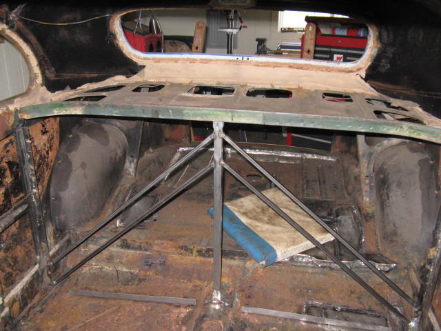

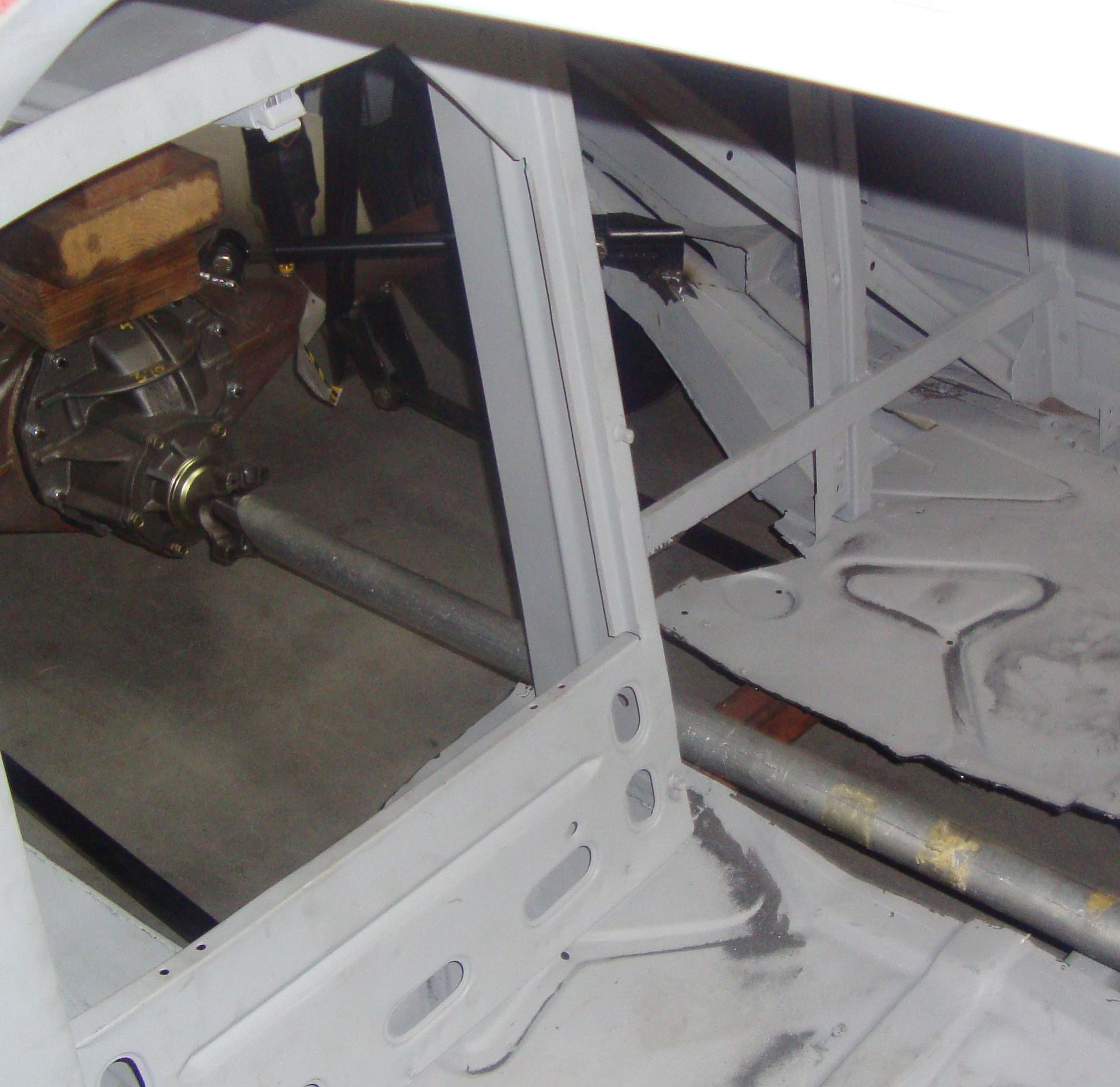

    Ok. Yesterday, I modified the bulkhead that separates the trunk from the passenger compartment. Originally, there was a spare tire well on the interior side of the passenger compartment. It was covered by a curtain of upholstery material. (I didn't take "before" pictures. Sorry.)
    I want my spare to be in the trunk, so I rebuilt the mounts for the bulkhead using 1" sq. tubing and 1/2" sq. tubing. I will mount the original spare carrier on the 1/2" tubing on the driver's side, as I plan on putting the batter on the passenger side near the bulkhead.

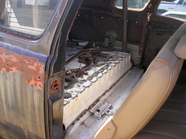

    Just a question Rock, you talk about a spare tire inside the passenger compartment. Was it located directly behind the drivers seat? I seem to have space there for one.... Thanks, Eric.

    No, Eric. It was behind the passenger's seat, right hand side in the U.S.
    The bulkhead was covered with 1/2" plywood in two pieces. There was a central divide that was a formed sheet metal piece about 6" deep. The plywood on the driver's side was about 6" further forward than the plywood on the passenger side and the spare mounted inside the cockpit on the passenger side.
    Does that make sense?
