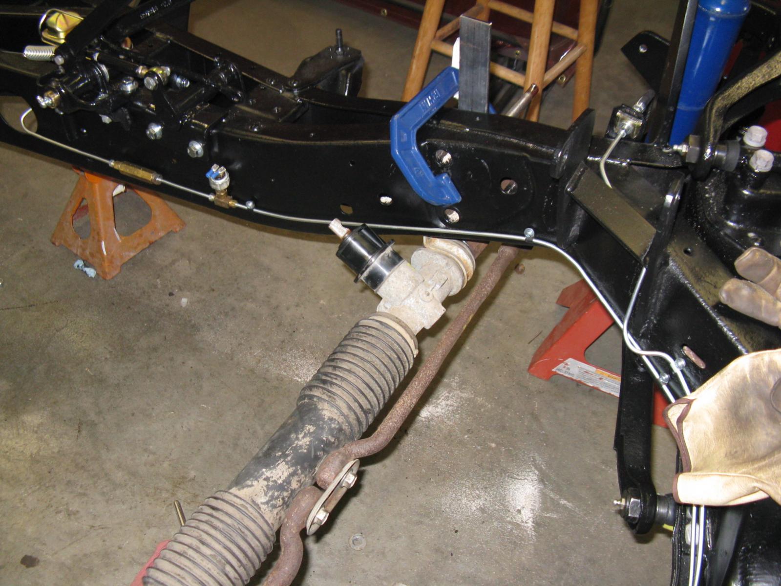

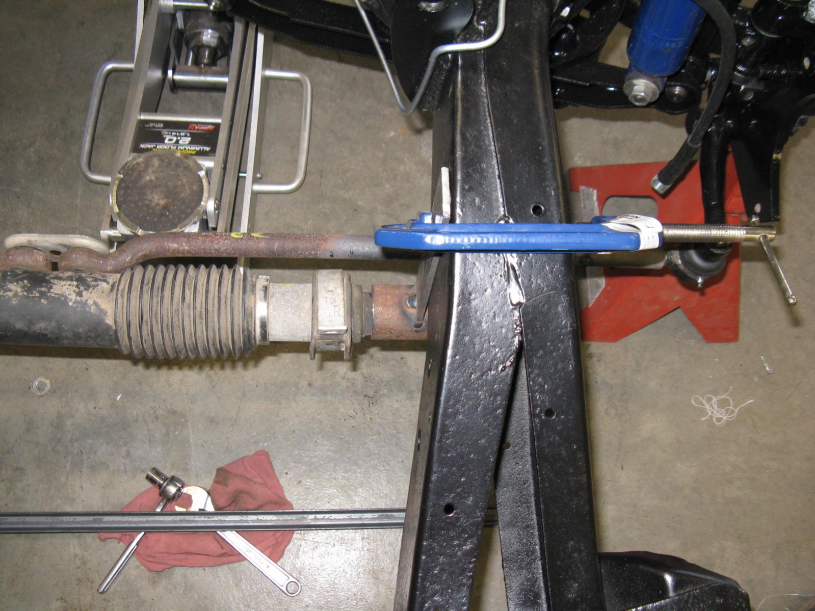

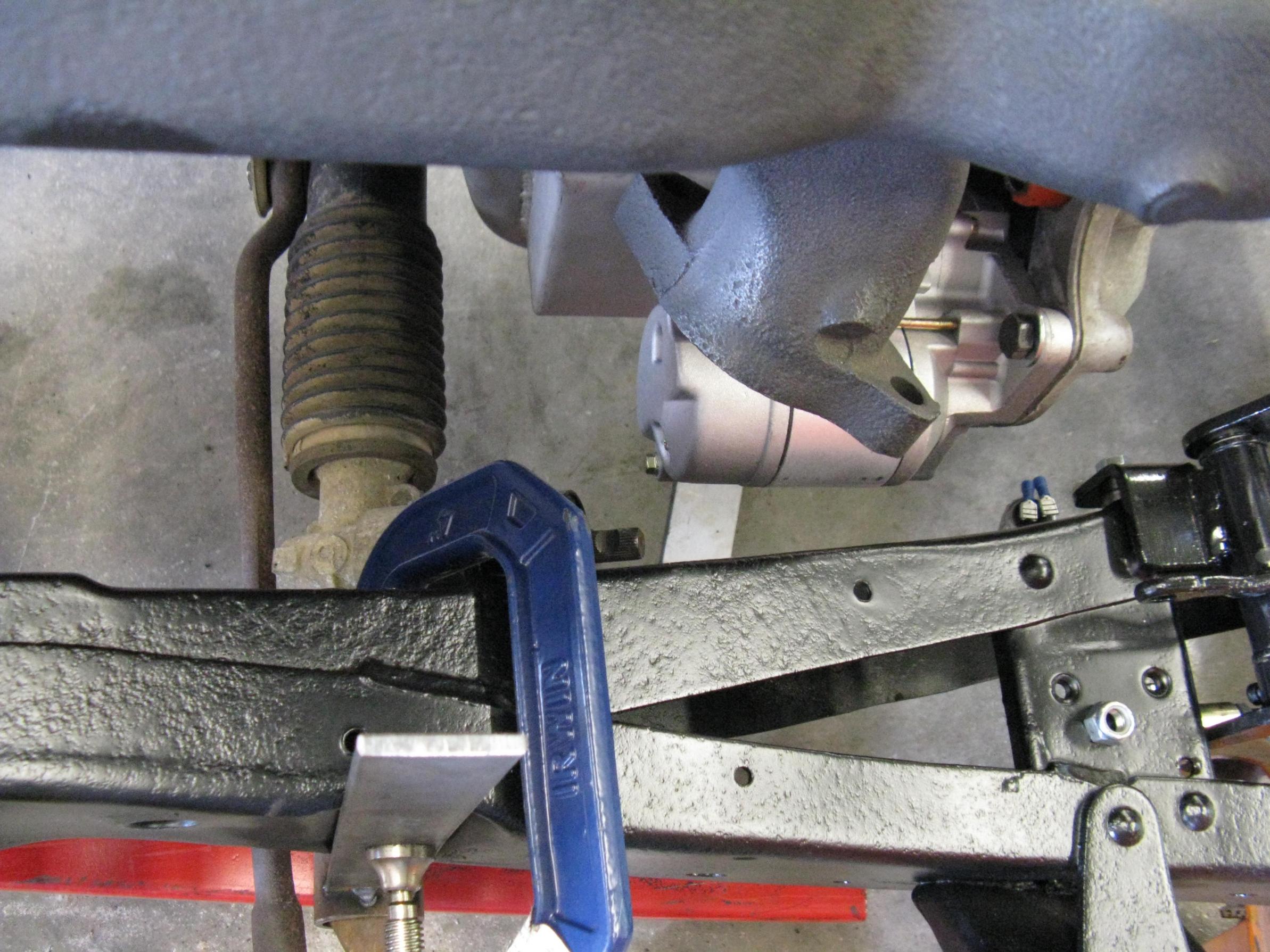

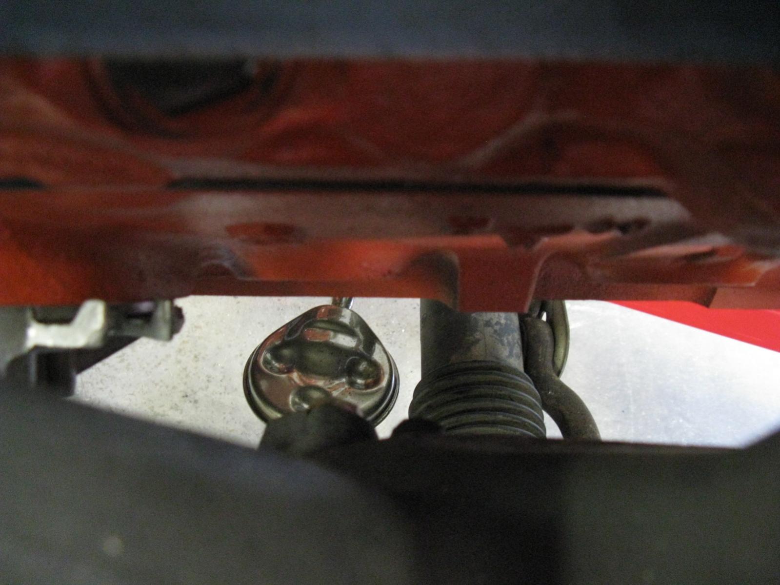

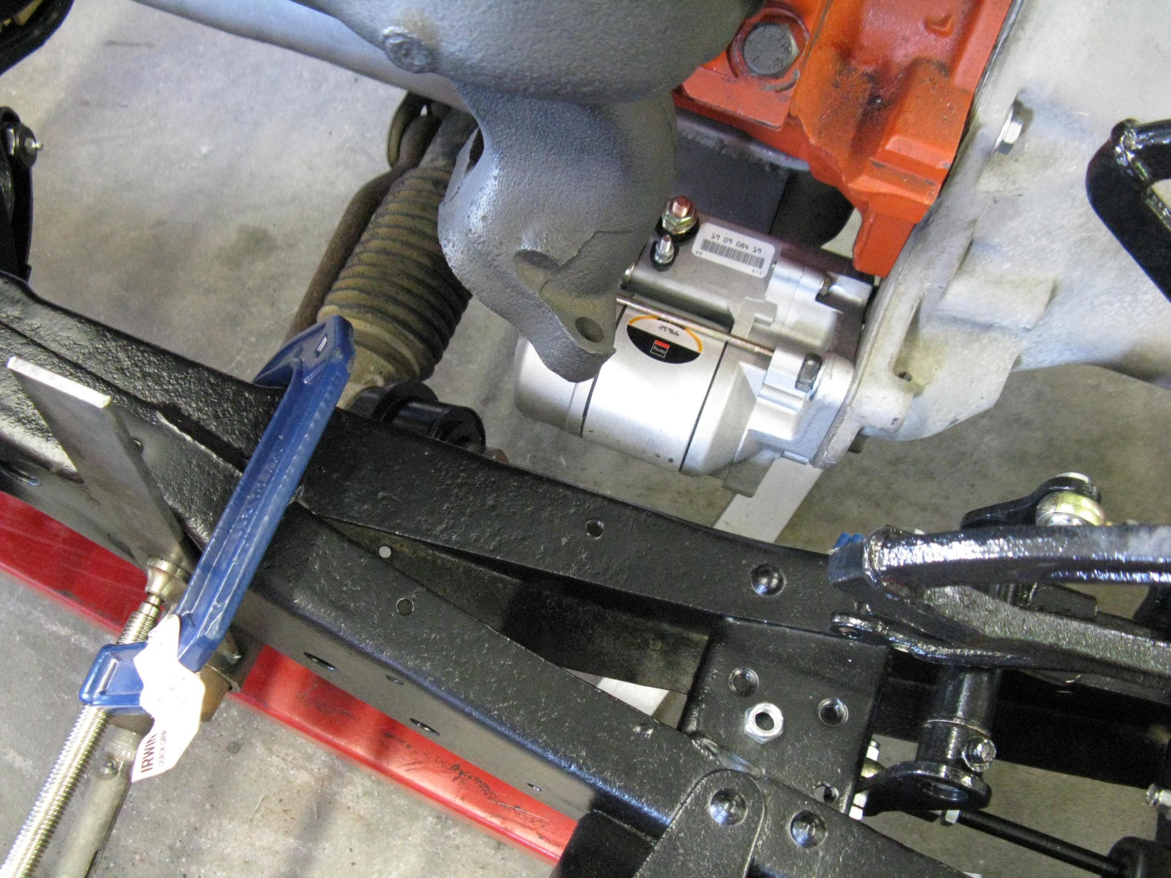

    Okey Dokey. I plunged headlong into mounting my r&p today. I have some obstacles to overcome, the biggest being moving the oil pan sump forward of the rack. Hopefully, that won't be a big deal but I will only tack my brackets until I find out for sure.
    You can see from the pictures that besides the oil pan problem, the '41 ch***is is apparently wider between the rails than some of the later models that have used the Cavalier rack. In order to center the rack up, I had to build an offset box to drop the mount from on the p***enger side, as shown in the pictures.
    I made temporary brackets to hold the rack in place while I jockeyed it into position. Also, I made adapters that let me use the Cavalier tie rods with the Plymouth tie rods. I chopped off the RH thread end of both of my tie rods to make the adaper. I turned down the RH thread end of the Cavalier adjuster until it just fit the i.d. of the old tie rod. I also had to shorten the Cavalier adjuster and the Plymouth tier rod thread on one side.
    Curiously, the tie rods I got with my r&p are not the same length. One is a 1/4" shorter than the other. They are now equal length and as parallel to the steering arms as I can eyeball it. The reduction in bump steer will be infinitely better than the OE setup.
    If I don't have troubles with the oil pan (doubtful), this will have been a relatively easy install. It just required a little noggin' scratchin'.

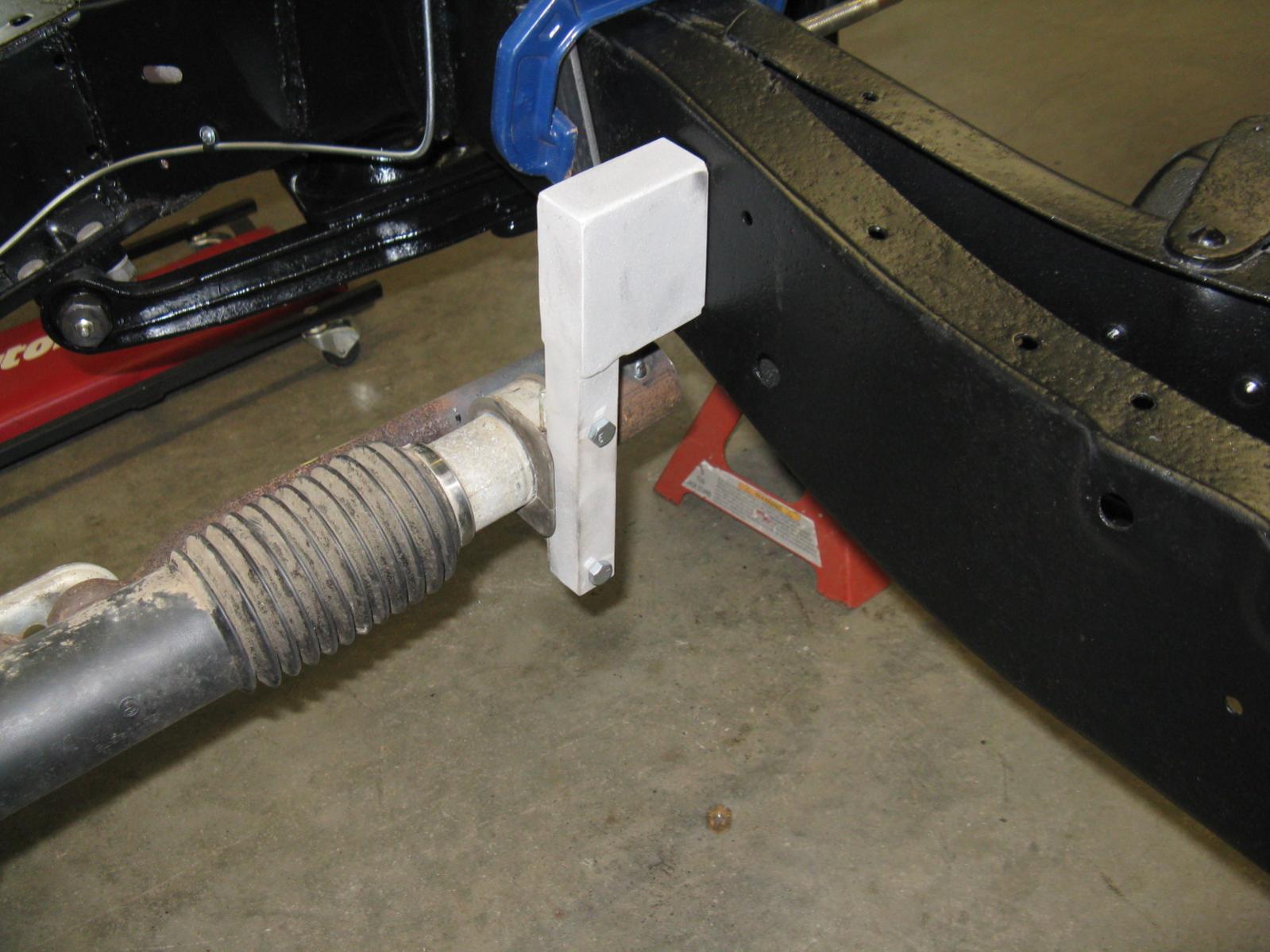

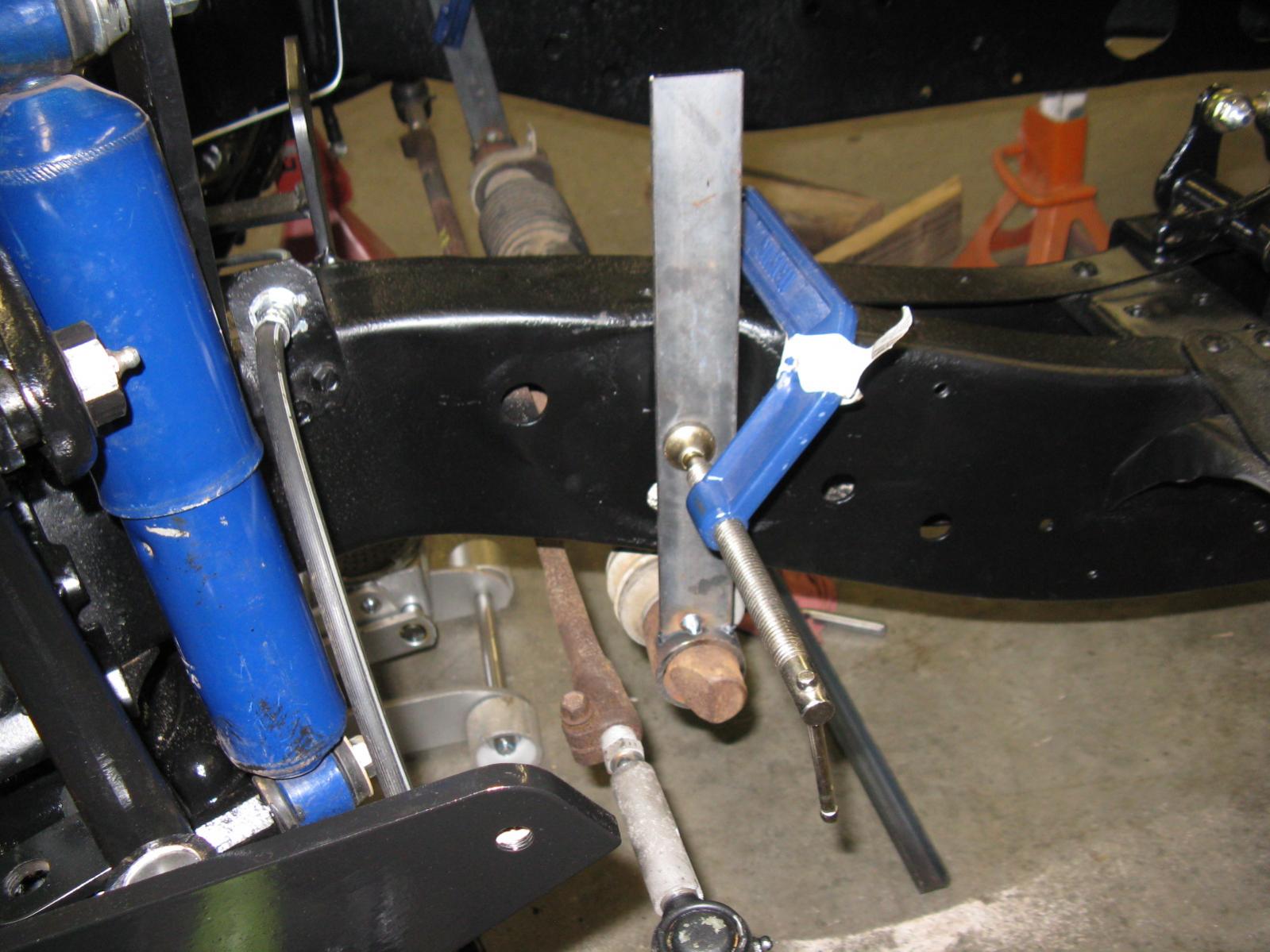

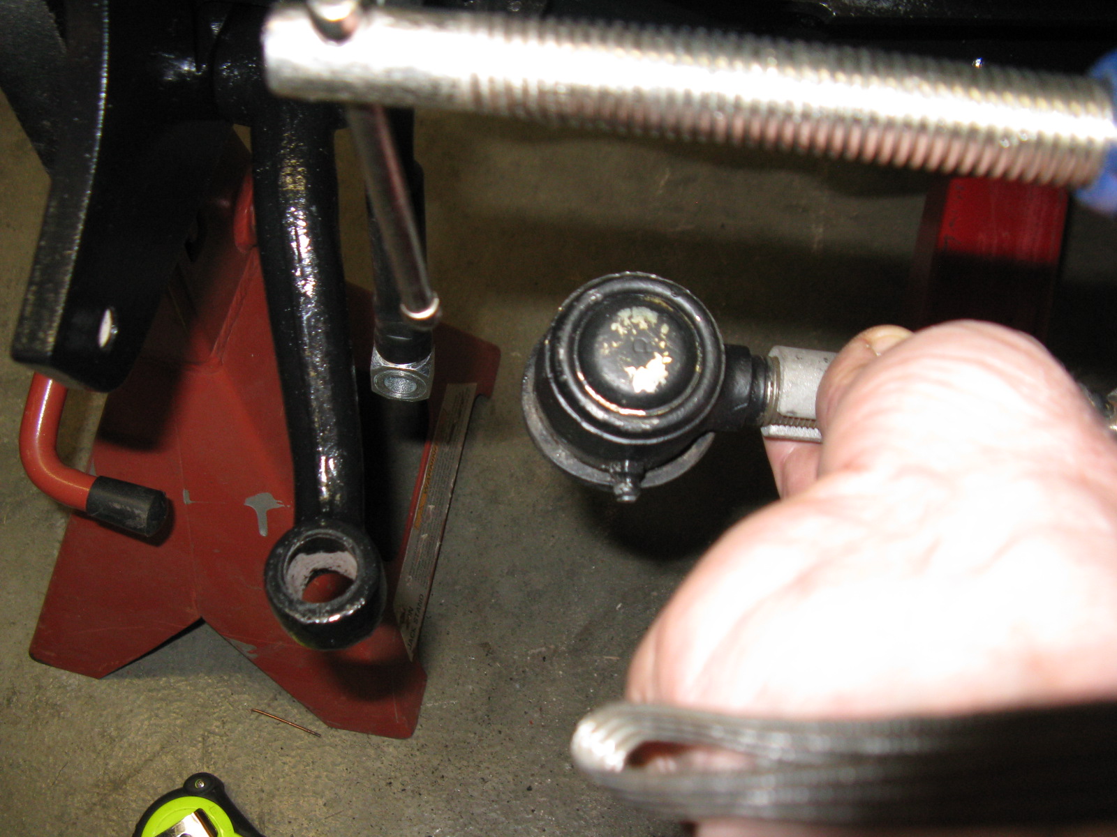

    And a few more pics, including the offset box and the tie rod adapters. Of course, the offset box will have a gusset of some descrption, after I'm sure it all works out.

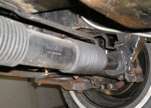

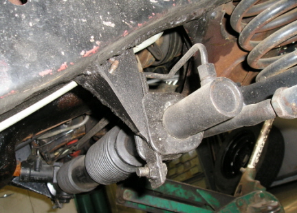

    Question, Can you move your rack froward a couple inches, closer to your cross member? The long tie rods can be bent towards the rear after they clear the rack to match up with your steering arms. If you look at the first picture I posted real close, you can see the center of the rack is actually forward of the tie rod ends and the long tie rod part curves towards the rear about mid way along the length. That would give you more clearance for the rear pan sump.
    The rack I have pictured is on a 39 Plymouth frame. My rack was a power steering rack, it could have had a longer body, I suppose. Gene

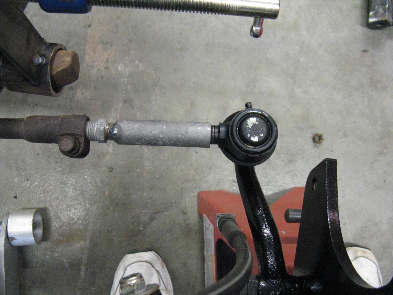

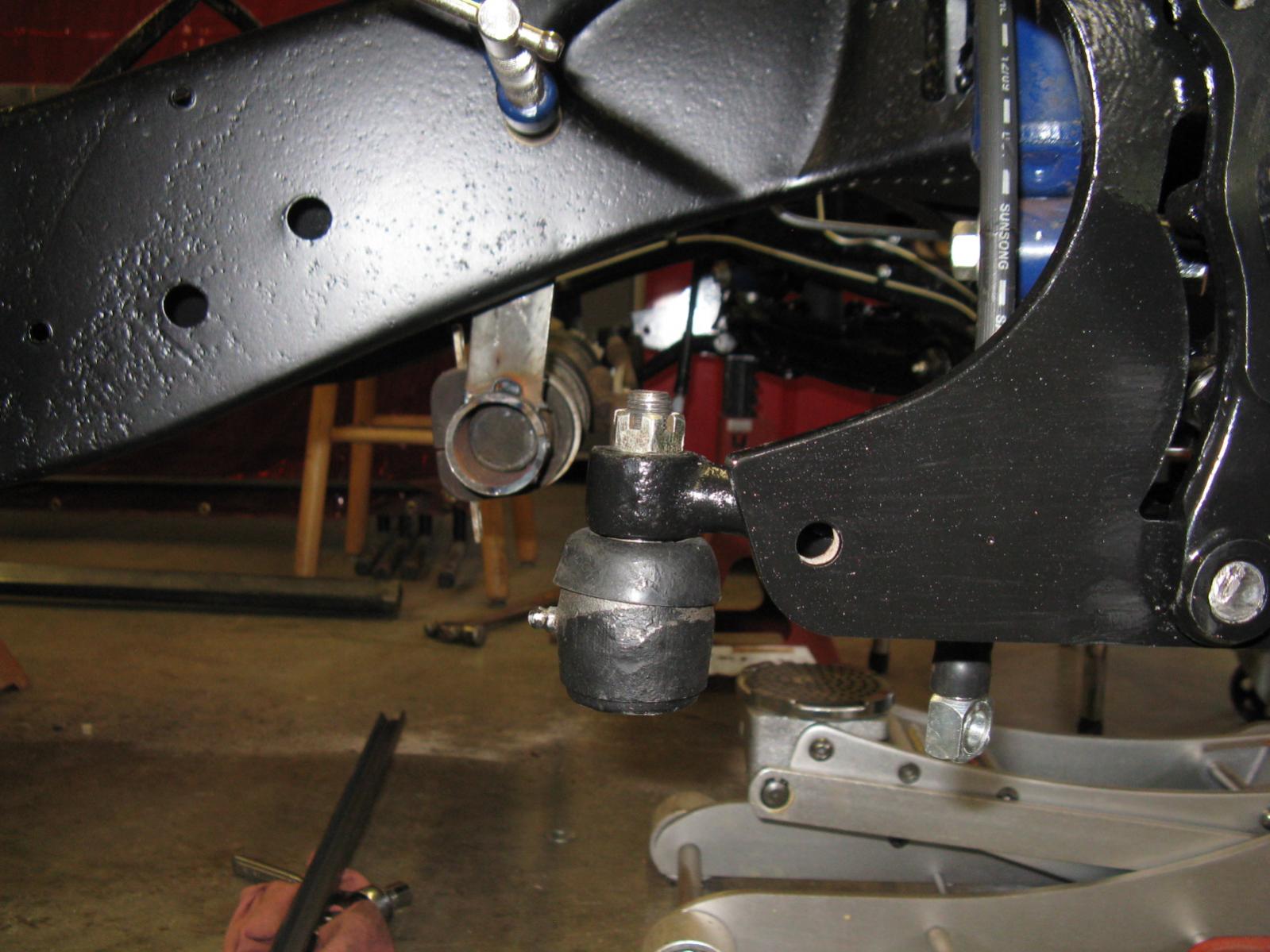

    Well, I moved the rack forward about 2 1/2"- 3" and the engine sits over it perfectly. The problem now will be coming up with a tie rod design that connects point A to point B reliably and still offers toe adjustment.
    On the Driver's side, there is little room between the end of the tie rod and the rack housing when turning to the right. That tie rod will have to be bent at a 45 degree angle straight to the steering arm. The picture where I'm holding the tie rod end up and showing the steering arm is at the right turn lock of the r&p, so visualize connecting the point from the center of the tie rod end to the center of the steering arm hole.
    Since there will be a short 45 degree bend straight to the tie rod, there can be no adjustment in this section. I'll have to drill and tap that end, screw the tie rod into it and locknut it down. Then, the adjustment will have to be somewhere in the middle portion of the tie rod.
    The material the tie rods are made from is approx. 3/4" solid round stock. So, I think I can heat and bend it and it will still be adequately strong for a tie rod, even with the 45 degree bend in the end. I do need to check and make sure the 45 degree bend won't interfere with the steering arm when it is in opposite lock.
    Did I miss anything? Suggestions? I'm a little concerned about keeping the "bent" tie rod in plane when the adjuster is in the middle.
    Thanks!

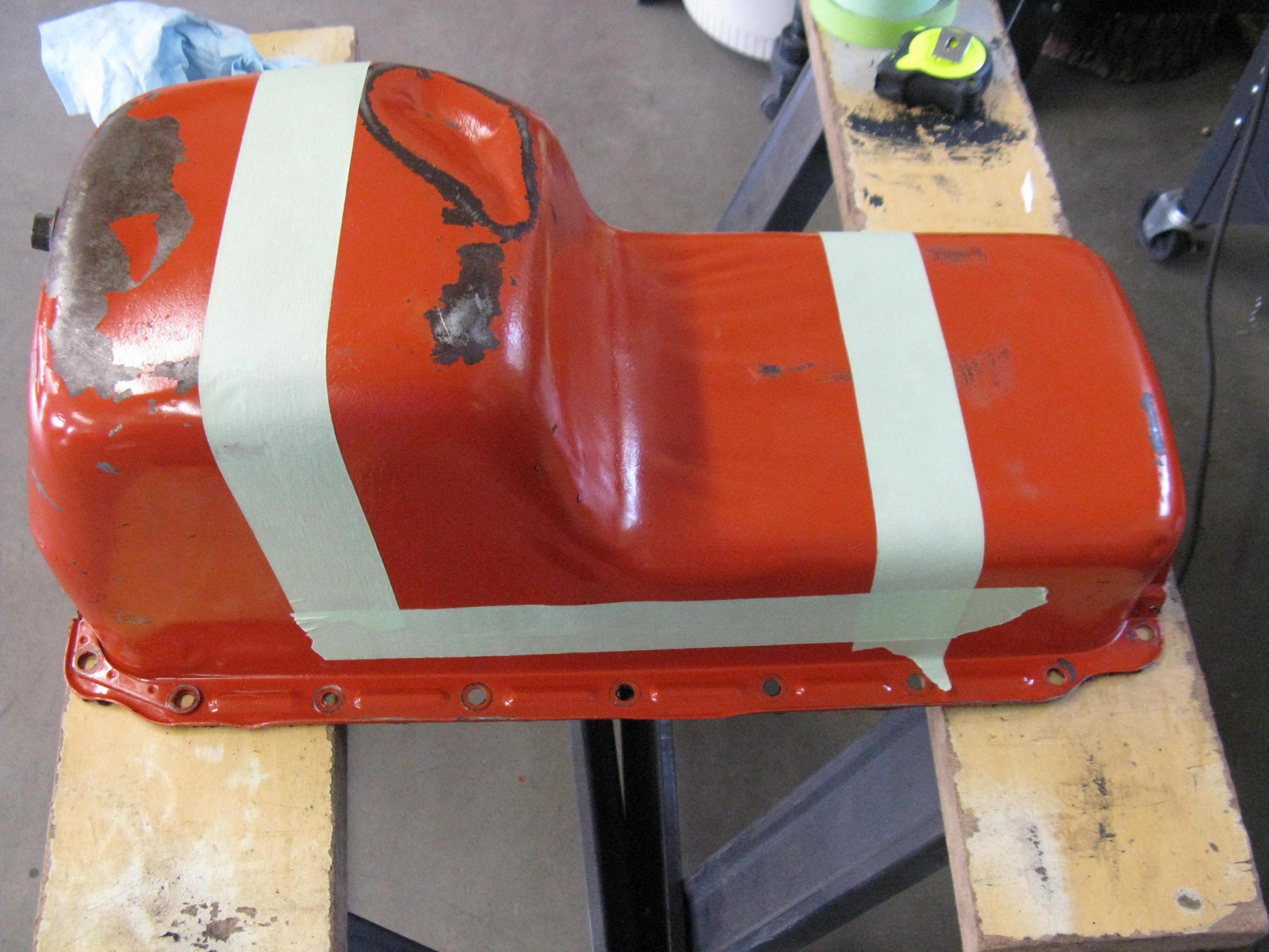

    After further contemplation, I am going to try oil pan surgery as my first option. I don't like the idea of having to bend the tie rods with as much offset as I'm going to have to.
    My oil pan is already dented, so it's no big loss if I screw it up. :)

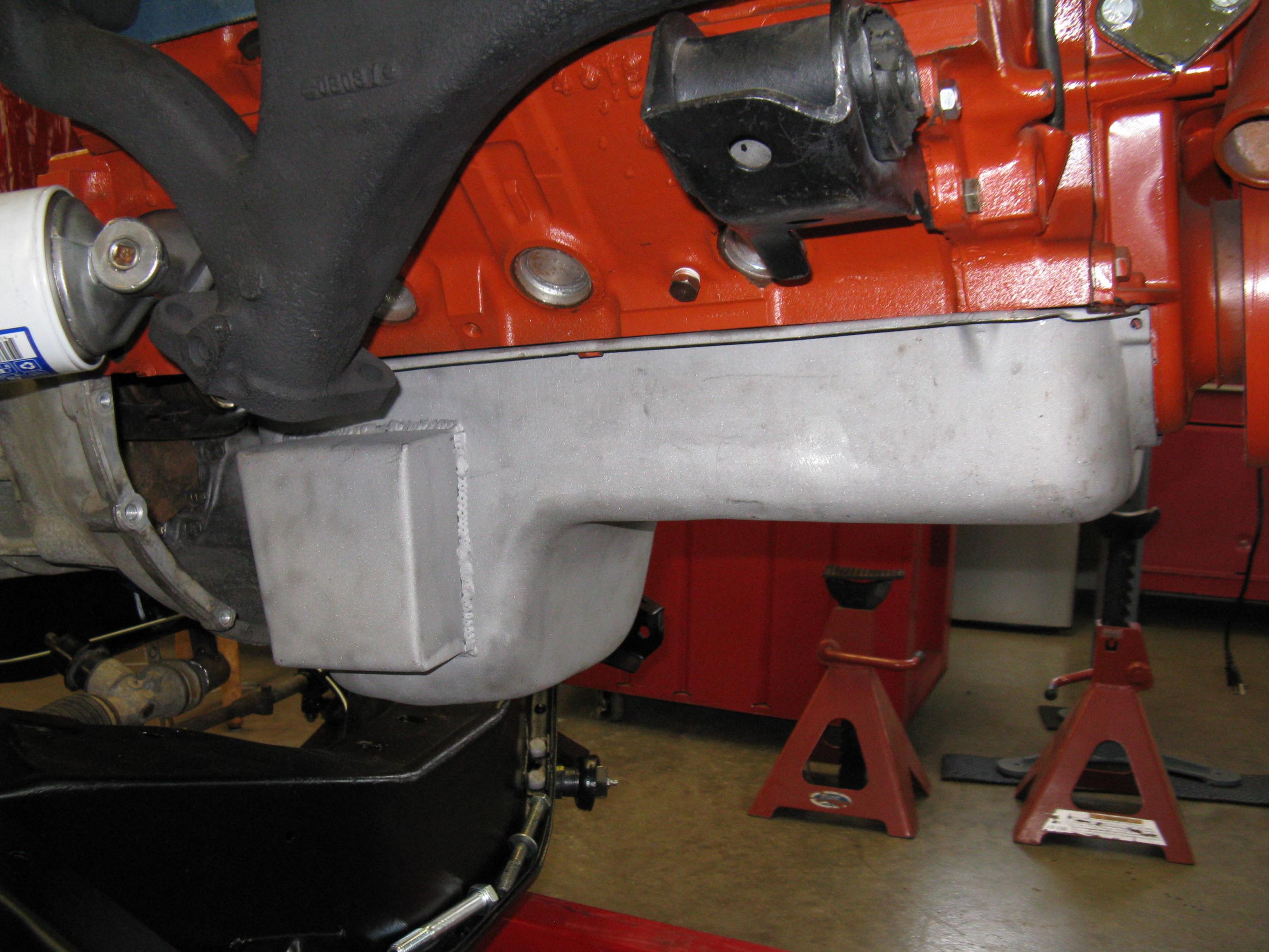

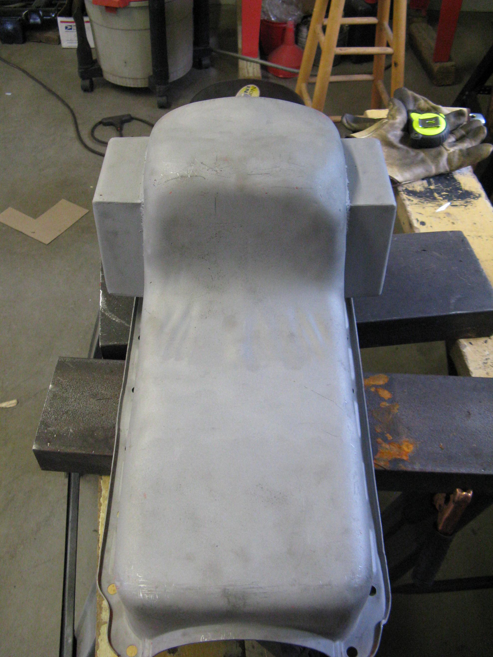

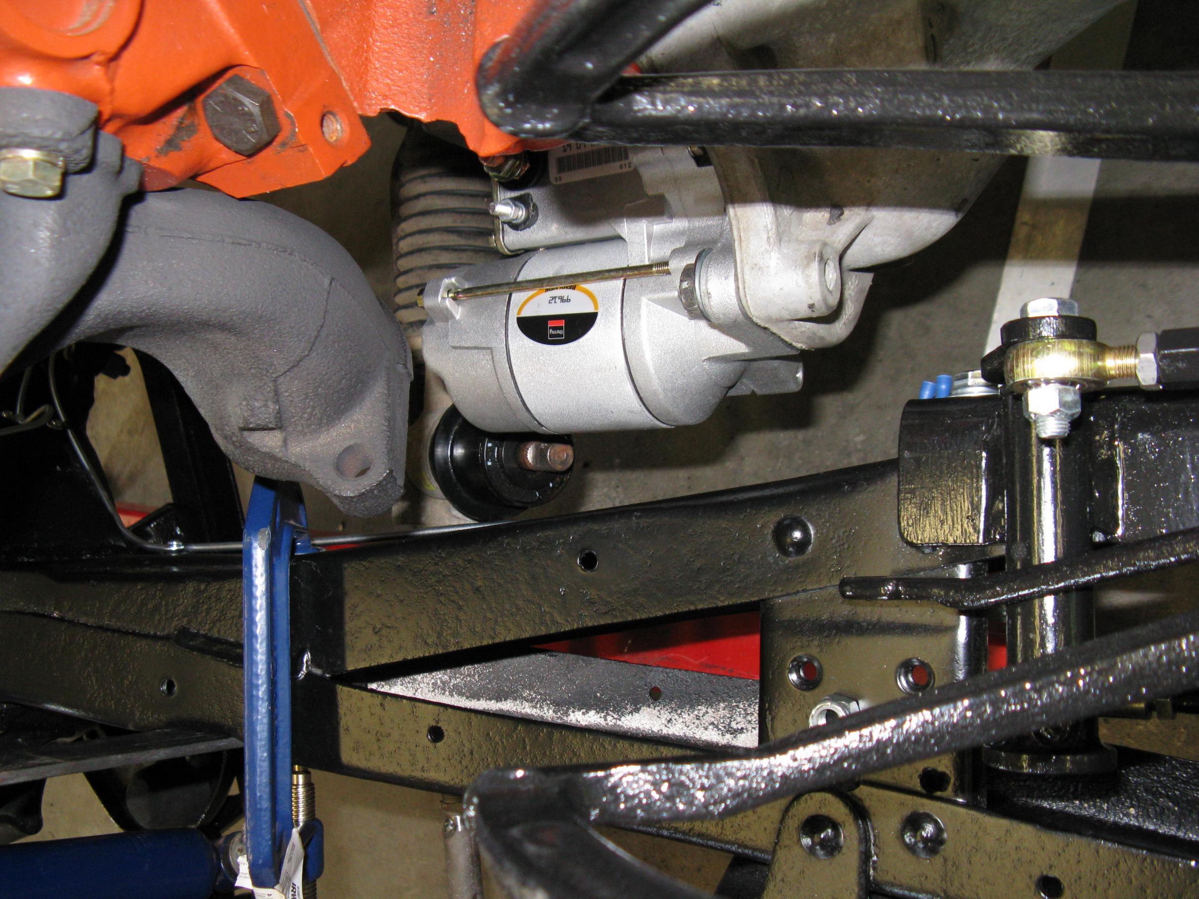

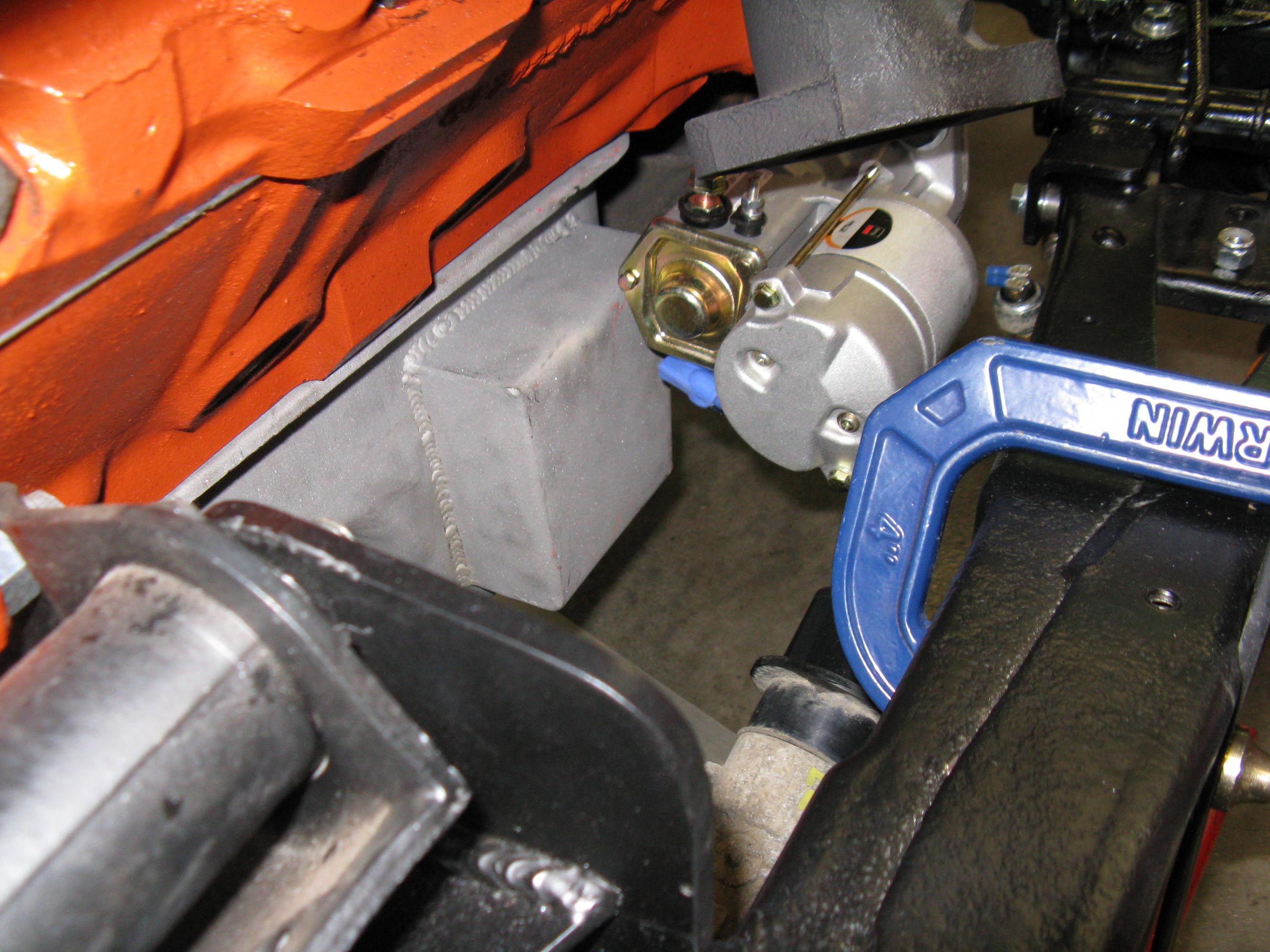

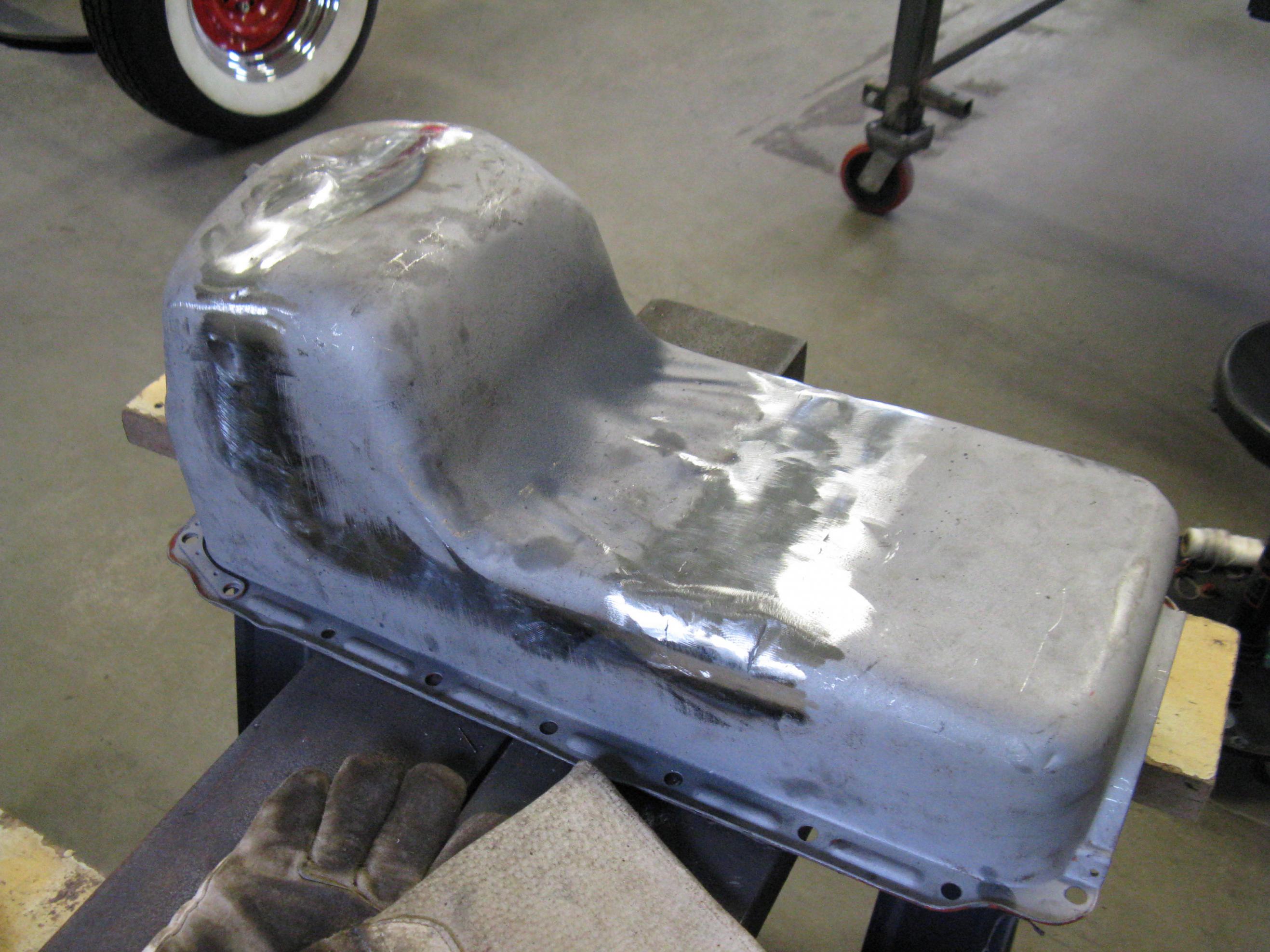

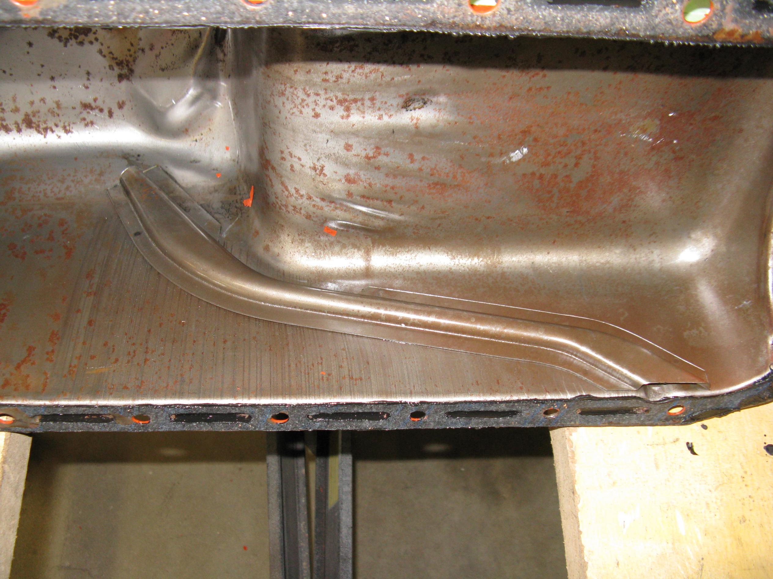

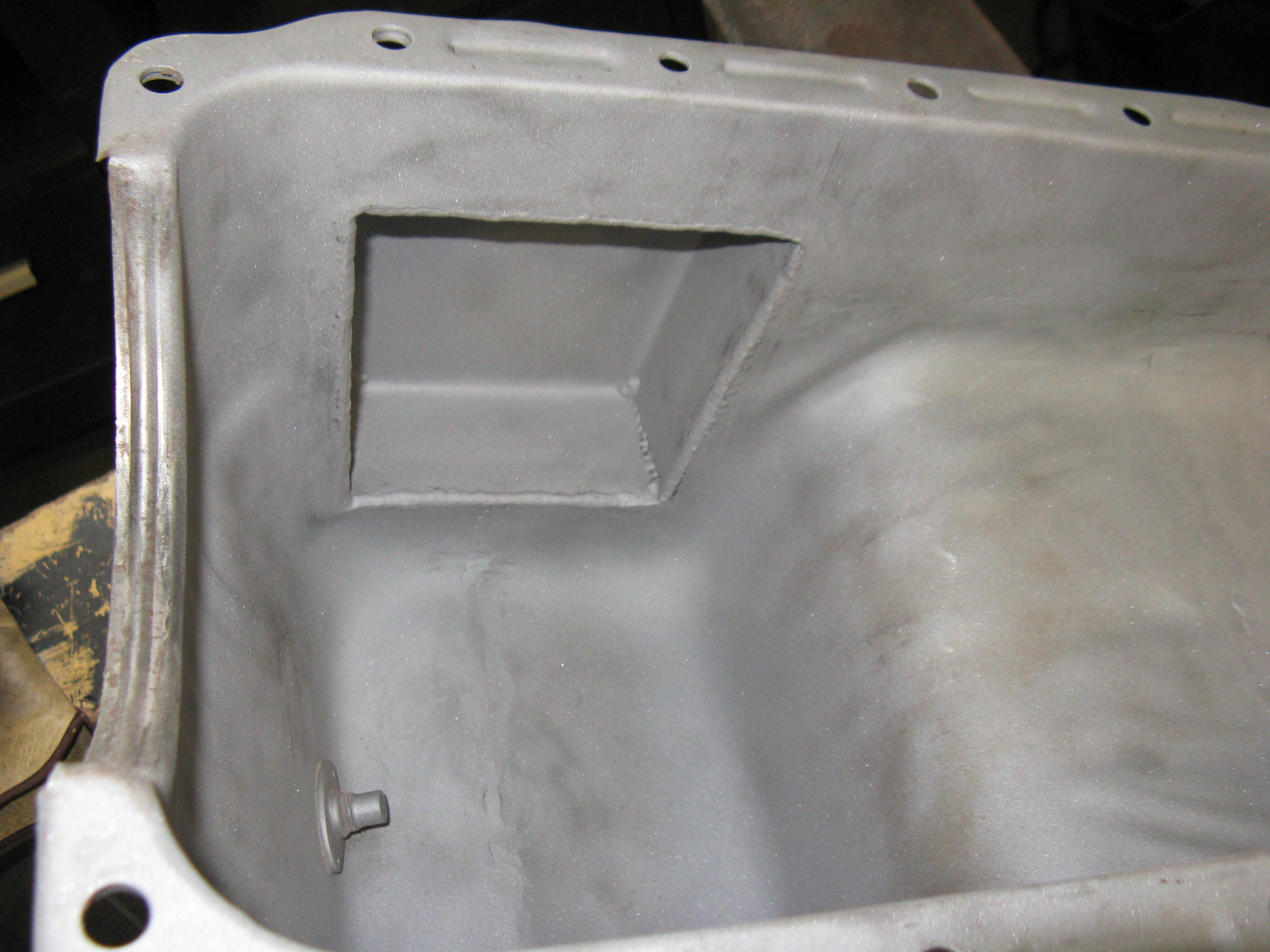

    Well, I modified my oil pan this weekend and I'm pretty happy with the way it all worked out.
    First, I had to take a 2" slice out of the sump and narrow it to gain room for my rack and pinion. The pictures will show how that was accomplished.
    Next, I calculated that I had removed about 96 cu. in. of oil capacity, so I had to add it back somehow. I first thought about adding 2" to the depth of the sump and that would have given me the capacity back but it would have been sitting only about 6" above the road and I thought better of it.
    Since I had plenty of room on each side, I opted to add "saddlebags" to the pan. Each compartment is roughly 5X5X2 or 50 cu. in. Actually, I tapered the box from 5" to 4 1/2" on each side, so I'm sure I'm right at 96 cu. in.
    The only modification I had to make to the pickup was to twist the oil pickup tube so that the pickup was moved backward about an inch. I now have to figure out how to get a dipstick that is 2" longer. Anyone got any suggestions? Also, I have to weld a guide tube in the pan for the dipstick. Since I had to cut on the original and since I was bead blasting it, I decided I didn't want any crevices for abrasives to hide, so I took it completely out.
    All welding was done with MIG, except the inside seam of the "saddlebags, I gas welded those. I had only two leaks to touch up, so I think I'm good. The saddlebag on the Driver's side clears the starter by about 3/8".

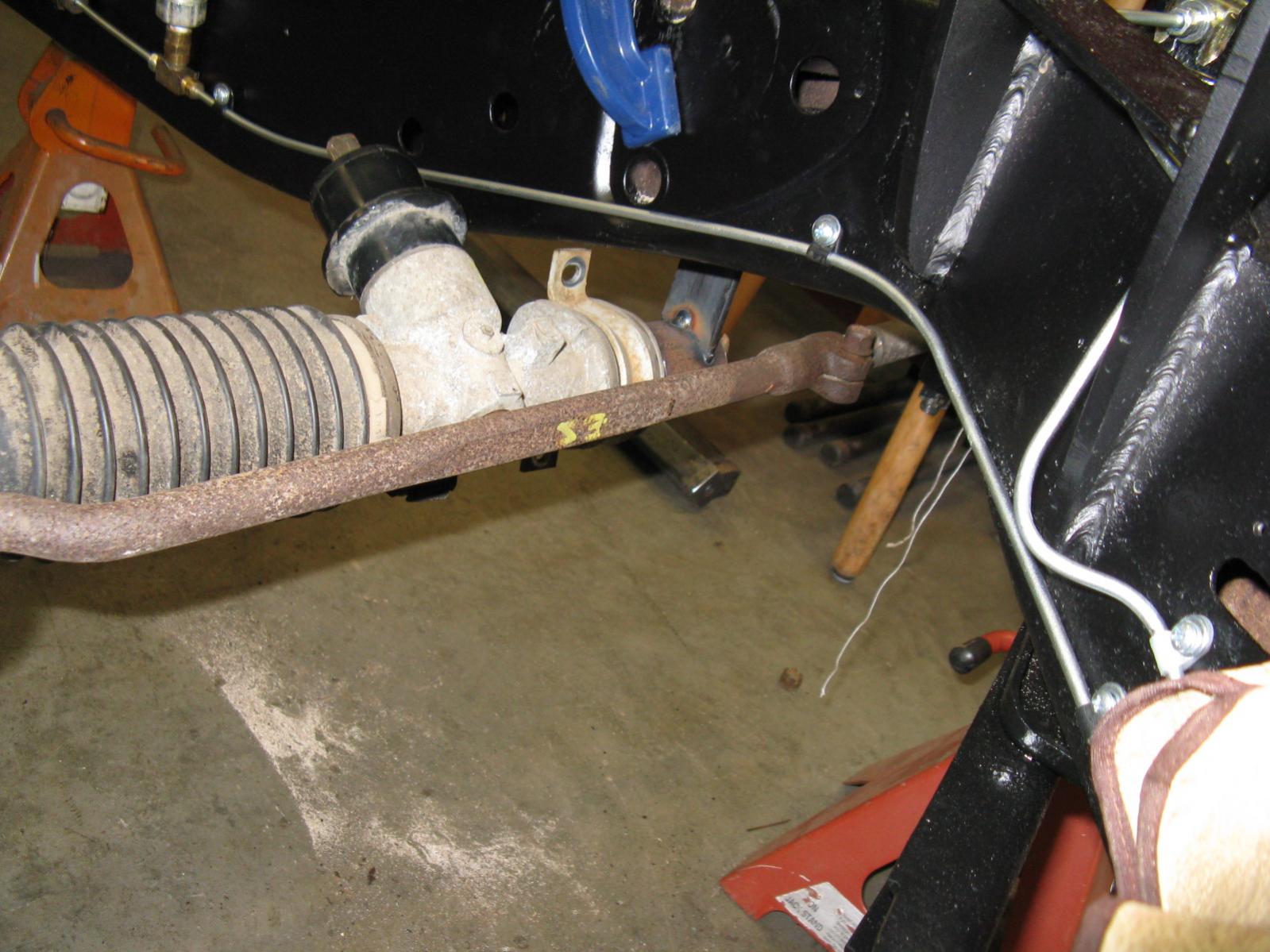

    After getting my oil pan project finished up, I'm now working on the final details of the of the rack and pinion installation. As you will see from the pictures, I am putting about 10 pounds of excrement in a 5 pound bag. It all fits but routing the exhaust pipe is going to require a lot of tedious fitting, it appears.
    Also, connecting to the steering rack is going to be tight but doable..................I think. I won't know for sure until I get the body and the sterring column mounted. The steering column may have to be canted ever so slightly to the left. It's tight.
