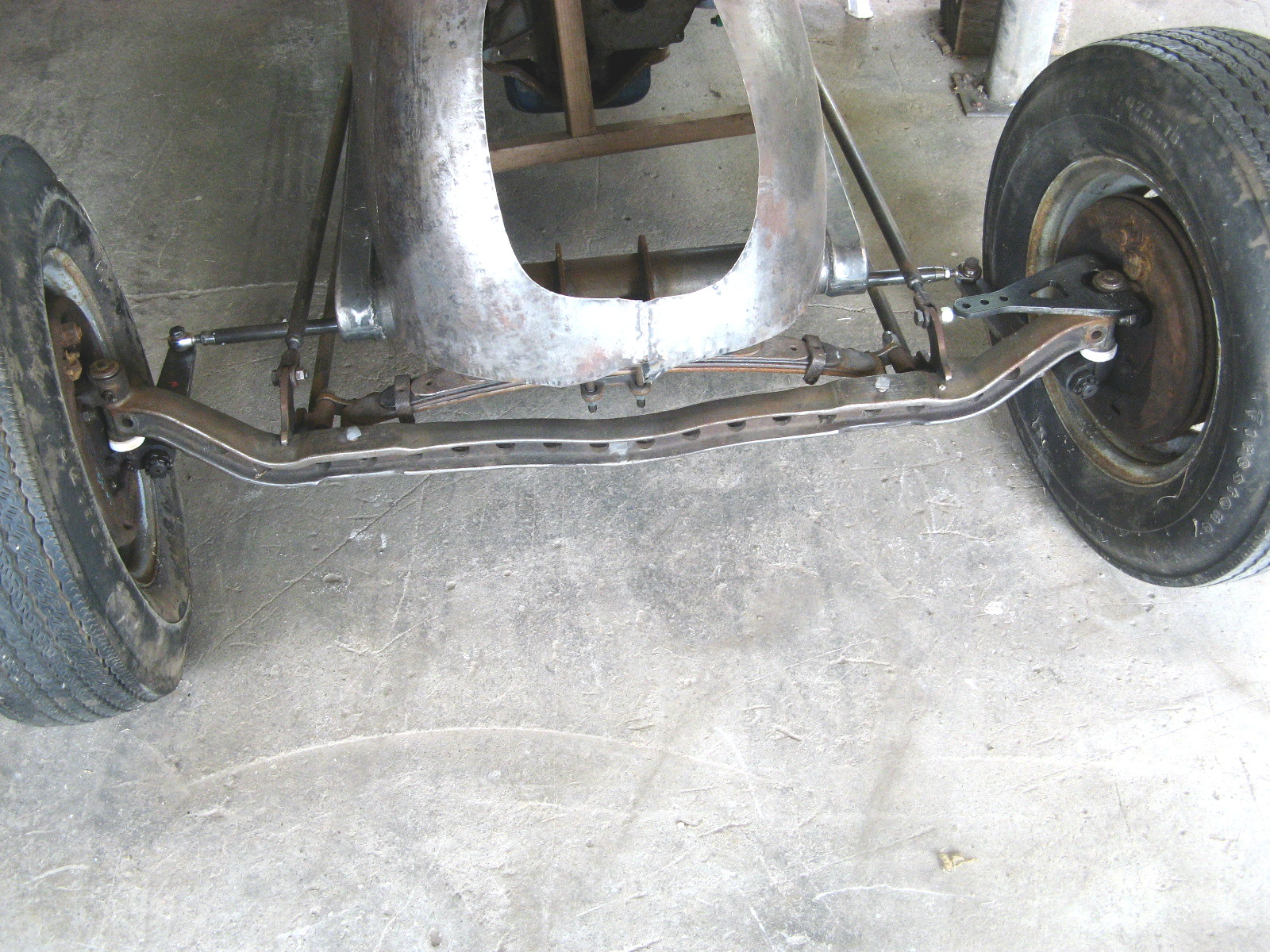

    I think the '46 truck axle is actually an elegant looking axle. At least it has the potential to be. I used one in my champ car because it has several advantages over the Model A axle.
    It has a dropped kingpin boss.
    It has a depressed center for additional oil pan clearance.
    It comes with adequate hydraulic brakes.
    It is strong enough to be narrowed .
    I narrowed mine 6".
    Drilled.
    Removed the dual spring pads.
    Used a Model A spring with fabricated batwings.
    Smoothed.
    Gonna paint it silver to look alumnum-ish, like the backing plates.
    000 sr_108.JPG Front Steering03.jpg Front Steering04.jpg paint 11.JPG paint 12.JPG

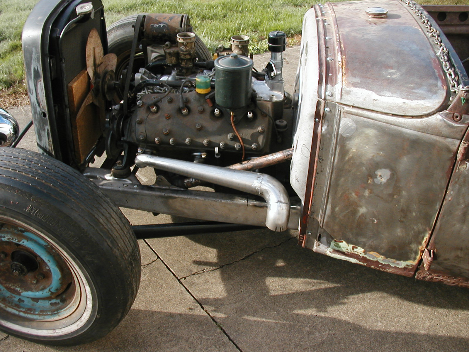

  8. Why not just use the Axle and Spring as is? This happens to be a 39-40 unit. Just install an AA crossmember to accommodate the wider spring and you don't need to drop the Axle to get a nice stance. You do however need to do something to get the wheelbase back to where you started.
    P.S. I don't think or build like normal home builders.
    46international and Okie Pete like this.

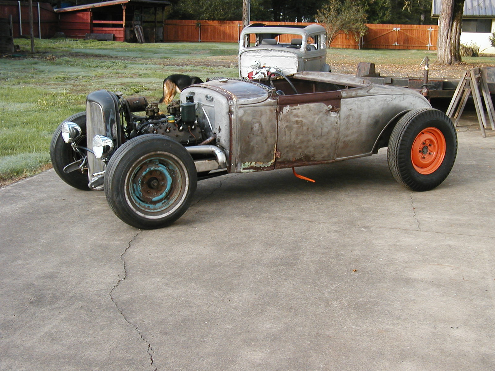

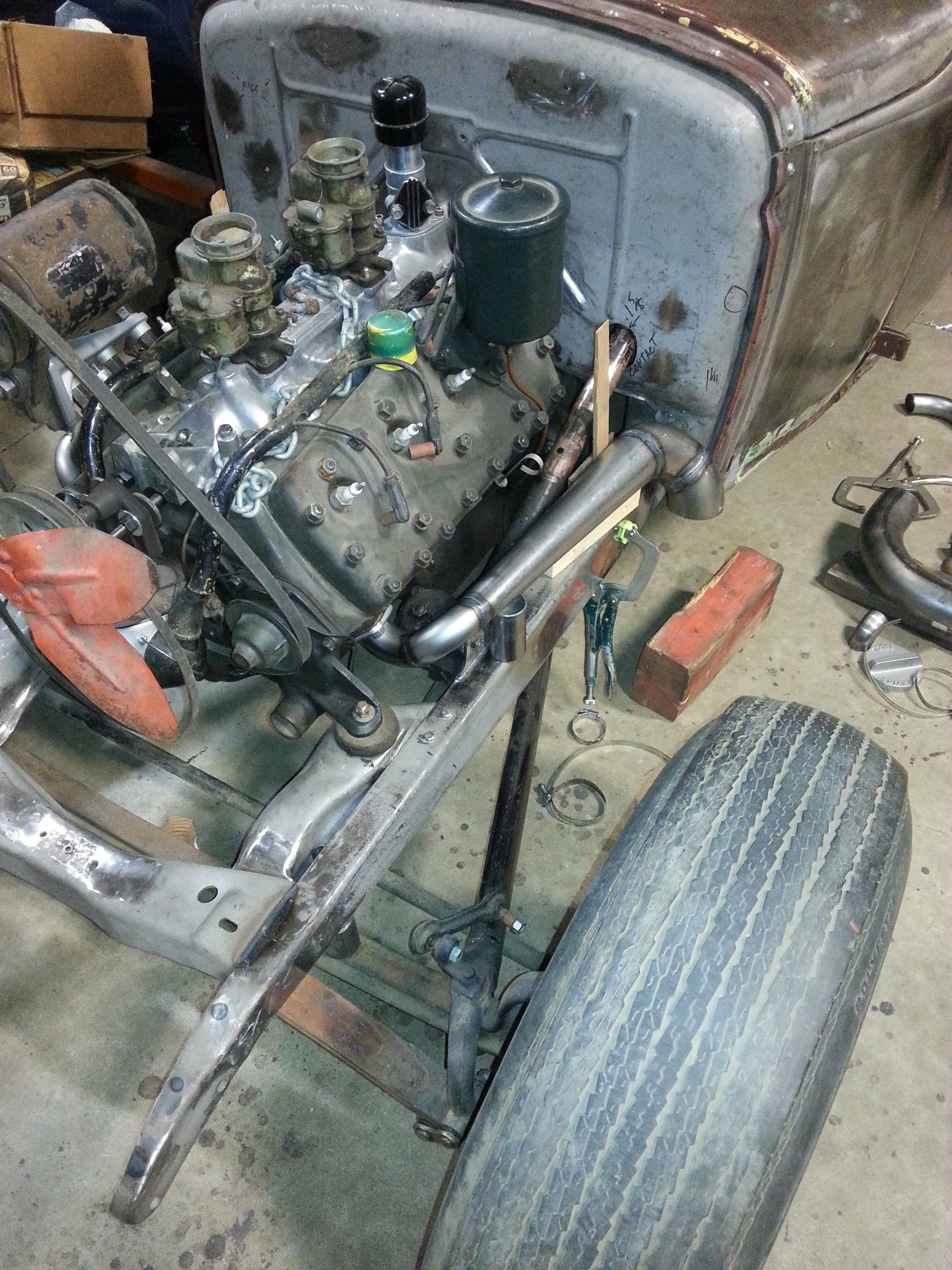

  9. Here's how it looks with No frame kick at all and the wheelbase is exact to Stock Model A. No ********!
    Look at the Firewall clearance and a manual Fan with 1" space to rad core as needed. Think for yourself and do some Math and save your $$$ for other things.

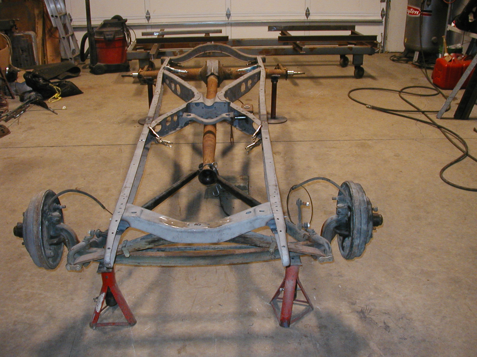

    Here is one from back in the day; but with modern updates.
    Still, better choices could be made.
