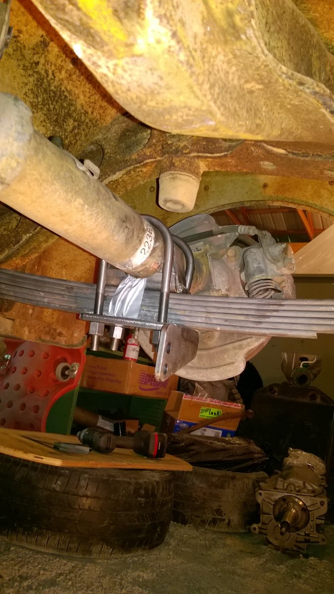

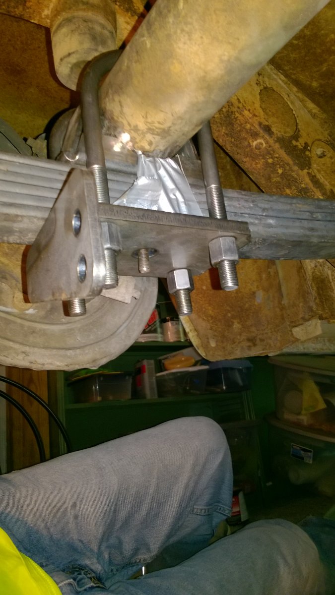

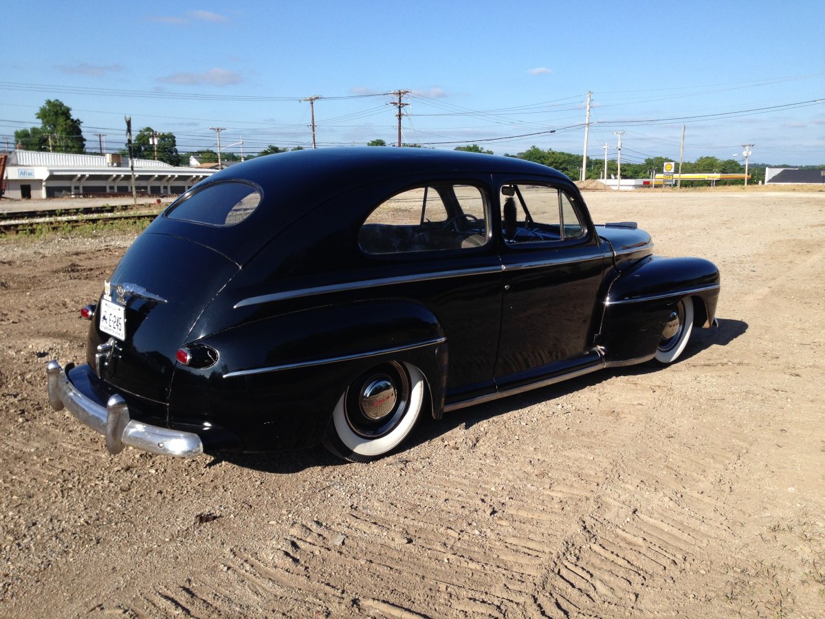

    I used S10 leaf springs & brackets (with lowering blocks as well) S10 clip up front ( not bagged) IMG_0016.JPG IMG_0018.JPG IMG_0033.JPG IMG_0035.JPG

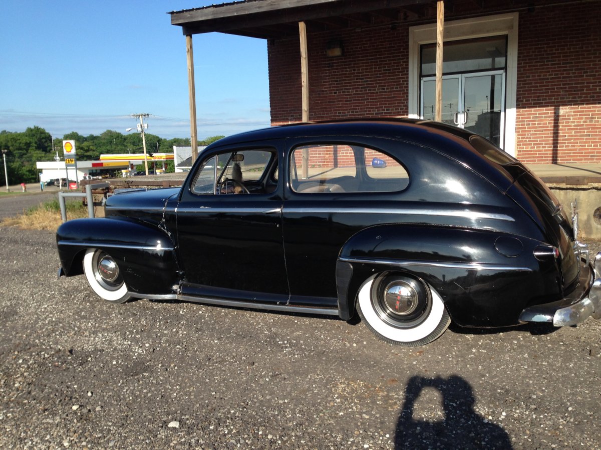

    That's pretty low. Did you C-notch the rear frame so the axle doesn't hit it when you go over bumps? Mine's not quite as low as yours yet and I'm still worried I'll need to notch the frame. I changed out the original bump stops to Energy Suspension versions I got from CE that are shorter.

    no C notch, no bumpstops ,good shocks, no bottoming out.
