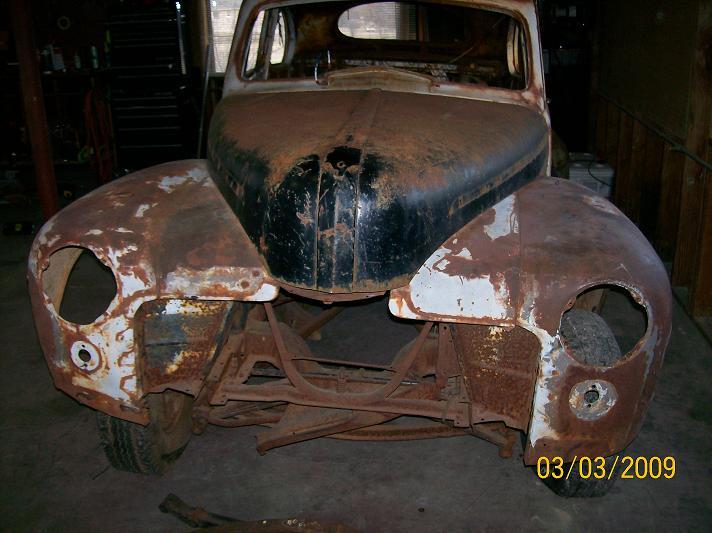

    [​IMG]this is my project[​IMG]

    this is after i put a dropped axle with split wishbones, reverse eye spring and leaves taken out and longer shackles without engine and small tires.[​IMG]

    your welcome. thanks, i want to see it when you get it done, it will look sweet. it does look lower in person that was a bad picture

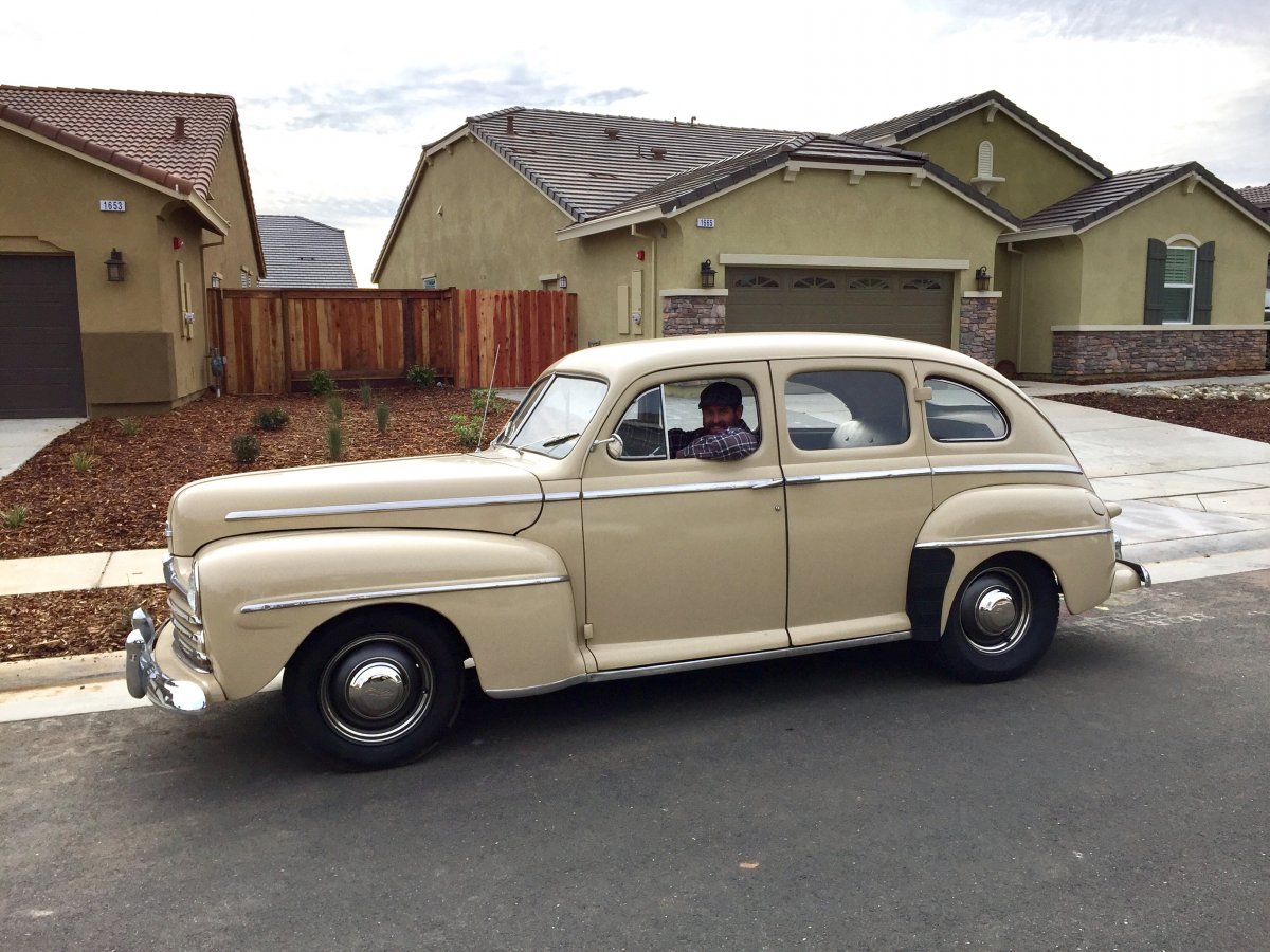

    47 left me 1.jpg Old Thread I know. but mine is a 4 " dropped axle. and stock "looking" spring and is still to high in front, posies says mine is flat, and theirs is 3 '' drop but the arch will make it sit the same as a worn out stock spring, is he correct?
    By The the way that 41" sedan sits perfect, I want that, but a nice new spring?
    also, when the spring is flat, or lower, do you need to heat, and bend the pan-hard, cause my shackle angles are uneven
    Thanks Rick ][​IMG][​IMG]

  25. Cosmo50
    Joined: Sep 8, 2011
    Posts: 225
    Cosmo50
    I love your 41. That is what I want mine to look like. Did you have any problems with the tires rubbing when turning?

    Chris
    No, never rubbed. I just got my 46 lowered up front with an original stretched axle and new Posi spring
