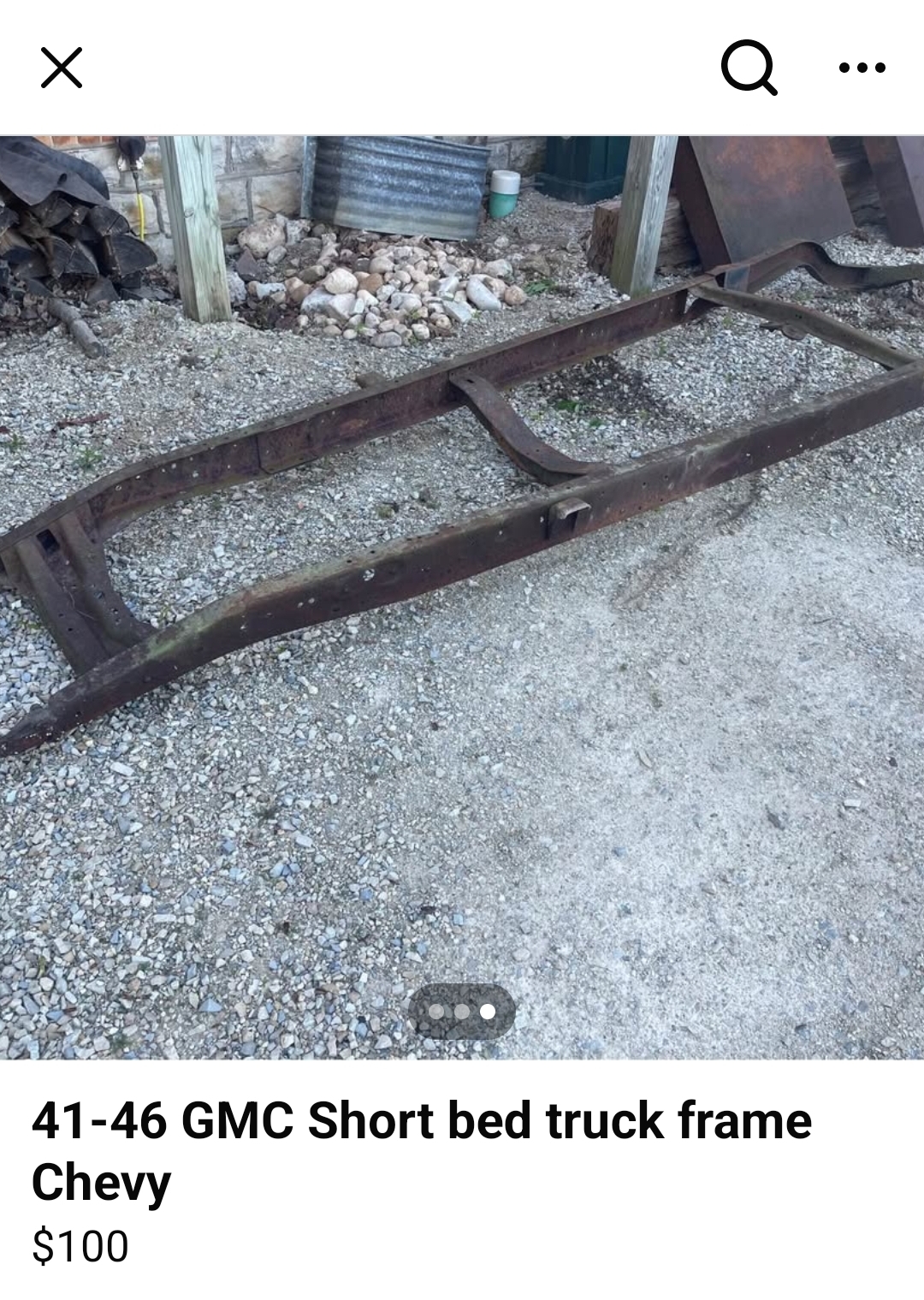

  17. cshades
    Joined: Sep 2, 2011
    Posts: 597
    cshades
    from wi
    putting a 62 on a 71 frame is one thing but 39-46 chevy truck frames are very narrow because of the way the body bolts on and the fat fenders. i dont ever remember seeing a 39-46 truck other than on the stock frame that looked good or fit well including the s10 swap. there are 41-46 frames around if you look at least around here. i have seen them on FB for a couple of hundred rolling

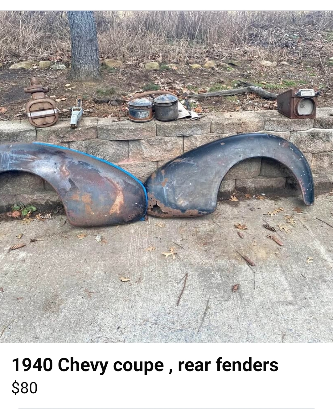

  18. Some options from farm country. Sometimes you can find an old pickup box converted to a trailer, you never know. If you are heading towards making you own box, old manure spreaders and corn elevators have bolt on tops with the angle already bent, and a nice round finish. Some of the John deere ones have fancy cast front corners with a radius. With some patience and a pair of fenders that fit the time and the tire, this will make a decent looking box, would likely need to be painted to keep it out of the RR category. Not sure where you hang your hat, but I have some of this in inventory.

    Ok now I’m curious is there any pictures of homemade boxes built like this?
