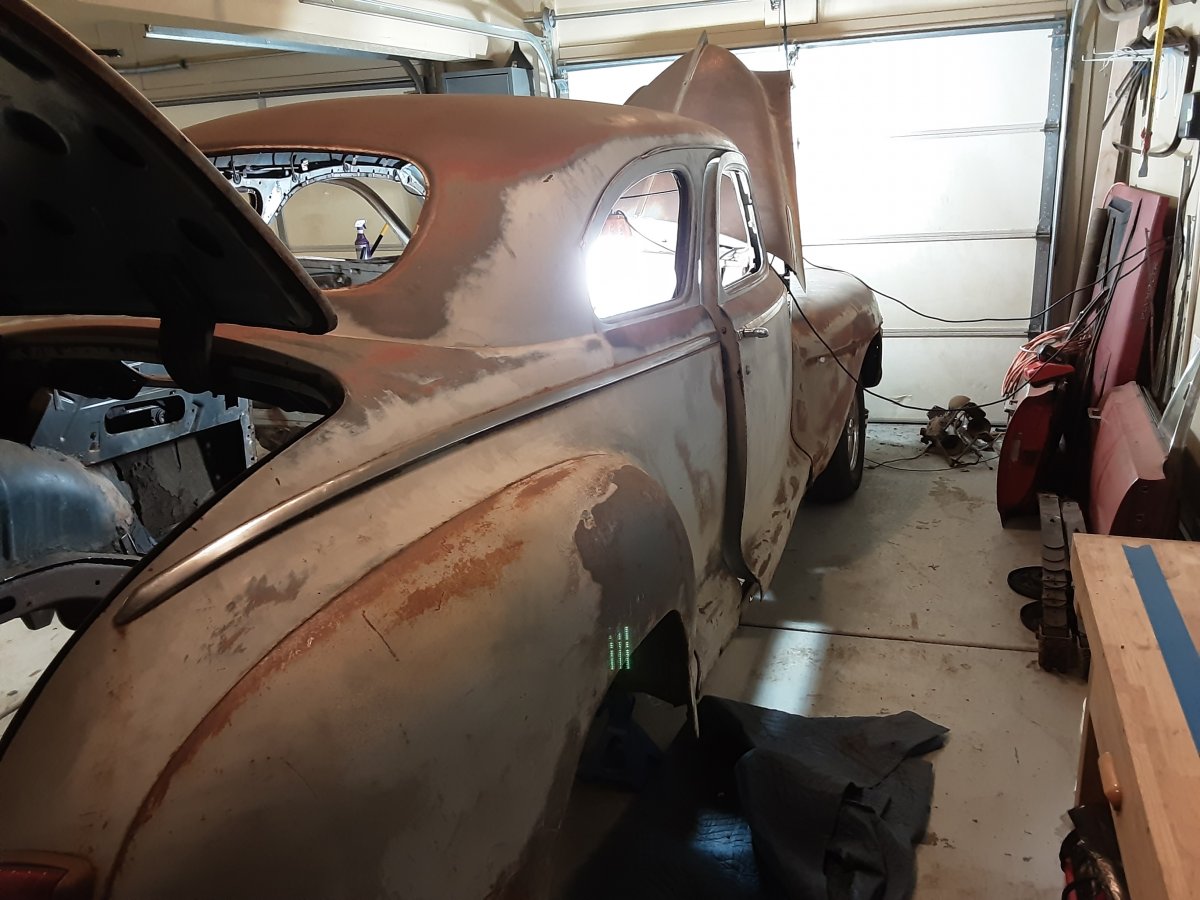

    I'm new to the rod/custom side of the car culture. Been building 65-70 mopar muscle cars for 20+years. I picked this Chrysler up a couple months ago through I'd post it up here with hopes of input and guidance. I am NOT restoring this car it's a custom/hotrod build I'm done with the numbers matching game.

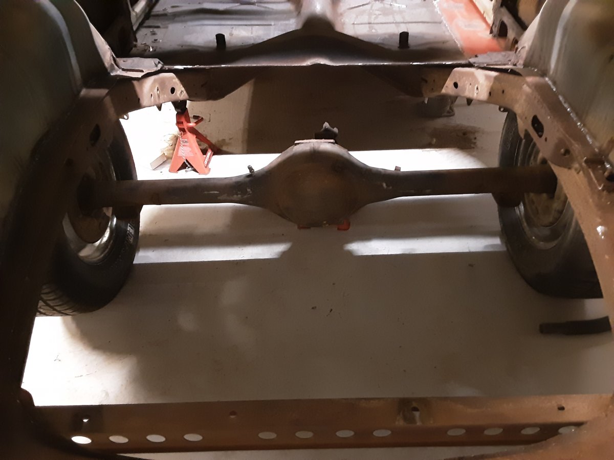

    Right now I've got a 8 3/4 (keeping it mopar) to put in the rear thinking 4 link with bags. Want to lower the stance but I'm not sure what I can do with the front suspension?

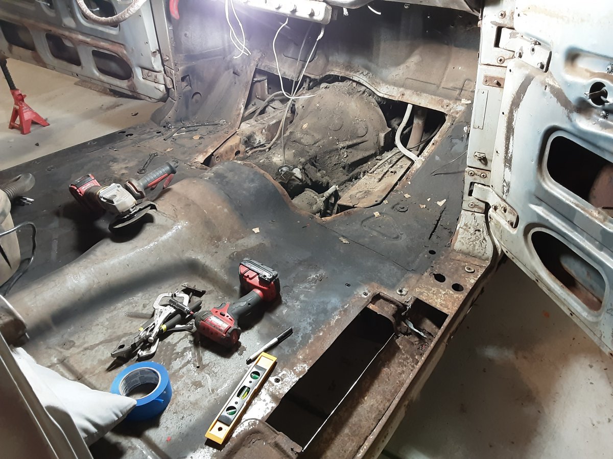

    All my patch material is sheet metal cut from leftover mopar pieces

    Few more pictures

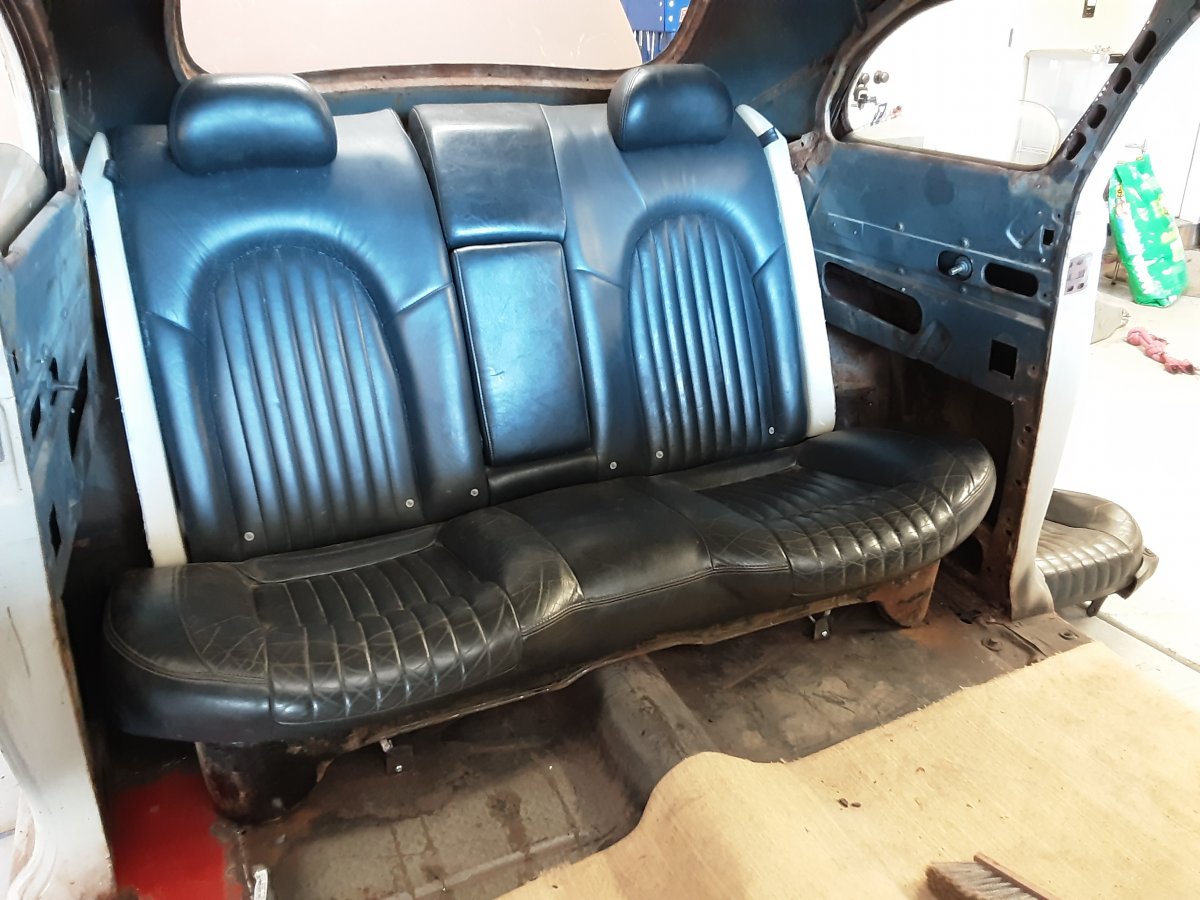

    So I got a set of leather seats out of a OT Chrysler 300, got the rear seats mounted using the front bench base as a base for the rear. Other than this I haven't gotten much done.
    I'm trying very hard to keep this a tight budget ride, using what I have or can scrounge out of the local pick n pull or local on line finds

    The car has coil front springs, you could replace the coil springs with bags like you want to do on the rear, but there probably isn't much drop available before the suspension bottoms out.
    If your really on a budget, why not just use leaf springs at the rear end with 2" lowering blocks between the axle and the springs, then up front move the spring perch from the top side of the lower control arm and bolt it to the bottom of the control arm, that will give you about an inch and a half, then replace the original springs with a set of Ford Aerostar coil springs and gain another inch. Move the upper shock mount from the upper control arm and mount it to the frame, there are kits available to do that, or its pretty easy to build your own. brackets to move the shock.
