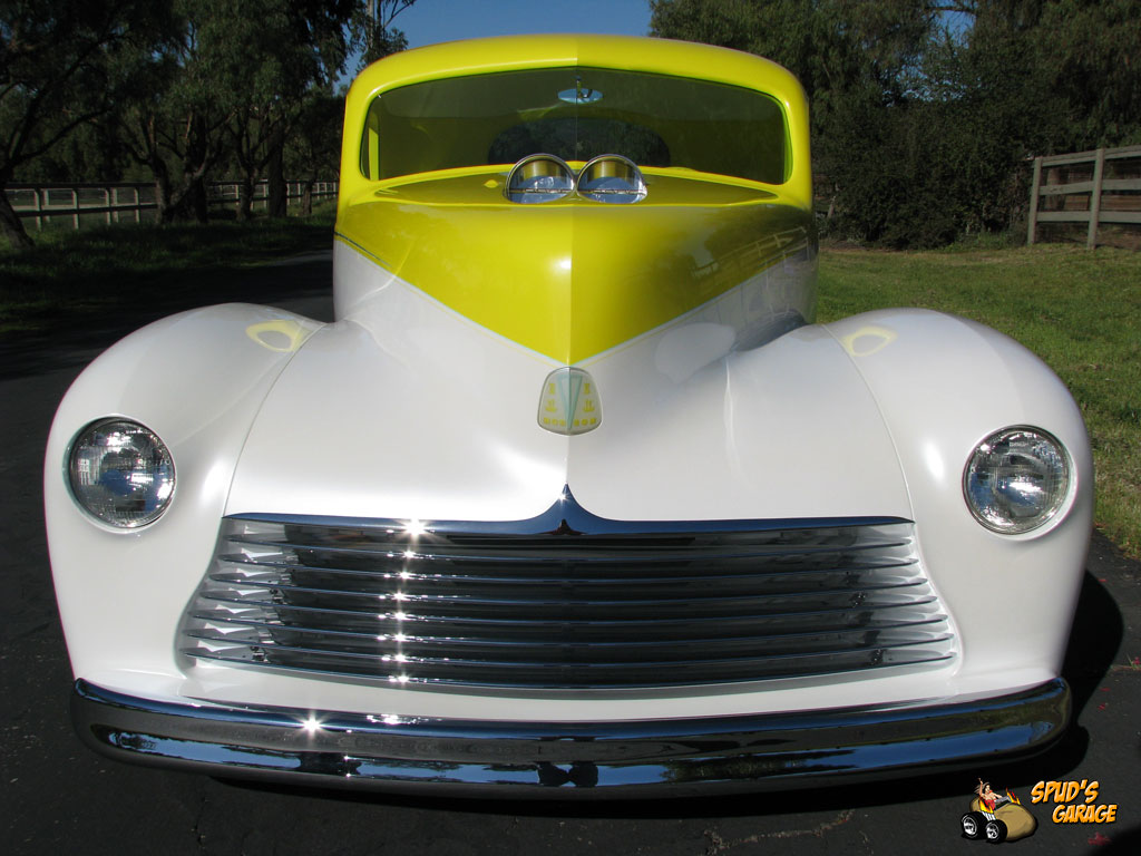

    I'm going for the look Pist-n-Broke posted with my 46. Not a fan of the original grill but love this custom grill work on this pickup[​IMG][​IMG]

  2. Saxman
    Joined: Nov 28, 2009
    Posts: 3,556
    Saxman
    ^^ Damn! I like that!
