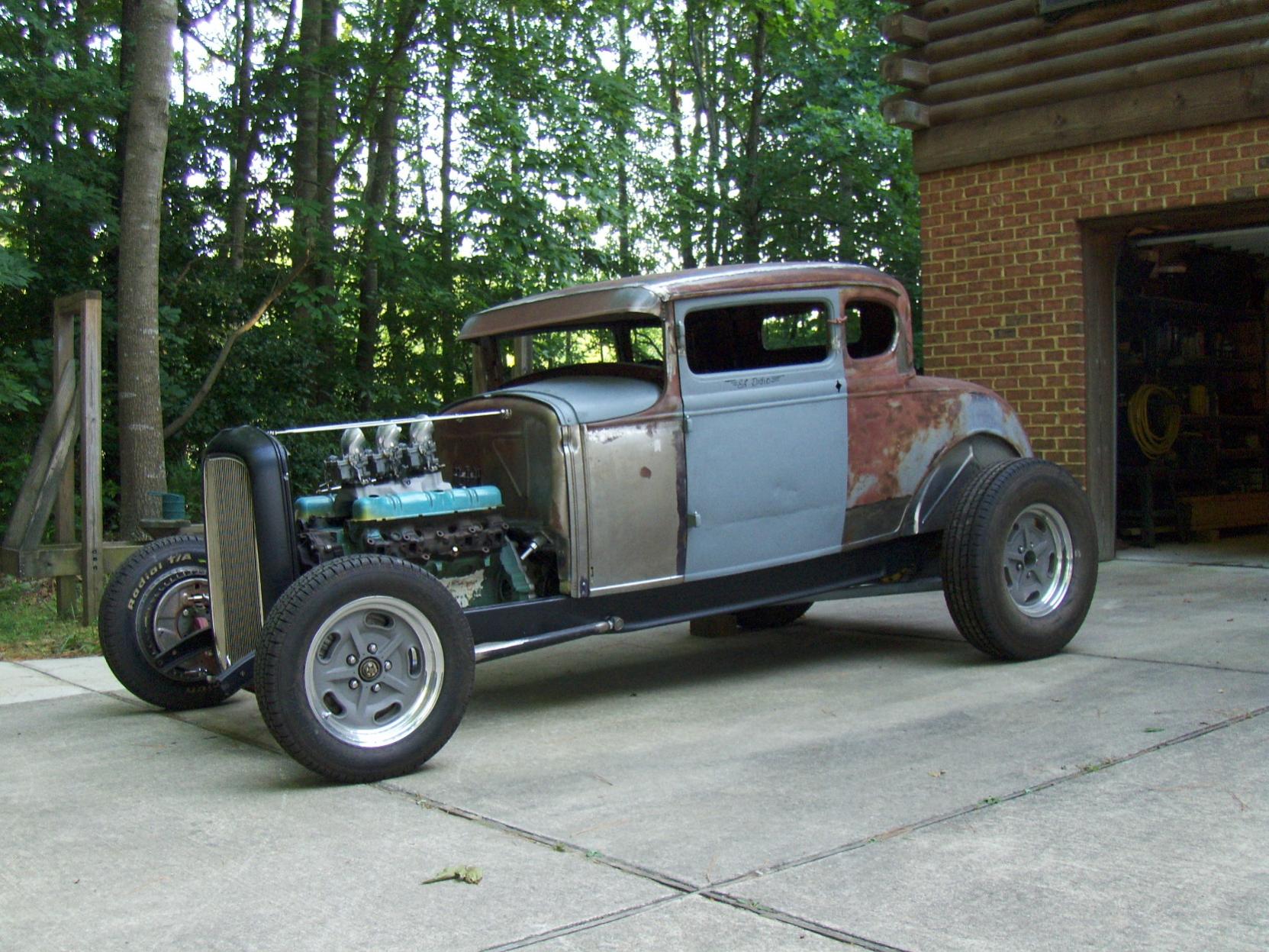

    Either engine will be cool in a Model A. For my 30 coupe I choose the Nailhead (57 364) followed by a T5 and a quick change. The car is going together for the final time and should be on the road soon.
