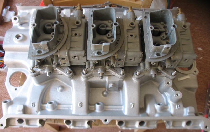

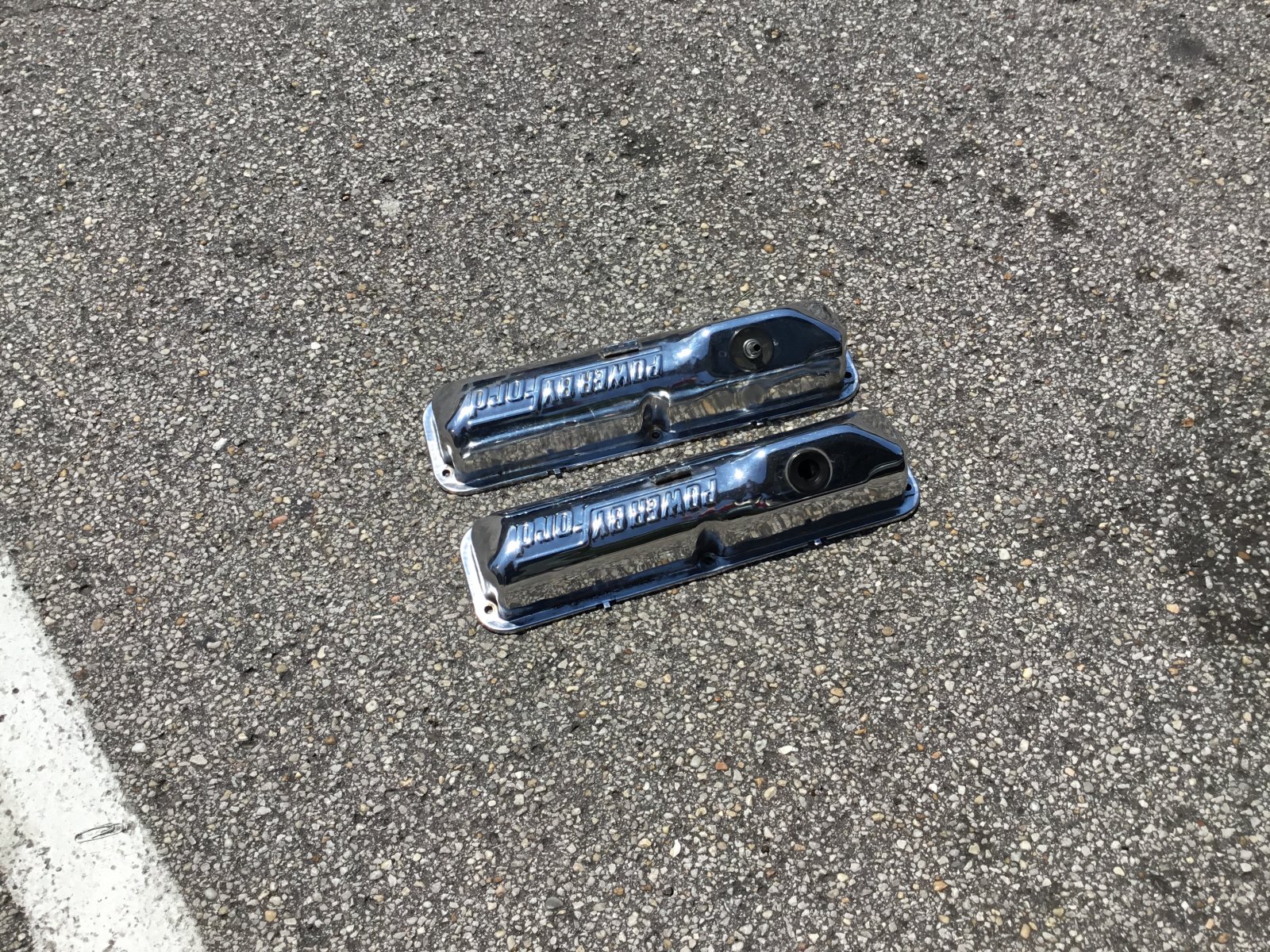

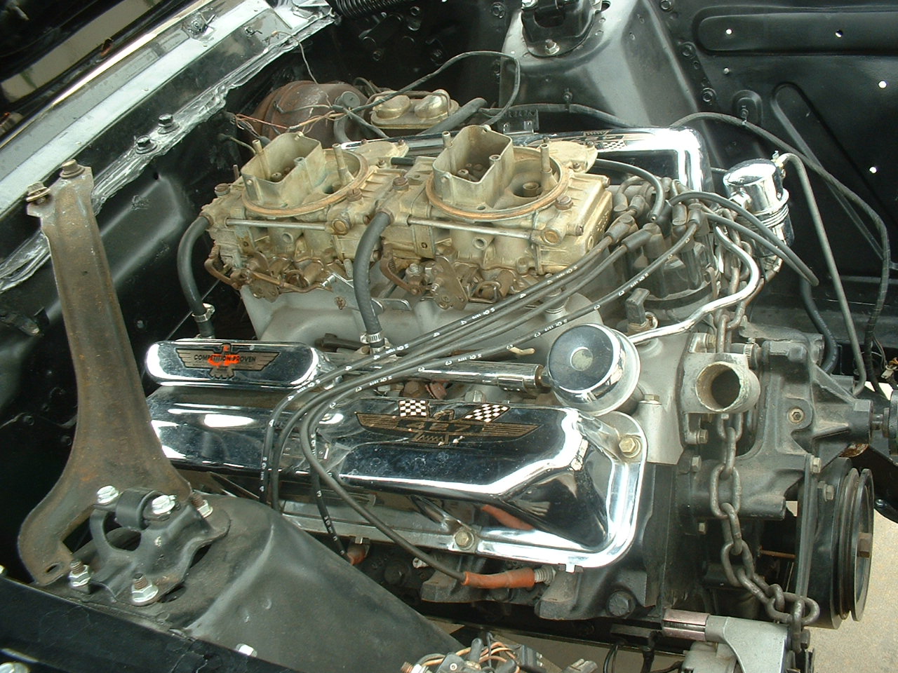

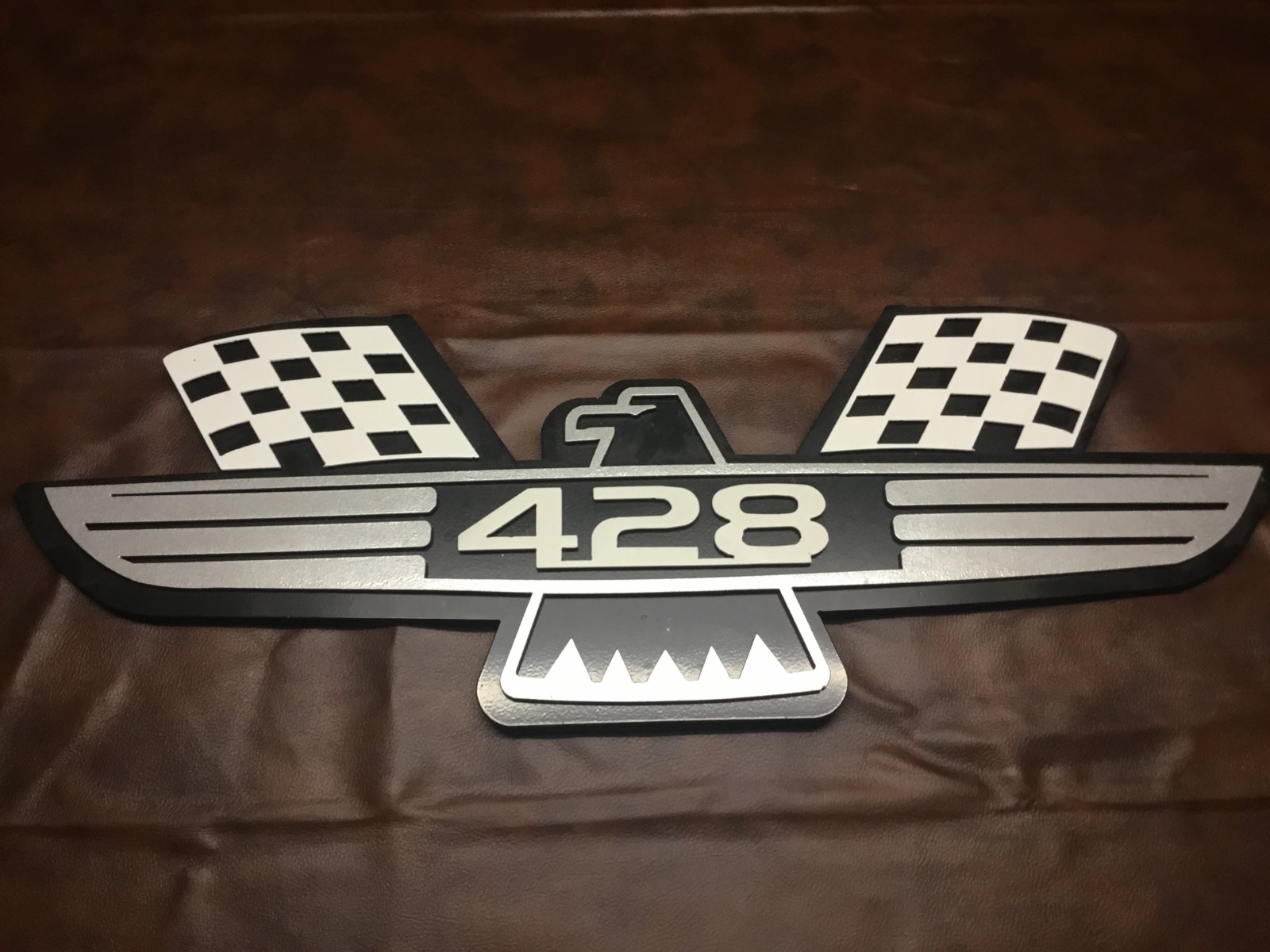

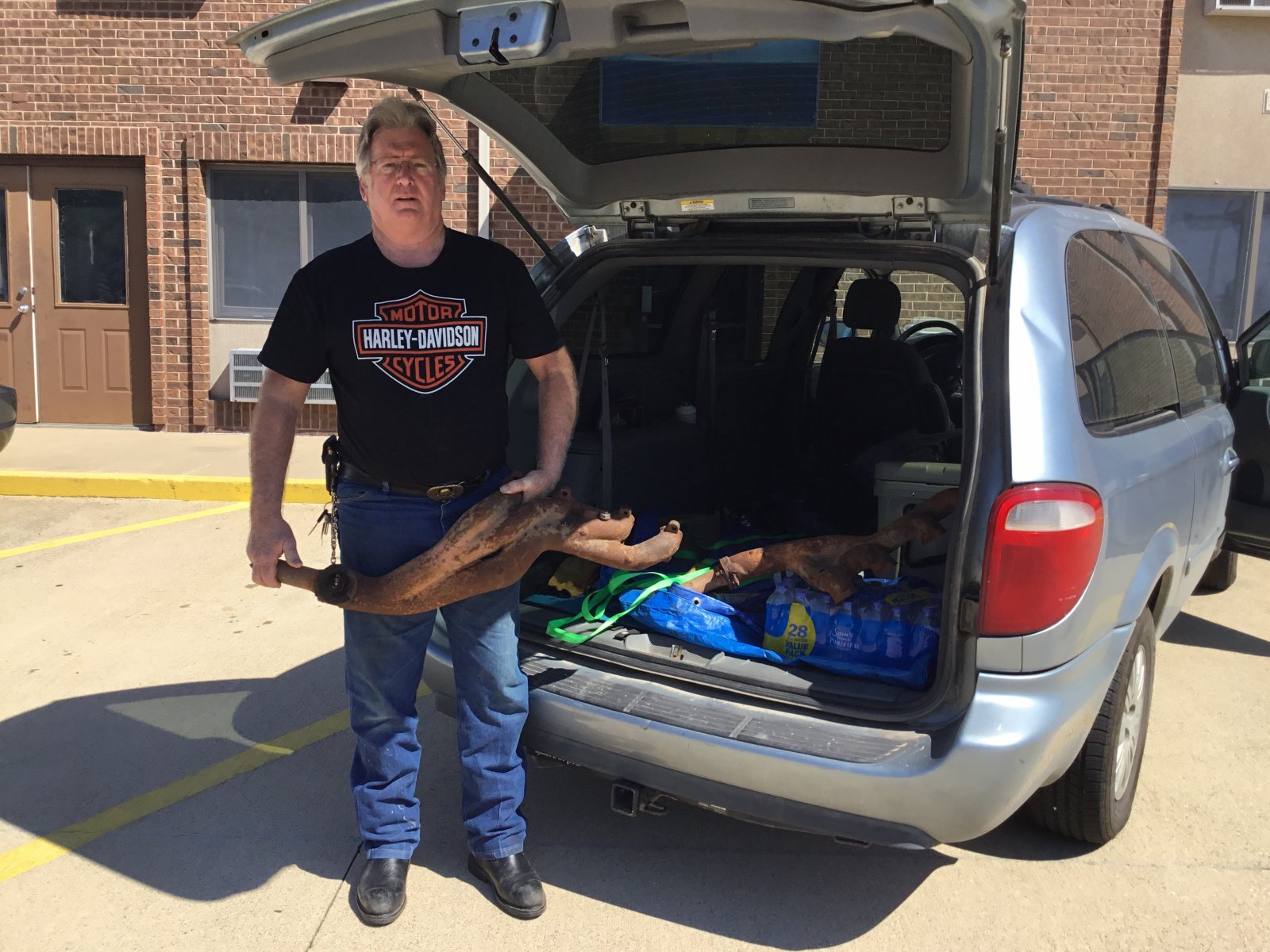

    I was impressed with the 427 way back in about 1965! But the Ford gods have never bestowed one on me! So…. I have had to settle for 390sand 428s. I am currently in the process of building a 428 to go in my avatar car with 3x2s. This car could have come with a 427, if special ordered. So I am including in my build a set of 427 long tube exhaust manifolds. I thought I would include a pic of these great exhaust manifolds!
    Bones E55F9190-517D-4D63-8379-2955E11B8F4D.jpeg 0899EC29-76EE-4447-A0F5-A9386382C5DA.jpeg 176ADC38-60F7-4C79-8741-B440801B5D30.jpeg A04FD5F3-C347-4B24-8BAB-77DB13033098.jpeg 6A9BE631-92E5-4448-9B79-8E4E6C011C86.jpeg

    Make sure you have the right long-tubes for your 65, the 63/64 manifolds are different and will not fit your 65. I have several complete 3x2s if you want to start with more complete

    For years I tried to buy a set of those manifolds for a buddy of mine from a fella that was set up at the Turlock swap. Guy wouldn’t budge off his 500 dollar price. This was in the 90’s, do they still hold the same value?

    The 3x2 setup looks great, and can be made to run fairly hard with a lot of work, but is not very strong with a mild engine, let alone a larger or more worked one. 2x4 LR is a step up, not bad, but the 2x4 MR dual plane is MUCH stronger. Tunnel Wedge is stronger yet, but not too strong on the low end for a street car, unless it has lots of inches. My Gal has the MR 2x4, great intake. I have a Dove TW, which is bigger inside than the factory ones, that has a pair of 660s on it and need big inches and/ or RPM. Also have a few 351C adapter plates with the Weiand 2x4 TR's, they work pretty well
