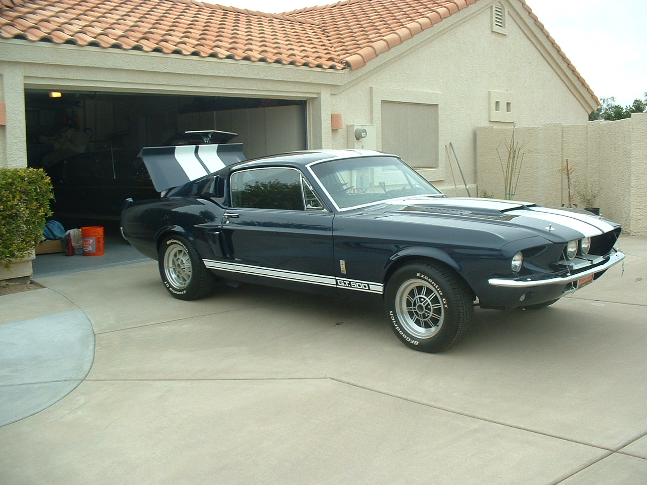

    If we're talking about 427 Gt500, the photo (on page 4) of the 427 with crossbolted mains came from this GT500, one of the original 3 Ford factory race cars, it was sent back to Holman-Moody who took the car back down and rebuilt it for the street. People can do some really dumb things. It was done back in the 80's, they must not have known how valuable it was in the original race form, it was not a 'street friendly' car, but it was the real deal.
