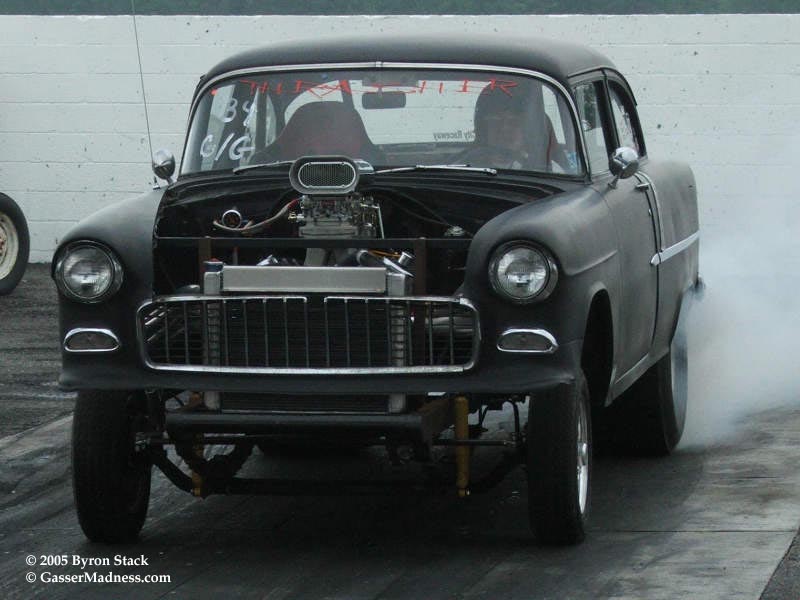

    I ran a 451 in my 68 Barracuda that I had in high school, and I'll tell you what... That thing would make you pucker up where you sit when you mashed the skinny peddle! Back to the topic at hand though, I love the idea of sticking a mopar engine in a chevy! It's like ***** **** - So dirty yet so exciting!
    This was the beast from my teen years...:D
