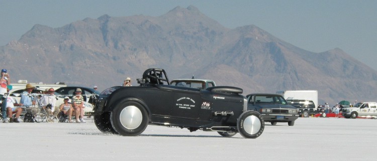

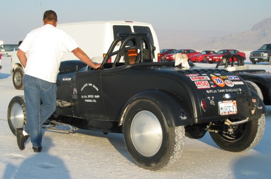

    That's what I had on the 283 in my Model O-Haaaaaaaaaay!!
