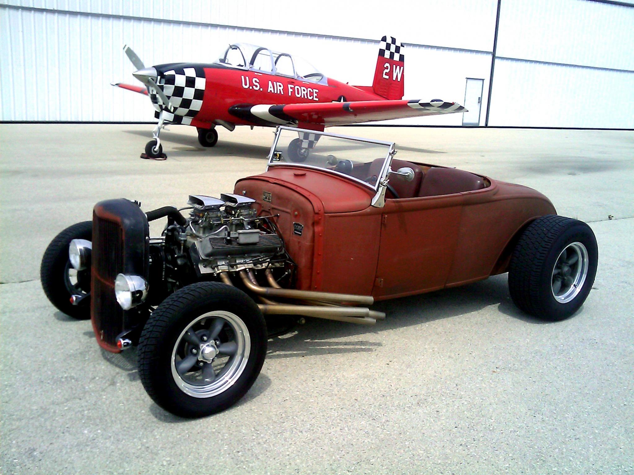

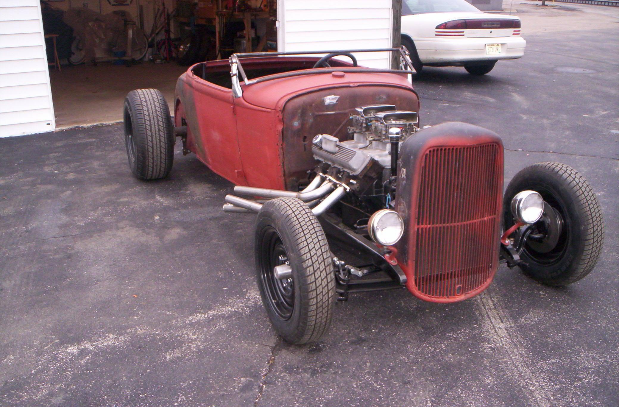

  13. I don't know about the cost savings... Horse Power costs money!
    I started with a $400 dollar 455 with a rebuilt turbo 400... ran 12 flat at108 mph!
    Next year I found a fresh 468 for a $1000 with "G" heads and upped the mph to 115 in the quarter!
    then I found another 462 with the aluminum heads and the right cam for $1,800 and bolted those parts on my 468 and ran a 123 mph!
    That's a lot of performance for $3,300... not to mention that I was able to recover every single penny of it by selling off my remaining engine parts.
    I don't think I can find those deals with the Vortech, Gen IV or any other Modern Engine!

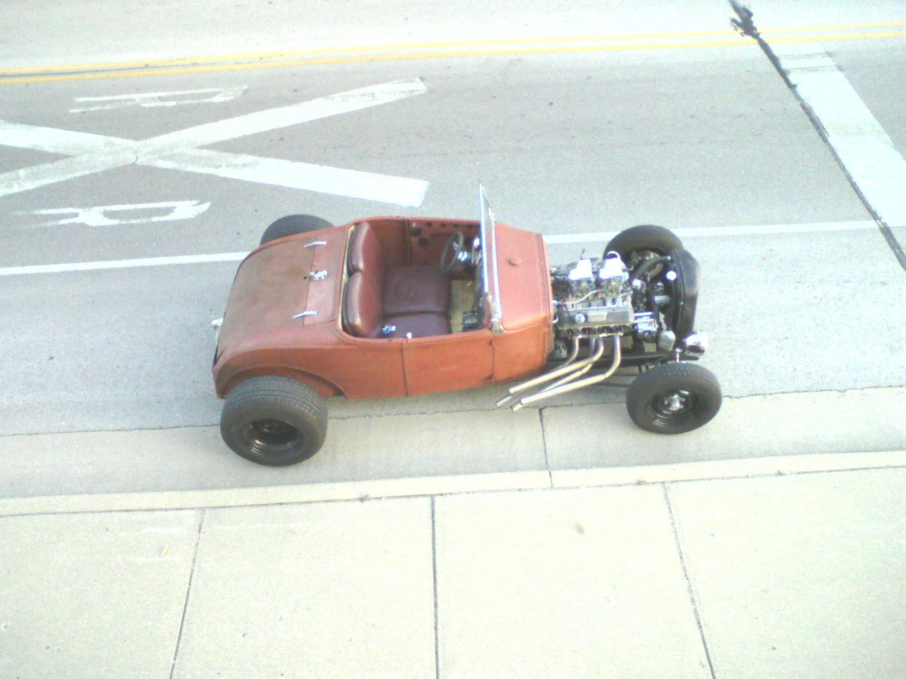

  18. Light car... and zero traction!!!
    I forgot to add that the dual quad and the Mallory dual point were super scores on ebay... I had $300 for the whole "Kit and Kabootal" and I transferred those from on engine to another over the years.
    First couple of photo's are with the stock long block... and the last photo was with the 468 and aluminum heads...
