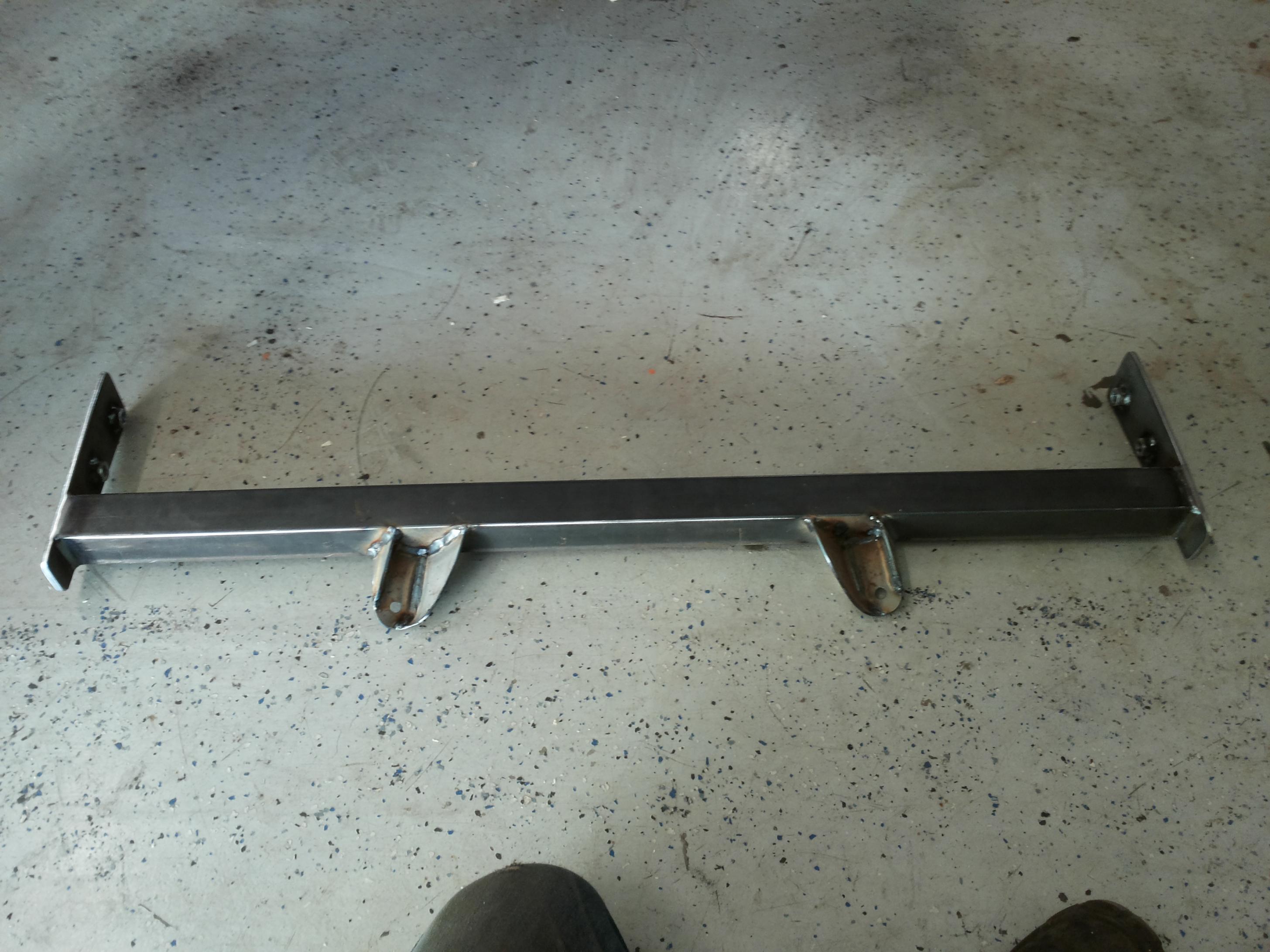

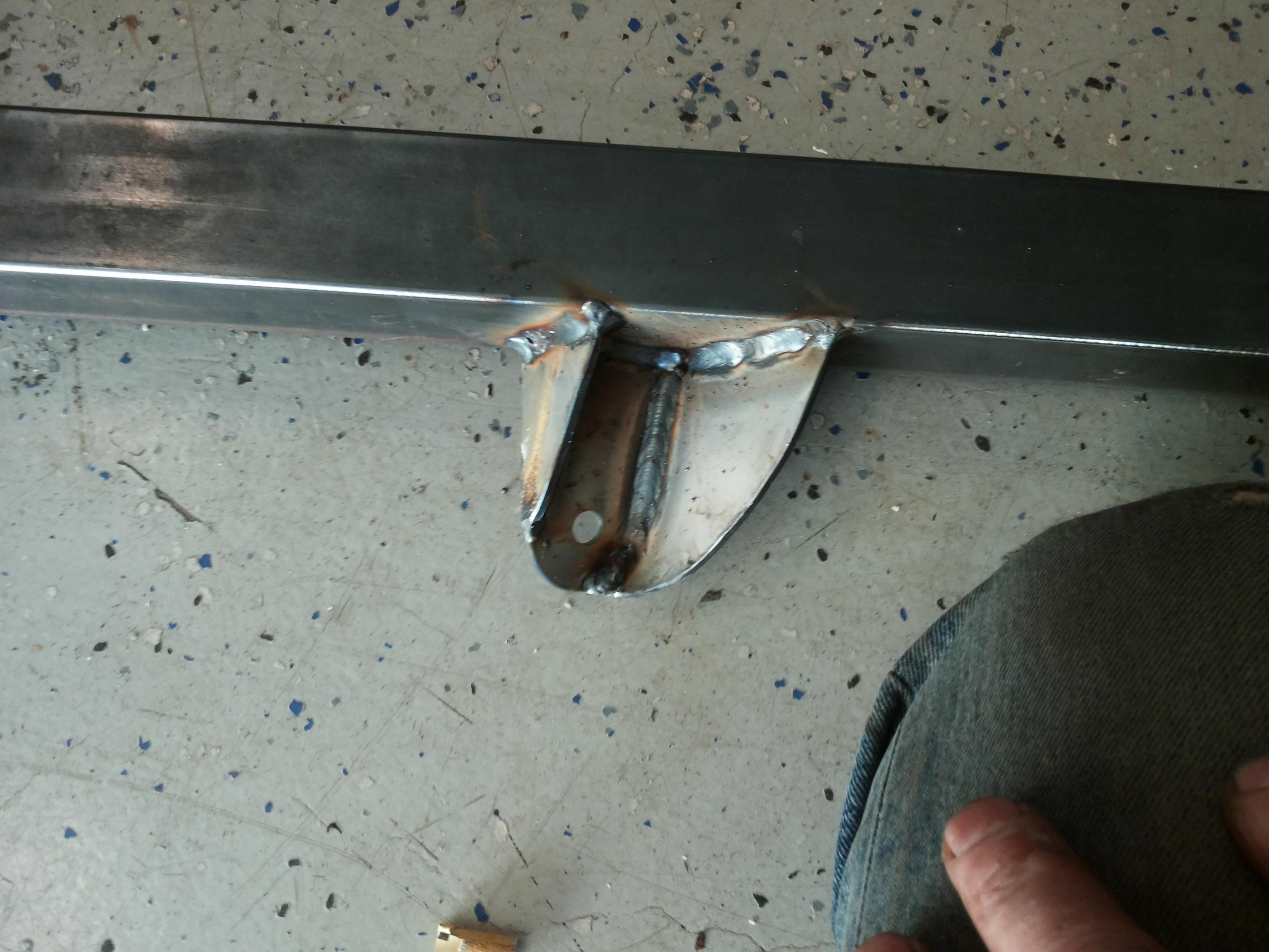

    shortned the prop shaft,becouse with the other lower springs,lowering block's and relocater plate there was no room for movement left,so took out halve an inch away.
    made an new bolt inn cros member for the rear shock absorbers,and welded a bracket to the ground plate for the lower shock mounting.

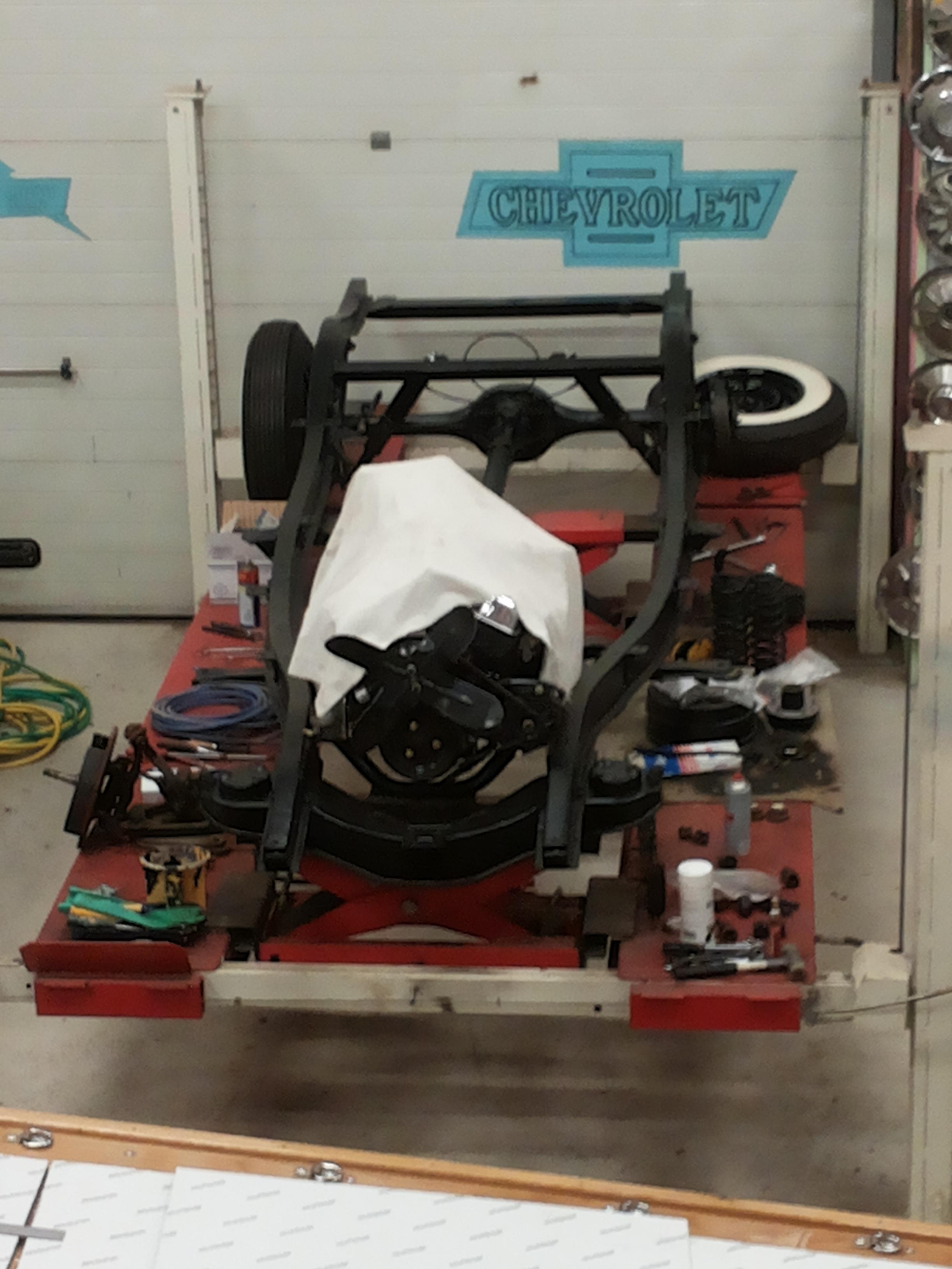

    Done lots of small ,time cosuming things ,that you never wil notice,and moved up to the front suspension,take it apart, cleaning,and then painting it and re***emble it again.
    and meanwhile Sander couldend resist to finnish te job i started with,putting the new ww tires that i stil had kicking around,on the freshly painted rims and ballance them as wel.!!!
