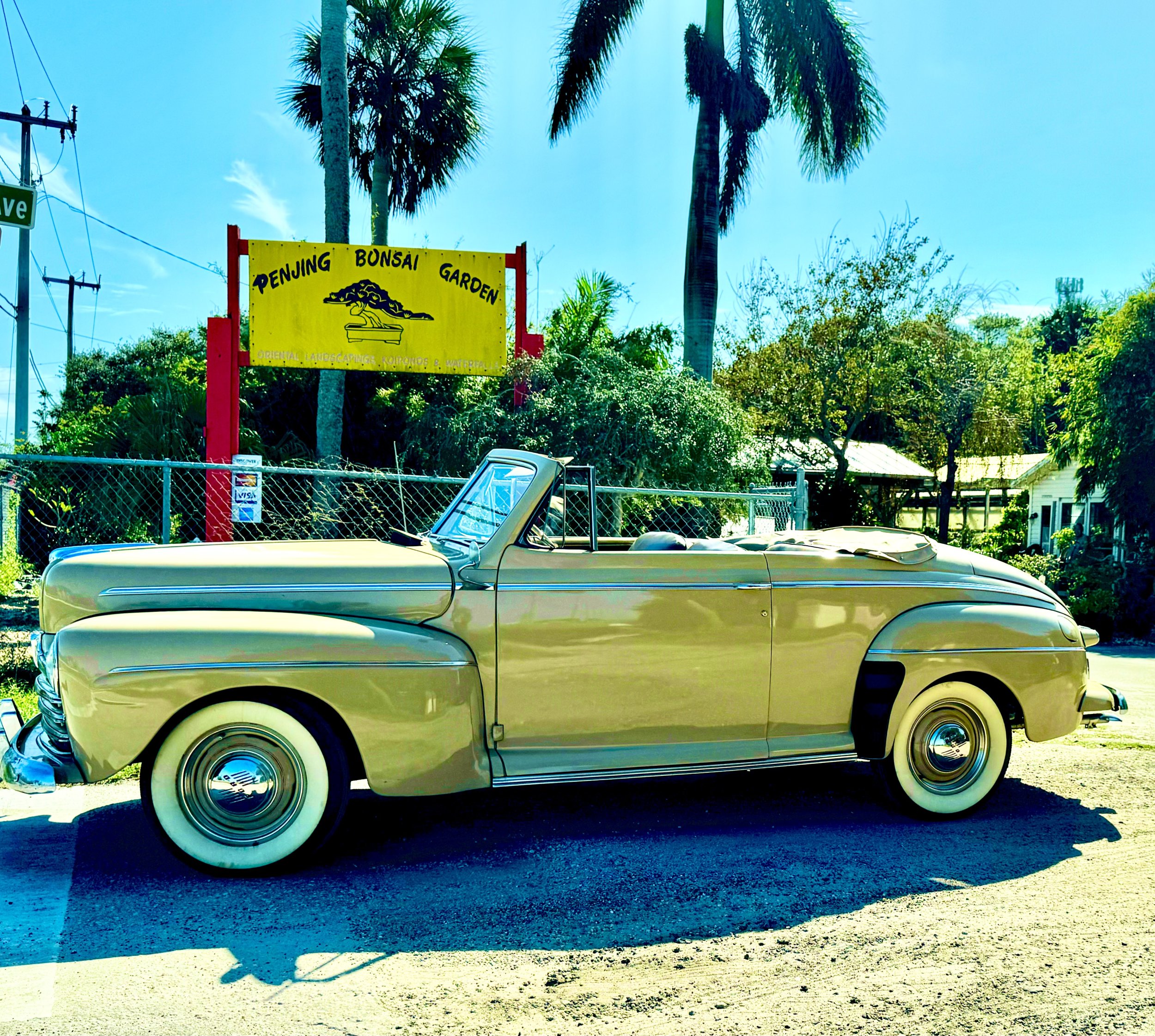

    Hey everybody. I have a 46 ford special deluxe flat head v8. Well I took it out the other day about a 5 min drive to gas station. She ran perfect then I filled her up and started her. Seemed fine. I took off and she was sputtering in all gears like she was starving for gas however she was back firing like a pig and had no power. I thought vaporlock ??? So I took gas cap off checked vents all fine and still did the same. then I figured maybe coil was an issue or voltage regulator so I changed both. Still having same issue. If she cools down completely she runs fine until heats up then same BS. What am I missing here. Fuel lines and tank clean. Carbs functioning fine. It seems to run like it’s a timing issue when it does this. Like the coil is doing it. I’m stumped. Any more intelligent fellows. Please chime in. Regards.
