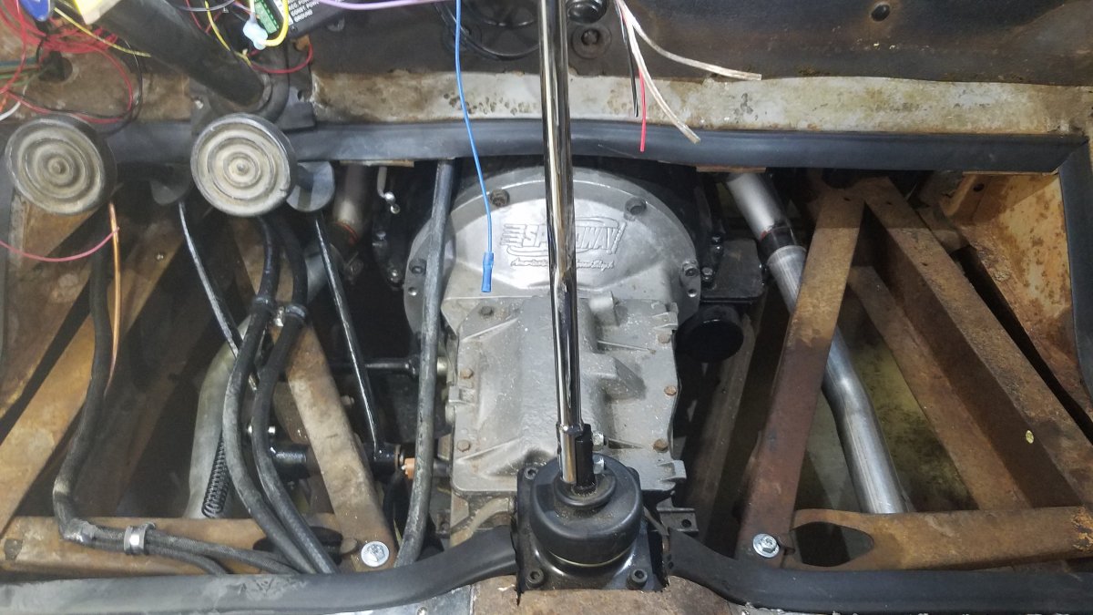

    Shop manual states that you need to pull the engine to change the clutch. Pretty much impossible without a lift. I think I've heard people say you could get the tranny out by first dropping the rear axle/torque tube assembly, but to me it's easier to just pull the engine. I don't know how you get it out through the toe board without doing that.
    Engine removed
    Toe board removed (granted, different tranny)

    Yes, of course you have to disconnect the torque tube.....no matter which way one approaches this job. But I have the personal experience of using the 'from the top' floorboard method and it works a lot easier than pulling the engine from an assembled car and does not require a lift.
