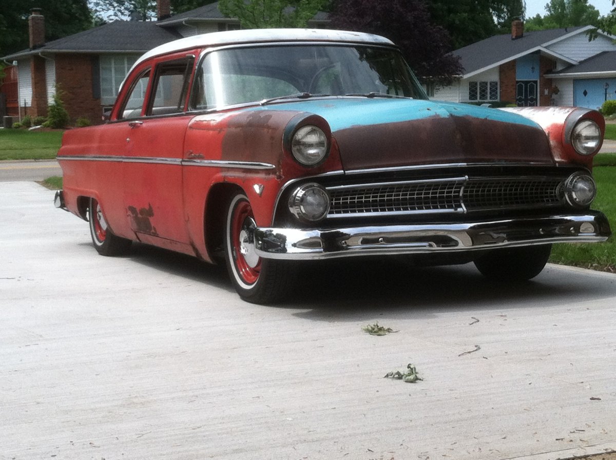

  15. The spindles with discs from a late '60s big Ford LTD and the '70s Torino/Mercury Montego are a bolt on swap. The ones on my '55 Ford came off of a '76 Mercury Montego.

    I used a 78 Granada for brakes and rear axle on my 55. Front spindles and all disc brake parts are from the Granada. One hole needed to be reamed, but I can't remember which one. Master cylinder and booster are also Granada. Then I used Ford Aerostar springs. Total drop in the front turned out to be 3.5 inches. That measurement was right after the swap so I never remeasured after it settled.
    I was able to squeeze a DOHC 4.6 under the hood. I would think a 460 would also fit.
    EDIT. The center hole on the factory 55 wheels had to be opened up slightly to fit around the center hubs of the rotors and rear axle.

    I did a disc brake swap on my 57 Ford and used 69 Torino spindles. Mustang, Torino, Cougar, Montego , all share the same spindle up till 1970. After 1970 the spindle pin is slightly thicker which requires different wheel bearings. Pretty sure you'll be able to use your stock 15 inch steel wheels, calipers should clear.
    My 57 has a 514 BBF swap. The only real issue was rad clearance. Had to trim the support slightly.
