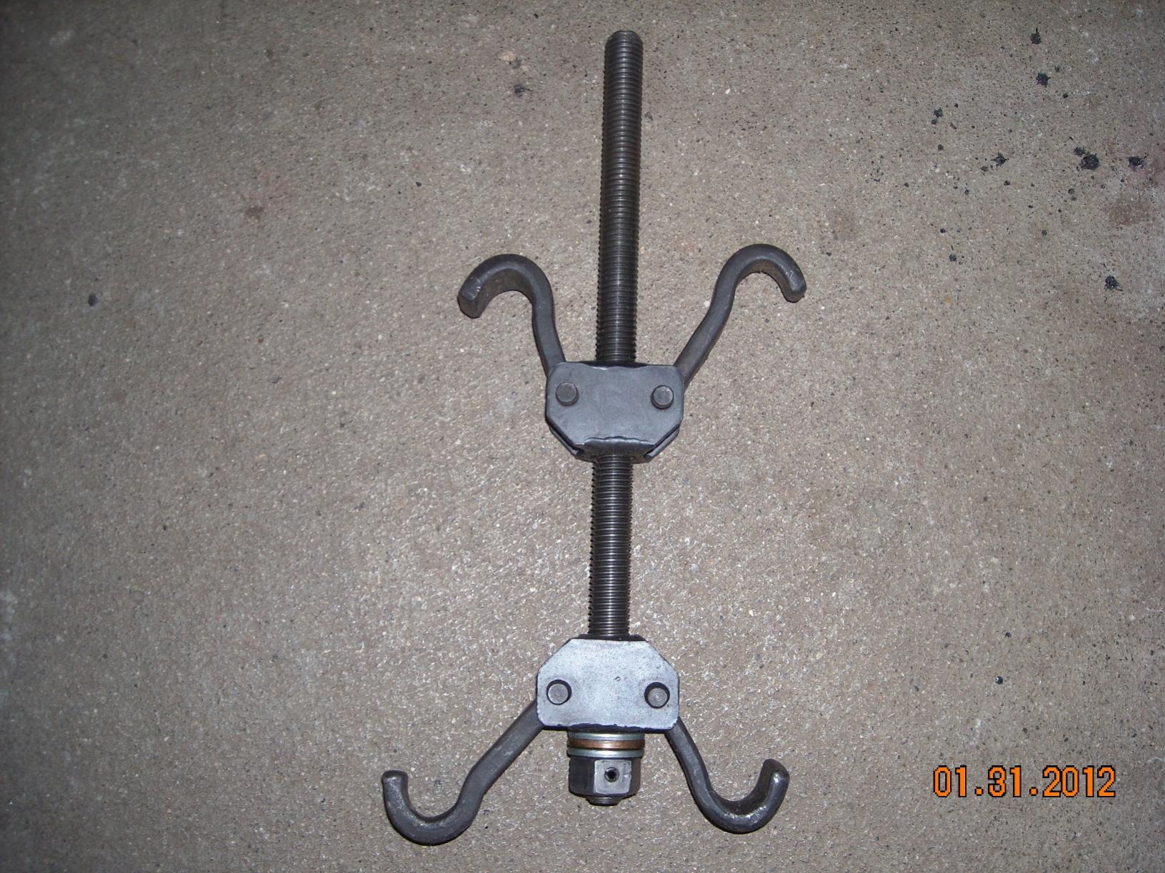

    greg
    This is the one I have. Im not sure what autozone has.
    You need to compress it yourself.
    It looks like you dont need much to get the old one out, so put the compressor in your old one, and when you get it situated to where you can get it compressed enough to get the spring out, make a mental note of where on the spring you have the compressor. Then when you put the compressor on the new spring try and do it the same way.
    you might even want to measure the compress length of the old one so you know it should go back in the same hole.
    chances are you will have to play with where you have it clamped on the spring to get everything to fit.
    so you might have it on and off several times.
    I had this spring compressor slip on me once, and kind of slid around on the spring so be careful when its compressed. leather gloves might help.
    also, last time i changed springs the new one didnt work so I had to take it off and do it all over, but hey, the 2nd time was much easier.:rolleyes:

    that was the one i used. there were different kinds of coil spring compressors i tried, but this was one of them. thing was, the rod kept hitting the top of my control arm, and i couldn't get it through the hole where the shock absorber goes through. hopefully you know what im talking about. but i'll give it another shot tomorrow on my day off.

    success!!! i got ONE spring out, on the passenger side. and i tried putting the new one in... holy god it's damn near impossible i think.
    i went out and just bought a spring compressor instead of keep on renting one. the one you took the picture of actually and it worked great.
    i was able to shorten the new one with it, but to no where near as short as i could get it. i still need about 3 inches of clearance and i cant get the a-arm to move anymore down.

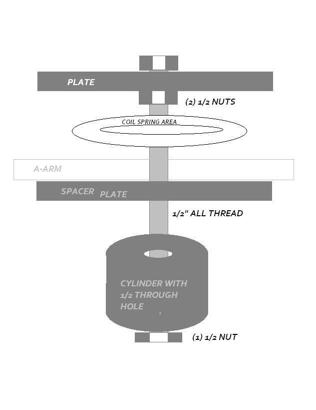

  26. d2_willys
    Joined: Sep 8, 2007
    Posts: 4,334
    d2_willys
    from Kansas
    Jay: Try this: Get yourself a "tee" type compressor that compresses the spring through the hole in the a-arm. I made a simple one by getting some thick plate that is about length of the diameter of the coil spring plus 2". This will allow the plate to extend over the coils by 1". Then I bought a piece of 1/2" all thread. I then got a bushing with a hole through it for the all thread to pass through. The bushing will either have to be bigger in diameter of the a-arm hole, or you will have to use a spacer that will accomplish this, plus the bushing. See drawing for details. Then use this at the uppermost coil accessible and compress spring. You should then be able to get the other compressor out. SPRING COMPRESSOR.JPG
