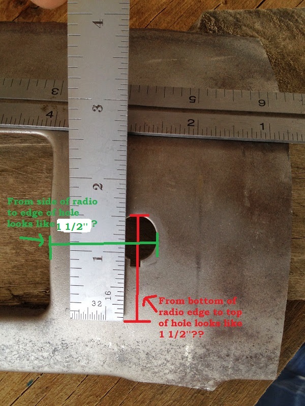

    Does any body know or might have the measurements for the radio holes? My homie welded in mine cause cus the previous owners made the knob holes bigger. So need to drill out new ones. If any one can get a pic with a measuring tape it would be much helpful ImageUploadedByH.A.M.B.1405875612.753737.jpg

    Here are a few more to add to above

    oh wow, those pics will all work perfect :) thanks!
    gonna get on them this upcoming weekend

    nobmesmnt.jpg on last question in regards to the pictures above that i attached some writing, can someone tell me if the measurments i assume are correct on the picture i edited?

    Yes. Your measurements above are what I see on my original patch
    Here is a center to center dimension on the curve.
    Keep in mind the holes were probably punched originally
    The holes are not perfectly round.
    A little round file work may be needed.

    oh man that'll work even better, thanks for that detail info!
