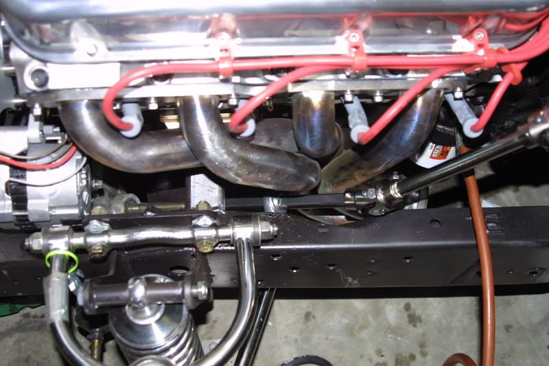

    OK, here's the info. I stand corrected on the application. They are an S-10 V-8 conversion header. I found the paperwork where I bought them. The Hooker p/n is 2837. The Hooker website no longer has the picture available so I recommend you definitely find a current listing and picture to verify in case Hooker has changed part numbers. Hope this helps.

    I went through three different block hugging headers before I found one that just missed the shaft. I believe it was finally the Sanderson I ended up with although its been 11 yrs and I dont remember for sure.
    And that was after i moved the engine over some to clear.

    I'm building one now and I used Sanderson blockhuggers. I have a small block with straight plugs. I will have to trim the motor mount and use two joints but it will clear.
    Remember that if you want to get low the full headers might not have ground clearence..............
