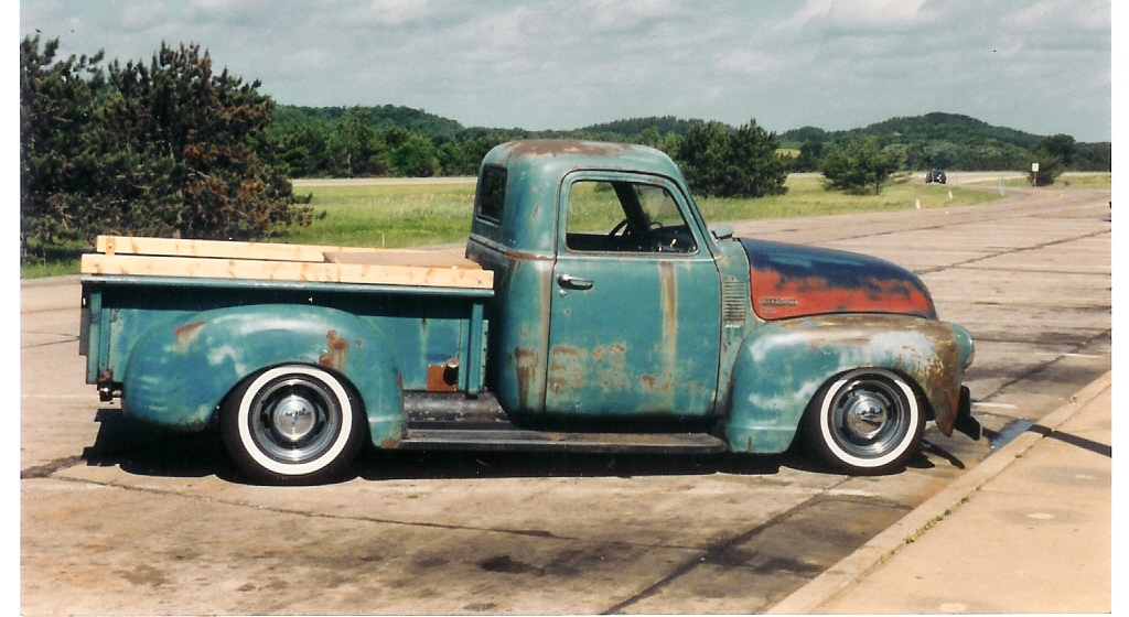

  9. my cars 028.jpg my cars 027.jpg ...sounds like you've done your homework, that's a great plan,...here's a couple I ran years back with the same engine/trans combo, a great all-round set-up.
    volvobrynk and kiwijeff like this.

    Nice trucks rusty1!
