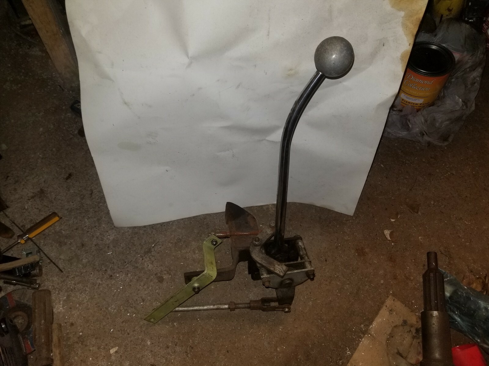

  8. vtwhead
    Joined: Oct 20, 2008
    Posts: 5,362
    vtwhead
    Zombie, I have one that is shop made that came my way in a trade. If you would be interested I could put up some pics of it for reference or if you want it pay the shipping and it could be yours:) as I will never use it.
    Zombiefink, Hnstray and Sporty45 like this.
