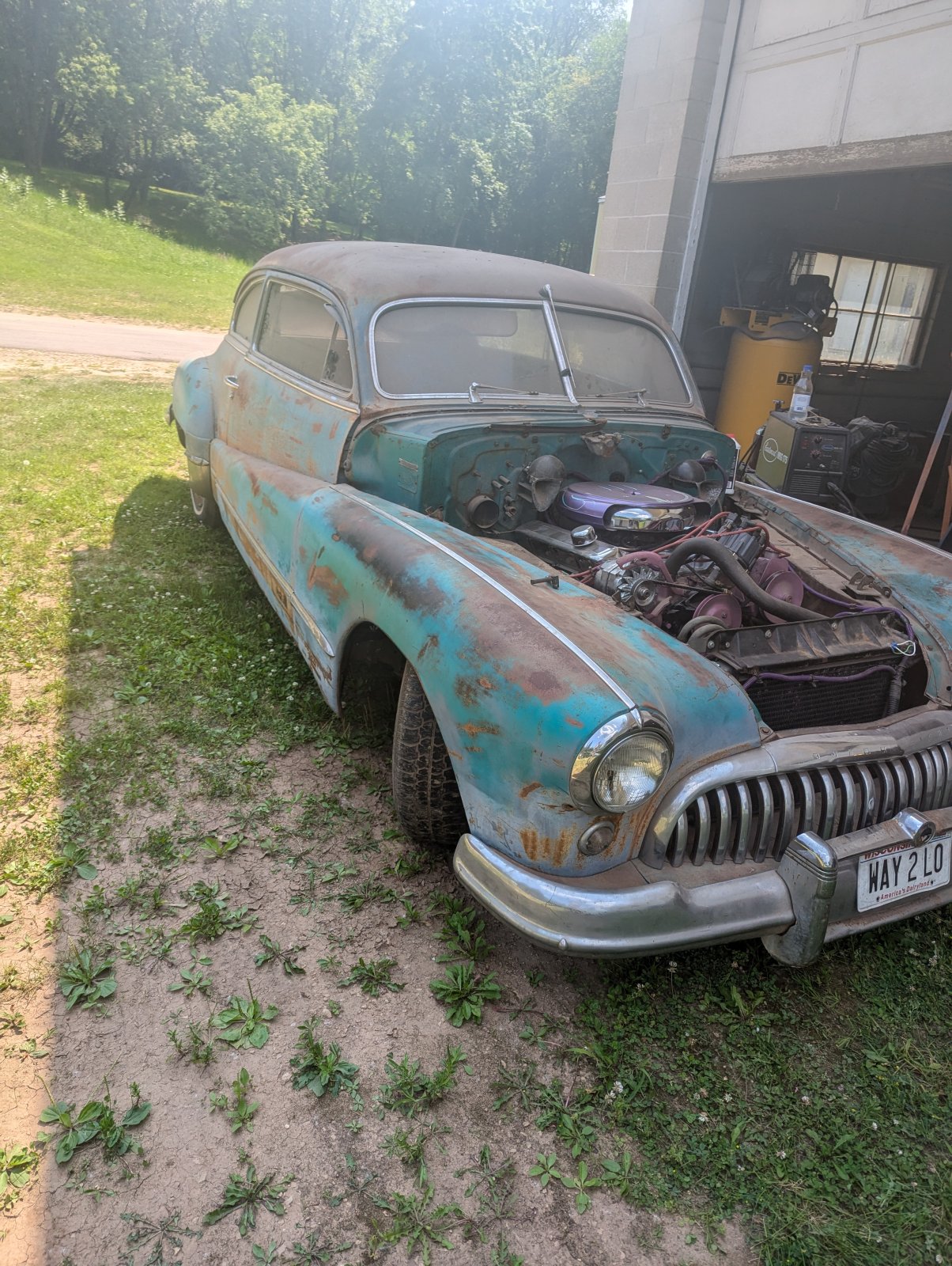

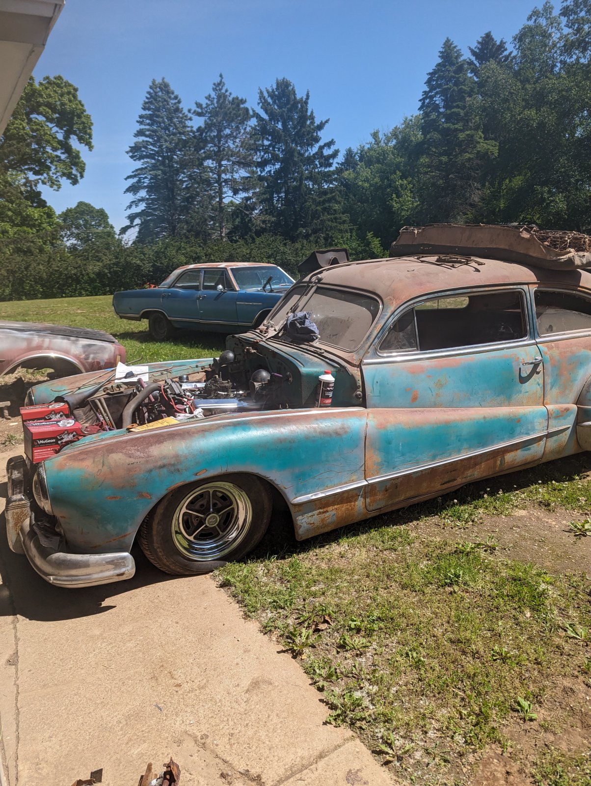

    Well, I had to try. I've got a filler up high in the upper hose to get all the air out, added HyperCool, new radiator cap(s), a full coverage KKS aluminum shroud w/ a 16" fan, upgraded to a 16" Spal fan, and it still gets hot. The fans look similar, but the Spal's motor is twice as deep as the KKS. It ran about 13-15 minutes and started puking out the overflow. Got up to about 230*. I was hoping to have it driving this year, but it's looking like that might not happen. The 22 1/2" X 15" 3 row core size just must not be big enough for this extra-large engine. I was told it was a Corvette radiator by the PO, but according to my internet research, the size comes out to early Nova w/ a V8. I understand Caddys run hotter than SBCs.
    On the bright side, I took it down the block and back for its first drive out of my driveway. Seemed to ride/handle/steer decent. Other than s****ing the front bumper guard on the driveway exit. Needs some brake adjustments, but it stops OK.
    Next up is a bigger radiator and a complete revamp of the radiator support which also serves as the front sheetmetal mount. I kinda needed a better way to adjust the front fenders anyway. They weren't fitting so well, and they need to, so the side opening hood works easily. If I can sneak it a little forward, I can go a little wider with a crossflow. I can definitely go taller, as it currently is under the fender line. There is room to go above that, behind the front of the hood. That would probably mean using a downflow. So, do aluminum radiators cool better than br***? What's the consensus on how many rows works best, etc. I know a few on here have said go to a mechanical fan, but I'm also reading where people have removed them in favor of electric and had better results.
    Also, I need to add big block springs in the front. As much as it pains me to say this- it's too low. If I'm going to do that, I might as well replace the old A-arm bushings, and whatever else needs replacing. This also means my other projects get pushed back, and I'm really wanting to get started on my '49 Merc.
