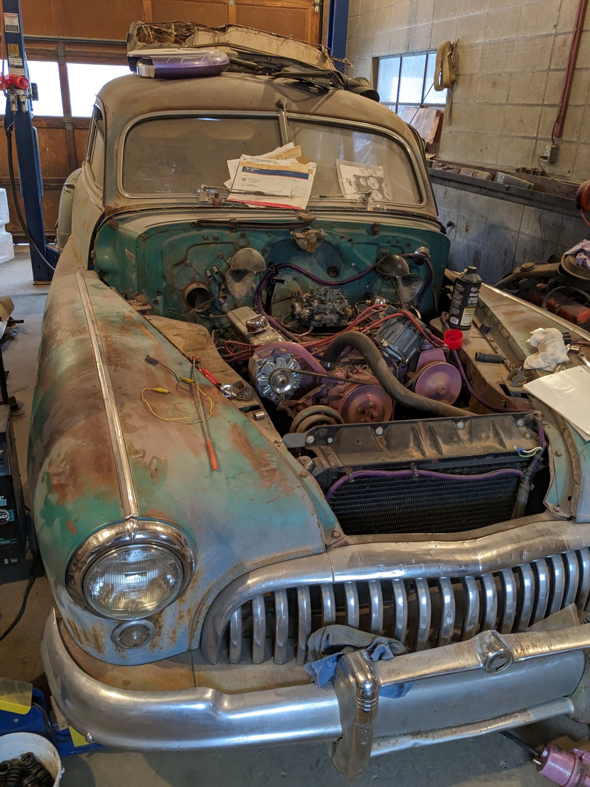

    It's always something with this P.O.S. Thursday, after I got the engine put back together, I let it sit outside and idle for about 30 minutes. Everything was fine. Friday, drove it to see my Bro, about 3 miles. No problems. Then, took a little longer route on the way home, maybe 5 miles. When I shut it down, it ran on a little, then the geyser started again. Shooting out the overflow. I can't tell what the temp is. I have the original gauge hooked into the front of one of the heads. It climbs steadily to max (220* or so) & a radiator cap with a built-in gauge that read about 160* when it overheated again. I'm about ready to give up and move onto something else.
    Okie Pete likes this.
  19. bobss396
    Joined: Aug 27, 2008
    Posts: 18,754
    bobss396
    Have you put a surge tank on it yet? Something ala a '64 Ford would do it.
    We had a guy with a NASCAR modified some years back, with a 351C that had the heads higher than the radiator. The front header tubes glowed orange.
    Or you have a grand-mal air entrapment issue, just my 2 cents.

    yeah, I was thinking trapped air pocket also. What part of the cooling system is the highest point?
    Also, have you tested the thermostat to see if it is opening at the correct temp?

    It will sit & idle with no problems. Original gauge reads about 180*. I took it for another ride today, even farther than before. When the temp started to rise, I headed for home and shut it off. Tried to re-start and it turned over too slow, but it didn't spit coolant out. Let it cool down and it started right up. It's getting hot while driving. So, an airflow problem, or too small radiator? The airflow from the grille into the radiator looks to be pretty good, but there is a big open space between the top of the radiator & the hood. Maybe the air flow is going over and not through while driving? Double checked the little things - timing, etc. What else will make it overheat while driving?
    @bobss396 & @RMR&C no surge tank, but an in-hose filler that is the high point. New thermostat. You can feel the hose get hot when it opens up, so I don't see a problem there.

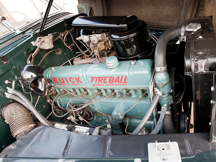

    Yeah that radiator sits way too low.
    You need a tall radiator like the stock one in this photo. It almost looks like something you’d find in a tractor.
