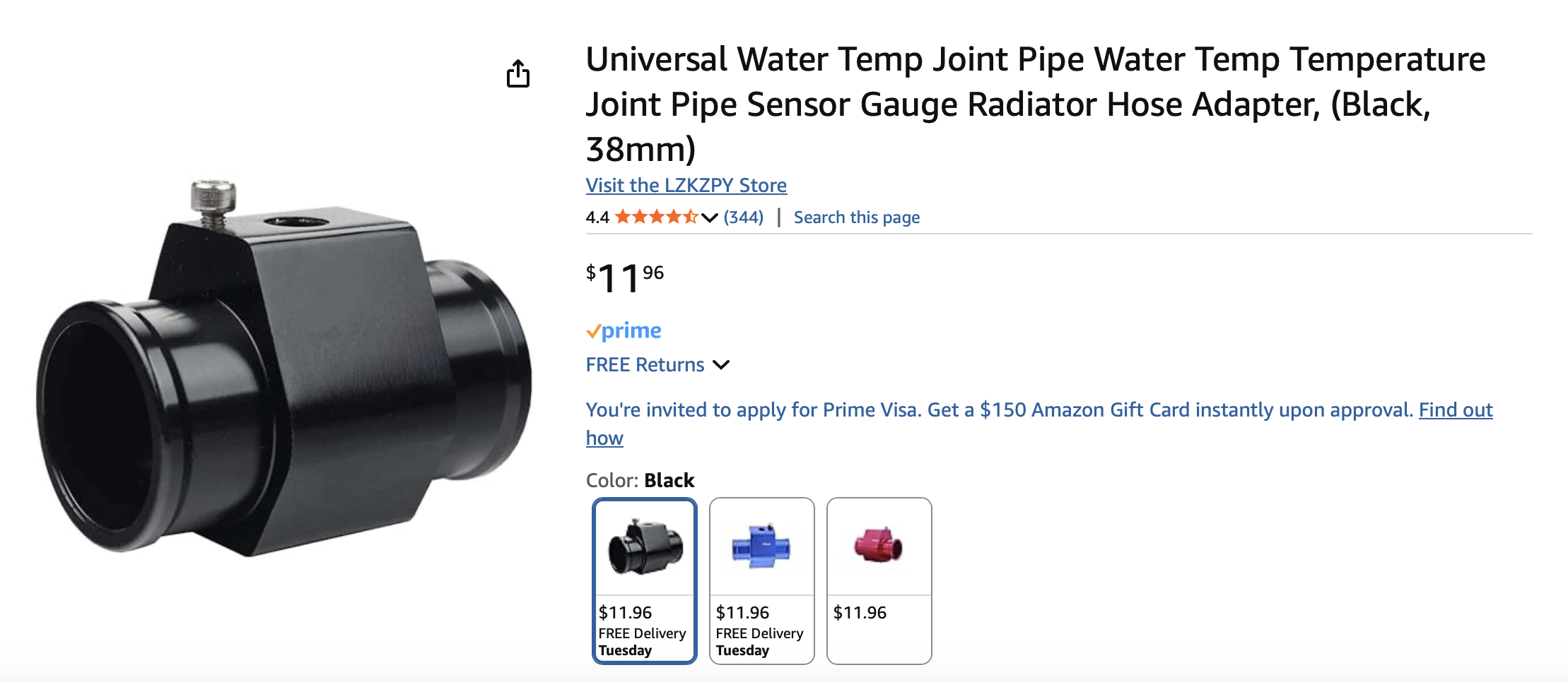

    How about this in the top hose right after the thermostat and water neck? Many sizes on Amazon. Screenshot 2025-05-17 at 6.24.40 PM.png

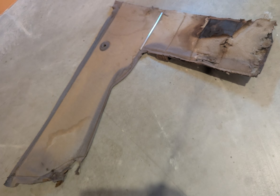

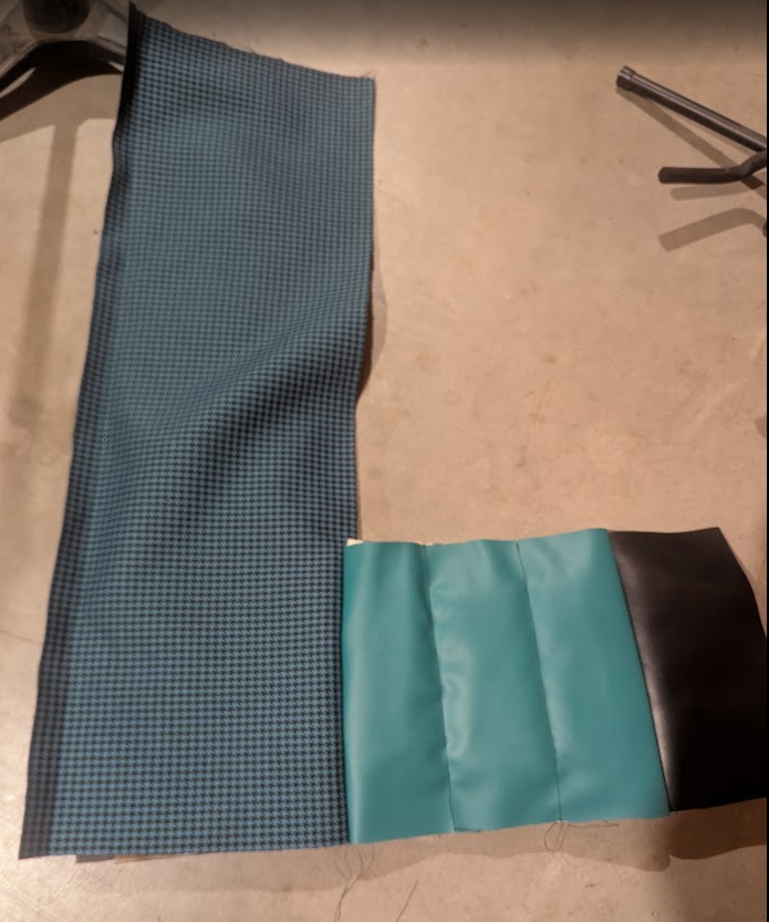

    Rear side panels before:
    Got the sewing done, will get them pulled tight and glued to the cards soon:
    The original upholstery was sewed to the cards, but I don't think my little machine will do that. The front has some grabbers to keep the material in place. The rest will just get Weldwood adhesive. Stainless trim will be going back on too.

    My new radiator is in Chicago, according to the tracking number. So, it was time to move forward with other projects.
    I am, quite obviously, NOT a professional upholsterer. I do, however, have the balls to dive into projects like this. One rear side panel is in the car; the other is getting glued up with Weldwood. I'll start on the rear armrests soon and post up what it all looks like in the car. The teal-colored vinyl looked WAY too dark when it arrived, but it's growing on me. The houndstooth material is a little bluer than I'd hoped, but I think it's all working well together.

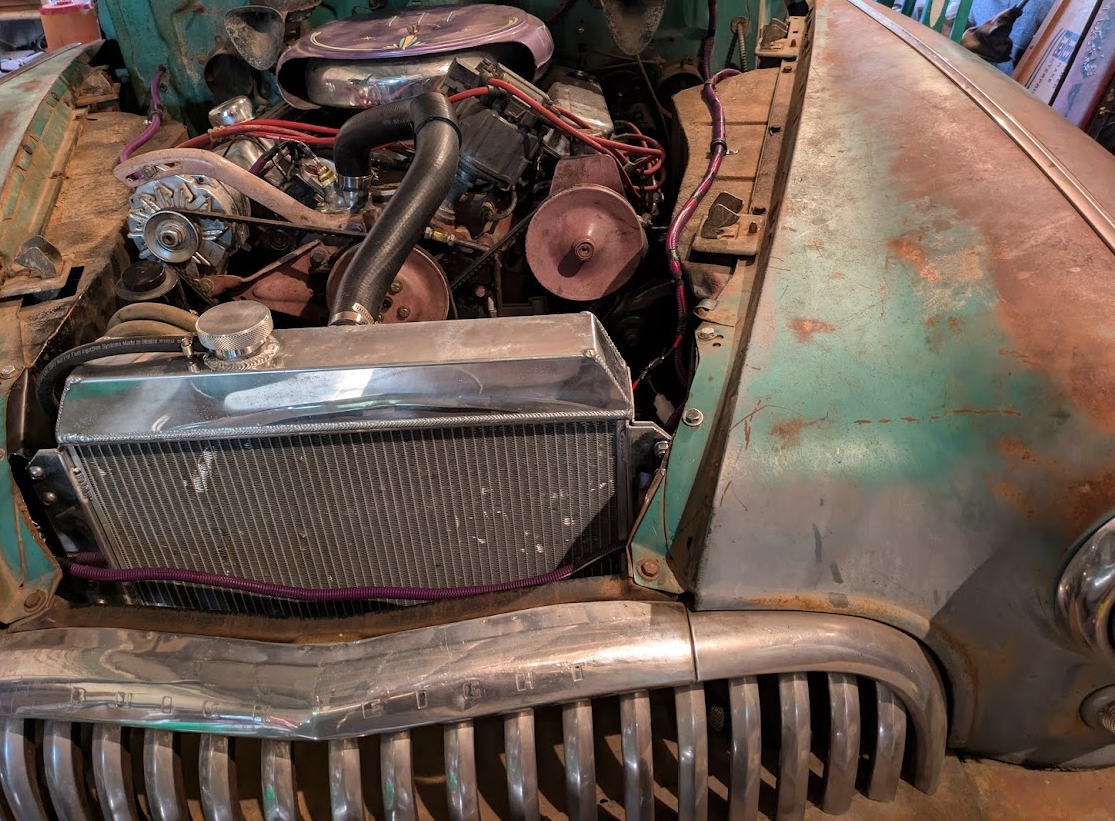

    Working on fitting the new radiator. Had to re-work the lower mount/crossmember. Still tweaking a few things to get it to move forward just a bit. 1/4" or so. It looks like it will fit well. Will need to make some side panels to close the gap between radiator to the inner fenders. Hope it cools well. And hope the hood fits too.

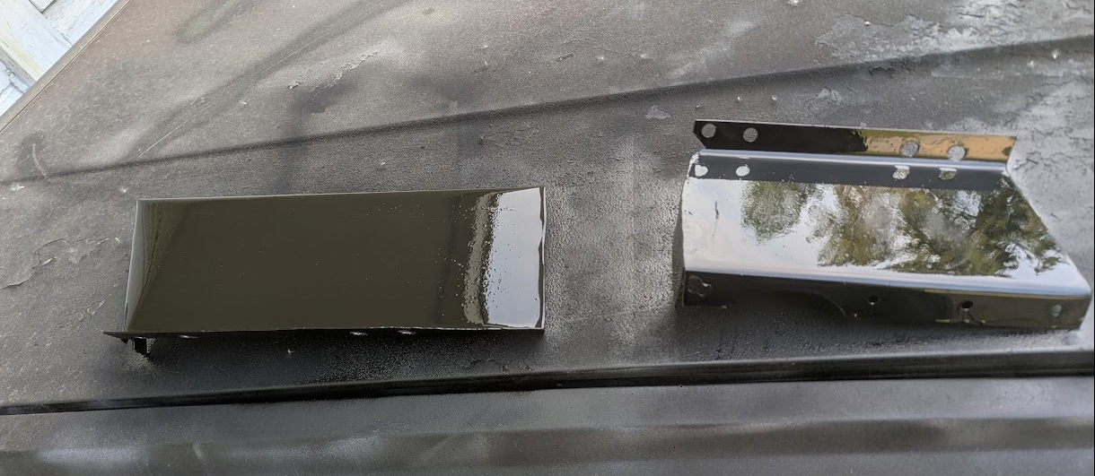

    Made these to bolt the radiator to the inner fenders (& direct some airflow) & spray bombed them. Remember, this is no show car, just a driver. They're sitting on my favorite paint spot - a '78 Impala front clip.

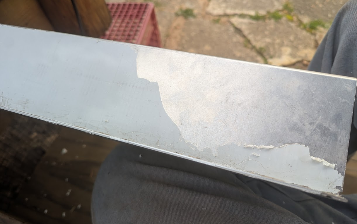

    How the hell do you get this protective coating off of the polished aluminum fan shroud? Worked at it for a few hours yesterday and have one side left. The biggest piece I could peel off was about 3"X5". Basically, using my thumbnail to scratch it off. Tried a little heat & a bondo spreader. Tried lacquer thinner. Even called the place I got it from. They said just lift a corner & it peels right off. It doesn't. When I told the 'tech guy' on the phone it will take me 5 hours to peel it off, his response was basically - well, you better get peeling. Maybe it's been on there for too long? Or it got baked on in the FedEx truck during shipping? Probably should have just got the DA out and sanded it off. Just one more way this POS keeps fighting back. It's trying hard not to get driven.
    winduptoy and SS327 like this.

    Hard to tell from the pics, but the radiator only has about 1/4" of clearance with the steering box.
    The PO did the frame mods & engine install. I would have done things differently. A rear steer set up would have probably been better. A rear sump pan would have helped a lot. Really starting to learn that it's better to start with a virgin car, than to finish somebody else's "almost completed" project. Hoping to get back on it in a few days when I'm mobile again. Feels pretty good now, unless I stand up straight, or walk normally.

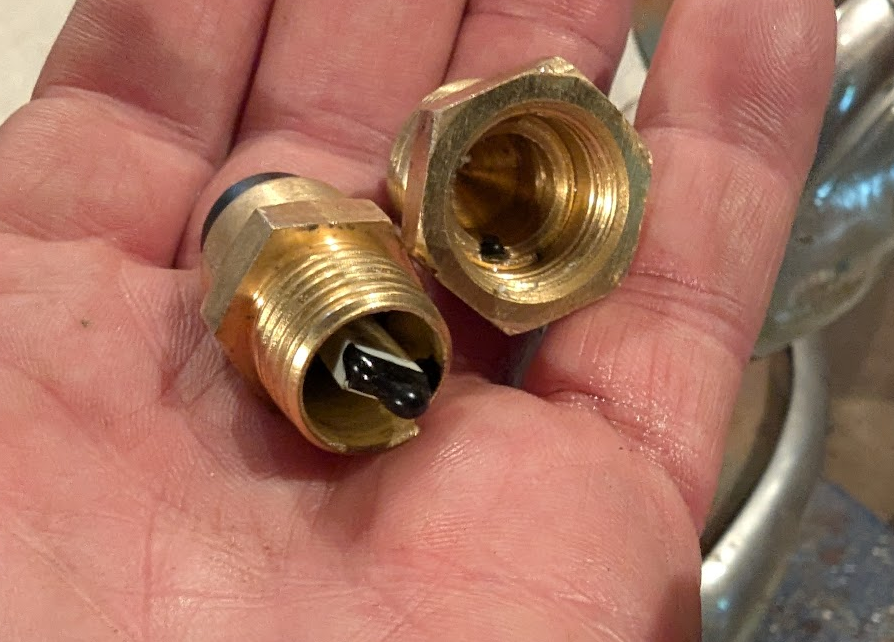

    Success! Well... so far. I contacted Champion radiator - nothing. No response at all. Expected more from them. When I tightened the pet**** by hand, it broke. I'm not that strong. The "ears" or "wings" just turned on the shaft. Not leaking, but it will need pliers or something to loosen it. I can change it when the time comes. That & the sensor falling apart, I ***umed would get a response.
    Ordered a new fan control from Amazon. Put it all in and it leaked. I'm afraid to tighten it. Took it back out (AGAIN) used yellow Teflon tape & no leaks! It sat & idled about 180-185 according to the gauge. The thermostat is a 180 & fan comes on at 185. I need to permanently run the wires for the fan circuit, as I just did them temporarily in case this didn't work. Then, I can see if A) the hood fits back on (fingers crossed), and B) if it cools at Hwy speeds. Gonna shoot for the local Tuesday cruise. Wish me luck.

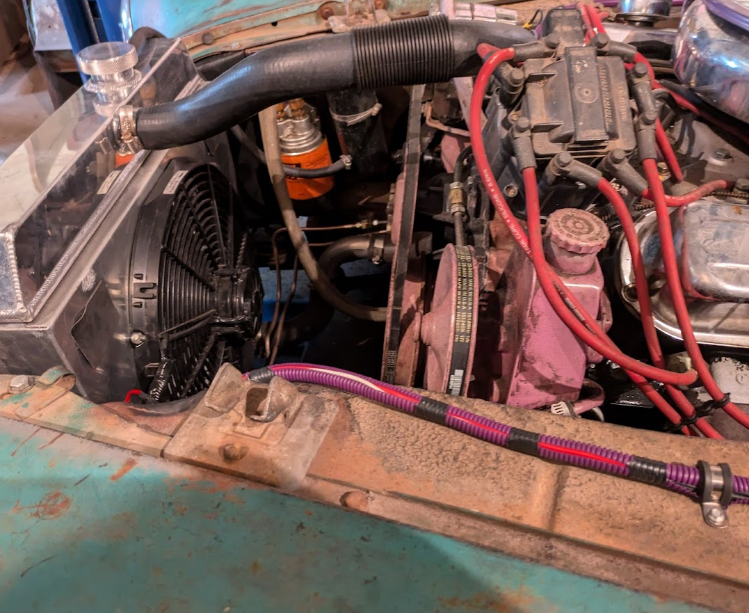

    Took it for a ride with the hood off. Maybe, 5-7 miles. At first it was holding about 190, then it crept up to 200 or more (this, all according to the original gauge), and I drove it back home. It was hot but wasn't puking coolant. Turned it off and tried to restart it. Wouldn't turn over fast enough - too hot. The gauge pegged after the cooling fan stopped. So, small victories, but it's still not really roadworthy. I'm tired of throwing $$ at this thing and it just won't run cool.
    Yes, the upper hose is still above the radiator, but it's the best fitting one I've found so far. What's next?

  20. BJR
    Joined: Mar 11, 2005
    Posts: 11,361
    BJR
    Sorry to say but.... Put the engine in correctly so it is lower than the radiator, and you can run an engine driven fan with a fan shroud. Also when you have the engine out, remove the core plugs and clean out all the rust and **** that is at the bottom of the water jackets and between the cylinders. That should help a lot if there is a lot of crud there.

    Have you tried a different gauge? Also you need some shrouding in front of the rad(TOP) to force all of the air thru the radiator.

    BJR has some good suggestions and, unless the camara angle is misleading, that engine sits way to far from the radiator.

    Did the fan temp switch work? I'm a little surprised as the tephlon tape would insulate the switch from grounding.
    I found the off shore made adapters that come with the temp switch don't seal will. My fix was to get a better quality (?) adapter at the Ace Hardware.

    @pprather The fan temp switch worked as it should. The instructions say to not use tape, but it was dripping without it. I'm sure that the threads cut though enough to make the ground. The yellow tape worked awesome.

    The area around the radiator needs to be sealed so air MUST go through it, not around it.
    Don't forget that grill air should also not go into the hood cavity, over the radiator.
    You mentioned current production autos, they are all sealed like this.
