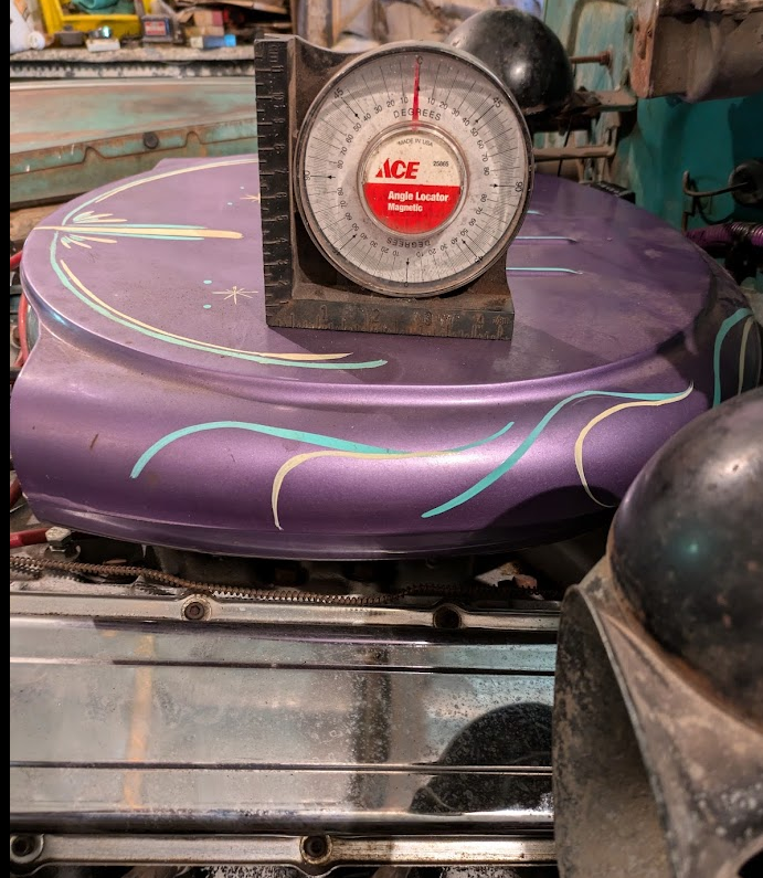

  7. Have you tried this yet?

    Update. Tried a couple thing today. Reset timing. It was on 8*BTDC & my Chiltons said 6*BTDC. Yes, I pulled the hose off the advance & plugged it. Pulled the Tstat, to see if less restricting might help. Used Water Wetter, topped off the system with water. Was 50/50 before, but maybe now 55/45? Replaced the cap that came with the radiator (16lb) with Mr. Gasket 16lb w/ built in temp gauge, so I can get a good idea of the temp.
    Fired it up (high idle). 6 minutes in, the fan came on 160 at rad/170-175 at gauge (sender is front left in block). 10 min in 180 rad/170-175 gauge. 15 min in, same. So, I'm pretty sure this thing can idle ALL DAY at 180-185.
    Took about a 7-minute drive in the country & returned. It did stumble a little, but I found I forgot to hook the vacuum back up to the distributor. Both read about 200.
    Kept it running at idle. After 8 min down to 180-185.

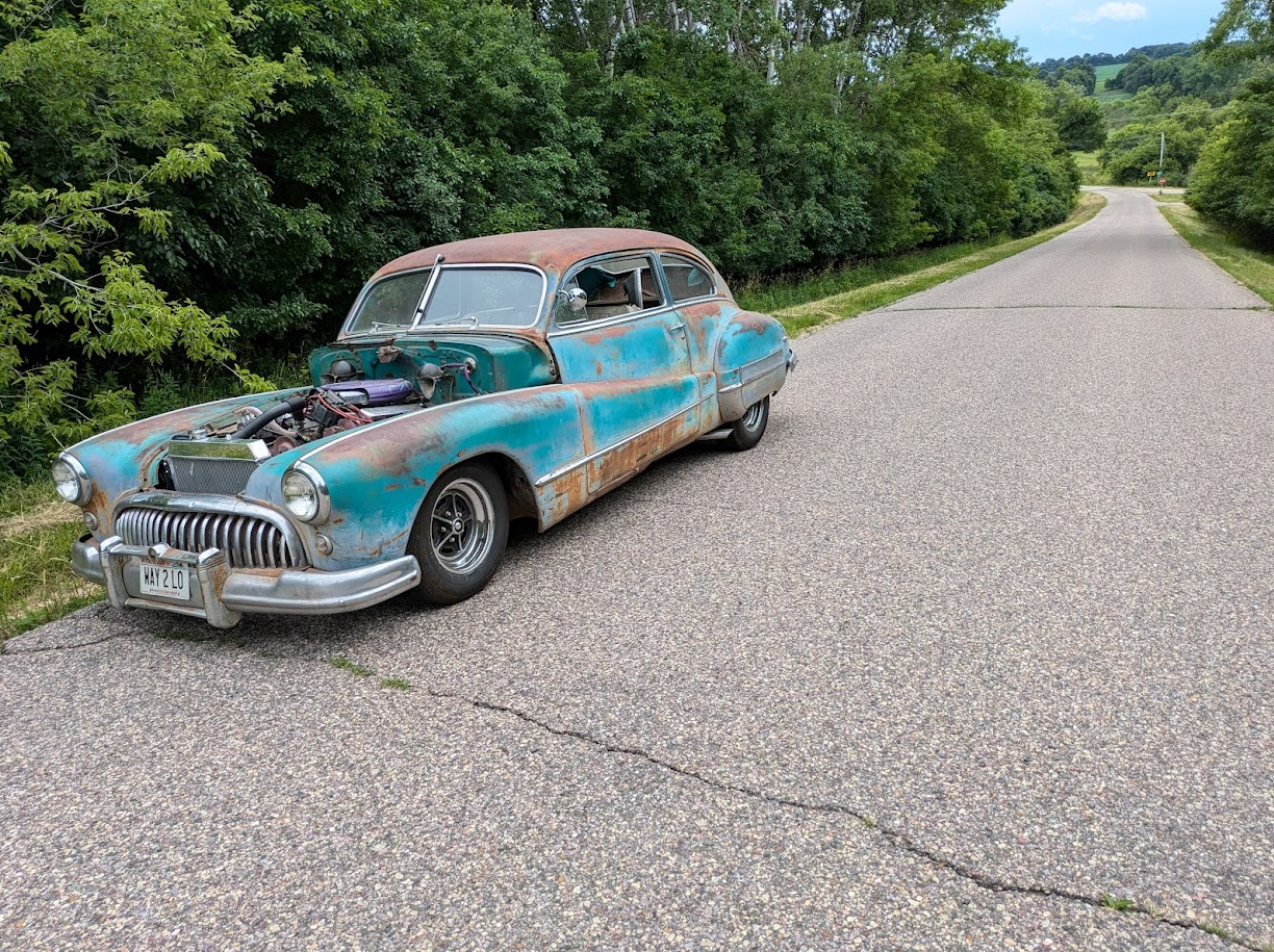

    Drove the short distance into town 1.5 miles? and drove through town (small town) to my Bro's house. Left it running. Was maybe 190 max but dropped back to 185ish as I B.S.'d with him for a few minutes. Backed out of his driveway & it quit but restarted quickly.
    Drove a different way home, with speeds of 35-40mph. It started rising quickly. I was nearing home, climbing a steep(ish) hill and it quit. Gauge looked to be about 205-210. Climbed to 220, not running (of course). Wouldn't restart (turned over too slow), and my bro brought a chain to get me the last mile or so. I left the fan on until he got there (15-20 min) and it was cool enough to restart, but not enough battery. Towed home, put the charger on & it fired quickly.
    So, what did we learn? I can go into town to hit the local cars & coffee at the Piggly Wiggly & the local show at the American Legion, but I can't go any farther, or faster than 25mph without the temp rising.
    I will try to fab up some shrouding in front of the radiator. At least close the open spot between the top of the grille & radiator. I'm wondering if something on the sides would help too. The outer 10" or so of the grille opening, are past the side of the radiator. Maybe diverting that air into the cooling area, and not just hitting the inner fenders would help? Couldn't hurt.
    Questions:
    1)High flow pump? Flowcooler makes one for the Cad - $168. Faster flow = better heat transfer = better cooling. 2)Better fan? I have the 16" Spal 30102049, pretty much the high-performance model. But they make one with a bigger motor that is designed to pull air through a 4-core radiator while using AC. The CFM ratings aren't that different, but if it pulls more air through a 4-core, it has to work better on the aluminum 2-core with more space between the tubes. Doesn't it?
    3)Other than shrouding the front, any other ideas? A bigger radiator will not fit. This one's supposed to cool 600HP. How about adding an aux radiator? I've never seen dual rads, except on Indy-type race cars (one on each side), or maybe kit cars. There would be room in front of the one that's in there, but then iut will impede airflow to that one.
    Everything I've done has made small improvements, but it's still not drivable any distance.
    Here's the shot of shame. On the side of the road, waiting for rescue.

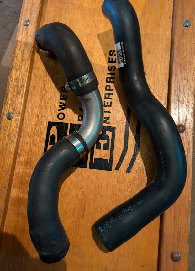

    Old lower hose & new:
    Truthfully, the one I made fit better. But for replacement purposes, finding a '77 Impala hose should be easier than "Hey, I need a hose with a couple of 90* bends, and a dipsy doodle next to one of them, or 2 that I can cut up and make them work." Plus, this one has a spring in it.
