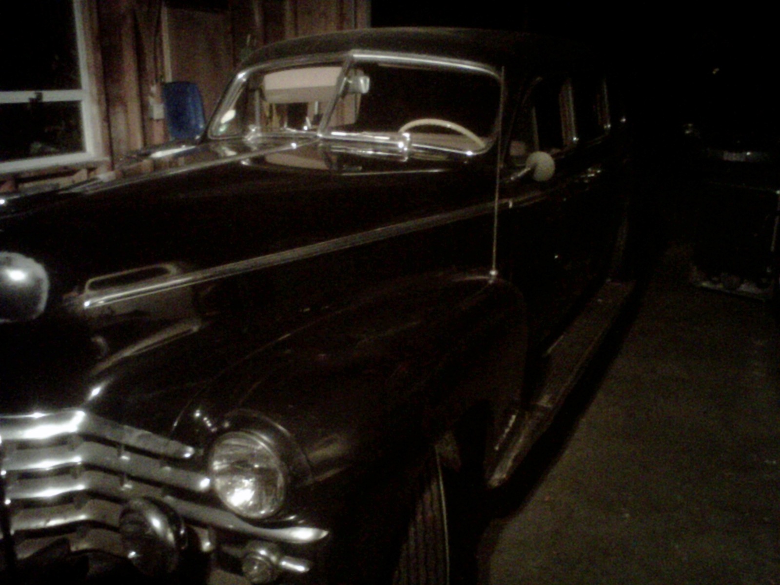

    Trying to figure out how to upload pics of my series 7519...
    :eek:
  18. 1947Caddy
    Joined: Feb 27, 2013
    Posts: 7
    1947Caddy
    From the back (way back, since it is a loooong car)
