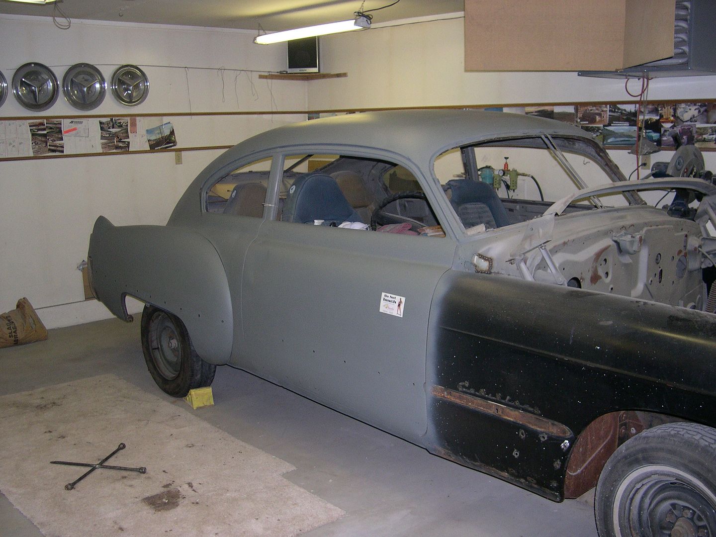

    Cool, thanks. Here's a ****py pic of mine. I still have to get it off the trailer. A buddy gave it to me and I didn't believe him so I didn't unload it right away in case I had to bring it back.:D
  11. Indy47Caddy
    Joined: Nov 8, 2012
    Posts: 169
    Indy47Caddy
    Well you can't beat a free Cadillac!;) Is the car complete? Or are you going to need to find a parts cars? I imagine parts for a 48 won't be much easier to find as they are for a 47.... What's your plans for it?

    That's a '48 Sedanet on the trailer above...you can tell by the lower part of the hood that curves down alongside the grille...'49's shared the same body style except the hood was cut straight across...most '48 and '49 body parts interchange except the hood and grille.
    The '48 had a really unique dash in them...and the '49 dash was changed quite a bit...'48 Sedanets are much more desirable than '49 sedanet.
    I have a '48 which is going to be my next build...[​IMG]
