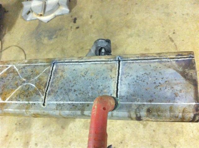

    Hi again, just a few more pix, I am in the prosses of modifying the ch***is by constructing a cross member for the centre of ch***is so it can carry the wieght of the body as per an origional convertible ch***is (bit hard to find an origional convertible ch***is in Aus) so with the help from plenty of images I have constructed a timber pattern as a template and will soon constuct it from steel, pix of this to follow soon, cheers for now, Ian :D

    Hi all, had a few good nights playing in the shed working on the cross member to support body, all timber at this stage and will start plasma cutting and welding soon, enjoiy images, by for now.

    Sorry I havn't posted anything lately, you know how it is, 3 boys to keep in line, oh and a wife, but here are a few other images of the engine I picked up from my dad garage prior to stripping it down, and the rear spring mounts fabricated from 6mm plate cut with plasma cutter, I will send more soon as I am now fitting the steering rack and fabricating new engine mounts prior to welding in ch***is rails, cheers from down under for now.

    Yes I'm still alive, been very busy with work and all and life in general, I have been having some progress on the 47, now going to convert to a 2 door convert not 4 door, and will extend front door guard extensions through to the back guards ( similar to Buick) ch***is plates nearly ready to weld (images) trial fitted brake booster & clutch/ brake pedals, diff & springs, steering, motor & other bits, I know their small steps but at least still moving forward, cheers from down under for now.

    Hi all, here are some more images of the ch***is x member all welded and ready to fit to ch***is, have to lift body off and place in from above, seeya for now

    Just aligning exhaust, handbrake and clutch mount prior to body removal, I'm using flanges along the length of the exhaust (4 each side) because the entire system p***es through the ch***is, so I want to be able to remove sections for maintenance or different note sound.
