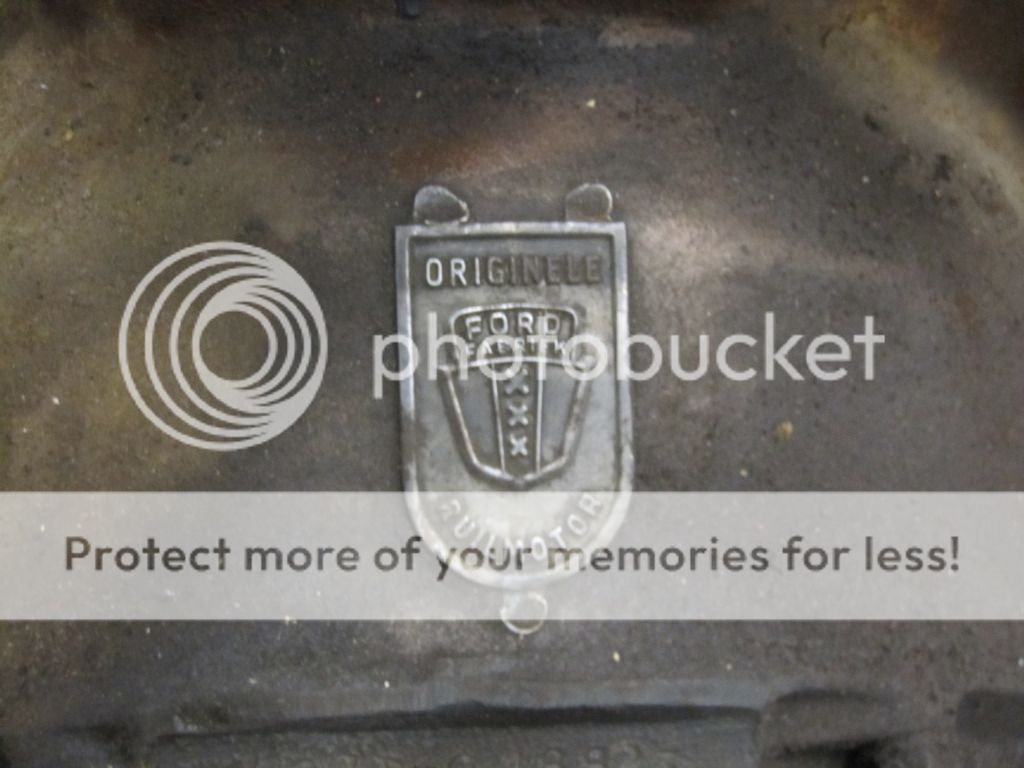

    the cab went off the frame !
    original amsterdam factory exchance engine tag

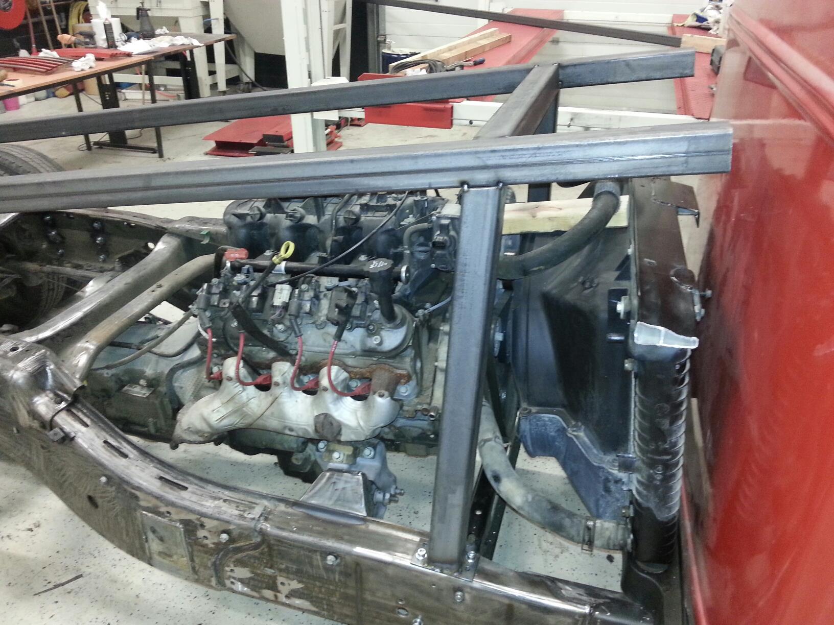

  9. locating the engine
  10. kscarguy

    What is the plan for the radiator?
  11. Great idea. That creates a lot of extra and much needed room in the cab. Neato
  12. The plan is to make a tunnel from the grill that goes under the floor to the radiator
    sander,

  27. got some more done yesterday
    more paint removed and lowered the cab a little bit more over the ch***is
    also cut a hole for the radiator in the back of the cab
    and added a floor brace

  29. got some more done last week
    removed some more paint from the doors
    and added some more steel to the ramp in the rear
    and have been working on the floor/radiator cooling tunnel
