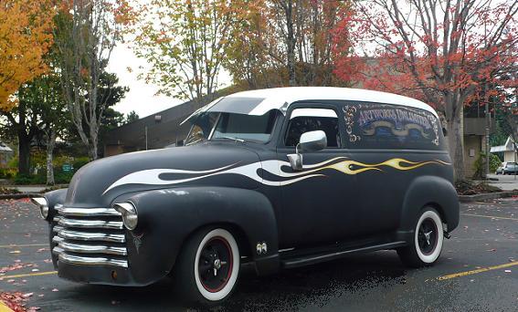

    Hey CVS...I just sold my old '50 Chebby Panel Truck to a great guy in Amsterdam!
    I'm sure you've met Martin...he's an absolute motorhead!
    btw...your dashboard looks KILLER!!!

    Yeah, he's had it for a year already, and he's taken it on some serious road-trips too.
    He can be found hauling his Falcon racecar with it...and it's still got all my graphics and logo's on it too!
