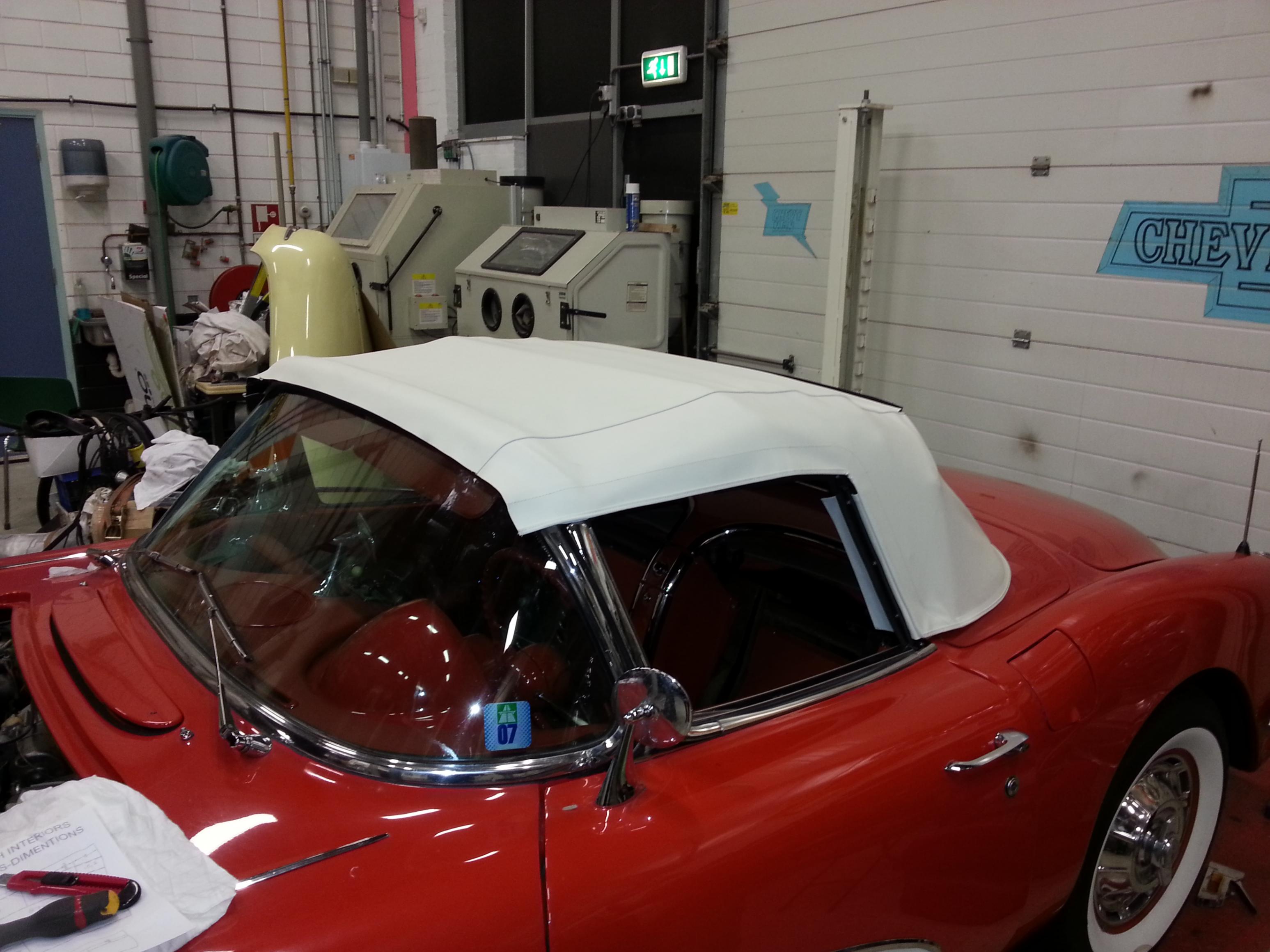

  6. Nope nothing done in the last 24 hours on the Coe :eek:
    i wil get back on track tomorrow ;) (had a side project going on, softtop installation for a friend)
