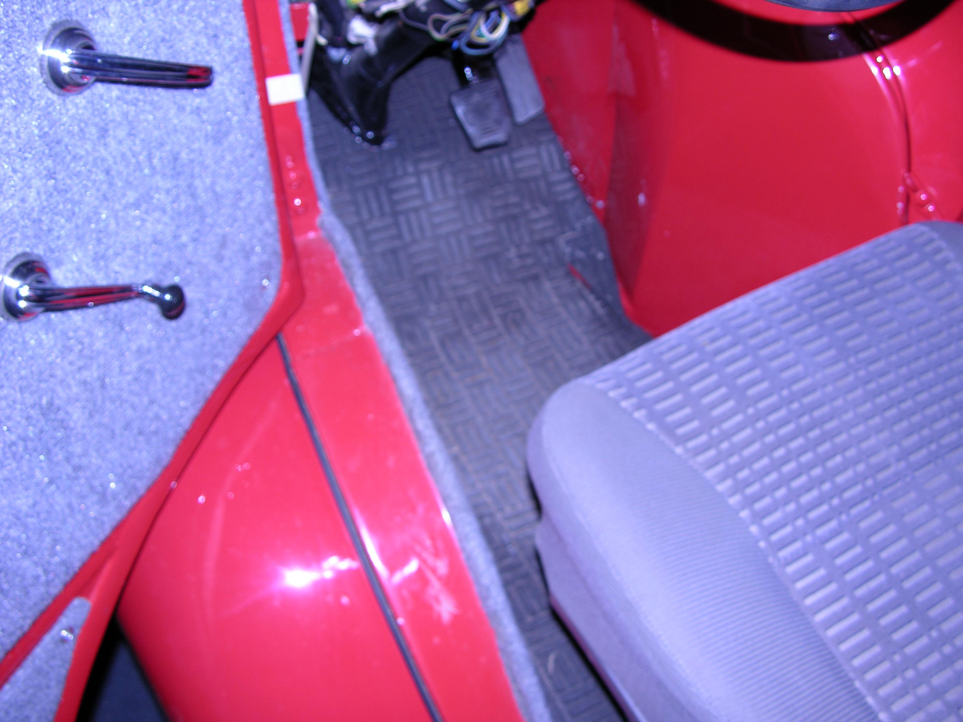

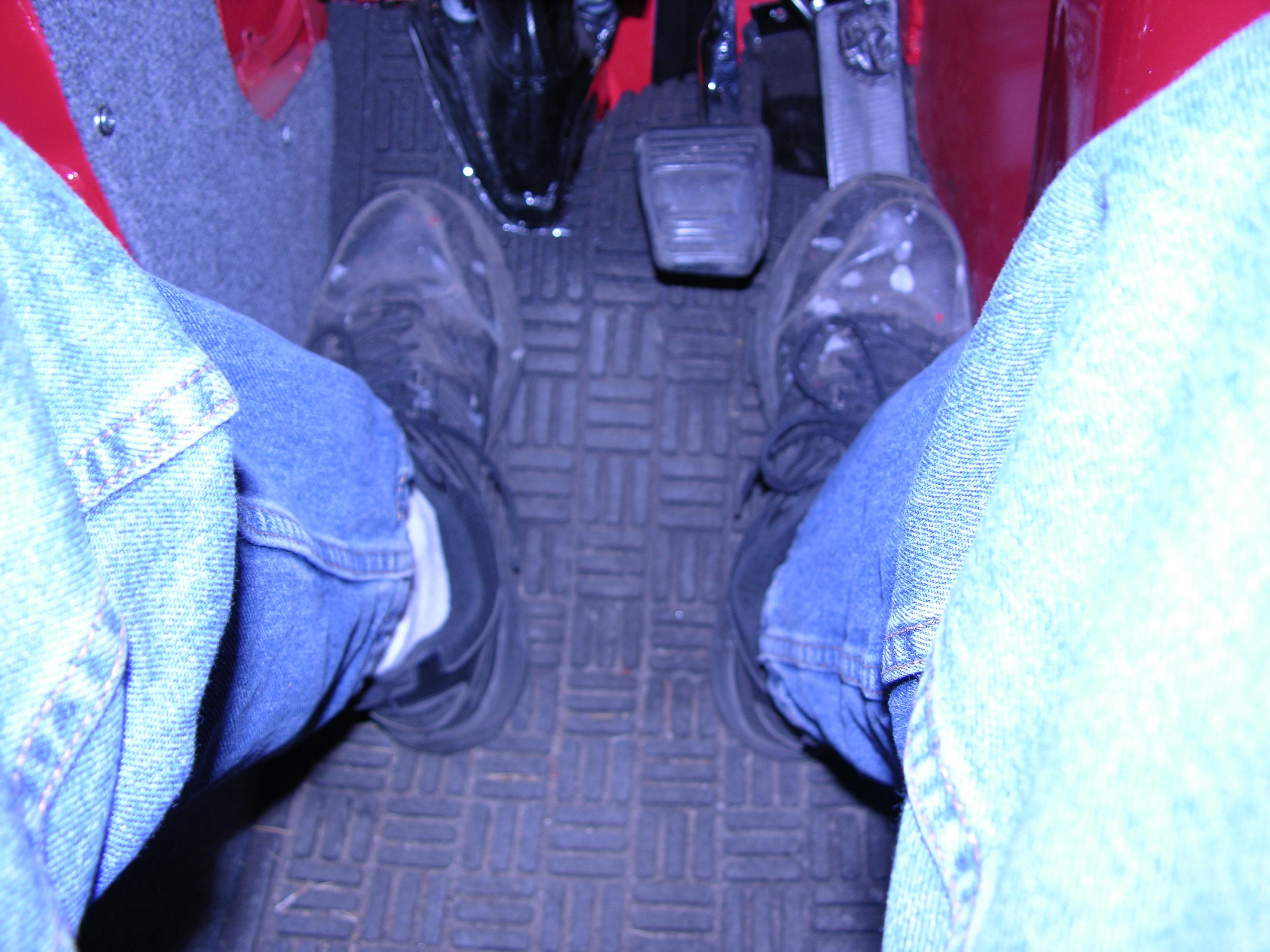

    Corvettesander,
    After looking at all the floor space you have in your truck
    I HATE YOU!
    This is a picture of my floor space.

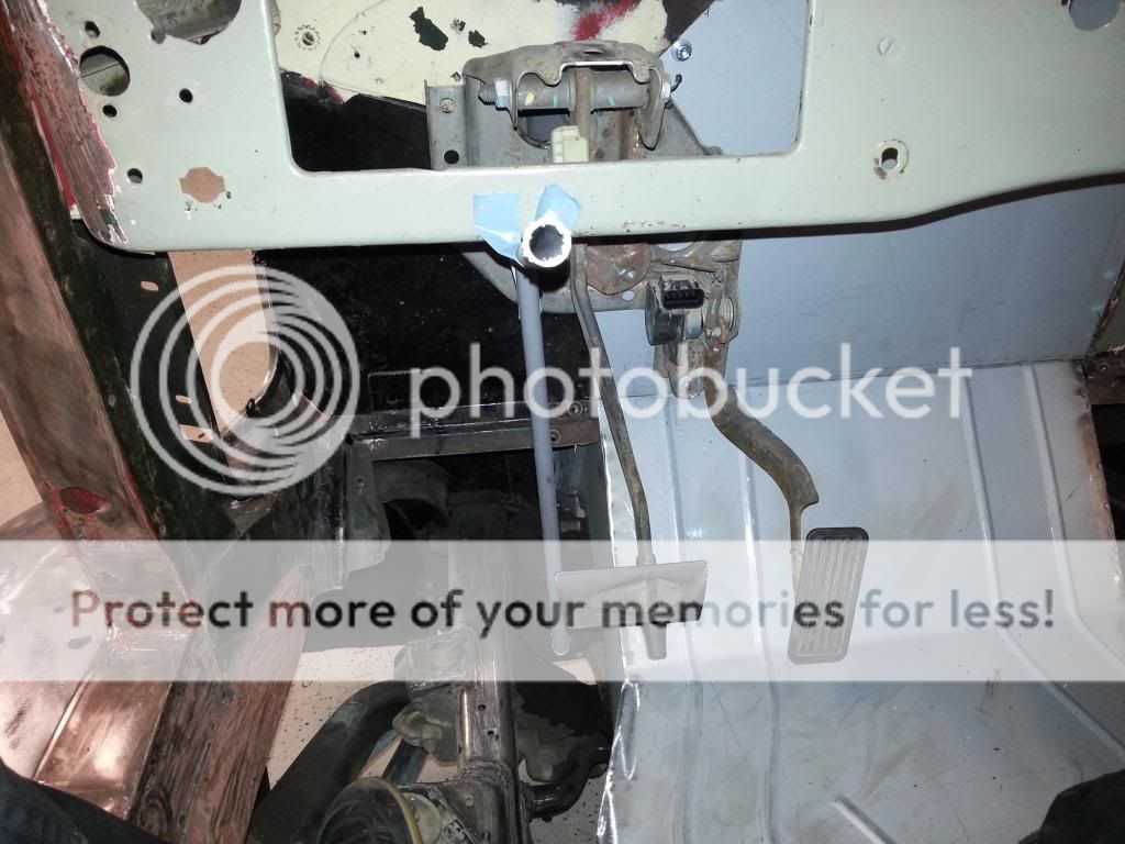

    now i am working on the brake ***embly setup and locating the steering column
    figuring out what parts i need.
    and its going to be a ''shorty'' column

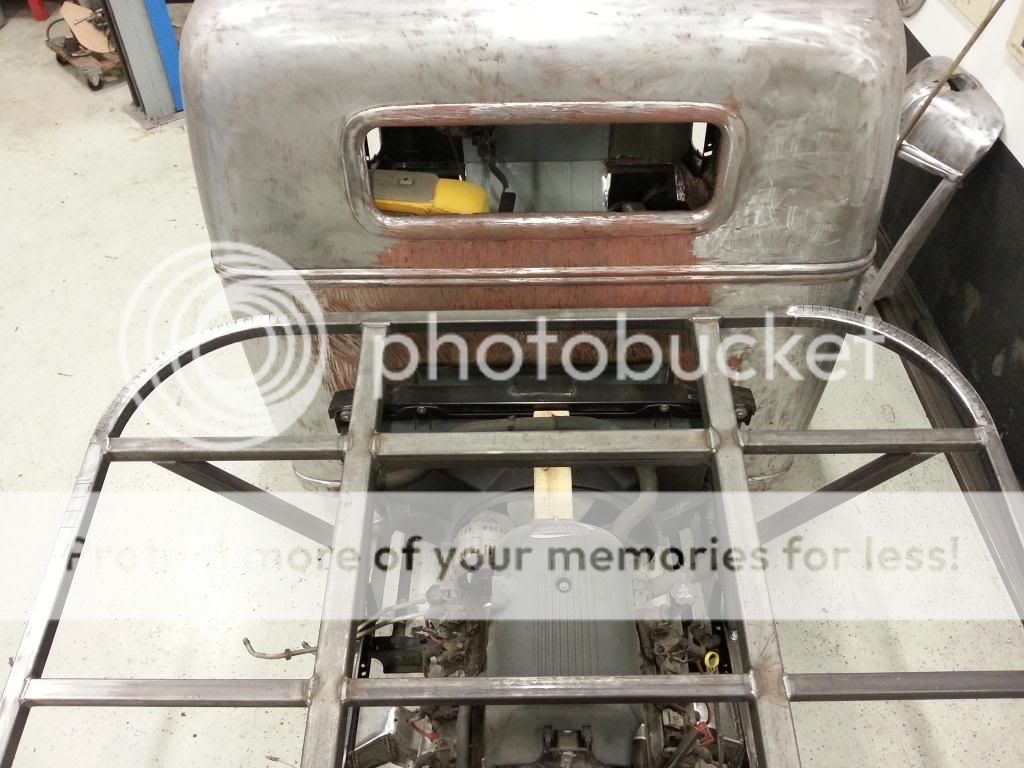

  15. got back working on the ramp made the front corners
    also got the winch in today ok a little bit overkill with 12000lbs
    checking the fit and will make a nice cover for it later on

    Beautiful! I don't care where the radiator is. ;) The curved bed corners look fantastic, it looks killer. I also like the engine choice.

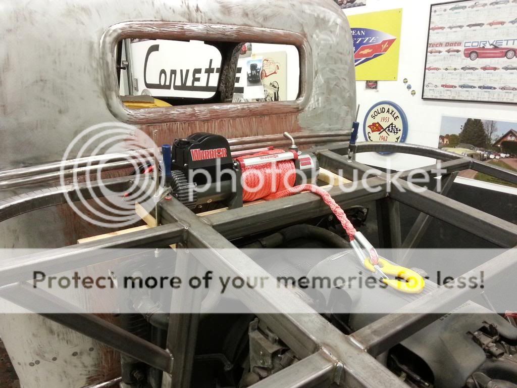

  19. got the winch in place and out of sight
    now i am working on the engine harness have got the pcm re-programmed
    and pinning out al emission related wiring, and re routing wiring for stand alone
    left over wiring
    added some wiring to go to the dash and a few wires for fused key power
