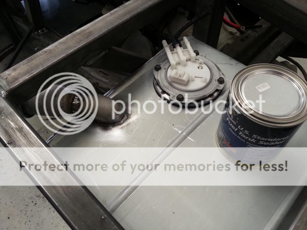

  6. after trying to figure out where to put fuel tank that came with the silverado,
    and since the original locations for both the tanks are occupied by the engine
    and ramp storage now, and would not fit elswhere
    i decided to make a new fuel tank
    made the tank the same height as the original so the fuel pump/sender will fit
    the capacity is abouth 32 gallons
    still need to make some brackets

  8. made an adaptor plate for the fuelpump/sender
    didnt want to weld it on because of wraping the tank and adaptor
    so i drilled a few holes :)

    Nice. On my tank I just used RTV silicone + sheet metal screws. Doesn't speak for my craftsmanship but it works fine and it's out of sight anyway.
    Did you machine that ring or were you able to buy it that way. Oh yea I bet your friend has a machine shop... :p :rolleyes:

  11. machined it @ work ;)
  12. Probably not the best idea since most RTV Silicone's get eaten away by gasoline ..... :eek: You might be getting a leak and not know it, and the silicone could fall in the tank and plug your pickup.

    It runs on diesel and also I used silicone that is rated for gasoline.

  17. got the tank almost done, made some brackets and placed the filler neck
    next task will be to treat the inside with a tank sealer from Por.:)

    Forgive me, but I'd like to make another suggestion...I would reinforce the lower mounting tabs. The apear that that over time, vibration and fuel weight will try to tear them apart. This is just my 2 cents worth based upon what I can see in the picture. Otherwise keep up the good work.
  19. no problem :) the tabs are 4mm thick (8 a 9 gauge steel)
    but i will check if i can reinforce them a bit more
