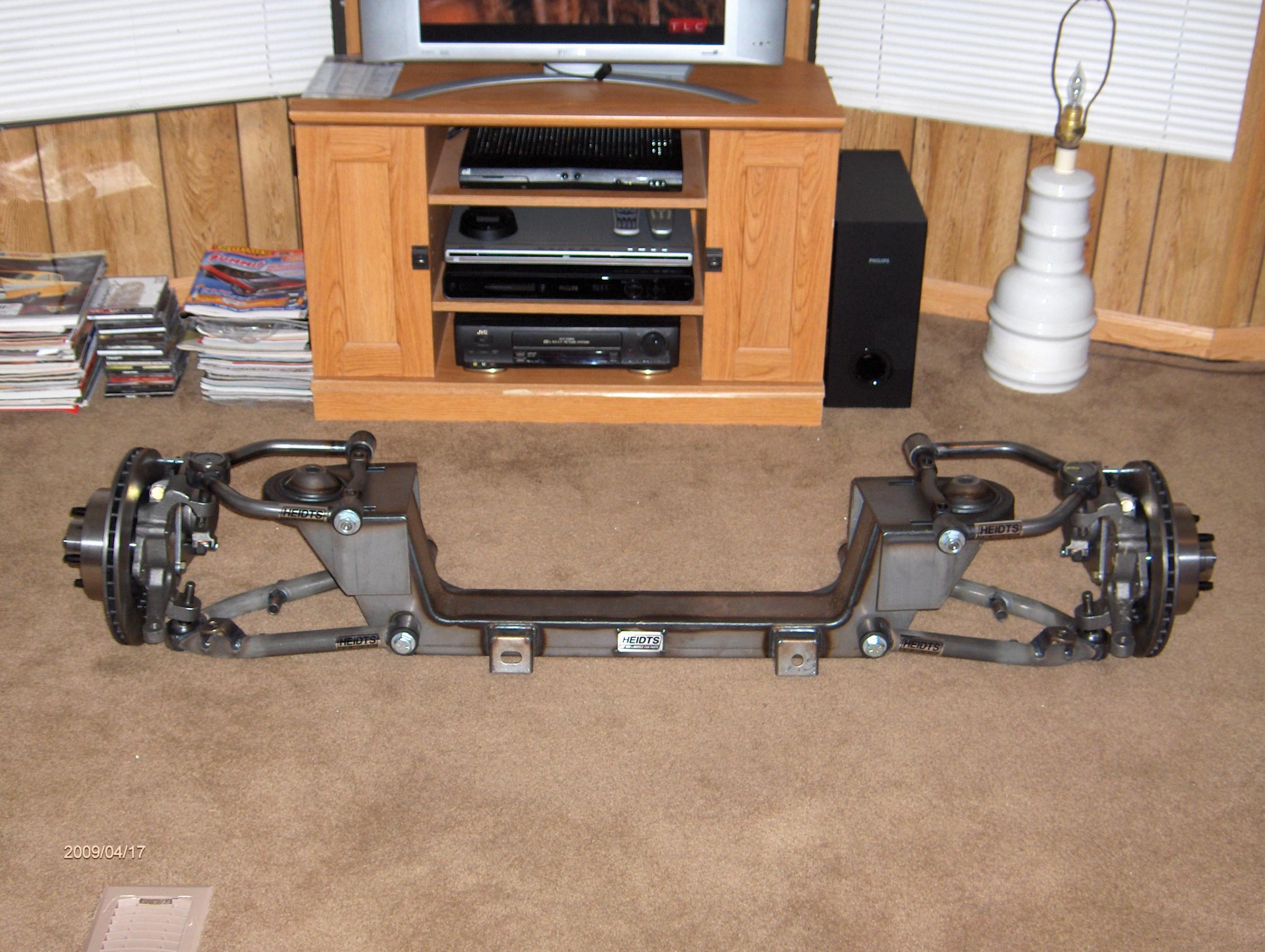

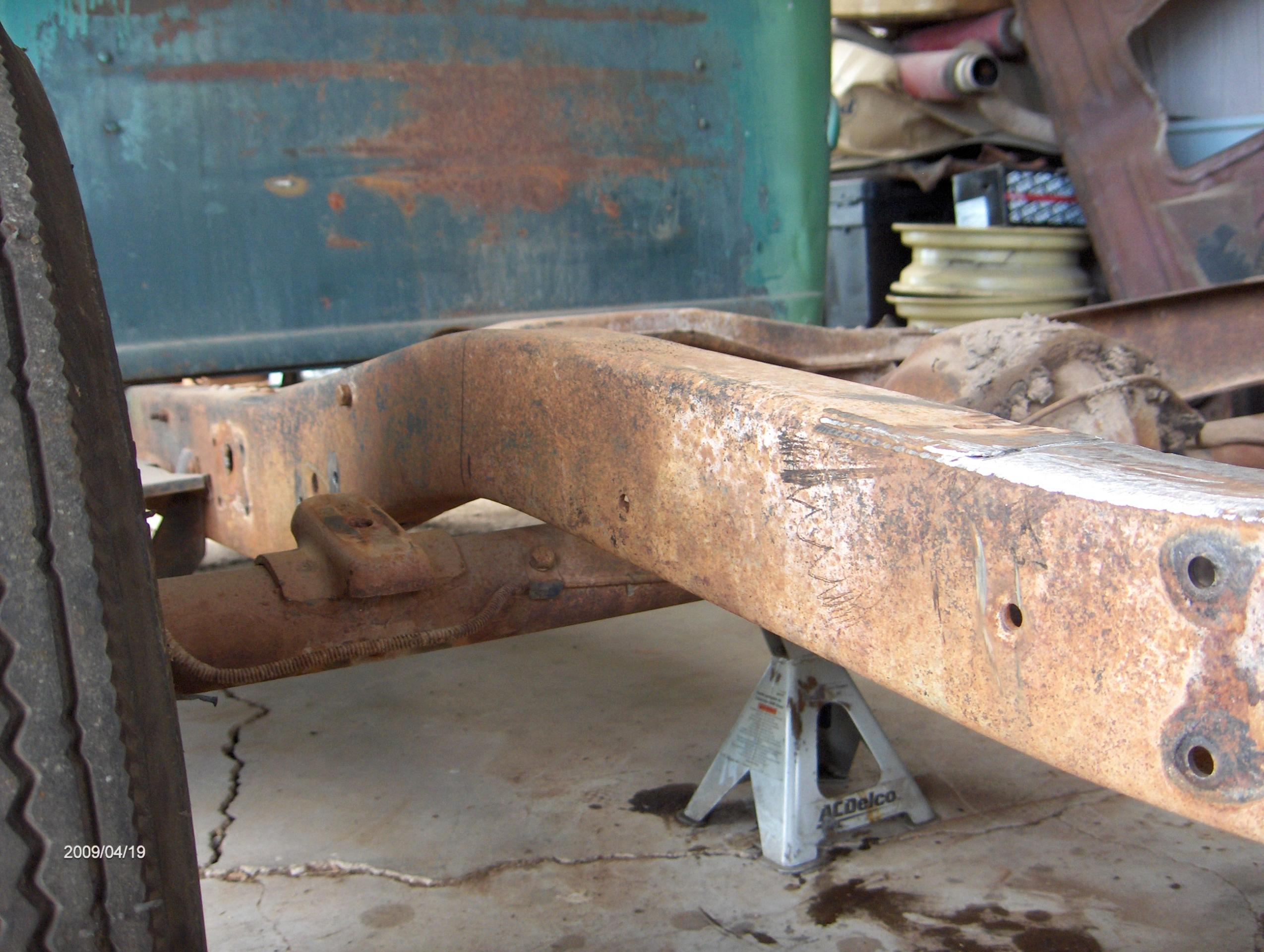

    Some pics of the Frontend.
  8. ULRICK
    Joined: Sep 19, 2010
    Posts: 75
    ULRICK
    from Texas

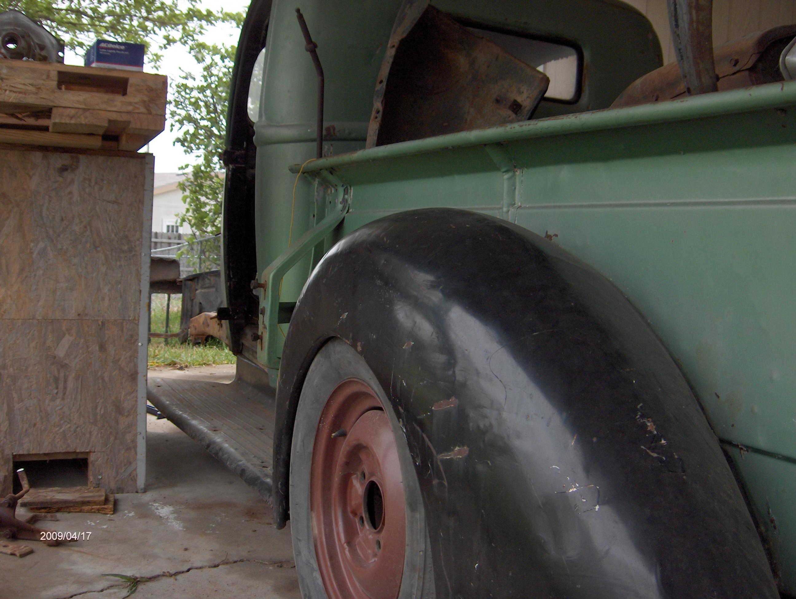

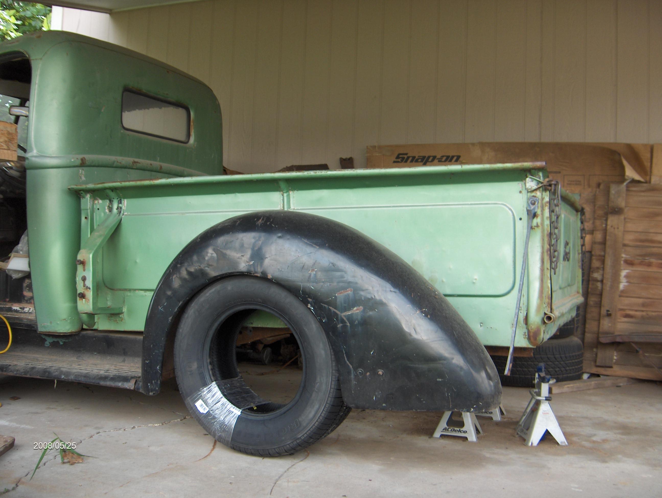

    The Body is in pretty good shape, the floor and cabcorners got some rust, but no big deal.

    I agree - old trucks are great! Last time I had my '47 Ford at Lowes picking up lumber - I had 3 or 4 guys stop and say I looked like a perfect Ford commercial. I said "yep, hauling lumber for over 60 years!!"
    Hot Rod trucks are sorta perfect in that way - you get a cool ride PLUS you can haul **** with them too! Yours looks great - keep us updated!!

    Ulrick, are those front fenders on your pickup the original pickup fenders, or are they off a larger truck? I'm kind of new to 42-47 Ford trucks, and have a lot to learn. I do know one thing, though --- I really like them!

    Yes, those are the original front fenders.

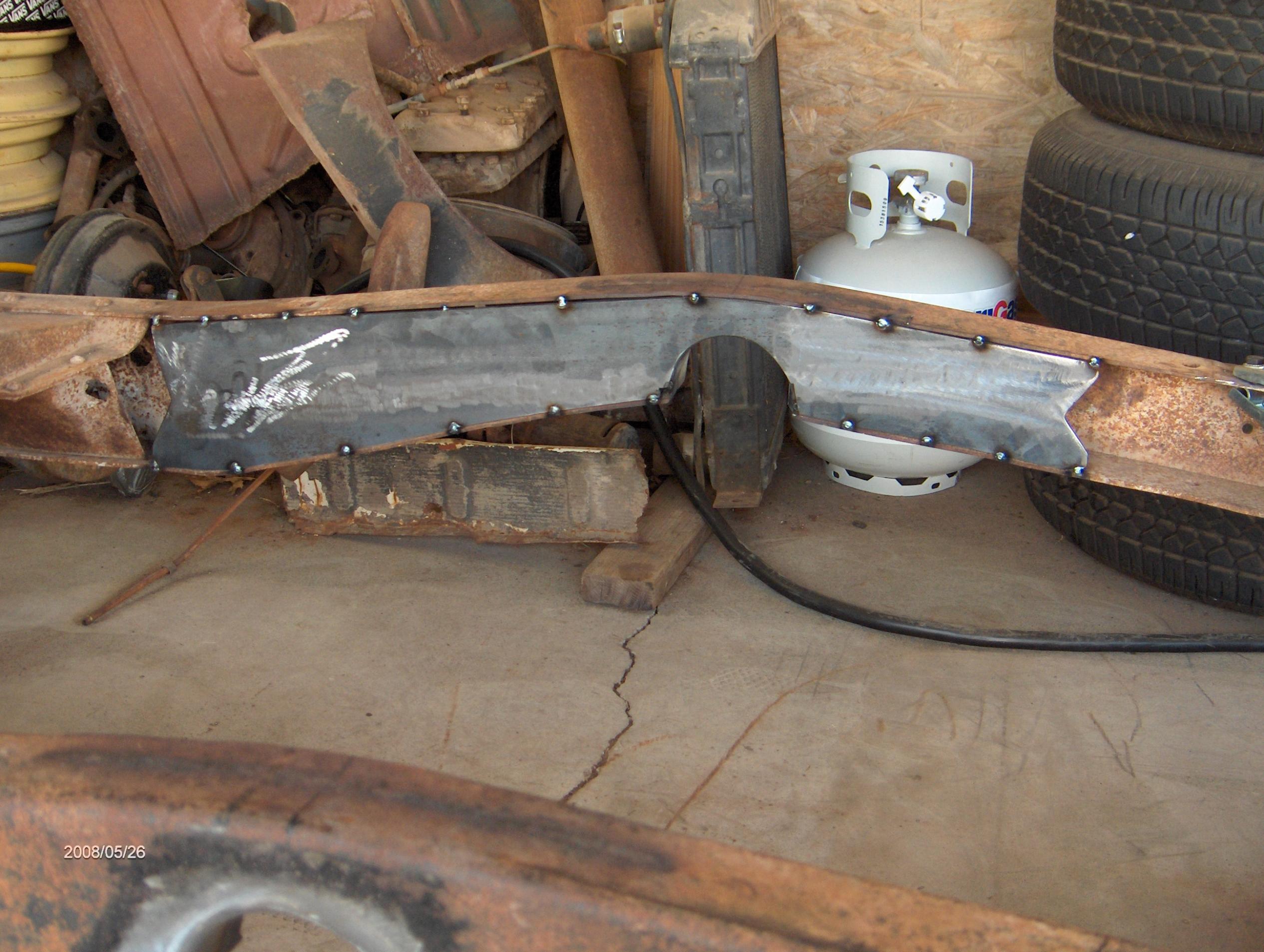

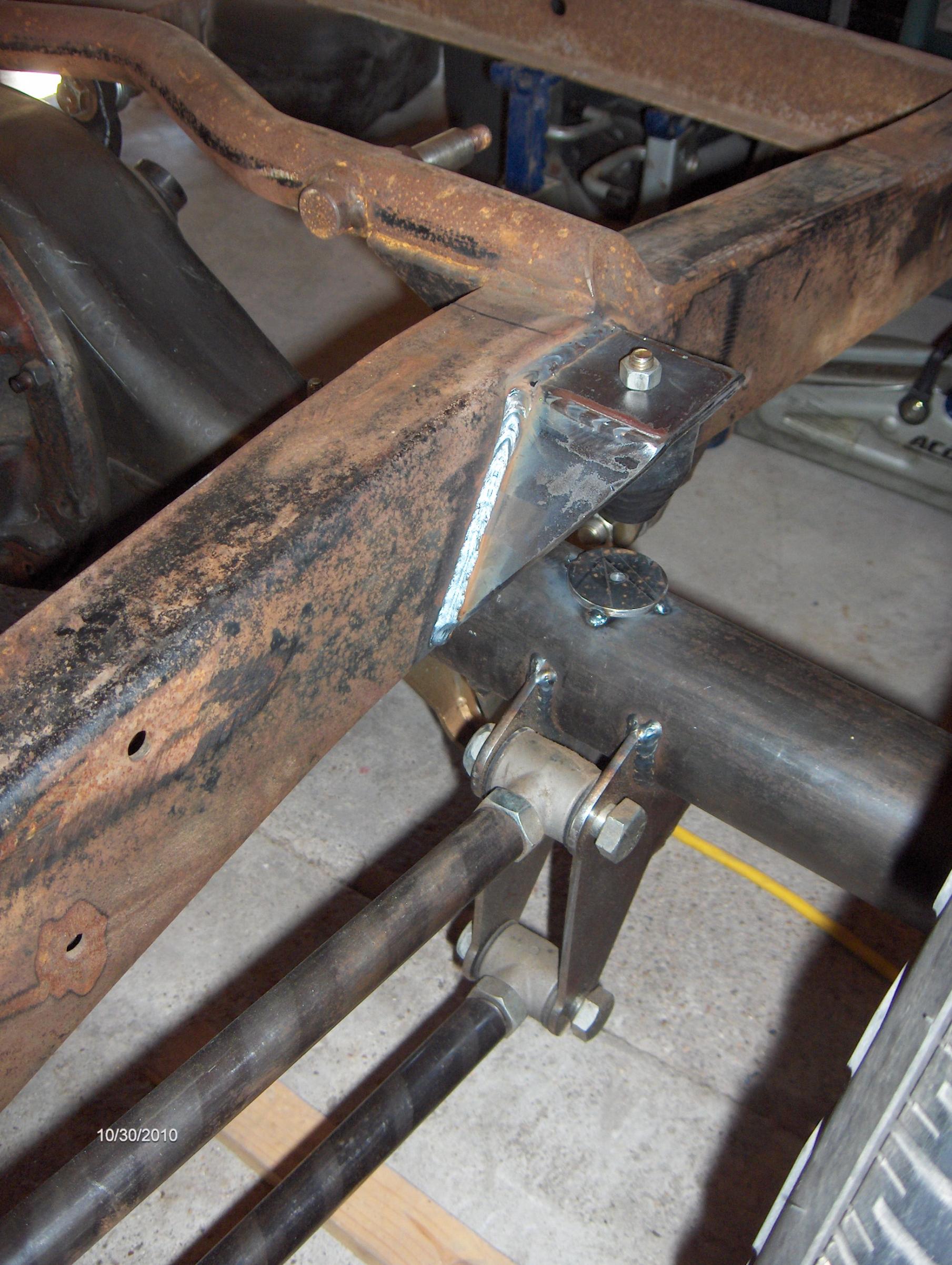

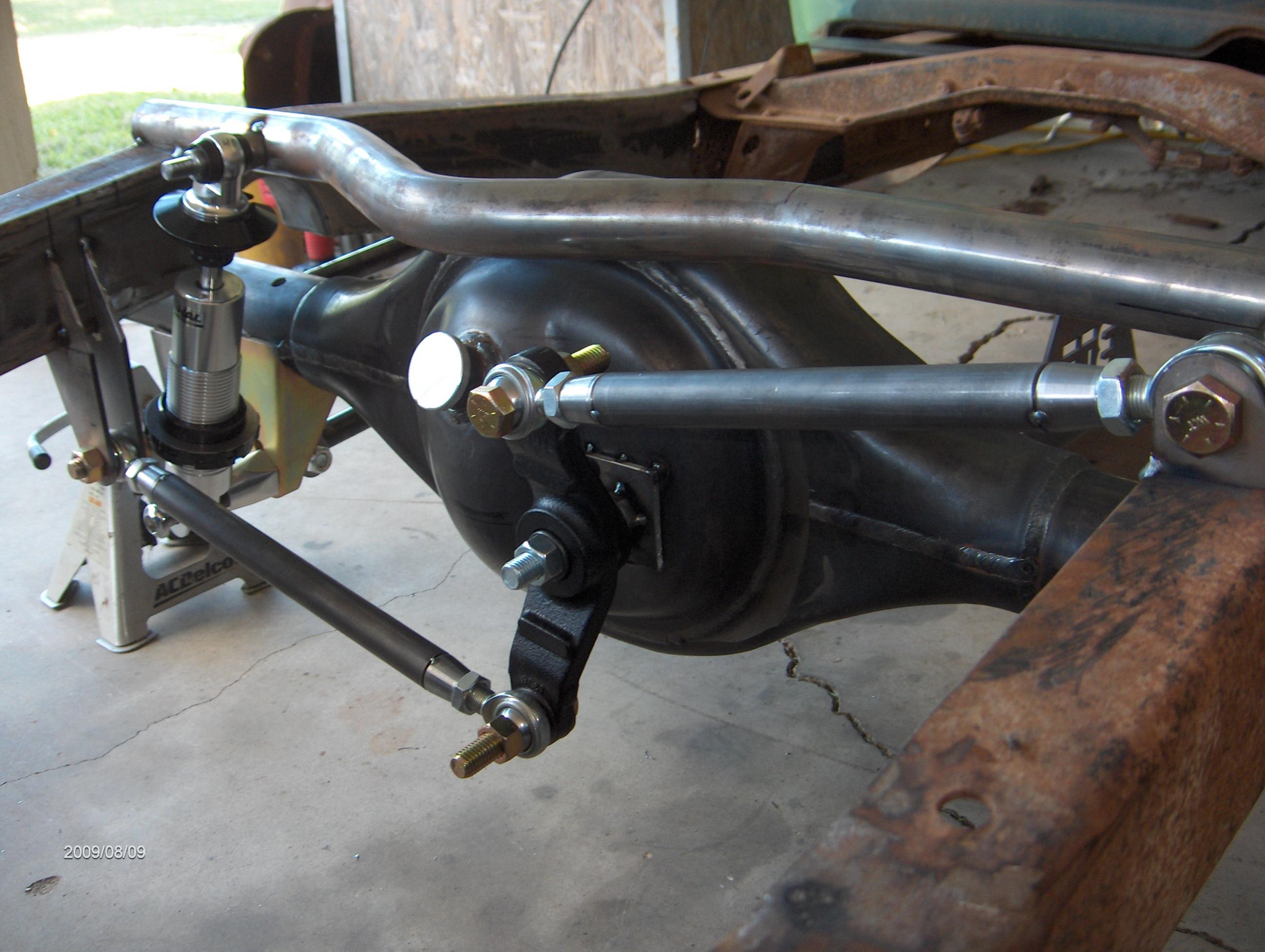

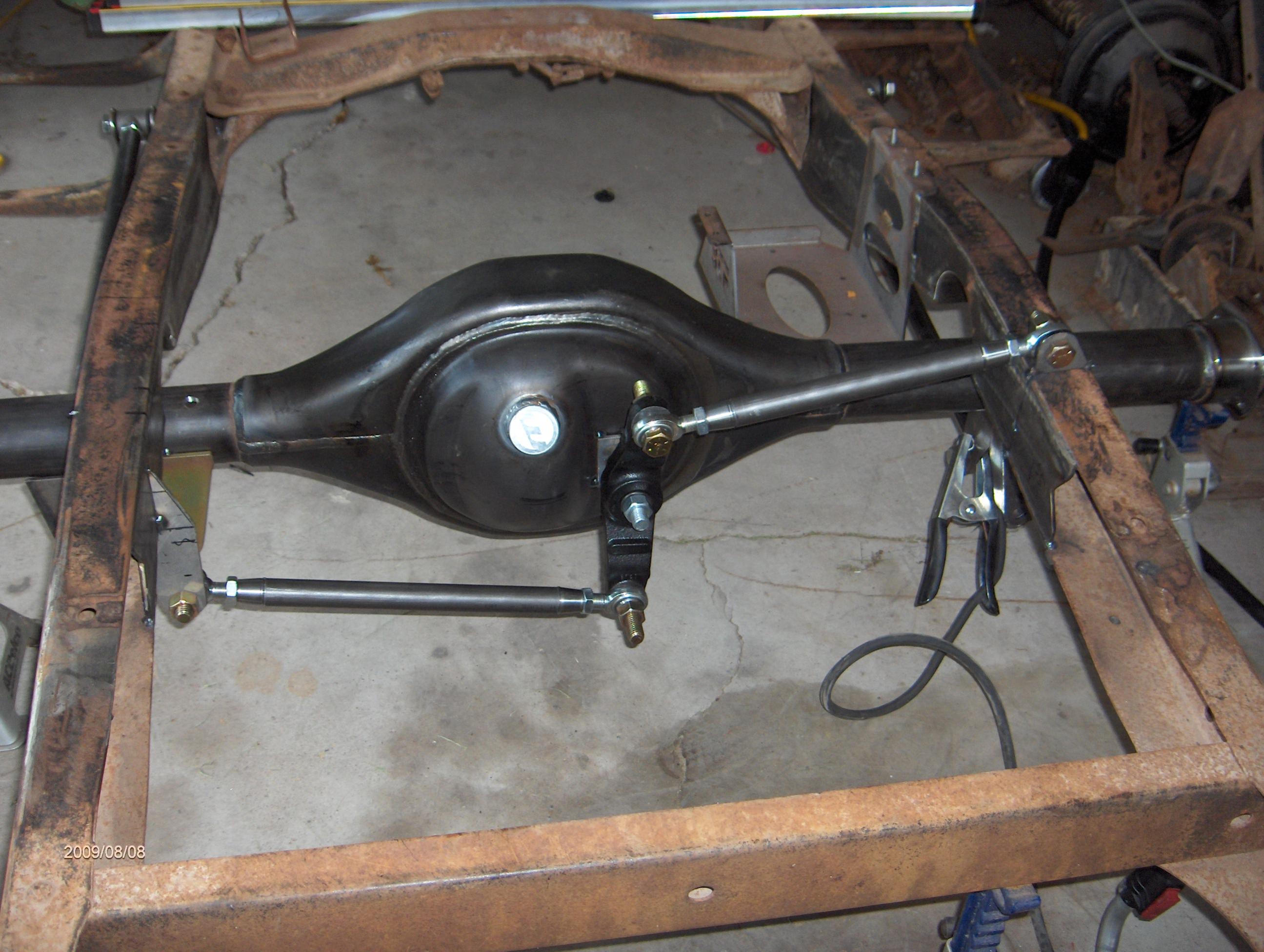

    Some updates on the rear end.

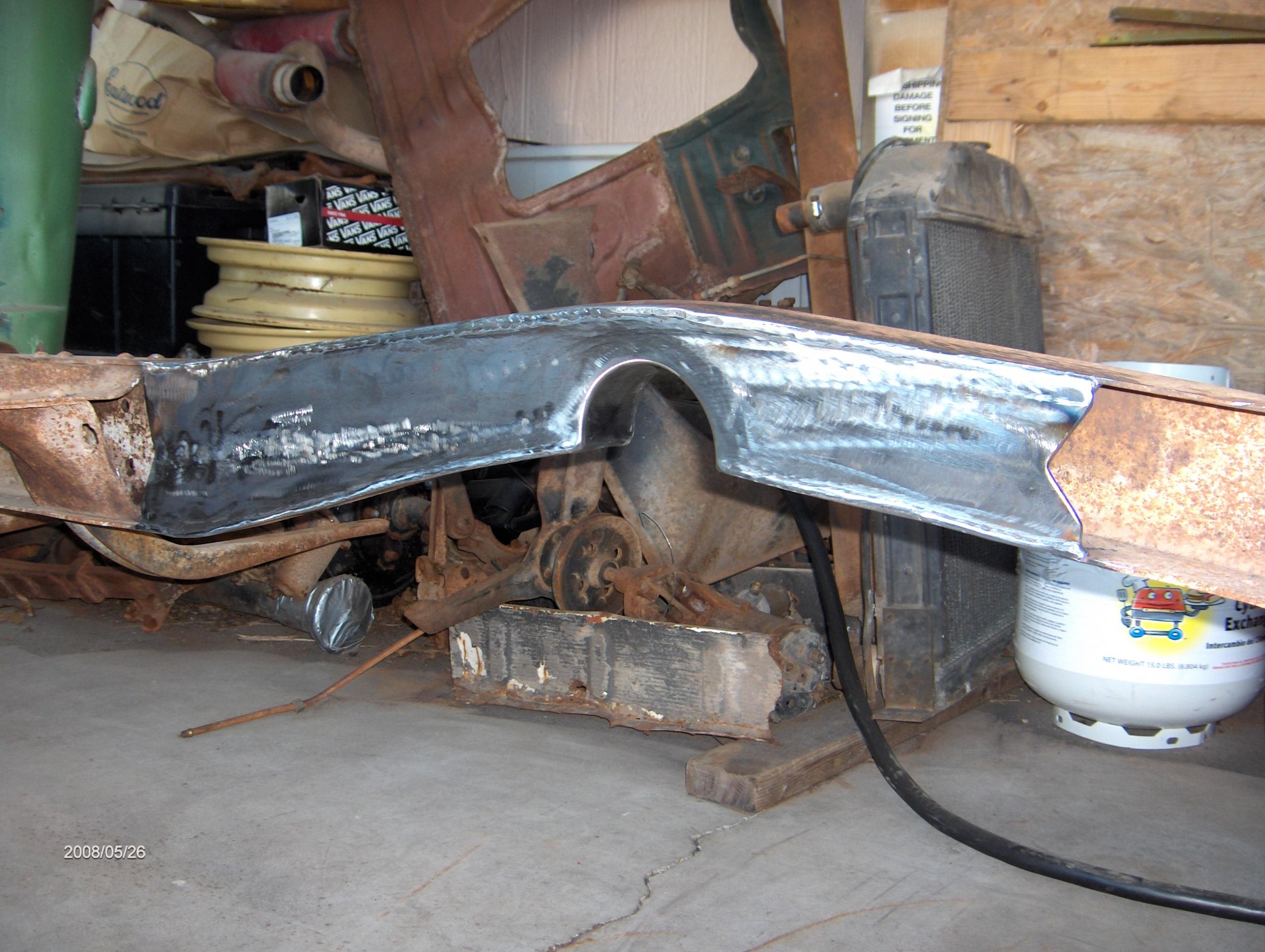

    Some more rearend pics...

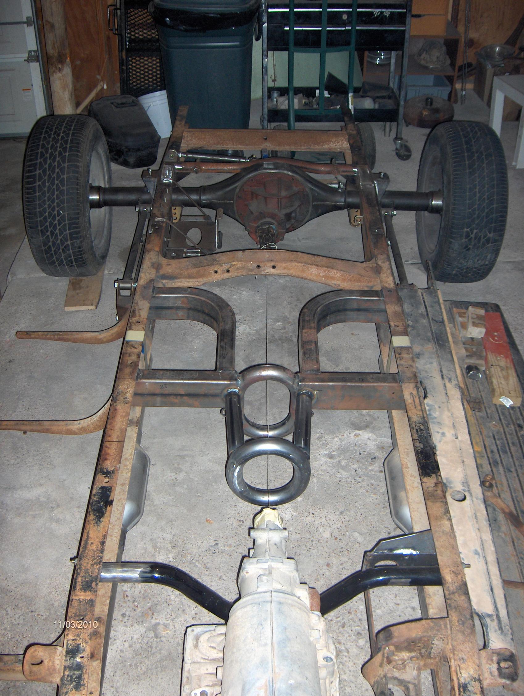

    Here we got the new column and all the u-joints in and the steeringshaft routed, Mastercylinder is mounted too.

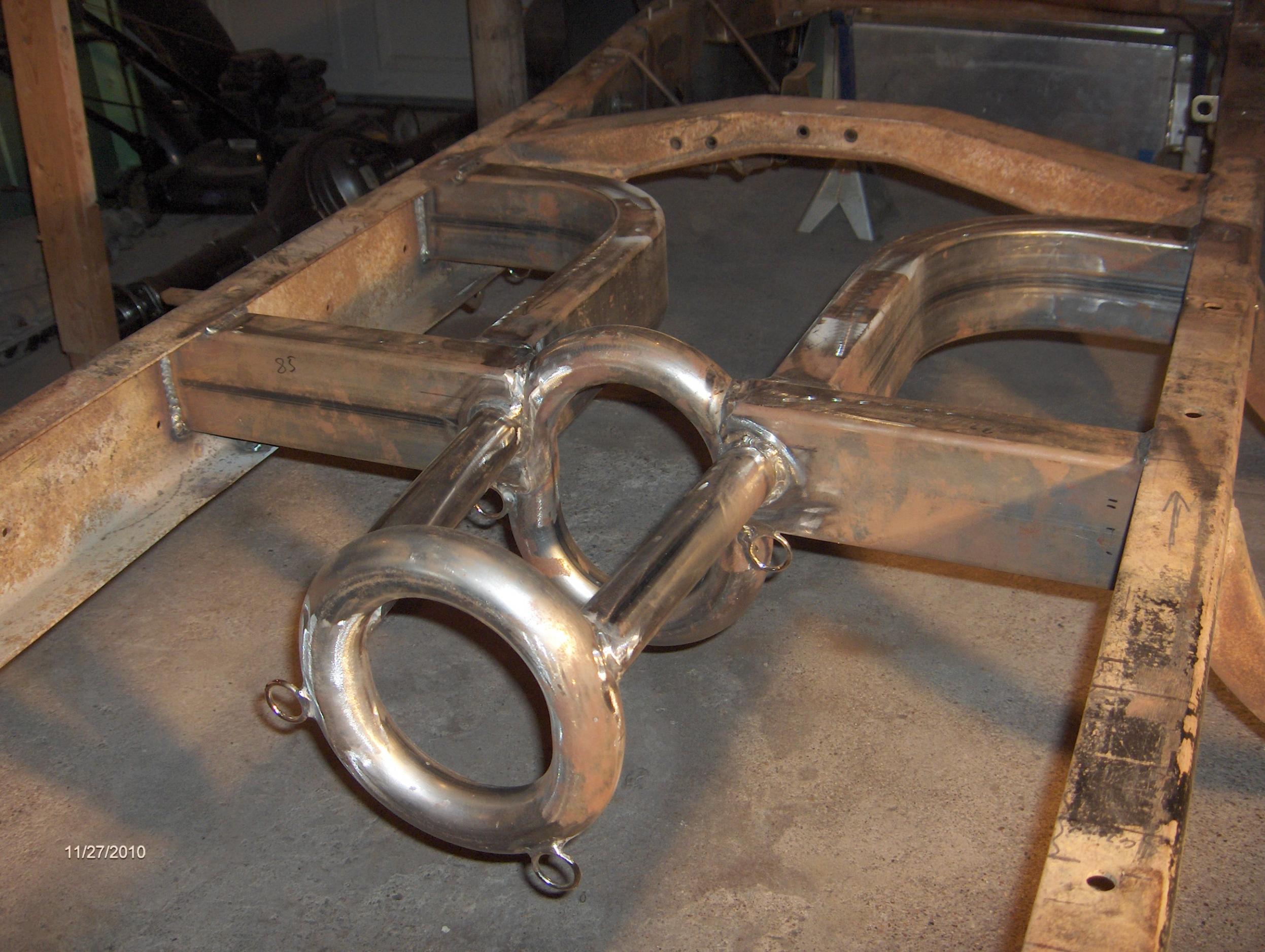

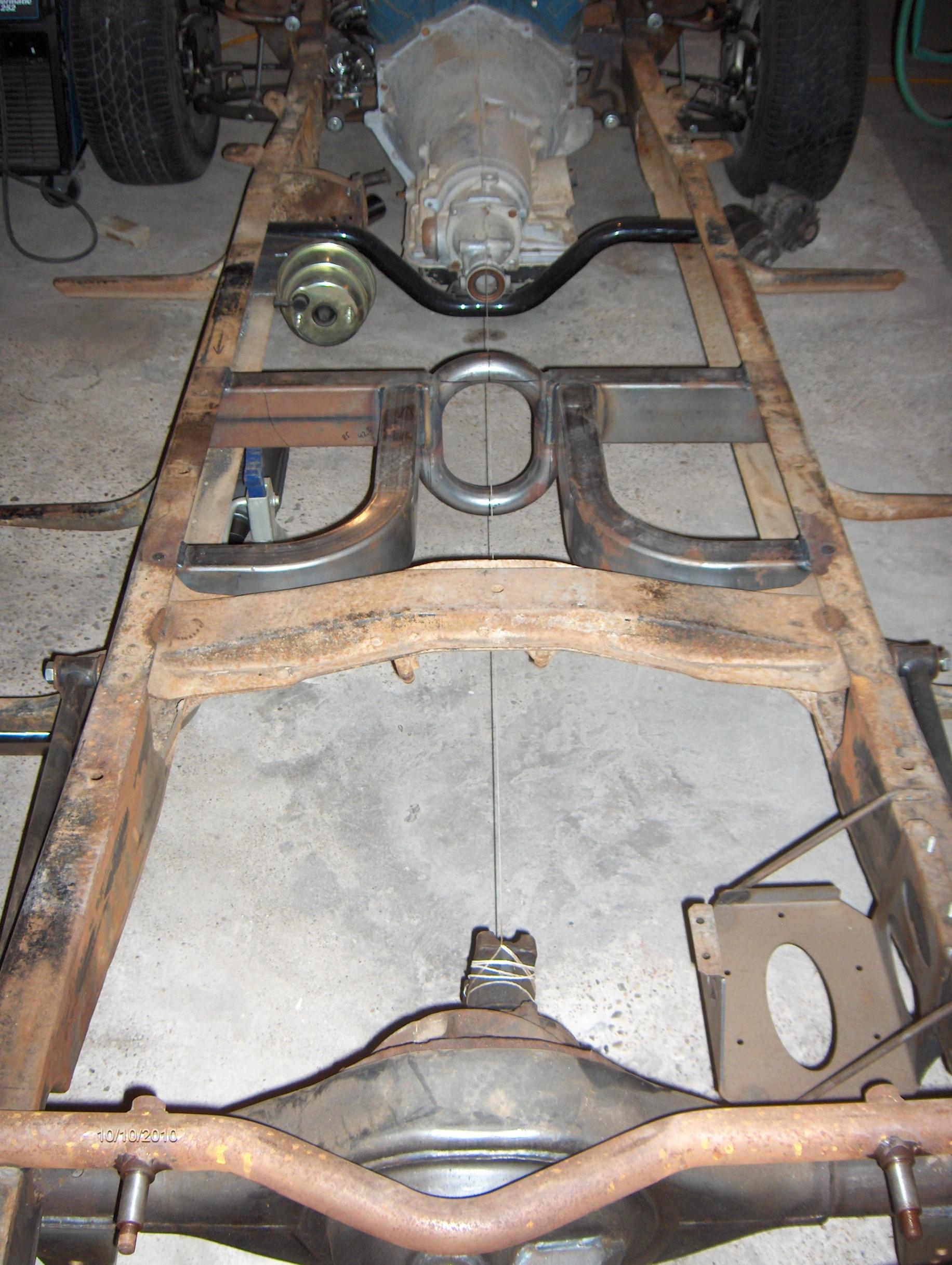

    Here we go, got all the driveshaft loops in also swaybar and mainbattery switch.
  25. 38Chevy454
    Joined: Oct 19, 2001
    Posts: 6,875
    38Chevy454
    Looks pretty good, but I would suggest to add a little height over your rearend notch to make it stronger. Even boxing the inside, it it still much less strength because it is so short. You probably have some room above the bed, even 1 inch taller over the notch is a substantial improvement.
    I used to drive a 37 Chevy truck as my daily driver and it was great. Still miss that truck, driving all over the place. Work, shows, junkyard, whatever. Had the same basic set-up you are running: Must II, 350 SBC, T350, and I had a 57 Chevy car rearend instead of the 9-inch you have.

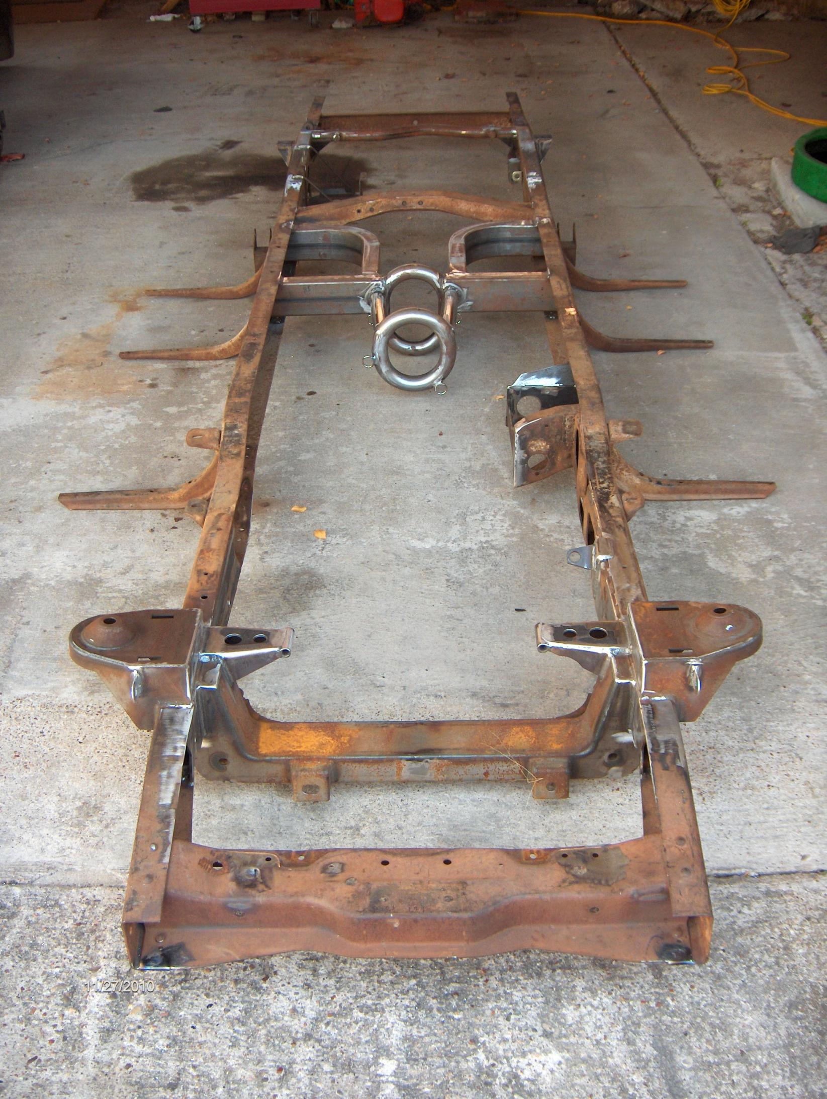

    Ch***is is all done and sandblasted.
