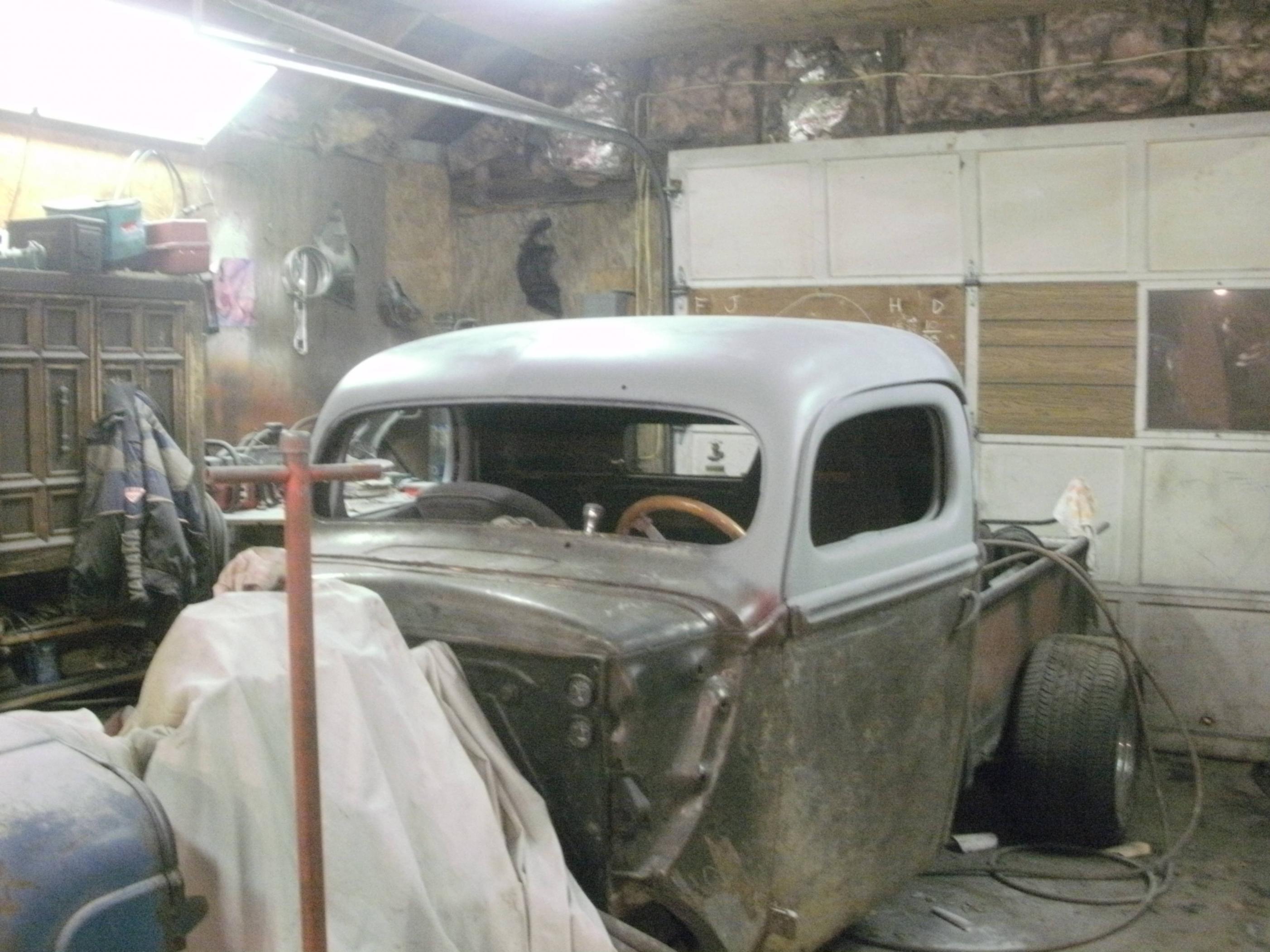

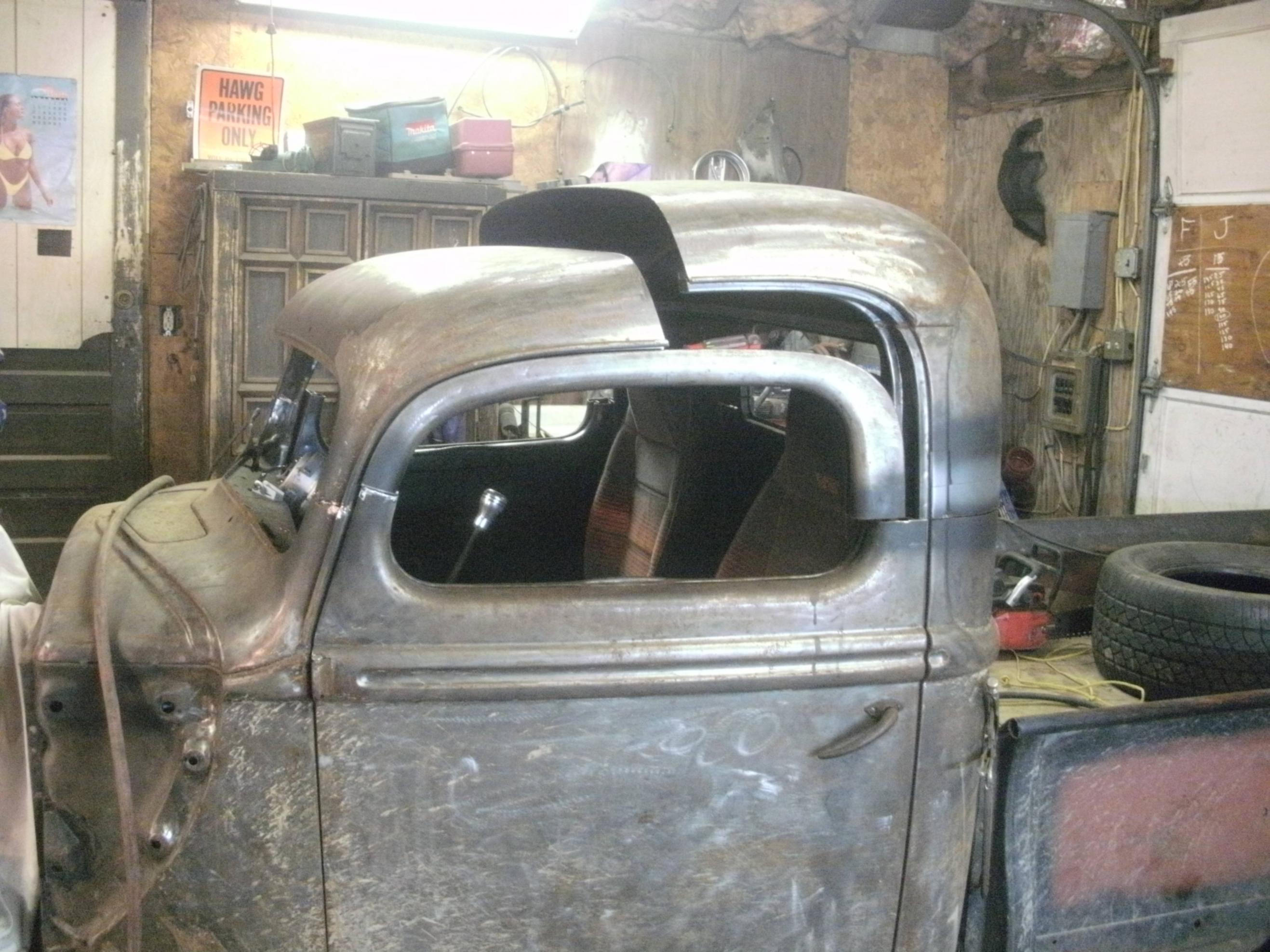

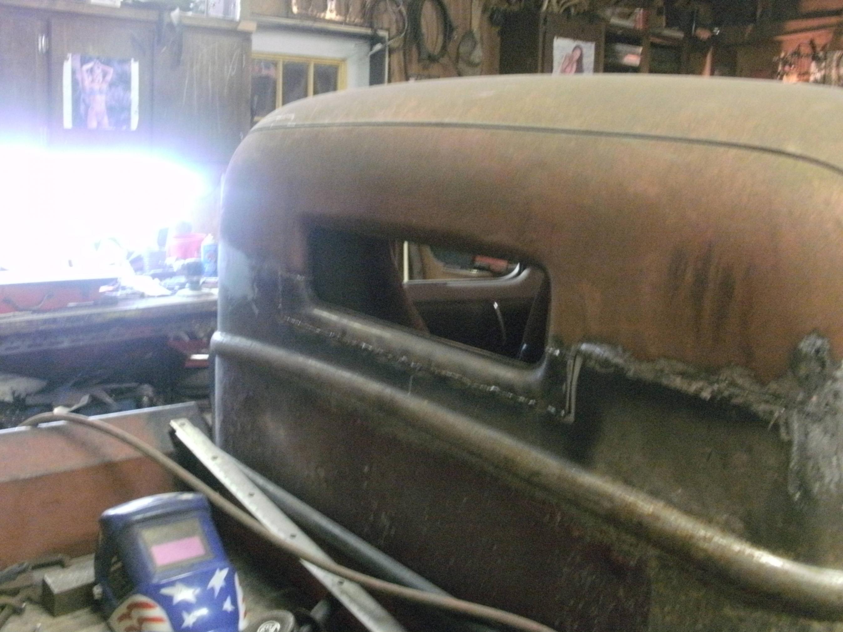

    4" off the top, and 2.25 out of rear window.

    I found some time for a little update today, i got more done and will uplaod more pics soon.
  3. octobeak
    Joined: Jun 30, 2010
    Posts: 154
    octobeak
    nice work man! I'm digging that color!

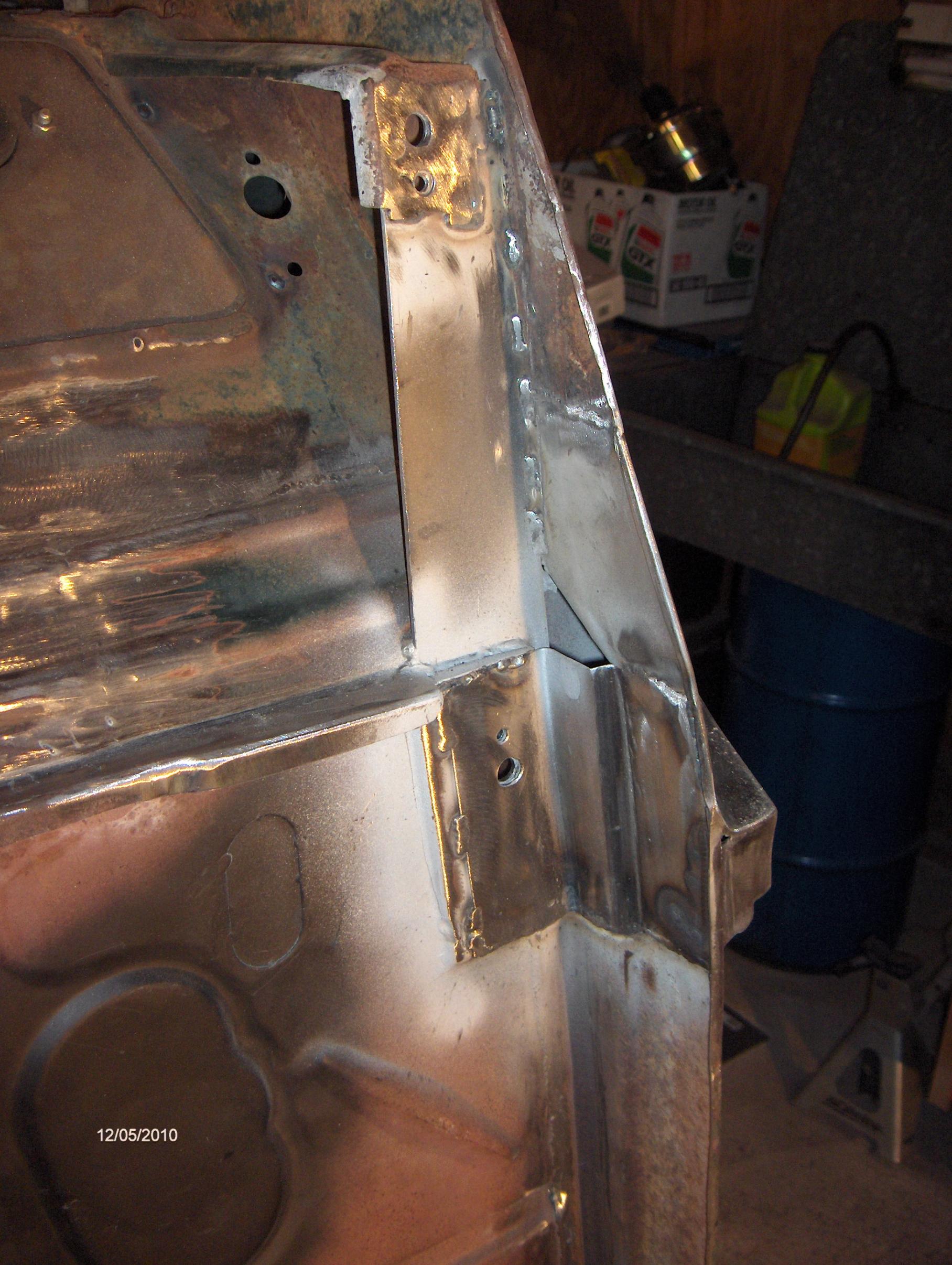

    Try to figure out how to do the floor!!!
  5. ULRICK
    Joined: Sep 19, 2010
    Posts: 75
    ULRICK
    from Texas
    Just kidding :) no licence plates for the floor.

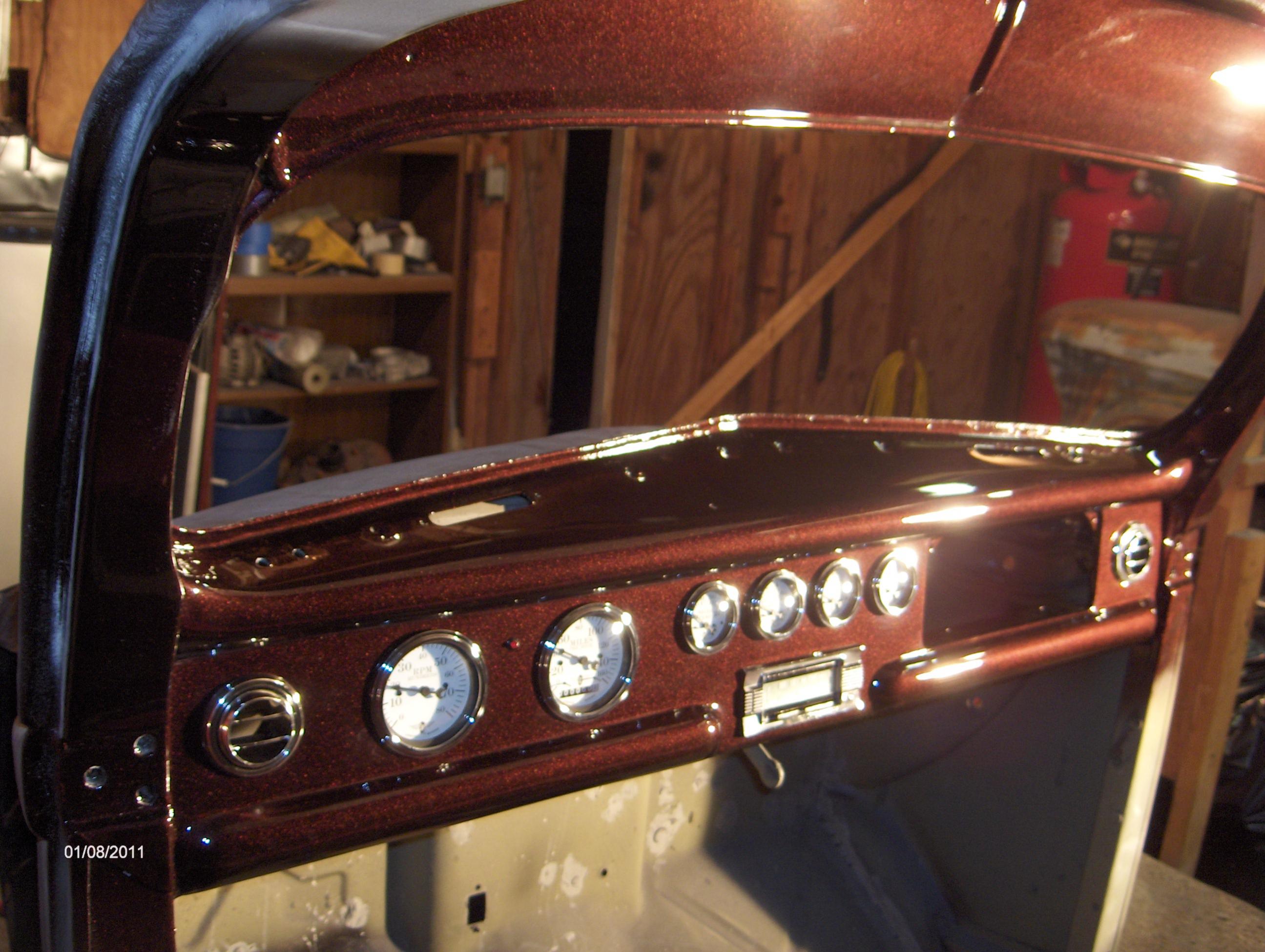

    Ooooh...X2! And if I'm seeing right, he flaked his roof...on the inside!
    ULRICK...You gonna leave the roof exposed? Nice.

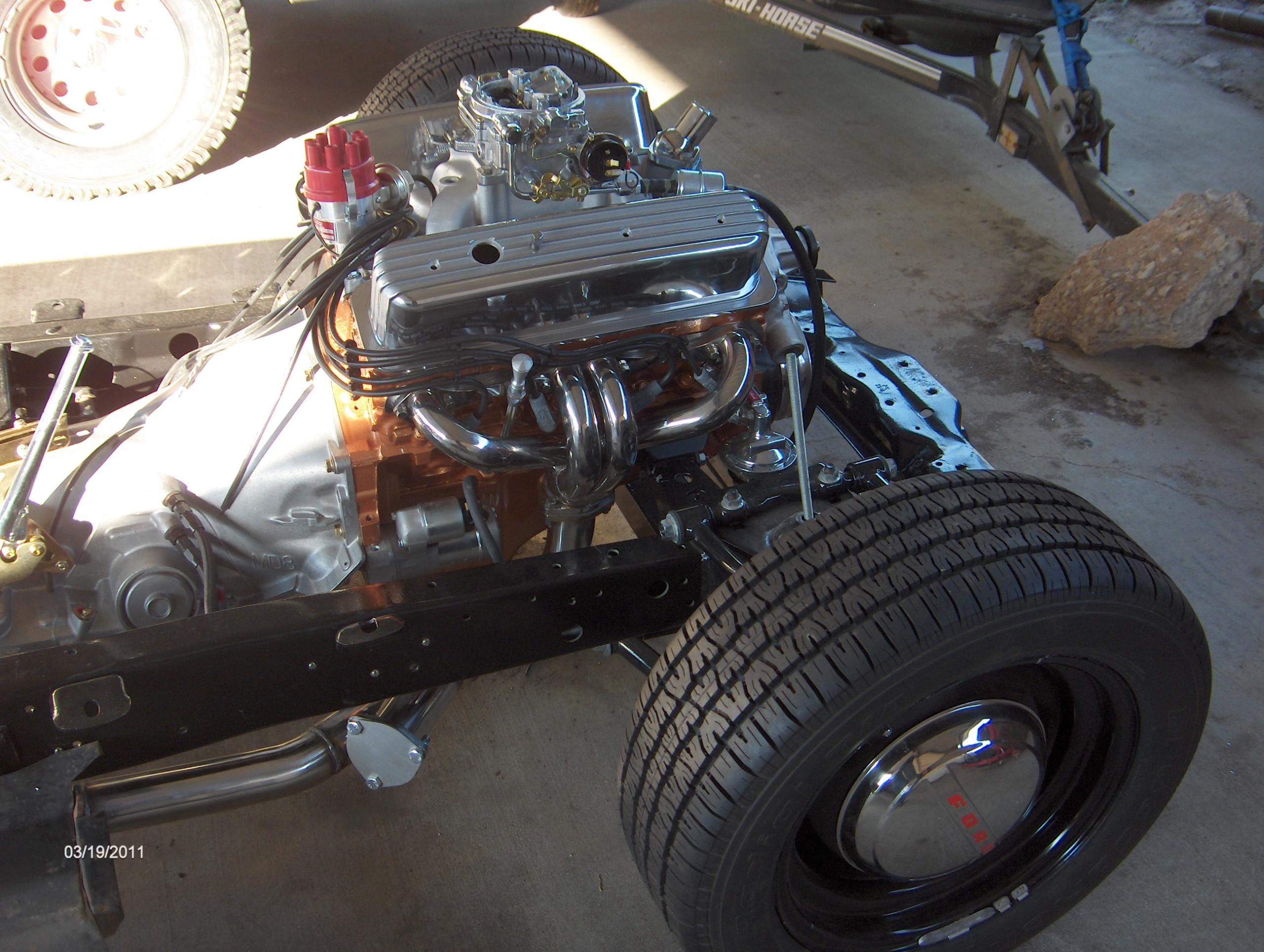

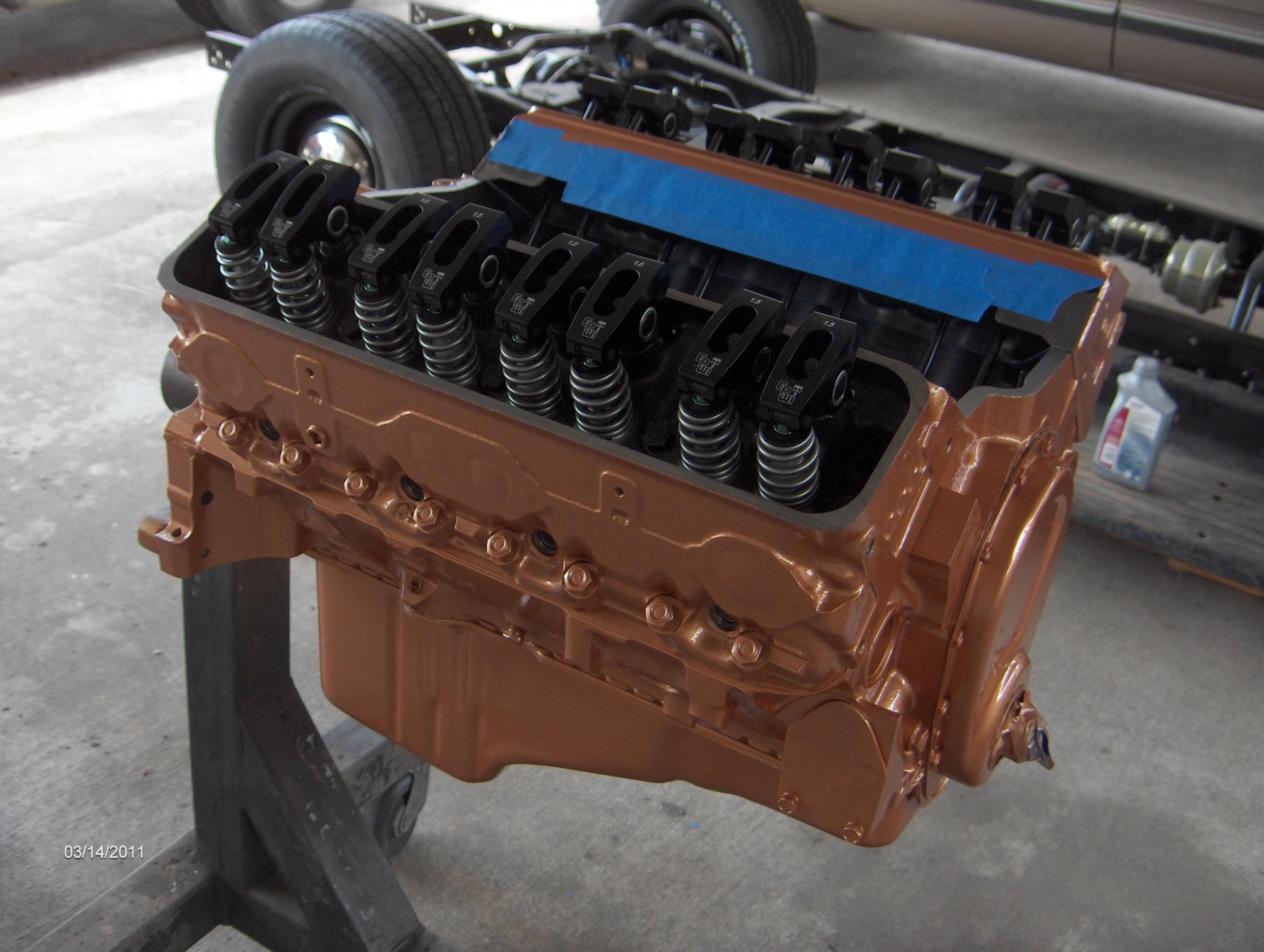

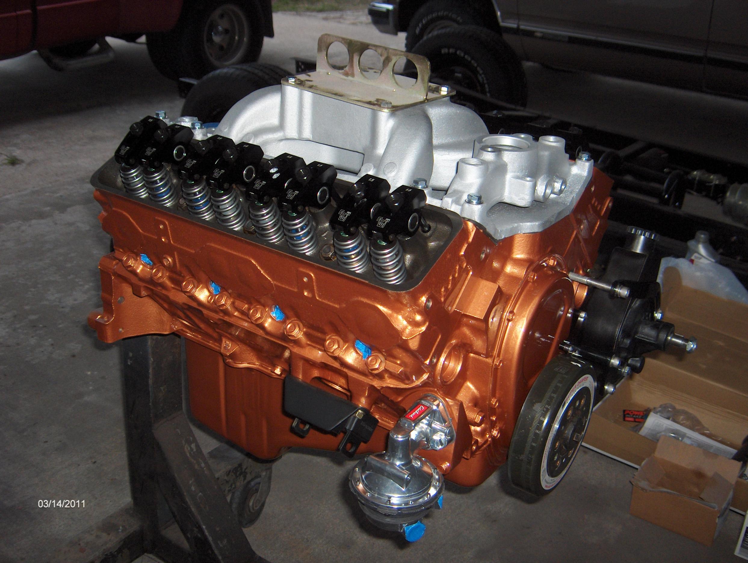

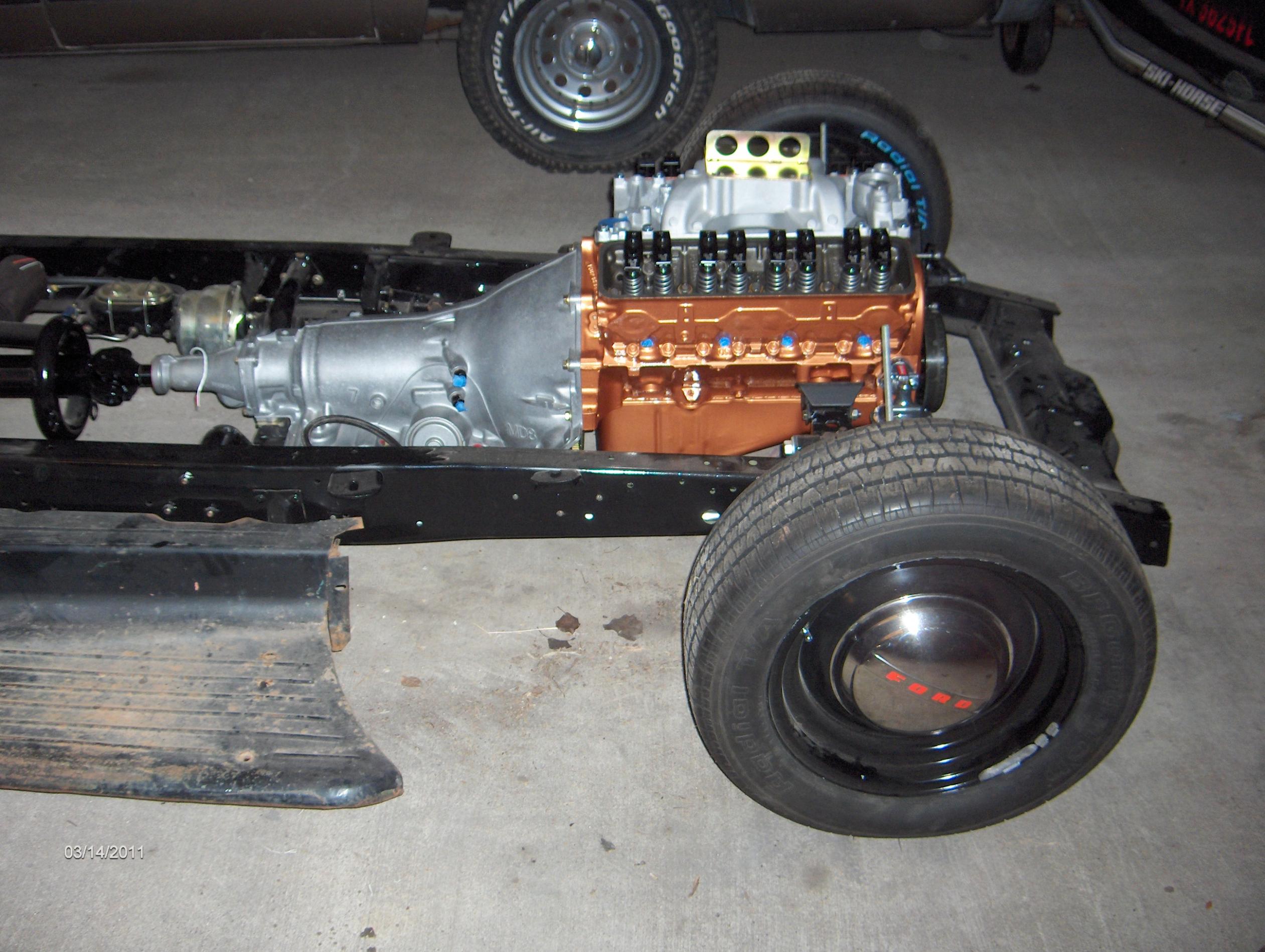

    Motor is in, its gold ;)
  8. oldman2
    Joined: Sep 9, 2010
    Posts: 2,373
    oldman2
    Engine is really looking good.....Jim

    how much did the back of your truck lower with that rear set up? i have a 9in rearend in my truck right now a but i want to lower the back also, where did you get the four link?
  10. DoubleJ52
    Joined: Jul 15, 2007
    Posts: 237
    DoubleJ52
    from Belton, MO
    What center pivot did you use on your Watts Linkage? Outstanding work on everything by the way!
  11. ULRICK
    Posts: 75
    ULRICK
    from Texas
    Thanks everybody.
    Not sure how mutch lower the back is, i just kinda set the ridehight up by eye and made it look right.
    The 4 link is a heidts 32-34 ford one i made fit. The center pivot on the wattslink is from a late model dodge durango.

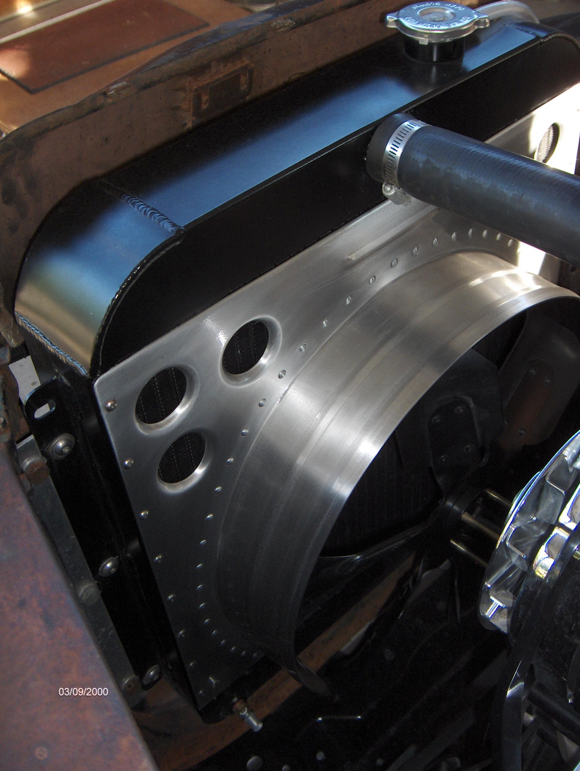

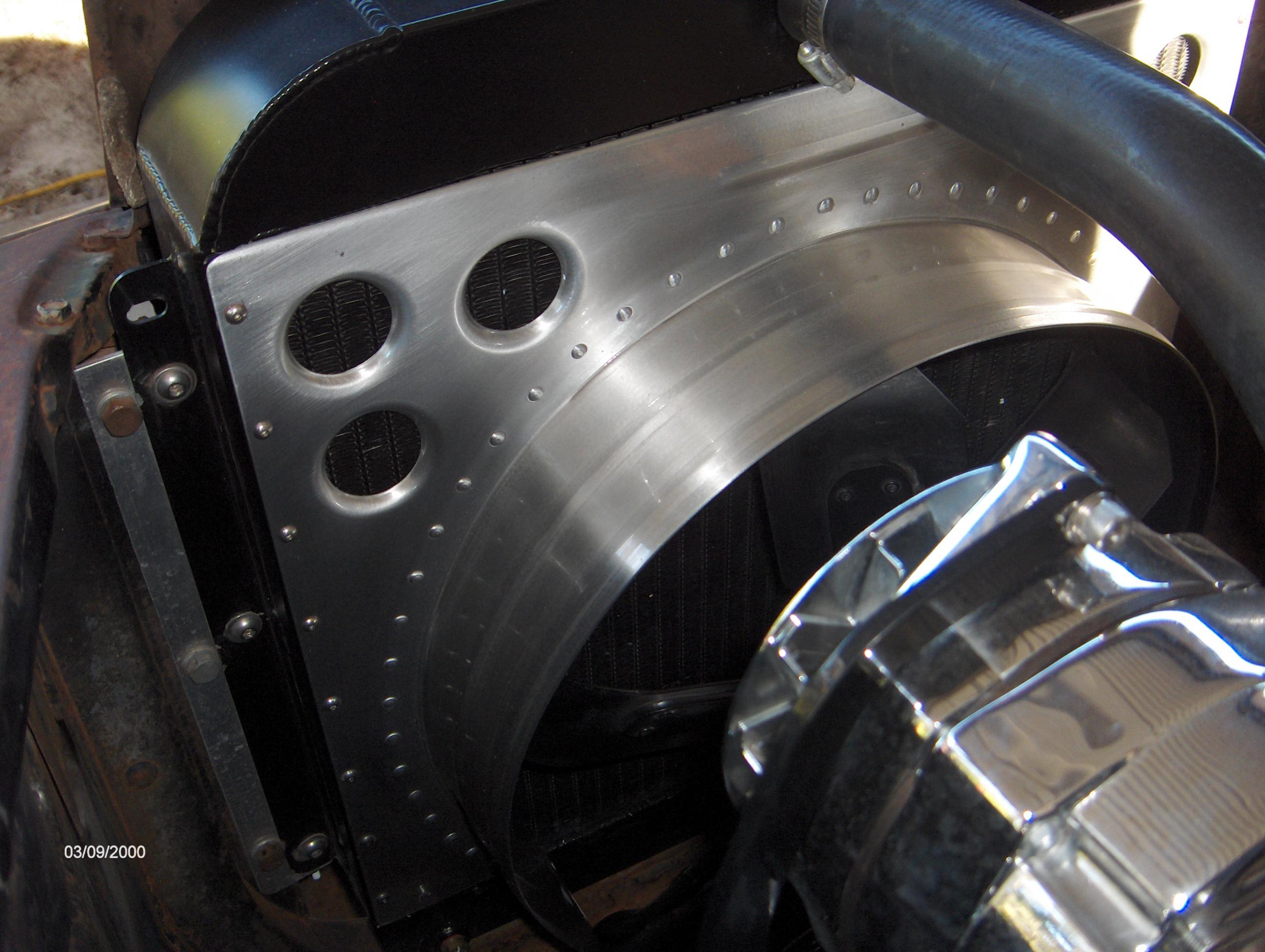

    Finally got the fanshroud done, after driving 9000 miles without one.
    Kinda looks like i really dont need one.....
  19. oldman2
    Joined: Sep 9, 2010
    Posts: 2,373
    oldman2
    That is one beautiful shroud, I'd keep it just so people would drool....Jim
